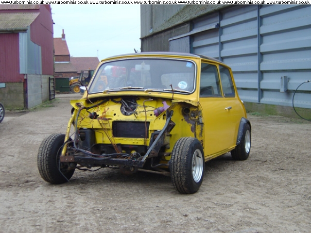

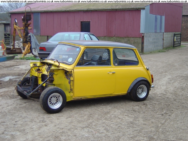

hey up just thought id pop a couple of pics up of my clubby while im rebuilding it.
its curently at the waiting for me to get my arse in gear stage, the engine is going back togeather tomorrow now the oil pumps arrived from avonbar. just added the final touches to the box too, a minispares x pin diff and central oil pickup.
ive been reading the posts about the layshafts and thought i better check mine too while its out, its the origional one with at least 70k on it, and looks as good as the day it was put in! box is full minispares evolution s/c with 1-1 drops as well and seems to be holding up well.
benross is curently modding an old head for me so that will hopefully get the CR down to a more suitable level, and it's going to megajolt thanks to a kit that alex is building up for me.
once thats all back togeather it can go in and the intercooler will have to be sorted. then its off to a RR and hopefully well sorted for minis v beetles.
aim was as near as 180bhp as possible but i bought iain's green racer and it put an end to the top spec engine. hopefully somewhere near 150bhp will still be achivable tho.
now sporting the mb's from the racer *happy*
needs a little paintwork in the inner wheel arches and the brace bars etc

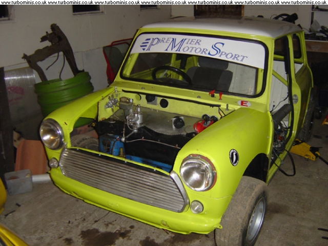

iains old car, safely tucked away in the back of my shed while i get round to doing something with it. realy looking forward to having a play with it actualy. still trying to decide on a colour for it

The MB's change the look of ever car *happy*
My garage is still empty, few weeks to wait yet before i can start playing *frown*
