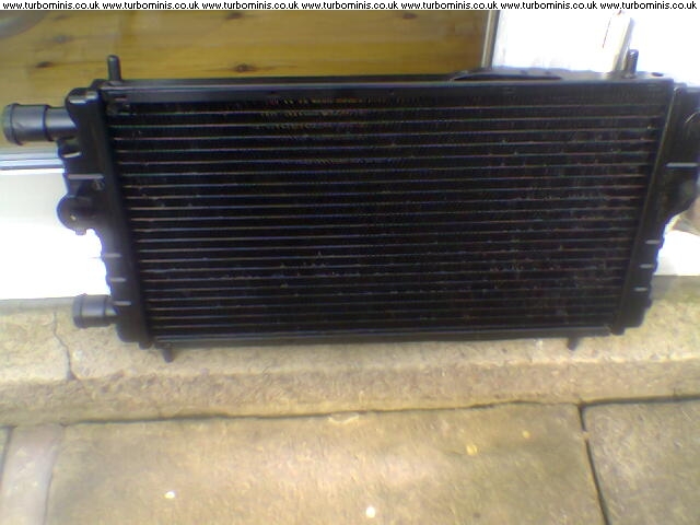

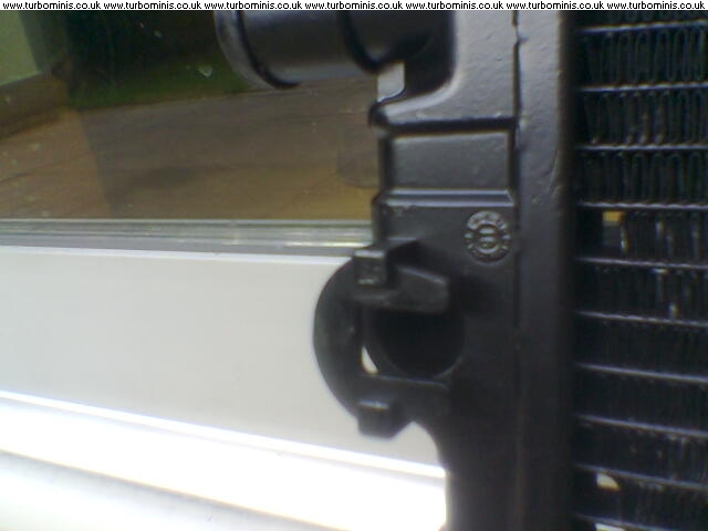

my mk1 metro radiator! yep its a sereck marston type, not exactley what i wanted but it was cheap & should do the job ok! its a NOS one too & never seen dirty water or fluids of any type does'nt leak after washing the dust out of it & looks ok too
dont really know what goes in here on it

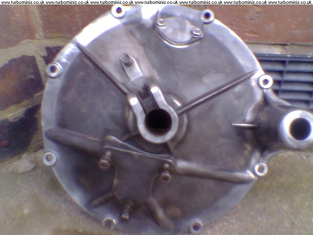

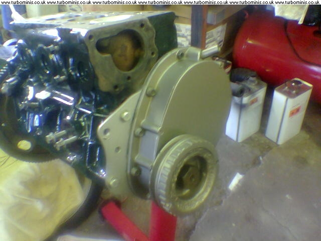

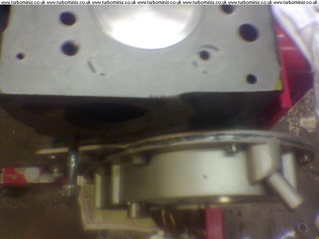

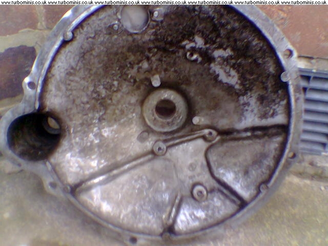

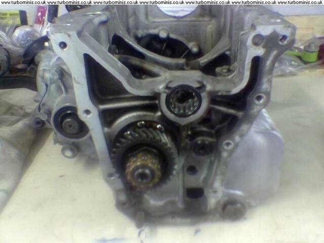

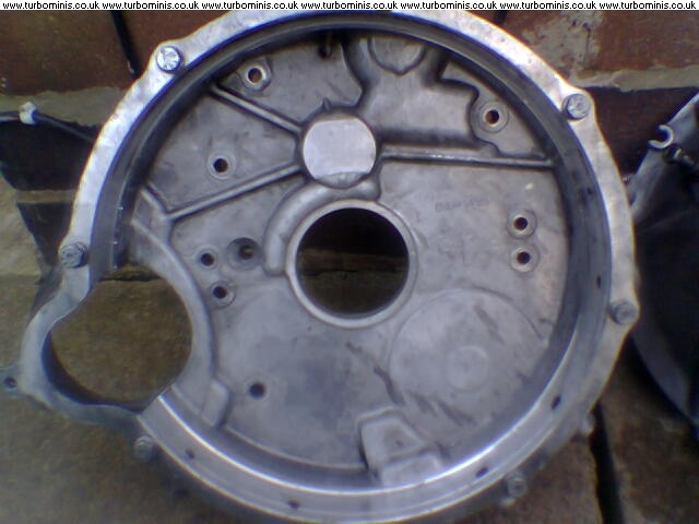

my clutch casings so far, i've gone over the outside with the wire brush mounted to a drill & degreased the inside, cant seem to get it cleaner inside the frying pan bit which is a bit annoying :/
outside of the pan
the inner casing the primery seal has come up better inside though, degreased & gone over the outside with the brush in the drill
bearing side

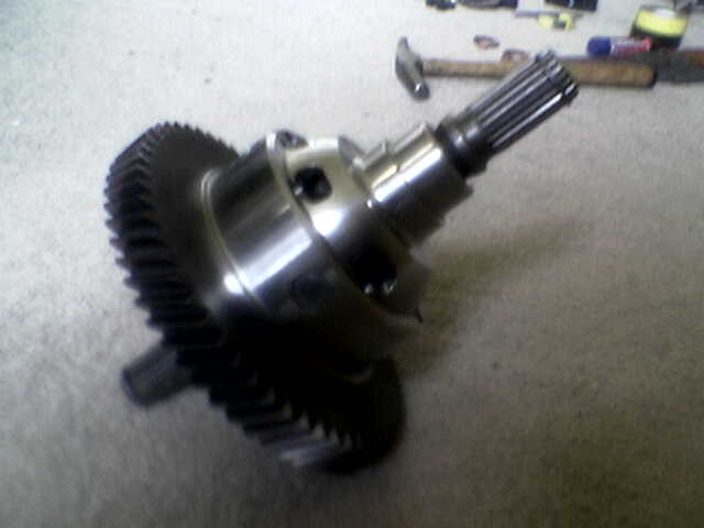

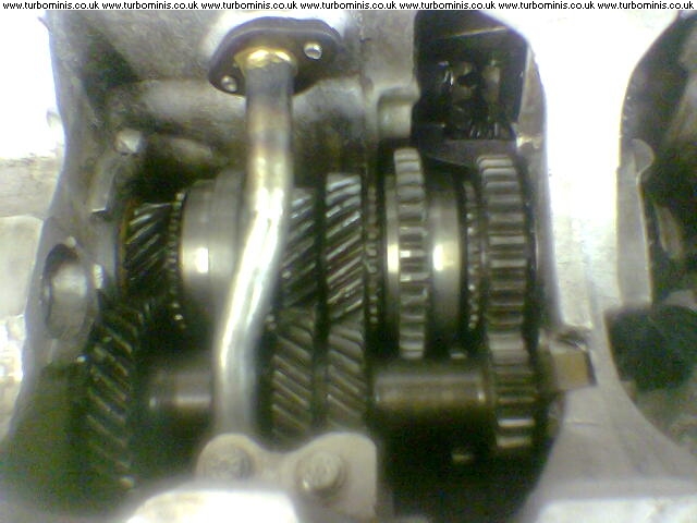

gearbox leak fix thingy-me-bob & "the" compatition diff pin which may become redundent

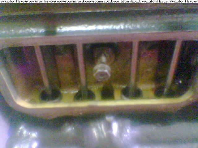

no need to bother getting the bits you cant see looking goodm
youll need a sender to block that hole, ill have root and see if i can find one

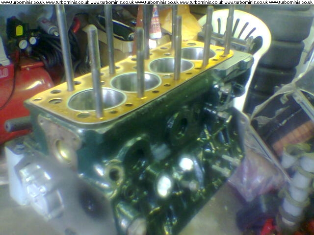

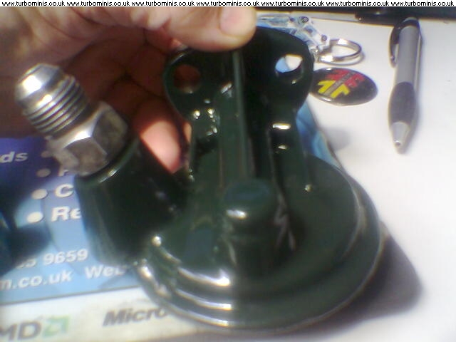

well i've been painting bits for my engine, quite happy with the finish i'm getting, i'm using hammerite smoothrite in dark green to match the engine
oil filter housing

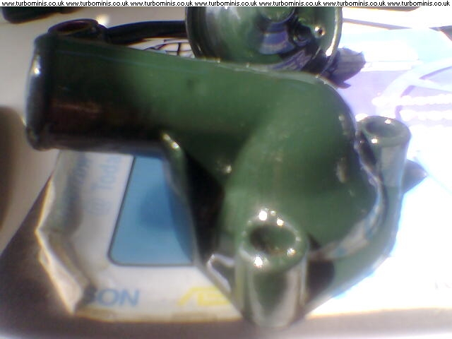

thermostat housing which i think will become redundant due to me needing the type that has a water feed/return for the expansion tank duuuuurrrr.....looks good though

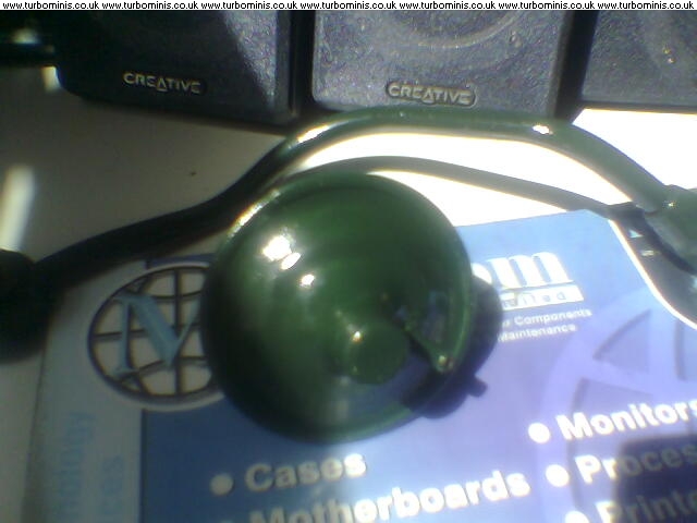

the oil pipe that goes on the block & the vacume advance dooobreee-thingy!

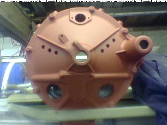

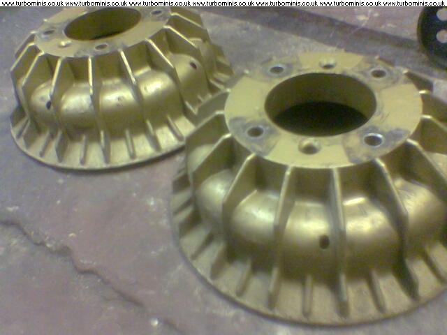

what you reckon of my clutch housings so far boyo's!
i like um anyway, holesaw's are ace, i'm gonna attack the car with um! *happy*
i've put holes in for a couple of reasons, clutch dust & to let heat out! plus it looks a bit racey ooooohhhh!
they'll be painted silver like my gearbox!

oh yeah, i've coutersunk the small holes cause i could'nt be arsed to file them *happy* the big ones are filed though!!!

its not very feng shui though is it dave? i mean those holes are supposed to line up with mars and saturn arent they?
clubminiflip
1840 Posts
Member #: 54
nr coventry
errrm its the light i swear hahaha! *tongue*
its like a deformed lab-rats head i thought lol ;D very deformed mind!
it does'nt look scew in in the metal, it was measured with my shatterproof :)

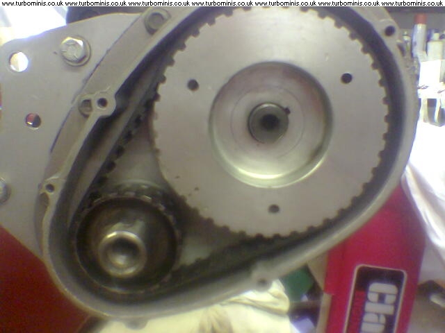

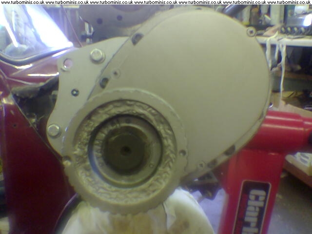

right chaps, i gont the correct gasket! the belt drive cast inner cover is on & i'm 99% sure i have the basic non-vernier style timing in the correct position, piston @ TDC, crank woodruff key @ 12o clock & cam @2o clock! the marks on the pulleys are matched aswell so thats basic timing correct i think!
i'm 99% sure its right so plz check my pics & comment, when looking at the bog cam pulley the marks on it are denoted by a large & small dot & you can just make out the notch in the crank pulley, thanks lads!
i'll check it with the fti next to see if i'll need a offset key to make it a little more accuate!
need new timing cover bolts too, any recommendations where i can get some as i dont know the sizes! stainless would be nice
thanks chaps

Just go to your local industrial shop. If i remember right they are either 1/4 unf

right then chaps, i've managed to time my cam in!!! hi-5!!!!
on the advice of will & ben 998turbo minmen *happy* & checking the kent cams site the recommended timing figure is 110degrees ATDC, i was previously advised by anther that i should aim for betweeen 106-107.5, i was reading mine at 109 degrees so i was going to use an offset cam key to correct it, but then today i've checked it over again a few more times confirming TDC & full lift on number 1 inlet & i got a reading of 109.5 so i've decided with the yellow book & advice from those more experiance than me to see how i go at 109.5 :) s some pcs of the progress-ish today
belt drive buttoned up & timed, i just have to torque the cam-nut up

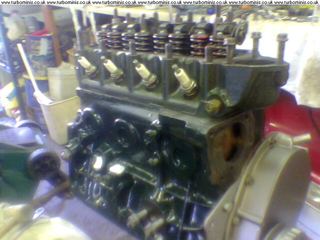

well the motor is buttoned up, i'll do so more checks before i put the gearbox & clutch setup/housings on but basicly i'm onto the gearbox strip & recondition now! hi-5!

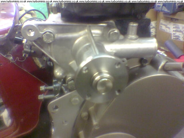

popped my waterpump on, its a hi-capacity item from minits, with the proper impeller, not the wanky steel type!

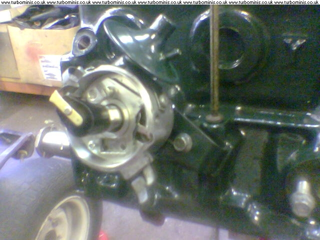

also i've put my locked dizzy on but i've forgot to get points & a cap & new rotor arm durrrrrh, this wont be on the motor for long though due to megajolt waitiing in the wings *happy*
the gearbox i'm gonna recondition & fit a cross-pin diff! plus a few other mods!

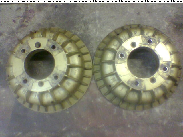

also got these lil puppys from a fellow turbo member, real Minifin Superfins *happy* they need a good tidy up but its the upgrade my rear drums need
more than likely i'll lightley shot/sand blast these & just laquer them! i'll decide on colout at the time!

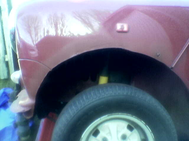

oh yeah gonna cut my rear arches in the style of jimbo's article, only cause i have the metal & welder out really! its a job done & probobly overkill on my car but bugger it! its clearance!

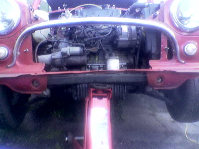

good thing is i can lift the car at the back so its defo getting lighter, comedy pic to follow of umper lumper sized me lifting my car lol *tongue*

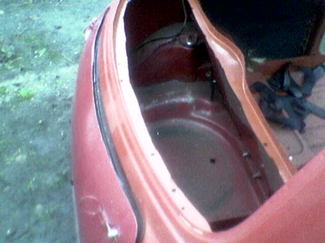

oh yep! another thing, i've cut the very very very heavy parcel shelf out & replaced it with an ally sheet bonded & riveted in! the weight differance must be oooooohhh fooook-all *surprised*P

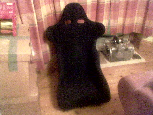

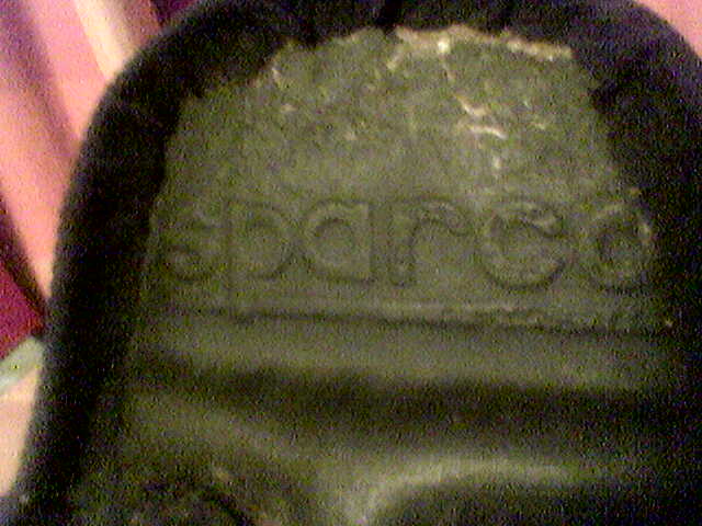

i have a new drivers seat!!!! not as oldschool retro as i wanted but its a SPARCO highback bucket, light as anything & i got it for £15, yes thats right £15 at another car show, it was filthy!!!! looked a real mess but had no tears, just the cover needed gluing in some places, round the harness holes etc, i'm not sure if its grp or carbon kevlar but it only weighs 2.1lbs on my scales, thats the same as a bag of sugar is'nt it!
rather than buying proper frames i've chopped up the old mini seat frame so i'll bolt it to that! *surprised*P proper cheap i am! i'll drill holes in the frame to lighten it in the fashon of carl super quick austin
i know ill have it mounted nicely from the standard frame, make life easier!

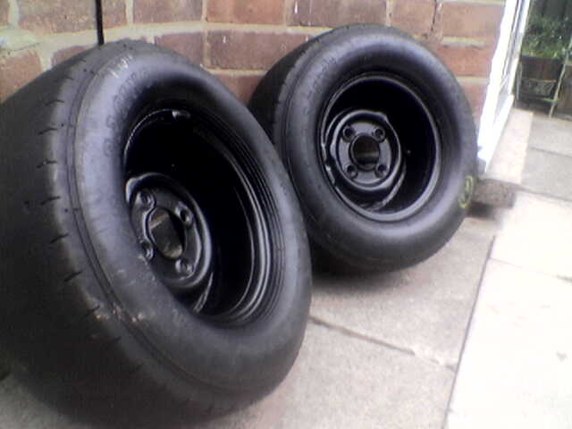

check out my badass track rimage lol, a little scruffy but i dont mind

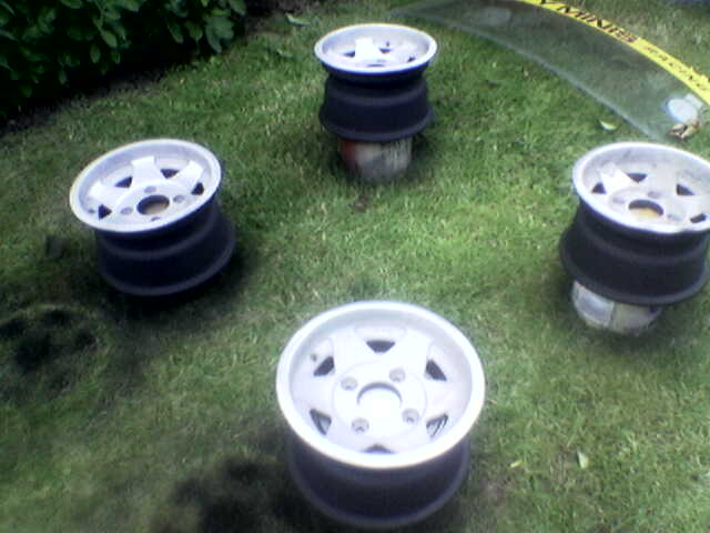

& i got some starmags wooohoooo prepped them all over just in the process of polishing them *surprised*( any tips, its a beeeeeatch of a job & i aint do to great on it

the sparco seat is kevlar & ionly paid £15 for it woo hoo
i have another more like a cobra monaco copy in grp tat i paid £12.50 for well chuffed

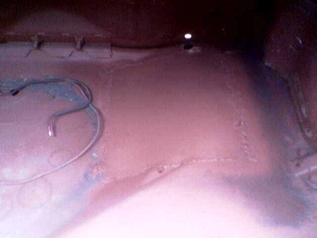

bar-steward! i've been doing this mini & found the sills although they looked "mint" are absolute pants!
i welded my 3mm plate for the rollcage & the sills almost fell off, but......i had some rover sills in the garage so i'm putting them on this week, alls gone ok so far (i'll get a few pics) inner sills needed a couple of patches but nowt serious, pheeeeewwwww!
