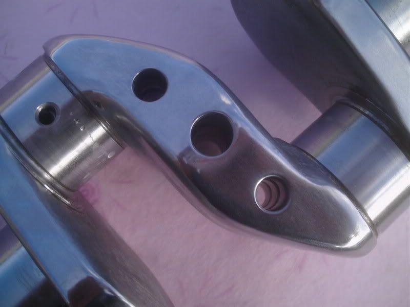

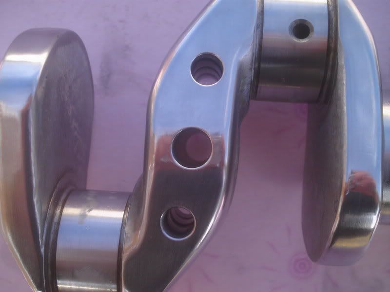

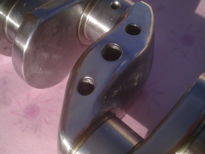

On 1st of Mar, 2007 at 04:10pm fastcarl said:
i have been thinking about putting three holes through the big web between 1 and 2 etc, and 3and 4. laying the crank on its side as in the pics and drill vertically,it would increase the surface area to heat treatment quite a lot, not monsters, maybe 14mm in the middle and 10mm out near the backdrilling,
thoughts,
carl
A bit late now but don't the oil ways for the big ends run through the main webs?
6966 Posts
Really!!!!, have another look,
the oil ways run from
"front" main to no1 bigend, centre main to nos 2&3 ends and "fltwheel main to no4 bigend,
or, not the bit Carl as drilled.
Ok, I was wrong.

Any further on with this Carl?
Did you get it to work in an engine?
I would really like to know *smiley*
If I'm not mistaken this crank is in The DON.
I'm sure Carl will confirm either way.
6966 Posts
no tom, its not in don , it was cleaned up groud and balanced up just fine, then i stuck it in the airing cupboard ,
i had previously completed two identical cranks which were to be used for a pair of turbo engines to be developed in Don, one is in there now,
the other keeping the counterweightless crank company,lol. amoungst others.
