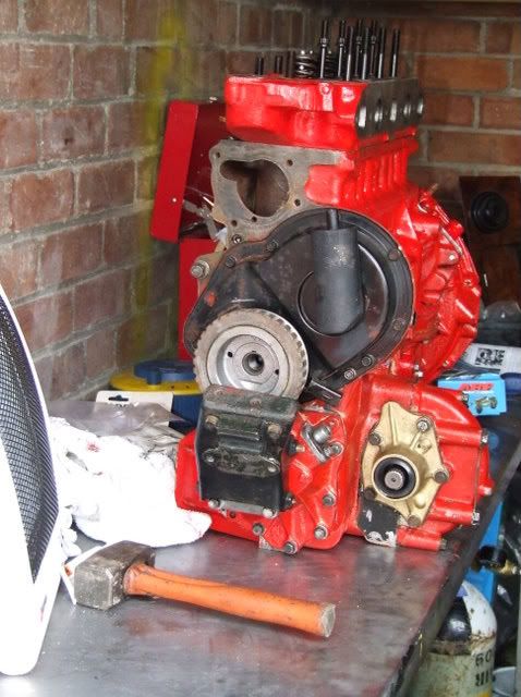

number 4 and the slither (super ultra fine one which isnt numbered) feeler gauge so its 4.5 thou i believe, it lines up nicely with the first motion, the primary is just under 6 thou, the remit is 3.5 to 6.5 so i think i will leave it at that, i have bolted the block onto the box and just popped the end casing on, but i am getting there. will post some pics up in a second.

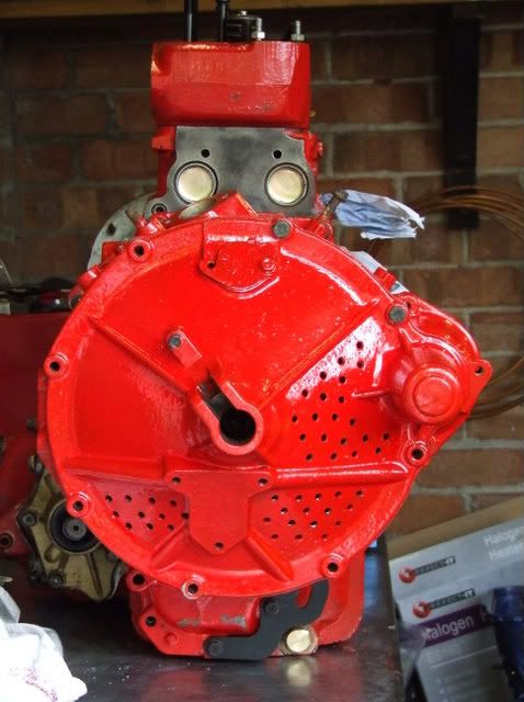

Richie
3184 Posts
Member #: 628

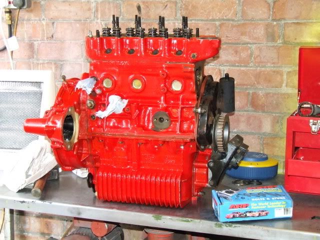

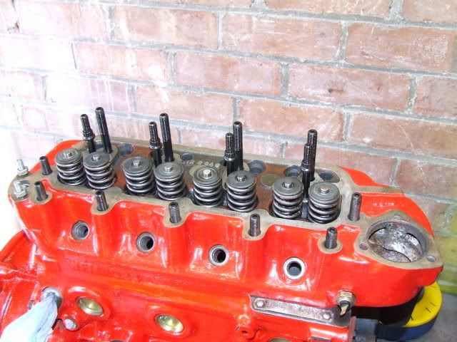

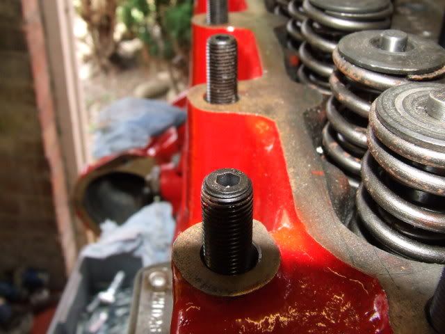

Reunited and it feels so good..........(dunno rest of the song) well three years later and the engine mets the box once again !!!
ARP head studs rock !!!!!! nice bit of machining Gucci !
well just need a clutch plate and a plenum of nic wink wink @ Nic, and am sweet
Edited by Richie on 4th Apr, 2008.
TRADER HALL OF FAME
TRADERS OF SHAME
1 user....pm me 4 details
LEGENDS
MikeRace, Mini13
On 17th Aug, 2009 Jay#2 said:

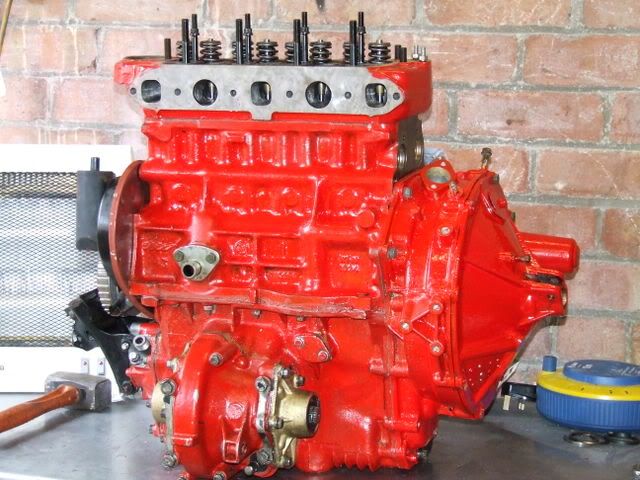

And you need to paint it.. Yellow car, red engine? It'll break down before you've left Tynemouth! *wink*
4310 Posts
Well done.
I like the fact the most important tool in the workshop gets pride of place in the middle of the shot:)
nice richi, soon be there buddy
Richie
3184 Posts
Member #: 628
what the heater :)
TRADER HALL OF FAME
TRADERS OF SHAME
LEGENDS
MikeRace, Mini13
4310 Posts
The lump hammer*smiley*
Richie
3184 Posts
Member #: 628
Ahh Mel the handy pursuader

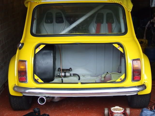

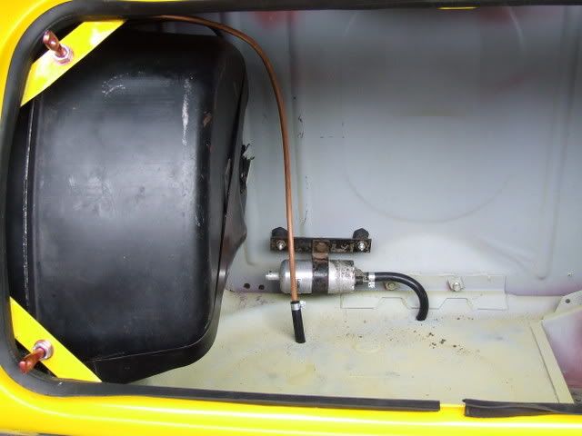

well a lil bit more progress, mounted the fuel pump and completed the lines fitted the reg, and fitted me exhaust. I still need a small bit of pipe from the tank to the pump and a P clip to secure the return and it should be good. the other black pipe is injection fuel line so should be ok "he says"

Richie
3184 Posts
Member #: 628
my spare wheel is going on the back seat in a bracket iam making before anyone says anything. the photo makes the return look like its in the middle of the floor but it is not i assure you.
TRADER HALL OF FAME
TRADERS OF SHAME
LEGENDS
MikeRace, Mini13
might want something on the rubber pipes where they go throught the floor in case of them rubbing? just a thought, i am not sure if they will rub or not but on the safe side.
looking gorgeous though! love yellow minis!
Richie
3184 Posts
Member #: 628
they shouldnt rub they are tight and have a bead of silicone around em i hope....i was thinking of that when doing it :) i have some rubber grommets if i need em.
