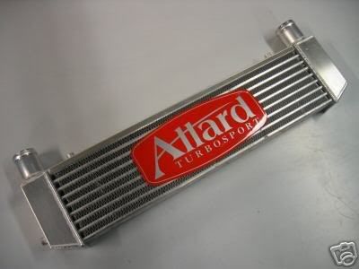

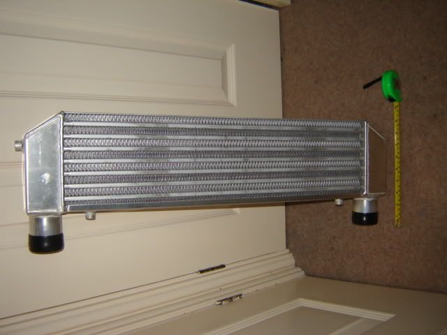

well i got my intercooler and its massive, i kind of miscalculated lol.
i have also now got some coil over brakets and a biased gear lever thingy.

Cool!.
so the coolers 9" high, How long?

Now youve got your intercooler,,,,, Where the bloody hell is it going?

lol i cant remember off the top of my head but its about the same length as the bonnet.
plan is to have the metro front mount rad behind the grill, plenum tucked just behind that and the the IC at an angle behind the bonnet and then sort of nostrils cut into the bonnet.
i will be ablee to find out next week when i chuck the engine in and start mocking up! lol.

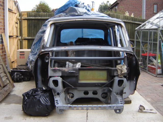

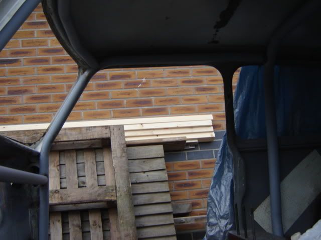

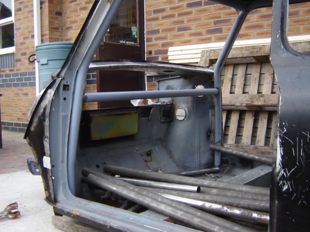

here are a few pictures of the cage going in.
im glad a got my tube notcher bit its still quite difficult to get the angle right!
and the bash brace ended up a bit higher than i would have had it as the tube didnt have much length to play with, but it worked out ok at it puts my steering wheel at a good angle!

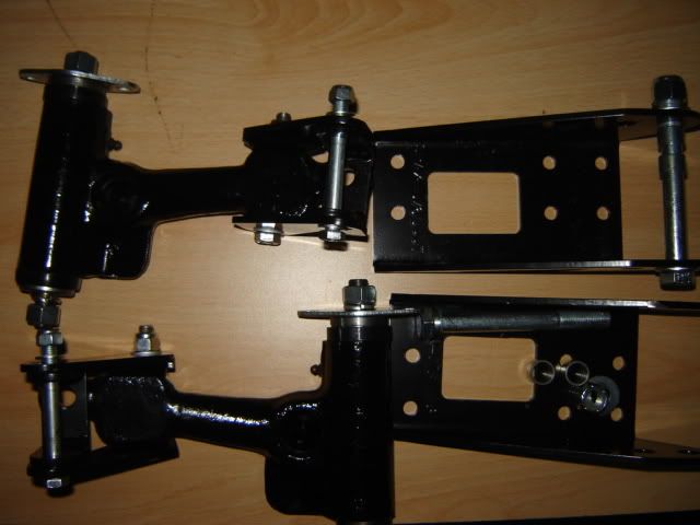

yes rob they are one off, there steel tube with a threaded insert welded in each end and the weld turned off then a set of left and right handed rose joints in each.
ive still got to make some brackets but im not quite sure where im putting them yet.
