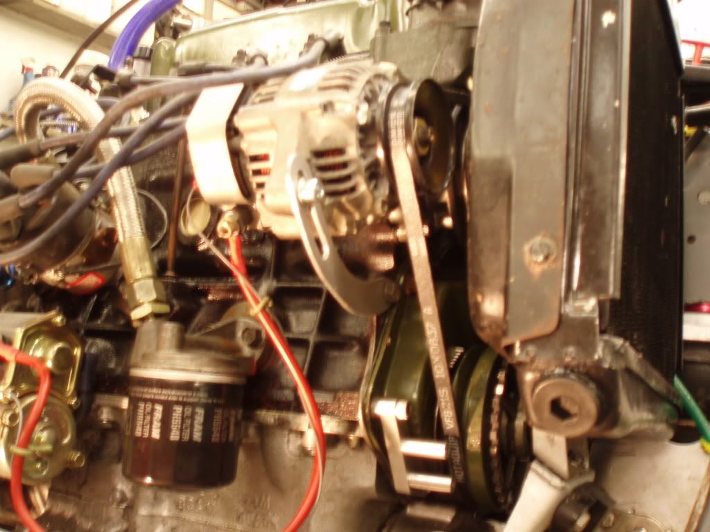

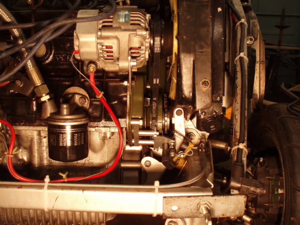

drove to douglas to get a fanbelt, got back tot he garage went to put it on, and the fella has mixed up the part number with the length i had asked for and given my one far far too short, so went back, (about a hours round trip....groan) and got the right one
with mattys nippon denso master, a 837mm belt is perfect, you can only just get it on so keeps the alt right in near the block, motoquip part no 215 if that helps anyone.
also got the fan belt/engine mount clearance sorted, as per the other thread managed to tilt the bracket over a bit to give an extra 2 or 3mm, happy with it now

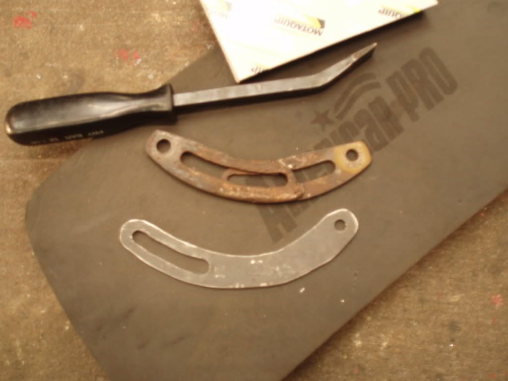

also made up a new alternator slide as my old one was an abortion
so using my best cave man skills, i crafted another out of 3mm steel, then sprayed it with alloy wheel silver to make it look lighter haha

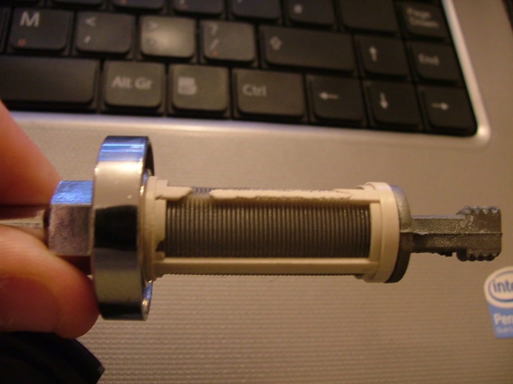

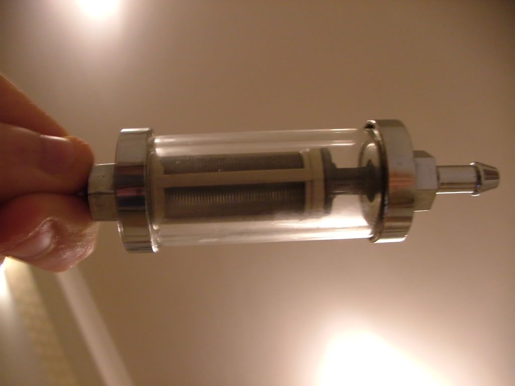

Joey heres the pic of my filter.. at the angle on the car it all looked ok. It wasn't so ok when I opened it up
shit, forgot to check, def will do tom!

Ive got one of those fuel filters. I had it unsrew itself once and wondered why i was getting really low MPG and a strong smell of fuel.
mines in the bin.
mine was alright as it happens?
looked to be made of a nylon though and the cage was transparent rather than white? think the quality must vary from supplier to supplier??

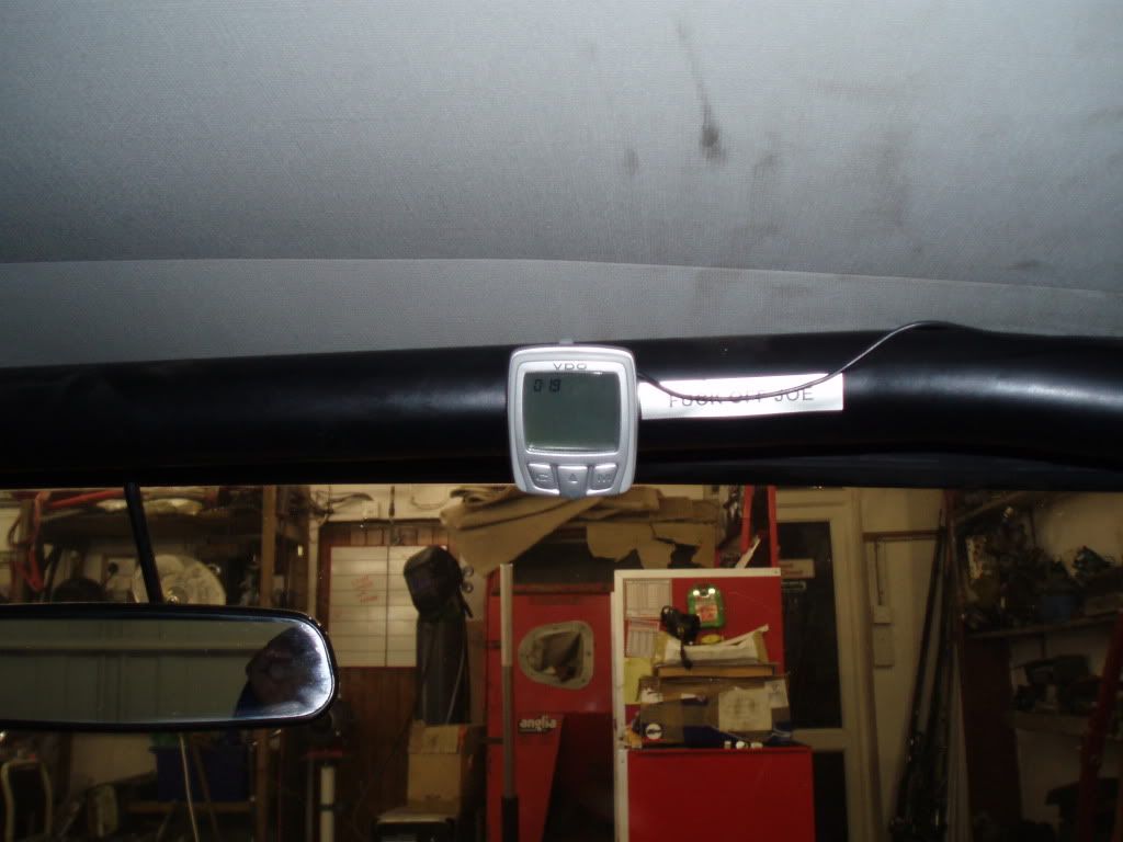

tom, found those pics of the cv magnet speedo do dar you were after bud:
