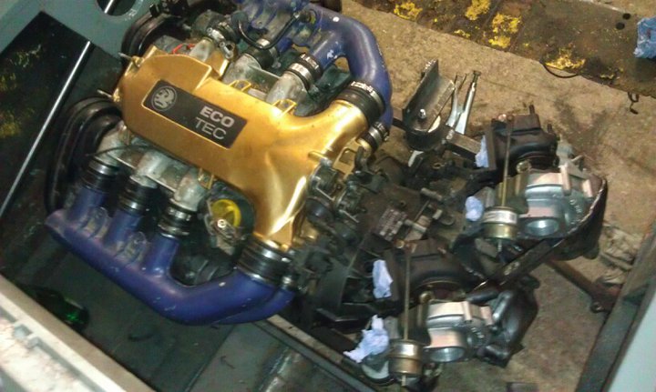

Also fabricated a new heelboard out of box section and did drop links downwards so we have a nice area for the rear /front subframe to push on.
Then got the V6 and F25 (should take the higher torque, if not we will shot peen the gears like the noble chaps do and thatll sort it) mounted in a front subframe, did some mods, still need to make engine mounts up, then thats that!
first fit..........ish
Cabin bar in will be seam welded but solid for the minute,
last night we sorted the front and rear engine mounted
in no specific order............
And its level!!
Turbo's should be coming tonight,
and the ECU in a few weeks,
Al made a Gantt chart and it seems were right on track,

4310 Posts
what engine is that, that turbo looks large too.
That should seriously shift.
Looks a really nice project! Good skills!
your right that turbo is a little large.........
Got two smaller ones instead...

what sort of figues are you expecting? ready for avon??

about 370-380 @ 1 bar dependant on cooling efficiency. Should be good for 1.4 bar on these turbos though, so if we beef up the rods we should be able to wind it round to 500bhp realms. Probably run it at about 0.6 for a while to bed things in and problem solve before the 1bar+ antics though, then have another map read for santapod *wink*

yer, subframes fully done now, so its moving on well, should be on its wheels again soon then we can start joining everything up with wire and tubes! Bit slow over the last week and I needed to make some progress with my own car, and arrons on holiday, so I didnt put many hours into it, not too fun working on someone elses car when theyre not there to entertain with stupidity

got the front mounts done for the rear subframe. Cant get the rear ones done until the hoop is in, also got all the bracing done on the back end.
dropped the V6 back in, subframe lines up perfectly! so chuffed!
from the bottom, didnt even oval out the holes, measure twice cut once *wink*
from the top
