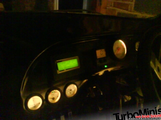

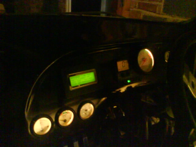

Urm well im now running a photocell sensor with a trigger wheel running off the original speedo cable. Ive got to buy a new cable as mine snapped, but should start making the housing etc next week. It should sit quite neatly behind the dash and should be quite light too as the trigger wheel can be made of plastic. *wink*
Wired the dash in today, all the pissing about has finally been worth it. *happy* I decided to polish it up for now instead of flock it.
very very nice!
i think that as soon as there is abit of sun it will be coming out to get flocked...especially as its polished *tongue*
or you could just whip out the good old aviators!!!
I think you could be right about the glare off it! Im hoping the polishing is only a temperary measure but you know how it goes, the job gets put off and put off and before you know it, its been like it for years! *hehe!*

Looking good that Matty. I think I'm definitely gonna go for one of those dash's. I fancy blue flocking for mine though.

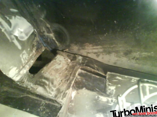

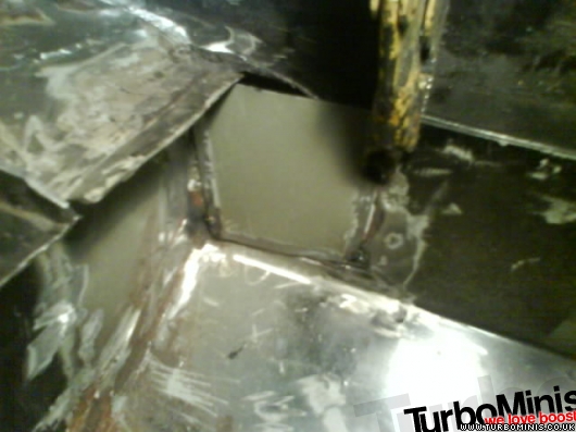

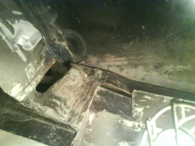

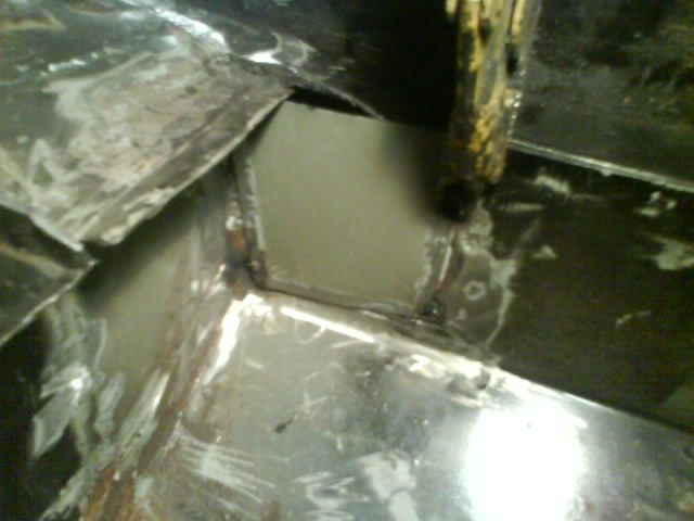

Made a bit more progress with cuting the rust out and welding plates back in.

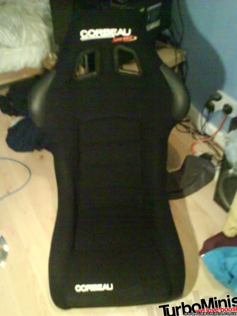

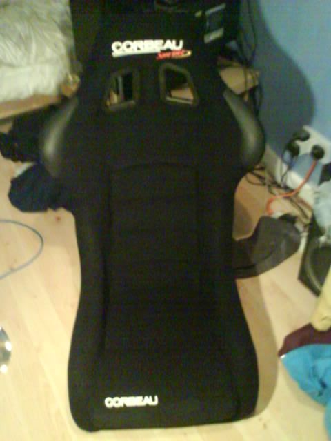

My new seats arrived last week! :)

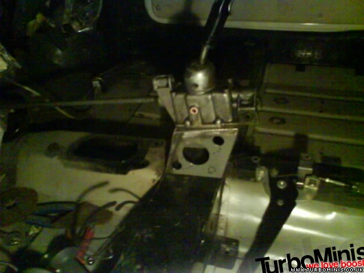

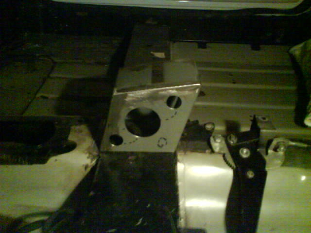

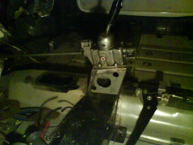

And made a start on my internal gear linkage.

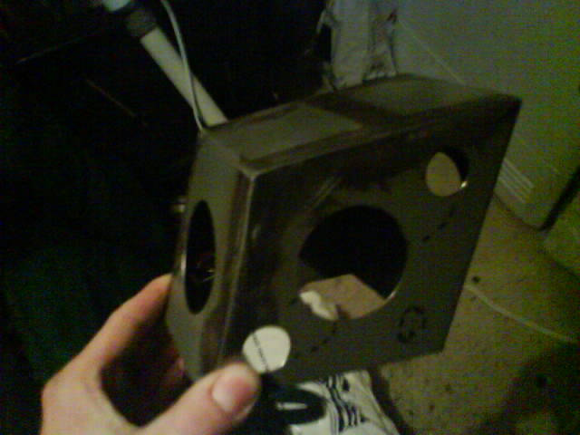

This is my unfinished doodah
Edit: I tidied up the work bench after taking this pic
Edited by Nic on 10th Dec, 2008.
what are you going to do with the hand brake?
hario
444 Posts
Member #: 2885
Make a braket to tilt it backwards to clear the stick?
On 10th Dec, 2008 Nic said:
Holy cow, thats putting my anti-progress to shame
Ah im in the middle of making the twin of that linkage, I recon a few holes could also be drilled! :) That bench was like that last time I was over! *hehe!*
Handbrake is staying where it is, will just be vertical for easy access! :)
Edited by matty on 10th Dec, 2008.
Im thinking that too
I think the bench has been tidied a few times but it always ends up looking shite within a couple of hours.
The cylinder head is now im my bedroom, lots of tins put back on the shelf, and even more thrown away. I also re-tuned the wireless
Ah just noticed your gear stick hasn't got the damper on it! I think im gonna chop it off and replace the stick with a bit of ally tube? *oh well*
I never realised but the gearstick is 2 piece. If you get that damper apart then the stick will separate

I would not use ally on the gearstick! It ill bend during a track day or something when you are not to kind with it.
The damper doesnt do much, keep it for the time being, and replace the whole stick if needed later.

ha looks like every one is going for the same type of internal linkage, my housing is looking simular to nics.
dash looks awsome, im just looking at getting mine flocked so i will let you know how it goes.

Re: Welding that patch infront of the rear arch, how did you tidy it underneath? i did the same last week and found the subframe was in the way! Had to just spray redoxide in as far as i could :(
Re: Handbreak sticking up vertically..

the handbrake's effectiveness will be much worse with it sticking up like that. I tried, but the radius of movement on it makes it less effective. you have to move it much longer to do the same thing as you did by lifting it a click or two when it was horizontal
Trigger hand brake lever perhaps?
iain
8506 Posts
Member #: 16
Near Lincoln
just shorten the cable and move it back?
Yeah still interested in prices, it would be good to have ball park figure.
..Wikedd!
Im having to do the same thing. *oh well* Will be fitting a beam next year so will get a good coat of paint on it then. Not sure if there is another way round it. TBH
Ah didn't think of that good point, back to the drawing board, I really want it mounted verticall now as the positioning is perfect for holding on the handbrake!
