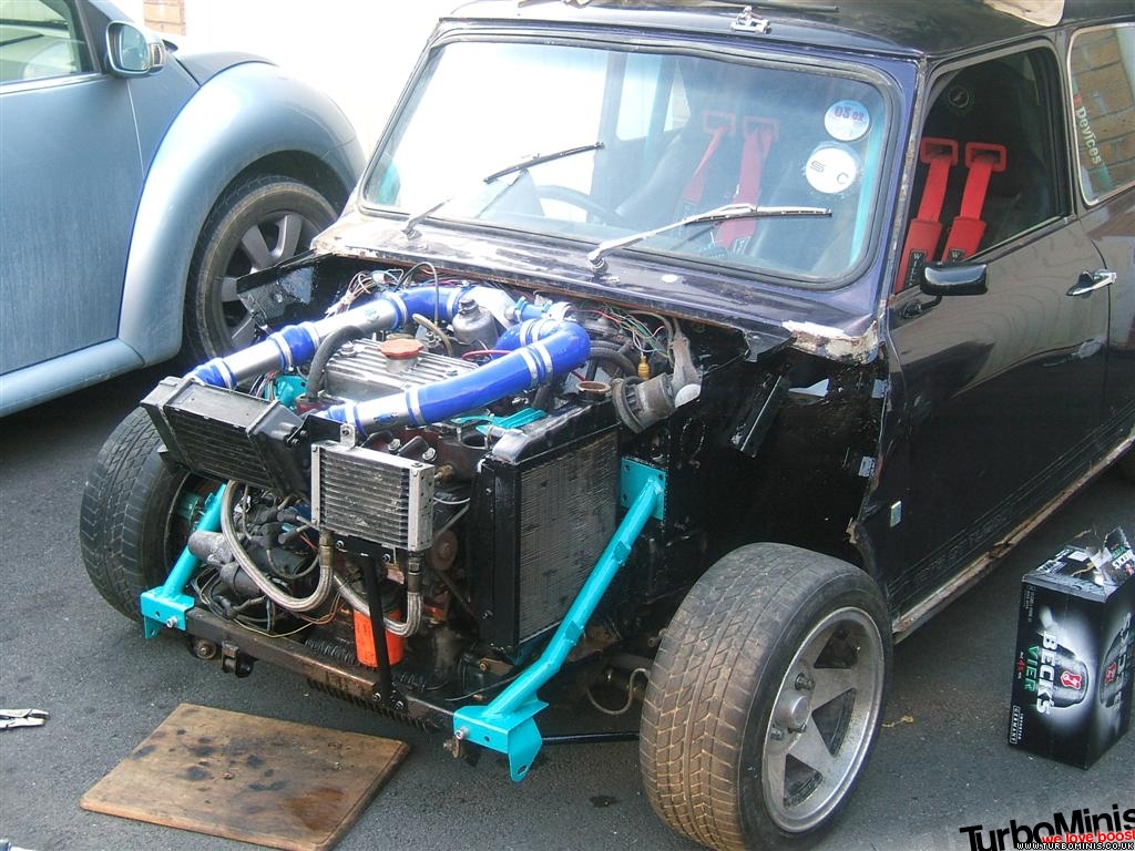

She's back on all 4's chaps :d
Looking better already
Welded a trailer plug mount onto the bracebar for my light socket
Engines new home for a while (anybody else thinking the same? *tongue*)
Tomorow it's looking at linning the front end up, once thats lined up I can get welding the tabs on for mounting the front end. Then all the innerwings and A Panels can be stoneshipped and painted. It's getting there...
