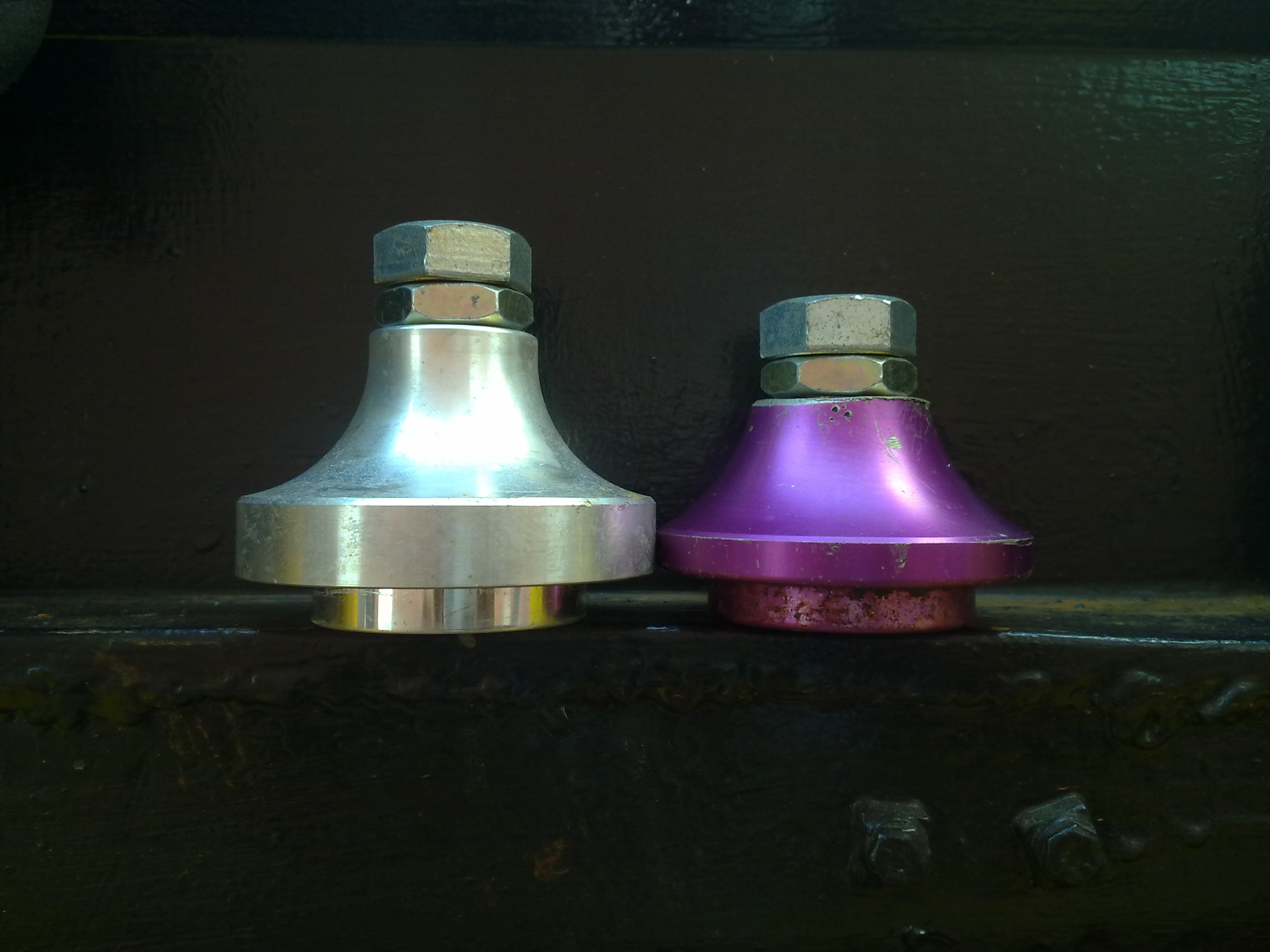

dash is 90% ill update later with pics, going to change the front hi/lo today for some i have modified, i have took half inch of them, that should be enough to get it lower :)
well swapped these out this morning, new silver out, old modded purple ones in, no pics of before and after though i can almost set it onto the bump stops so i think its about enough
the 10x6 wellers stick out half inch less that the 13x7 on it so atleast its in the ball park

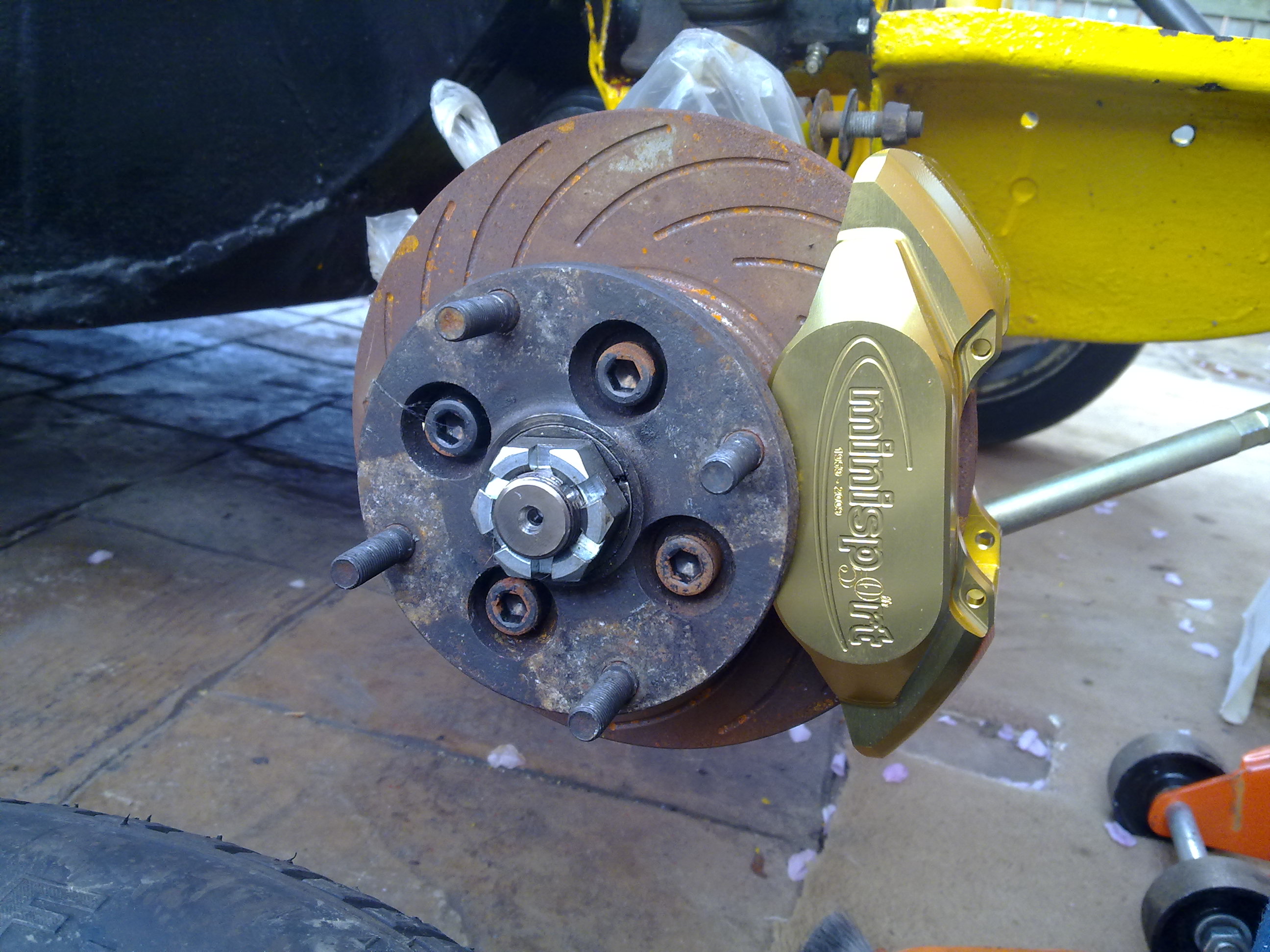

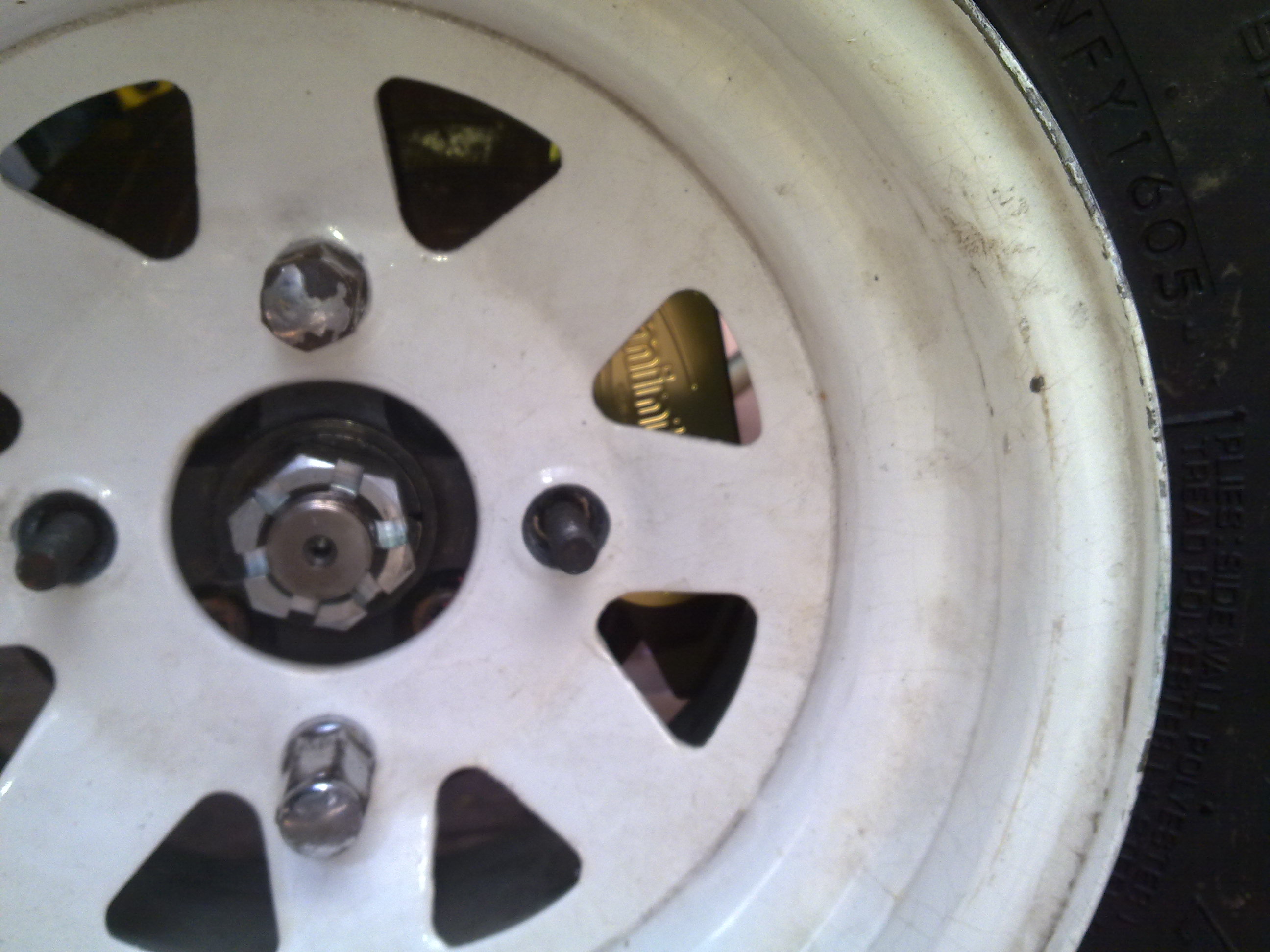

test fitted by callipers for the first time, discs are rather rusty, it brushes off easy so not worried, the discs on the wrong side though imo, ill sort that

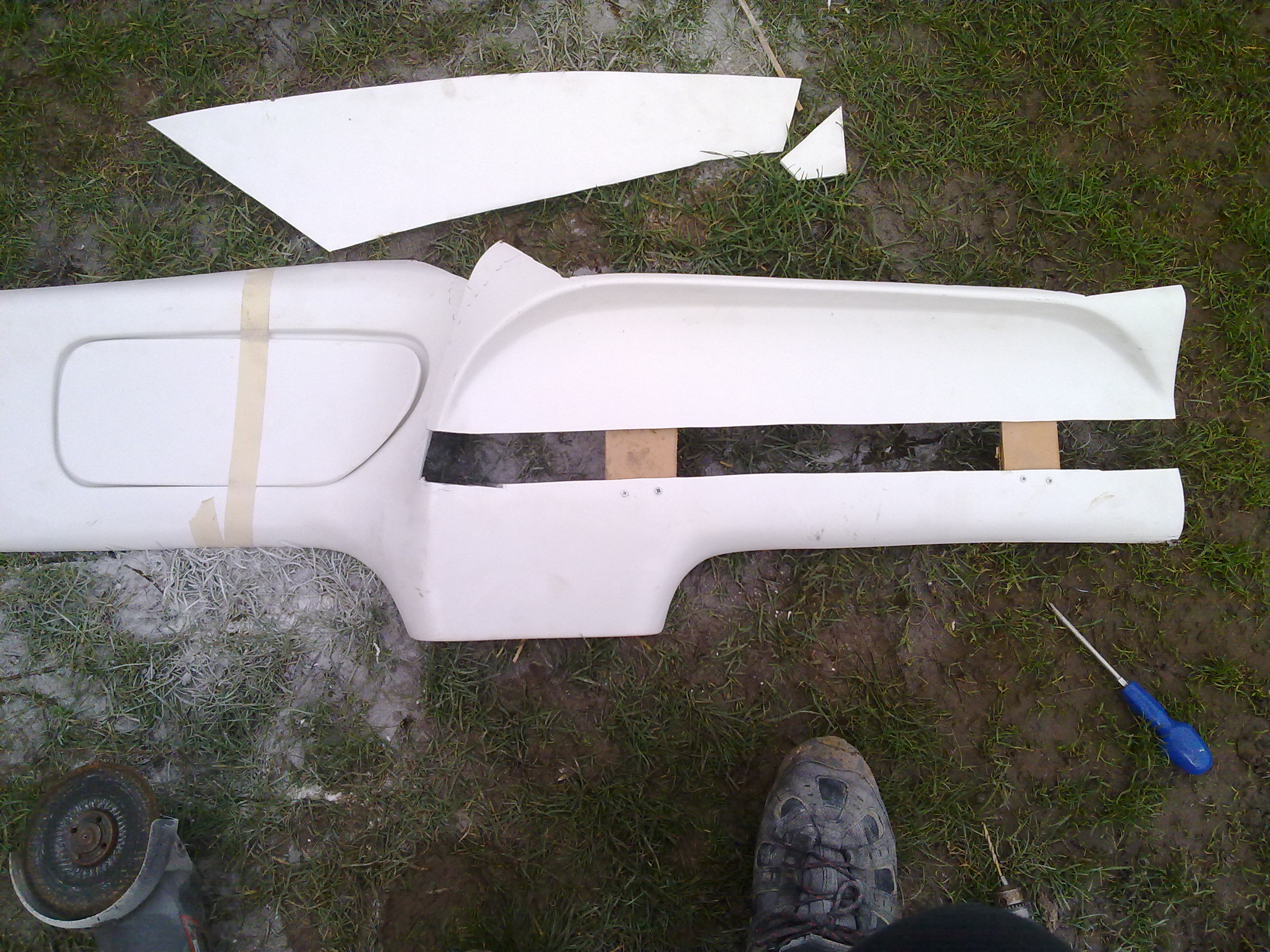

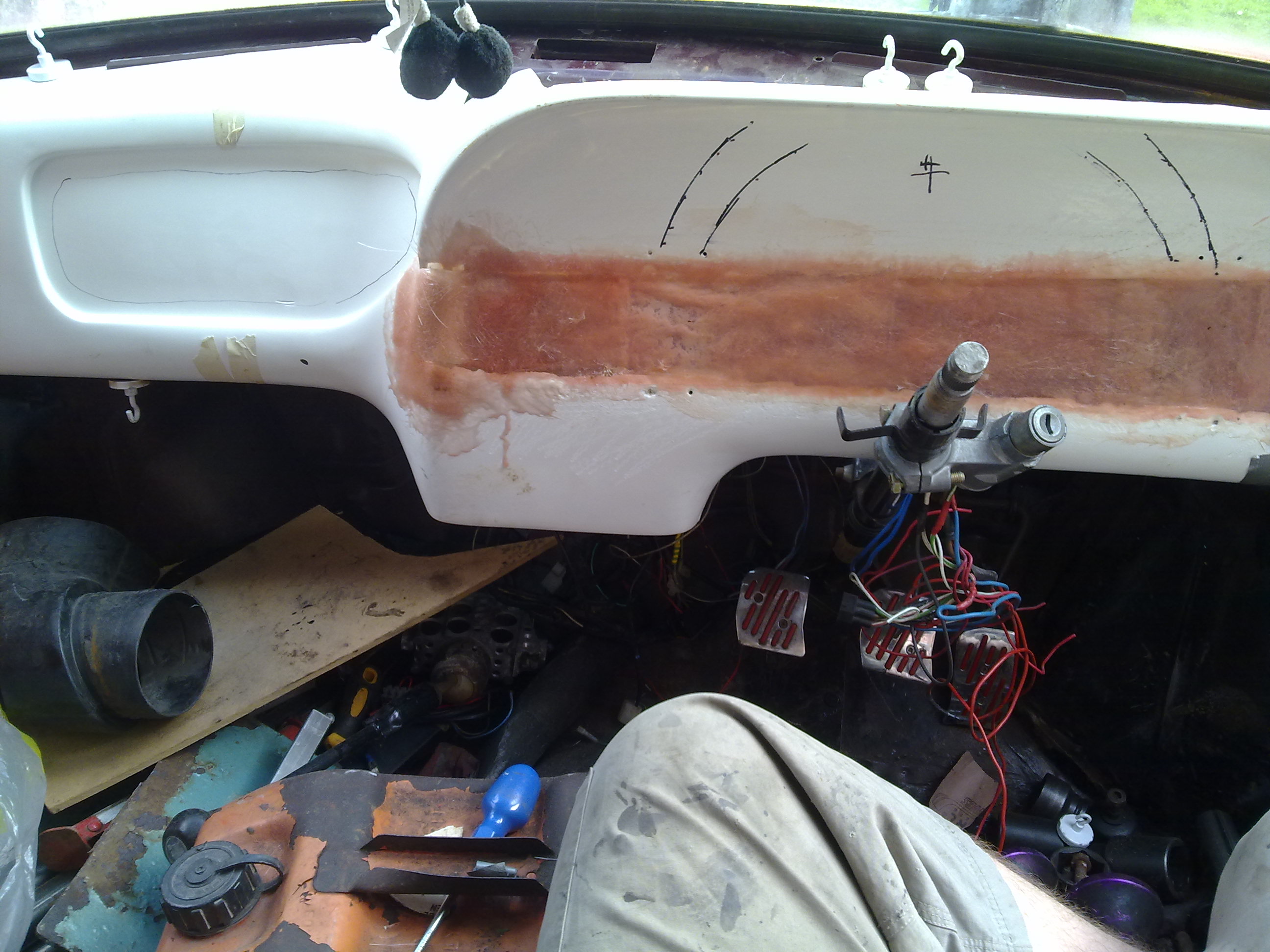

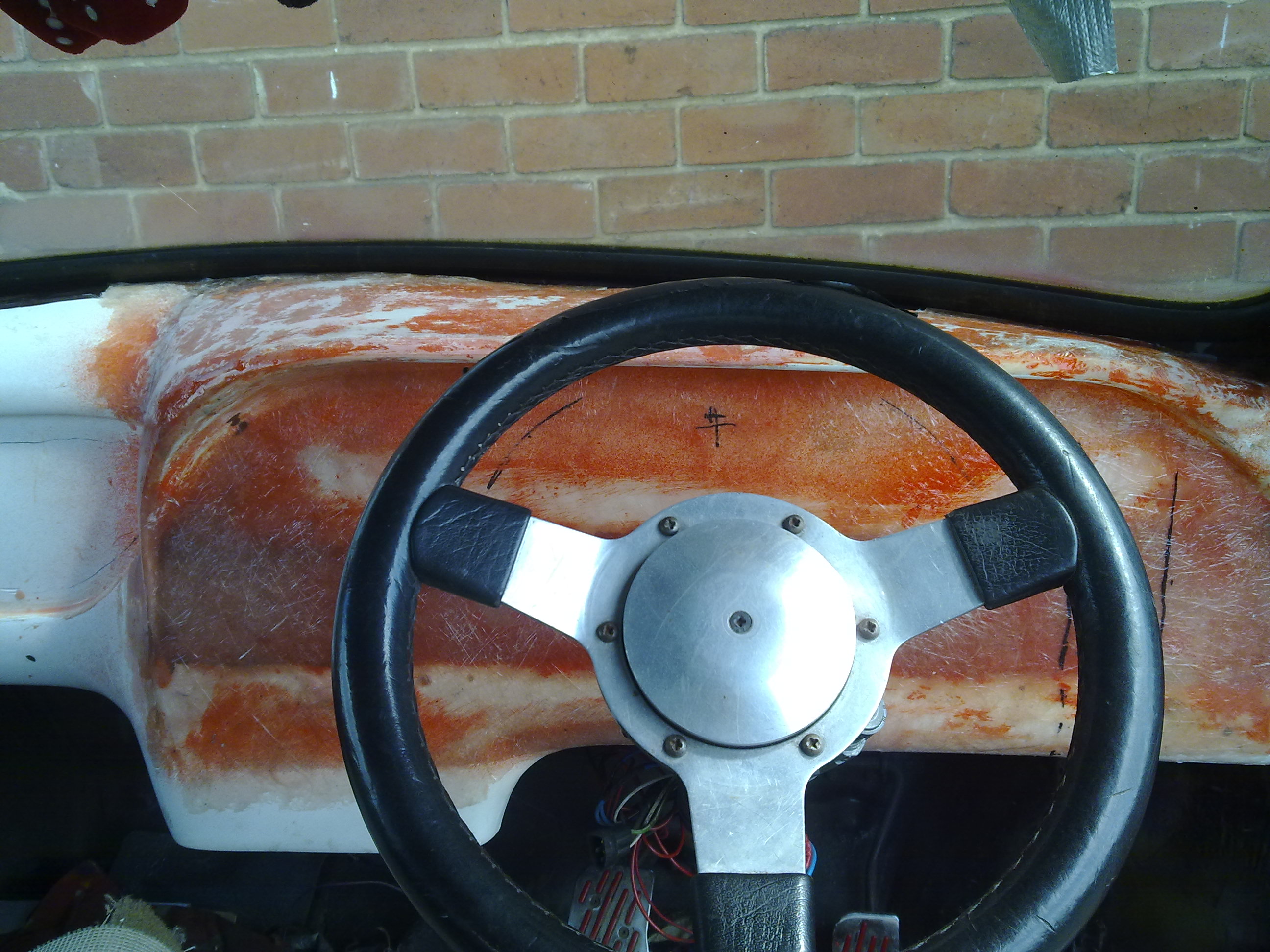

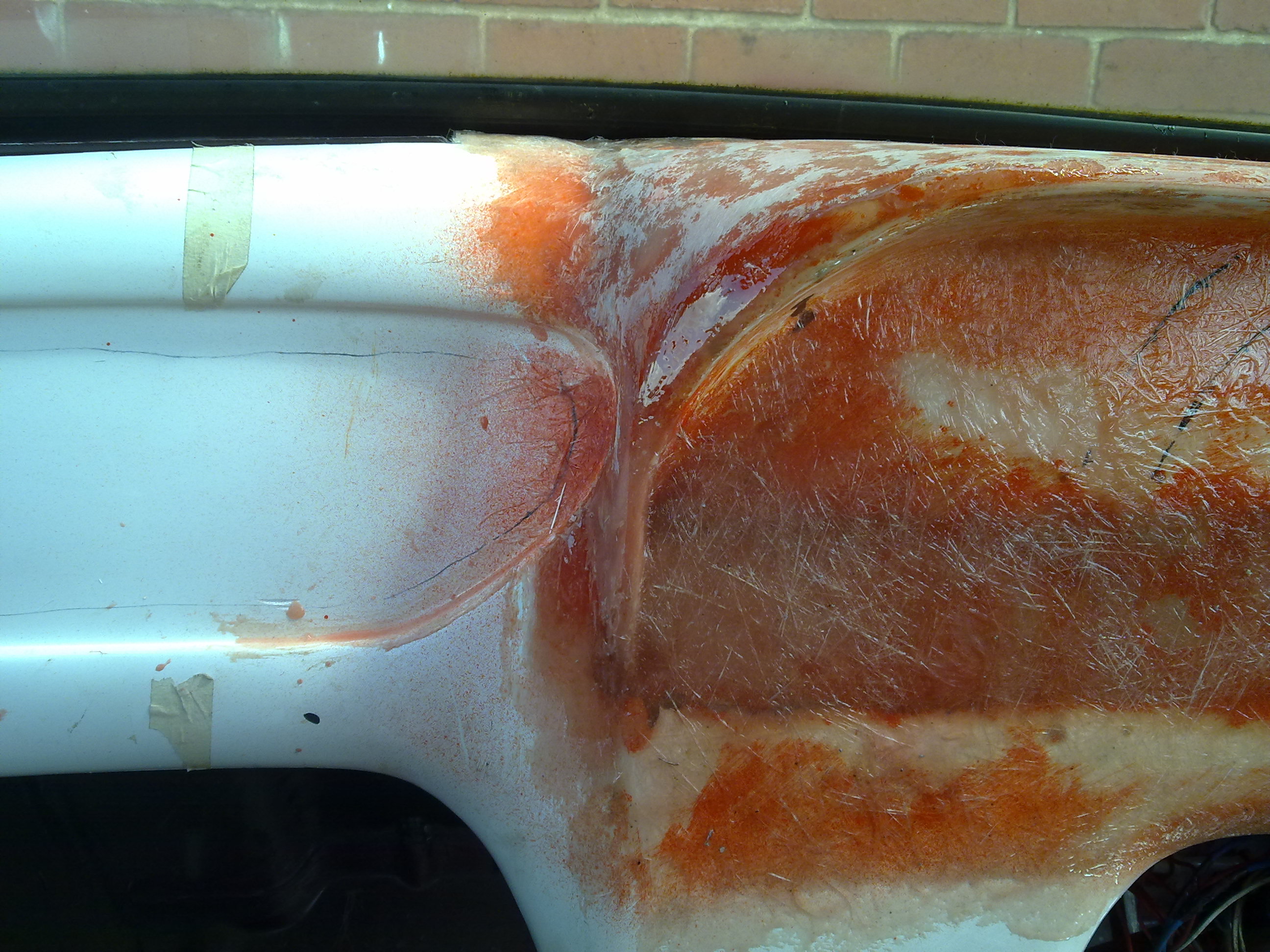

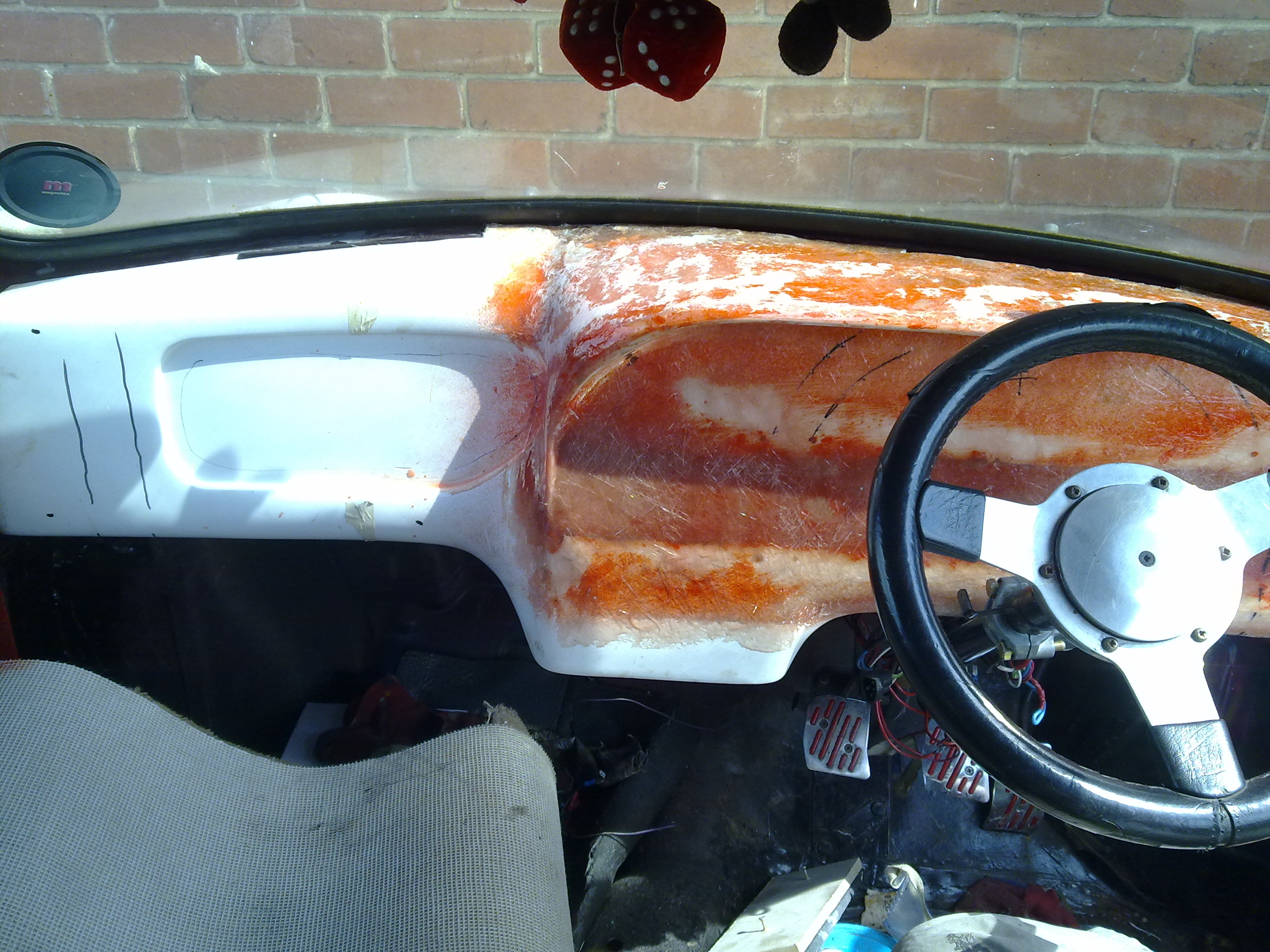

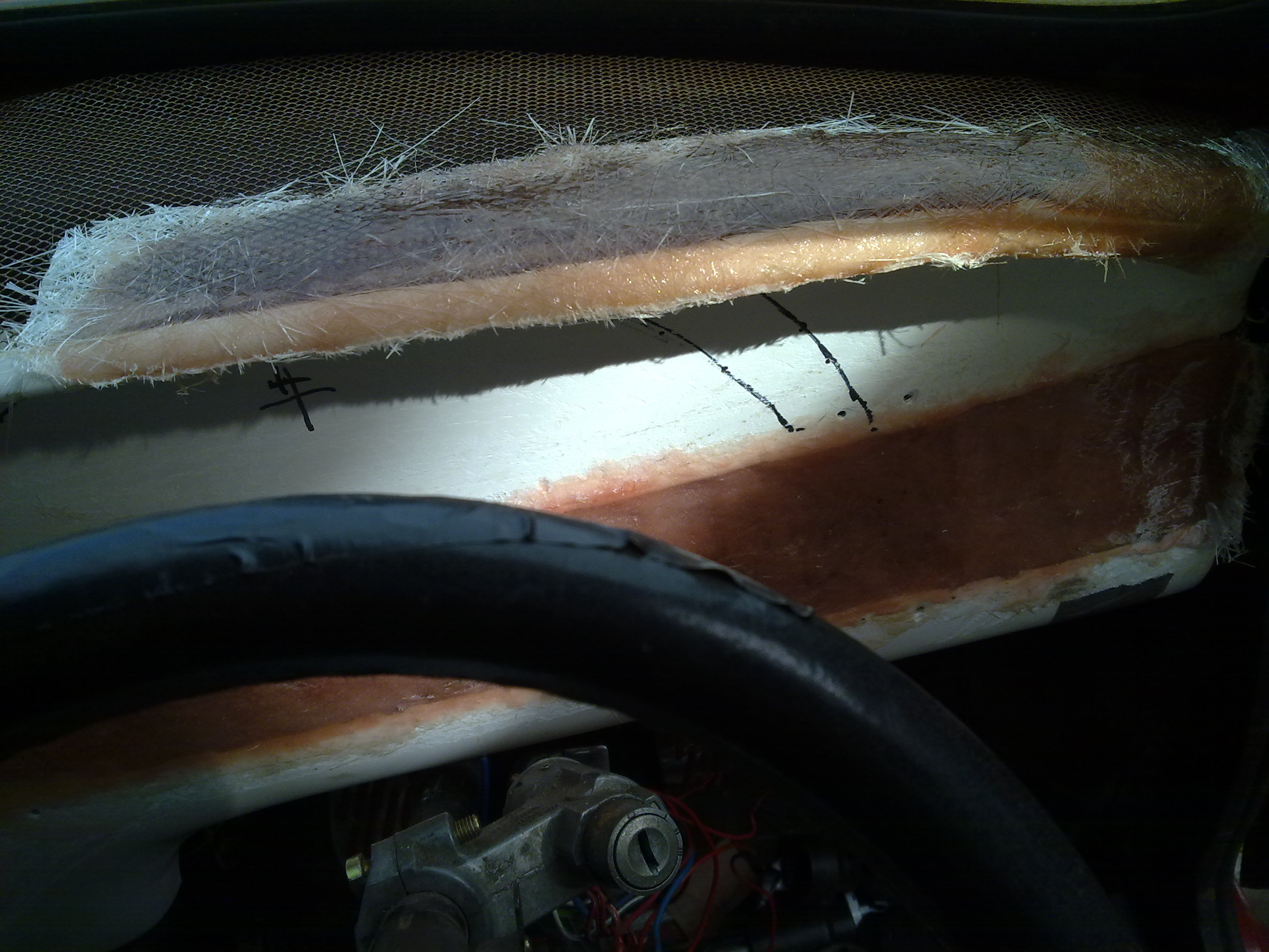

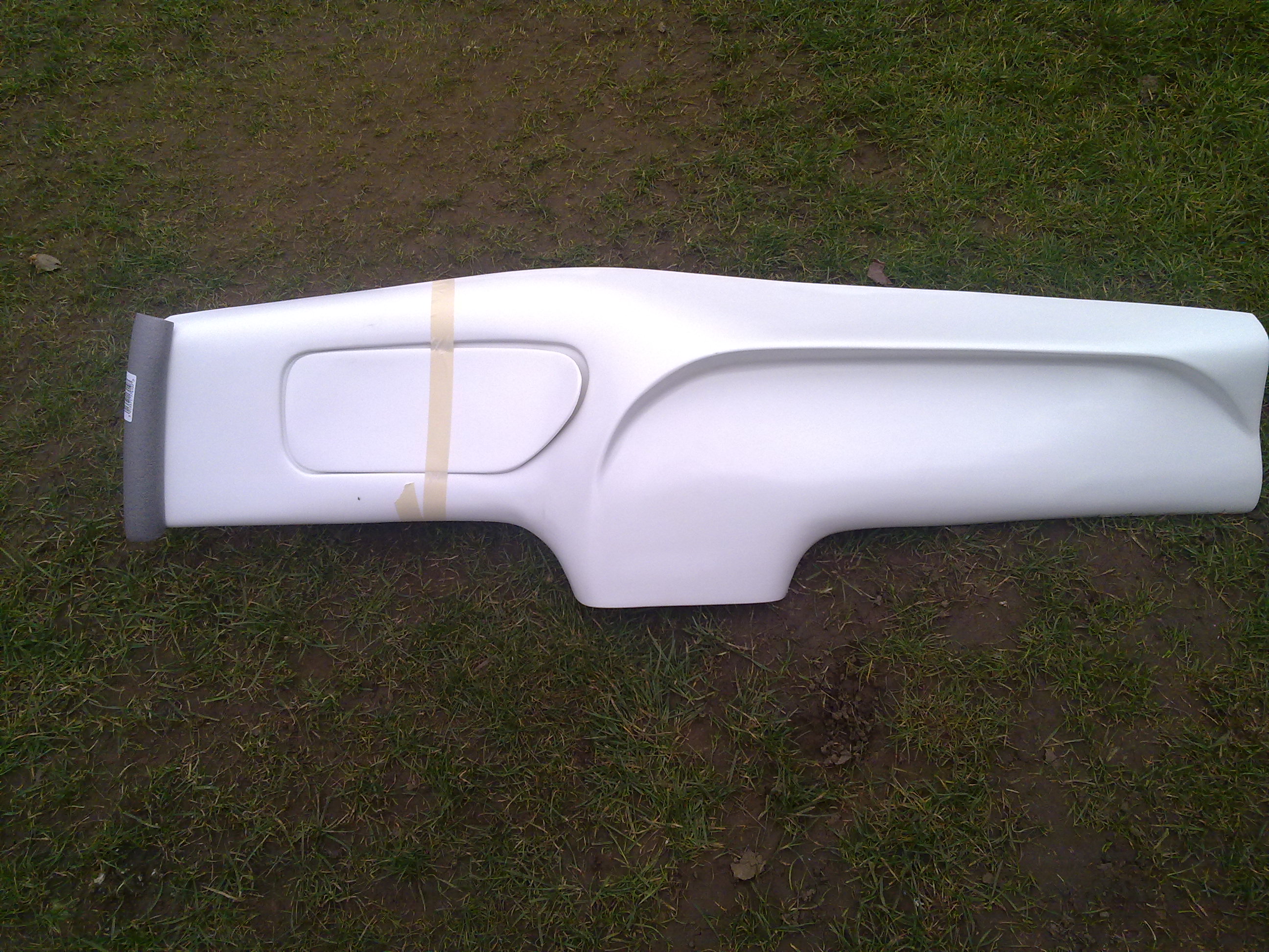

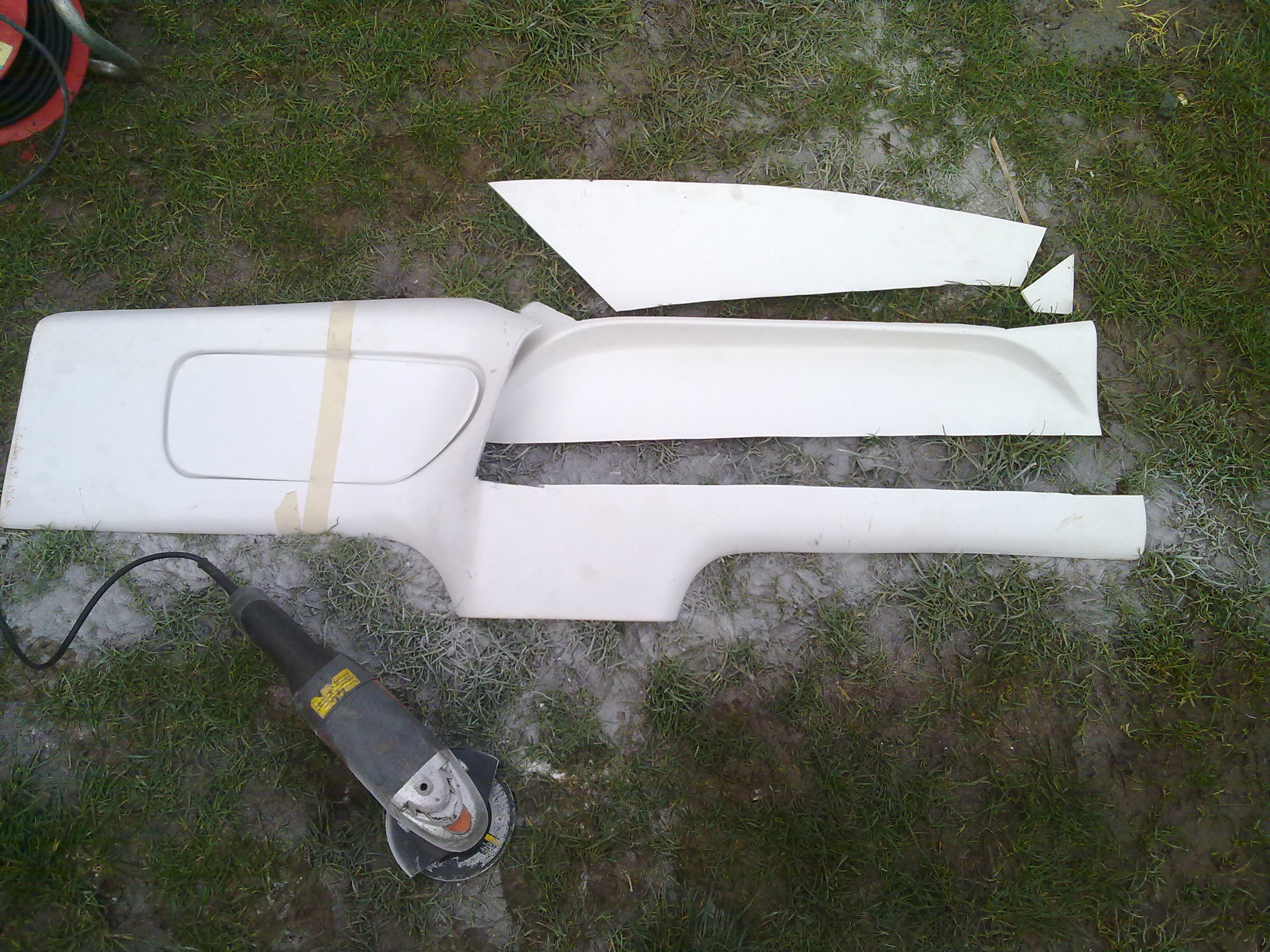

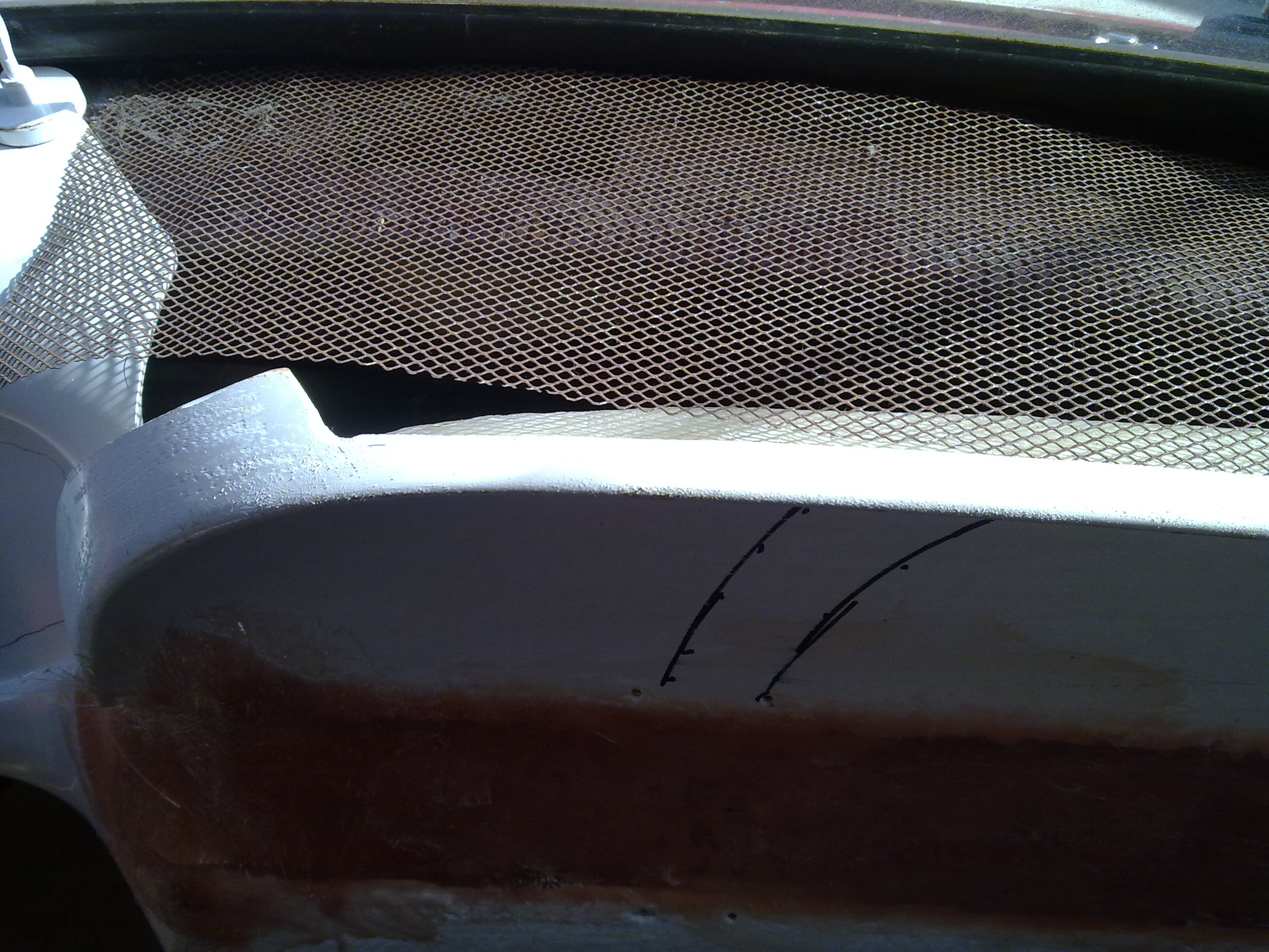

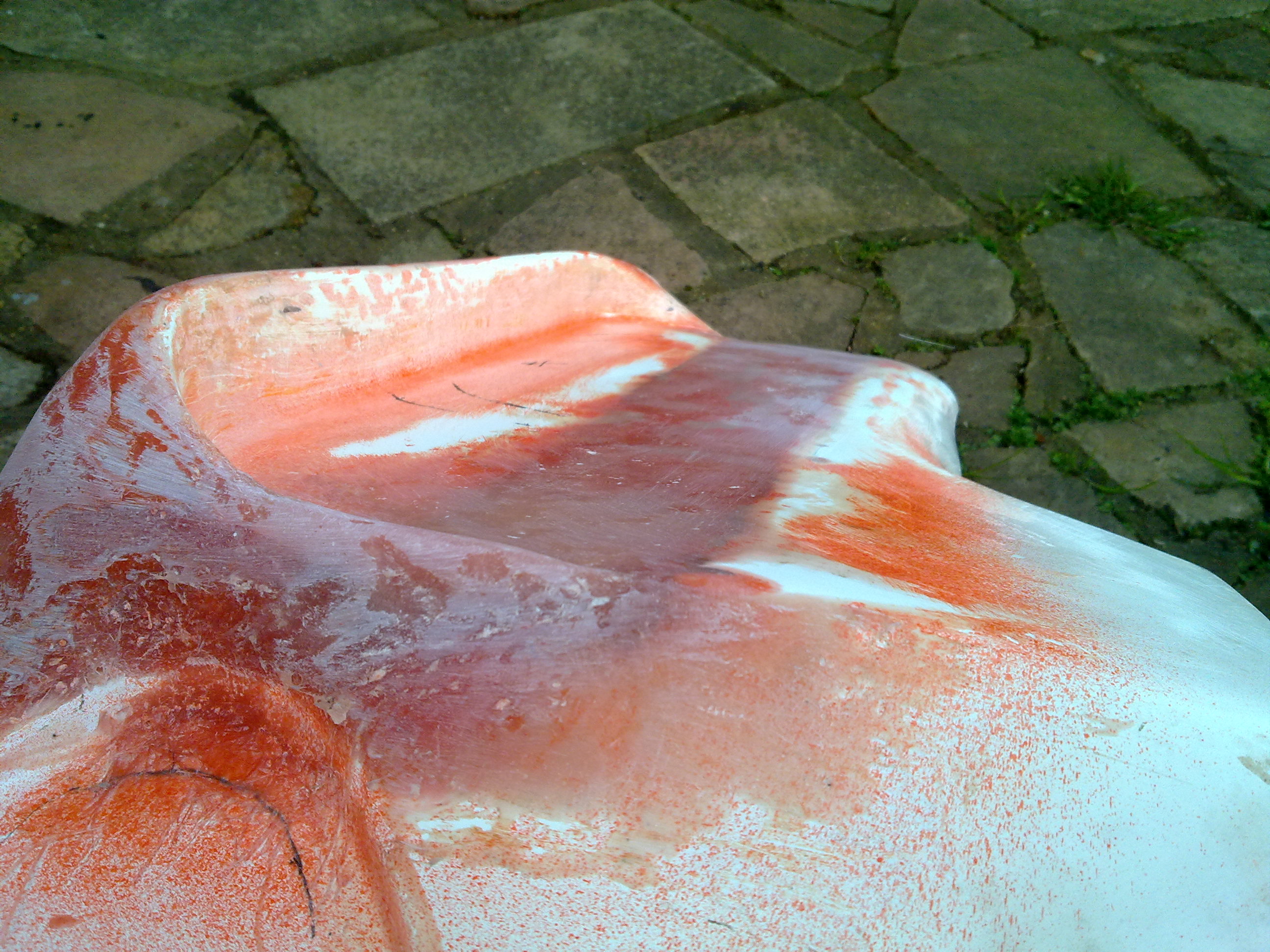

dash in stages
and at present, front needs rubbing down again top right needs glassing again and i can start smoothing it off for paint, im happy with the fit now and concentrating on getting it extremely smooth*happy*
Smooth as a cashmere codpiece?

i just had to do the same to my trumpets, if you weld a 10mm cap head to the top of the threaded part that runs through the alloy part, you can then chop off everything below the locknut. downside is you need to ajust with a very long 10mm hex bar through the tower bolt. but gains you a much shorter hi-lo :)
this is all cause i raised my top arm 2" in the frame though lol
Denis O'Brien.
cheers rich
i wanted to take a full inch off the cone but it left very few if any threads left, i might have to do that if its still not enough, i hope so the top ball joints are getting quite an angle on them at rest now

Brett - get yourself some gelcoat. To get the dash really flat and smooth after you have finished with the fg you can poor and paint it on and it self levels. you should only need a thin coat and its very easy to sand to get it ready for paint / covering.

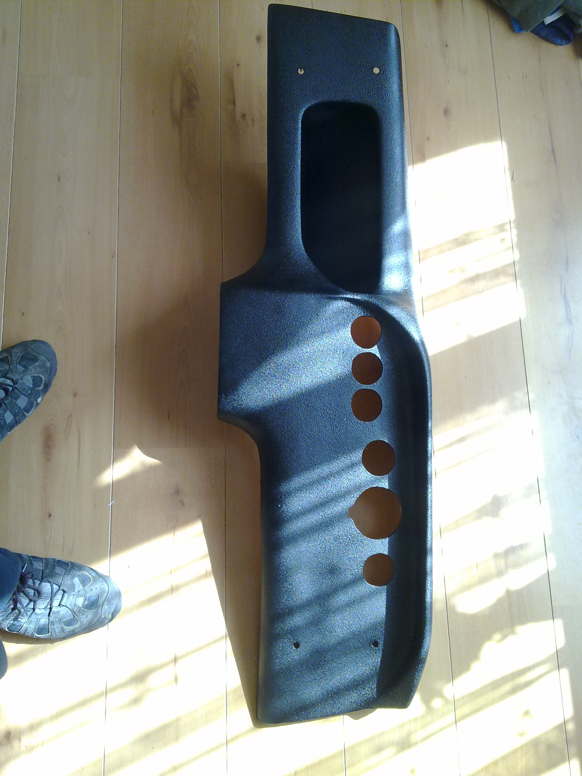

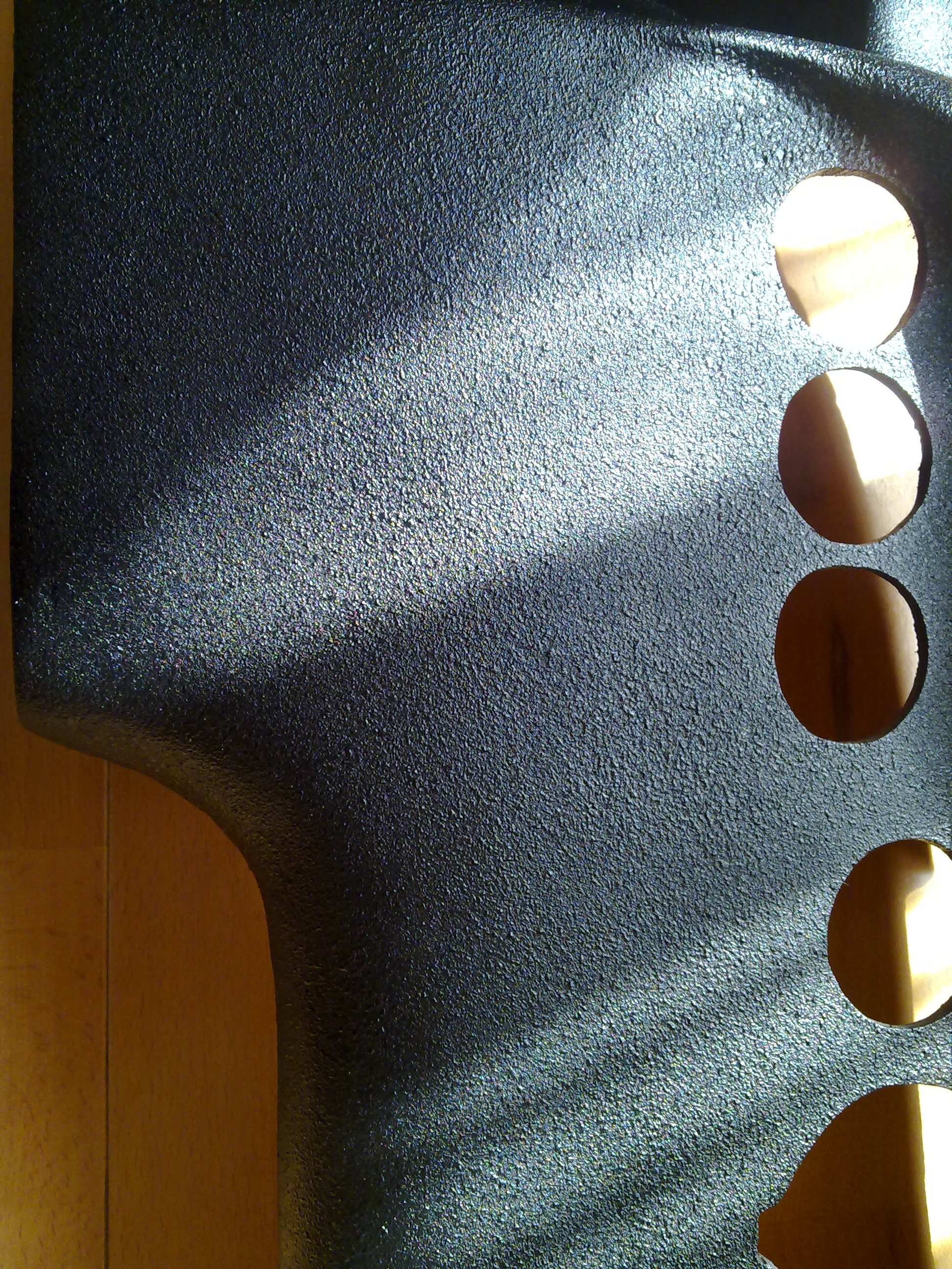

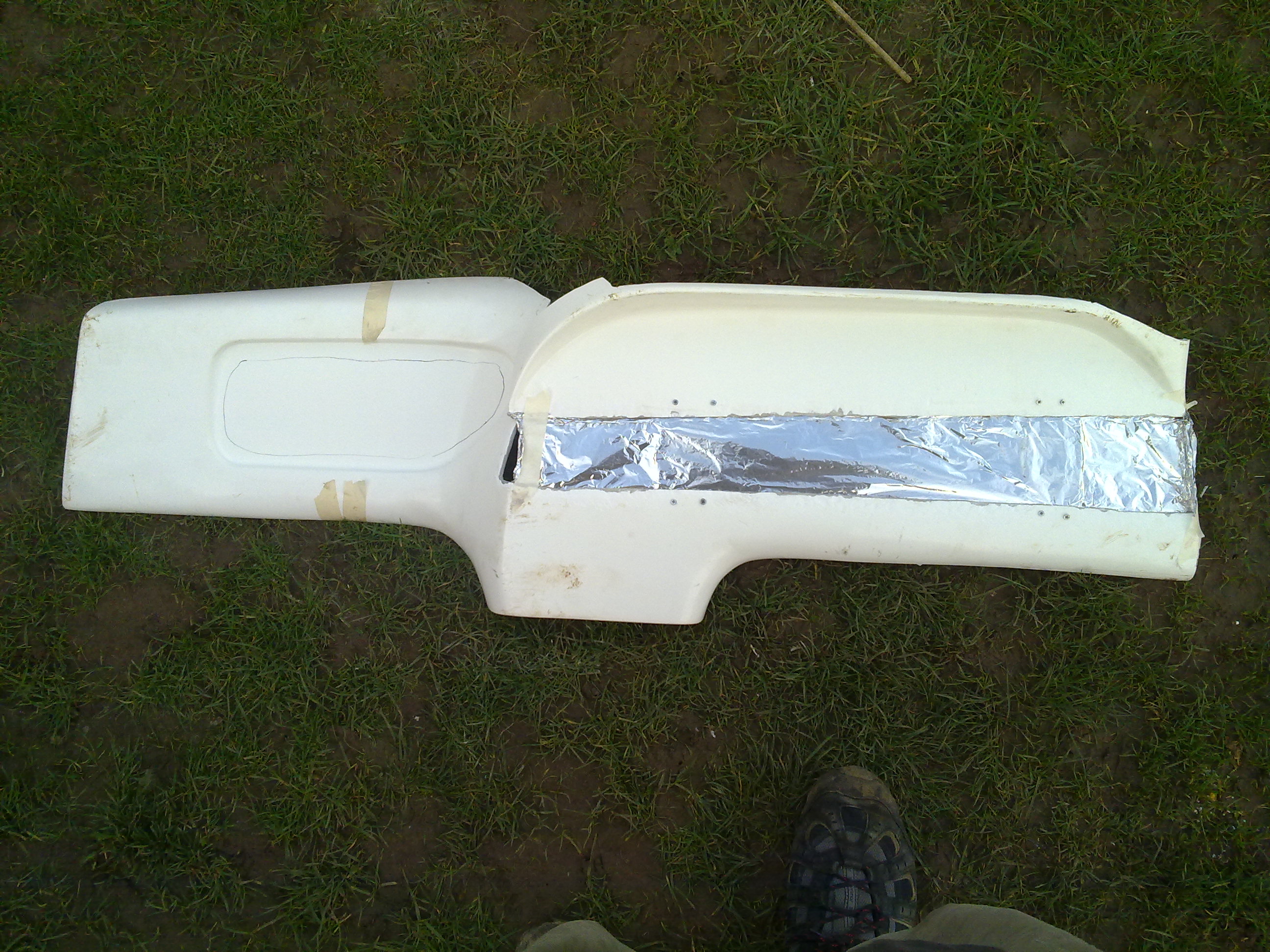

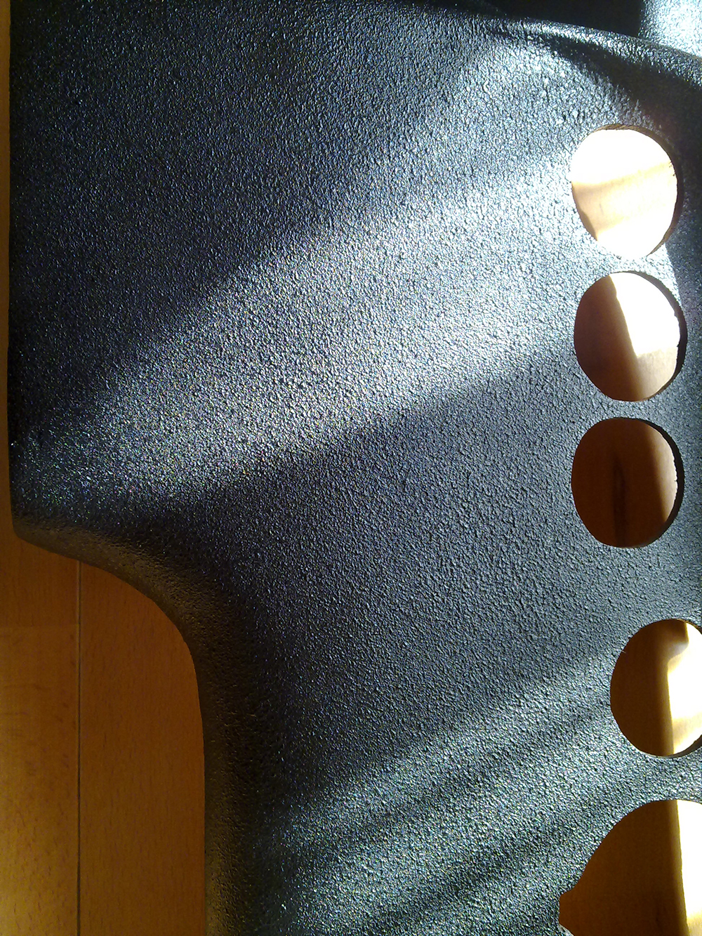

well after about 10 hours of sanding and filling the dash was looking spot on, but looking very plane, i decided to use some textured paint :) i like it, what do you guys think?
Edited by Brett on 16th May, 2010.
I think a picture would help *wink*
EDIT: Must have been too quick. Looks Prety good.
Edited by apbellamy on 16th May, 2010.
