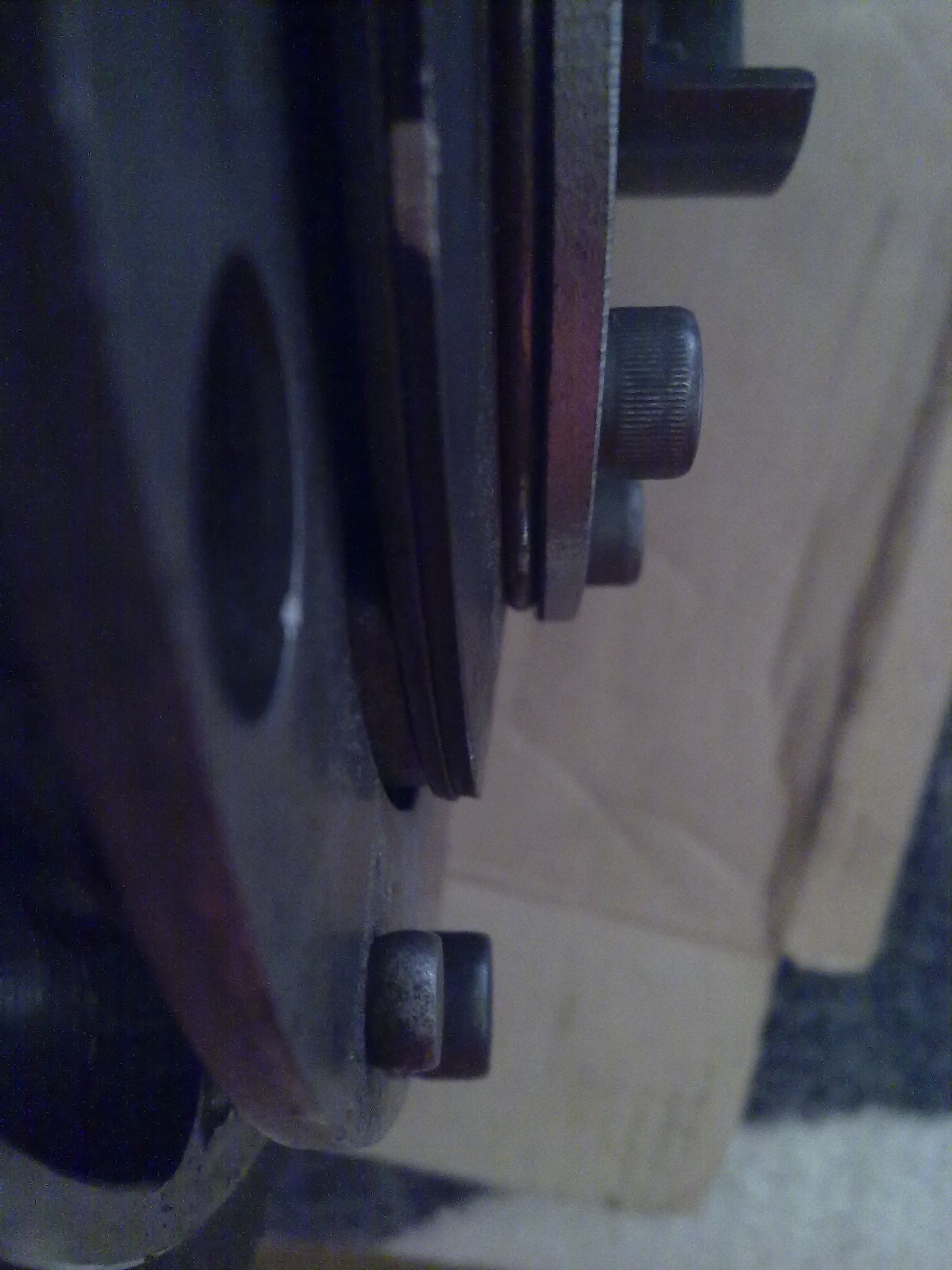

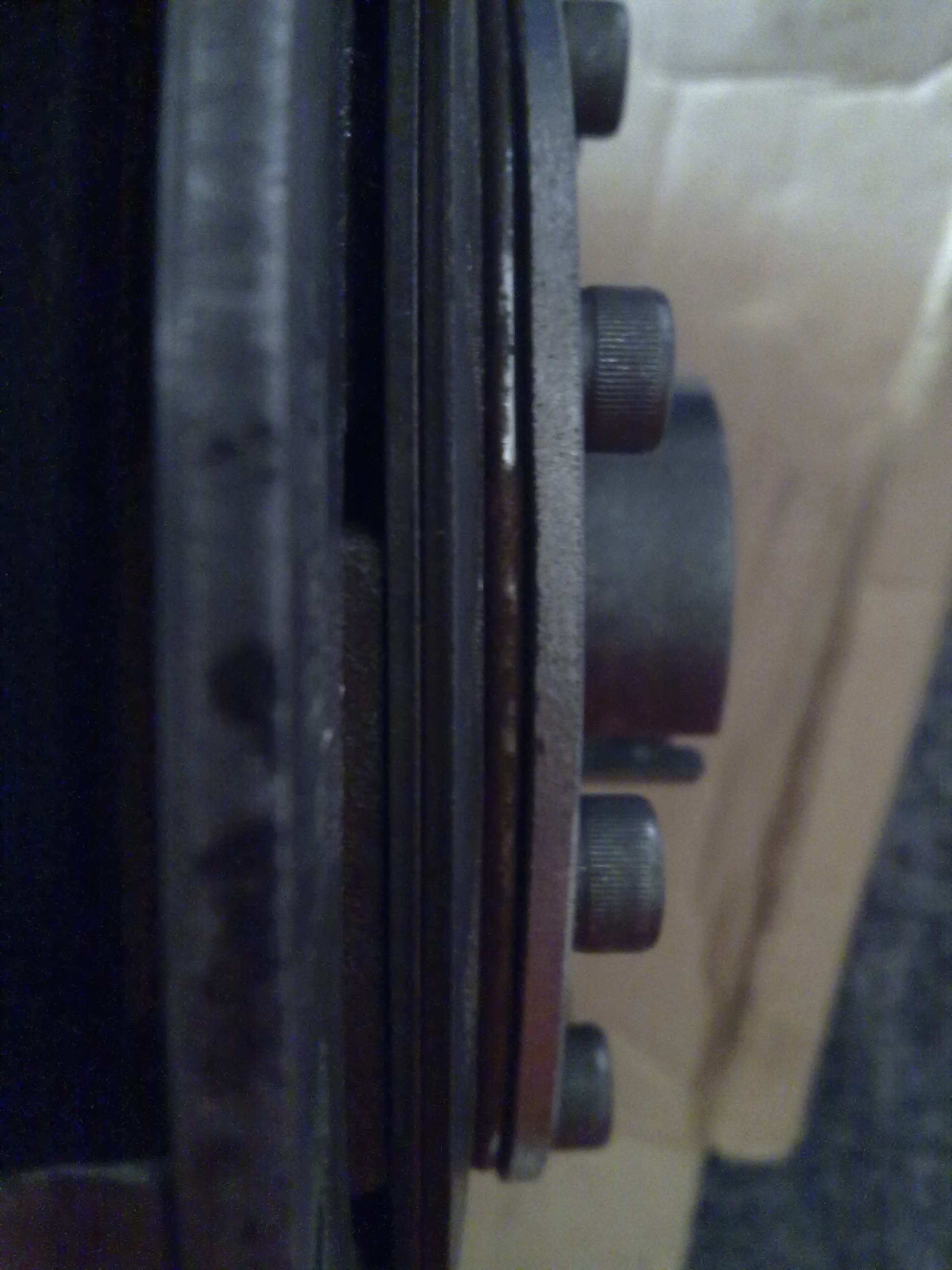

could one of you guys confirm i have built mine correctly please *happy*
i have built based on a valeo in order i have
stainless pivot ring
spring
spring
spacer plate
i have built it all up and i am able to pop it over centre but it takes alot of effort as if something is binding it takes more than double the pressure to pop it over than each spring on its own
after building it up to the flywheel ( minispares light weight) with a 7.4mm thick used verto clutch plate( i believe the pre verto plates are 7.5 thick new?)
and the spring is quite far off being flat
any help appreciated cheers :)
Any pics? The order of assembly is right.

cheers for the pics, i will just go bolt it to my flywheel and grab a couple
Edited by Brett on 7th Jun, 2010.
pics
Well that looks right from that angle, can you grab a pic from the front face?
