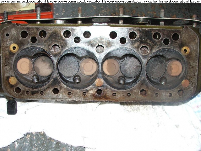

The only thing I will add to this debate is that, with my 1400 Spi using the factory injection manifold (apparently shit), factory ECU, and 10.5:1 compression, giving at that time 90hp, ALL exhaust valves were the same colour.
So what you might exclaim. What you have to consider is what this is telling you. Its the same as reading spark plugs, and that, is the oldest way to really understand what is going on inside the combustion chamber, outside of all this funky electronic data logging.
The easiest way to compare the cylinders, is to do a plug run. Run the engine up to the load point you wish to look at, hold it there, then imediately shut the engine off, pull the plugs and read them.

If John has read the plugs or lifted the head or whatever else to validate the AFR then it hasn't been presented even in qualitative way. What has been offered is EGT which has been proven with measurements from two independent sources to be irrelevant to establish AFR and fuel distribution.
So no one can say if he's 90% there (whatever that means) or 50% or 99%. From measurements with data available on this forum, it is possible to have an engine that will run quite nicely at an AFR mismatch much worse than what you mention above.
So is it so strange to ask for relevant data from someone who should be able to provide it easily? And is it a good thing for 2 members of this forum (Paul and Rod) who have done a lot of work and presented there results here to basically be called shit stirrers because the point out the wrong conclusion and ask for more relevant data? (Unless I"m the one being call this and in this case I don't care because I mentioned my intentions already)
And there's also the issue that no matter how close it is in the setup presented here (which seems to be better than a carb and perfectly adequate as a more practical setup), there is nothing showing that it would still be acceptable in a highly boosted setup. Again, there's been arguments presented here against that being and nothing has been presented to counter that and there is no running example. And a lot of people don't seem to understand that the fact that it is working as a carb replacement in an NA situation doesn't mean it will work in another configuration. The explanations for this can probably be found on this forum in the numerous discussions on the subject.
And by the way, the wall wetting will not improve fuel distribution but make it worse. This can again be found on this forum.
So call me a shit stirrer but at least present me with facts and data that make sense especially if you want to sell something (and as far as I know there is only one on this thread). And I'm not saying the product presented is not good but the data about it is not complete and you can't make extrapolation from it. And please tell me you don't advocate using a pure Alpha-N setup for a blowthrough turbo setup.
