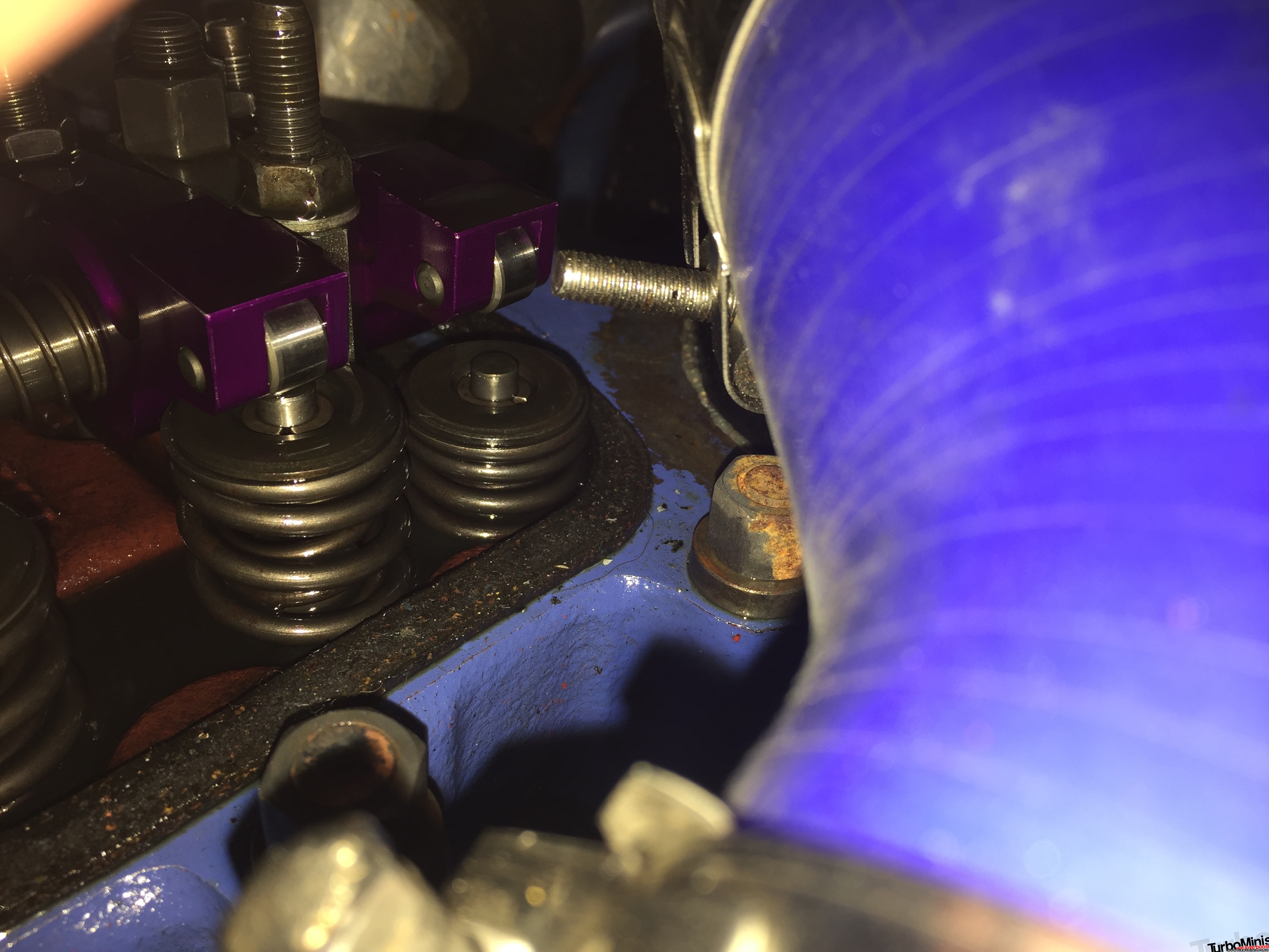

What’s wrong with this picture?
On 7th Nov, 2008 Nic said:
naeJ
m
4310 Posts
Yep, that valve might be an issue!
