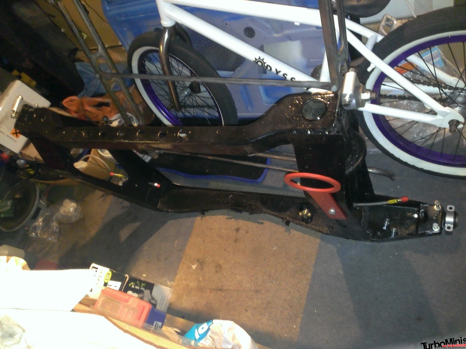

Not a lot gone on with the shell lately, but I've been doing my rear subframe! Got a couple holes to drill to add another couple of nuts and bolts to the towing eye (didn't trust just two so im adding a third) and then I think I can fit it up to the car, then onto the radius arms I think.... The joys.
