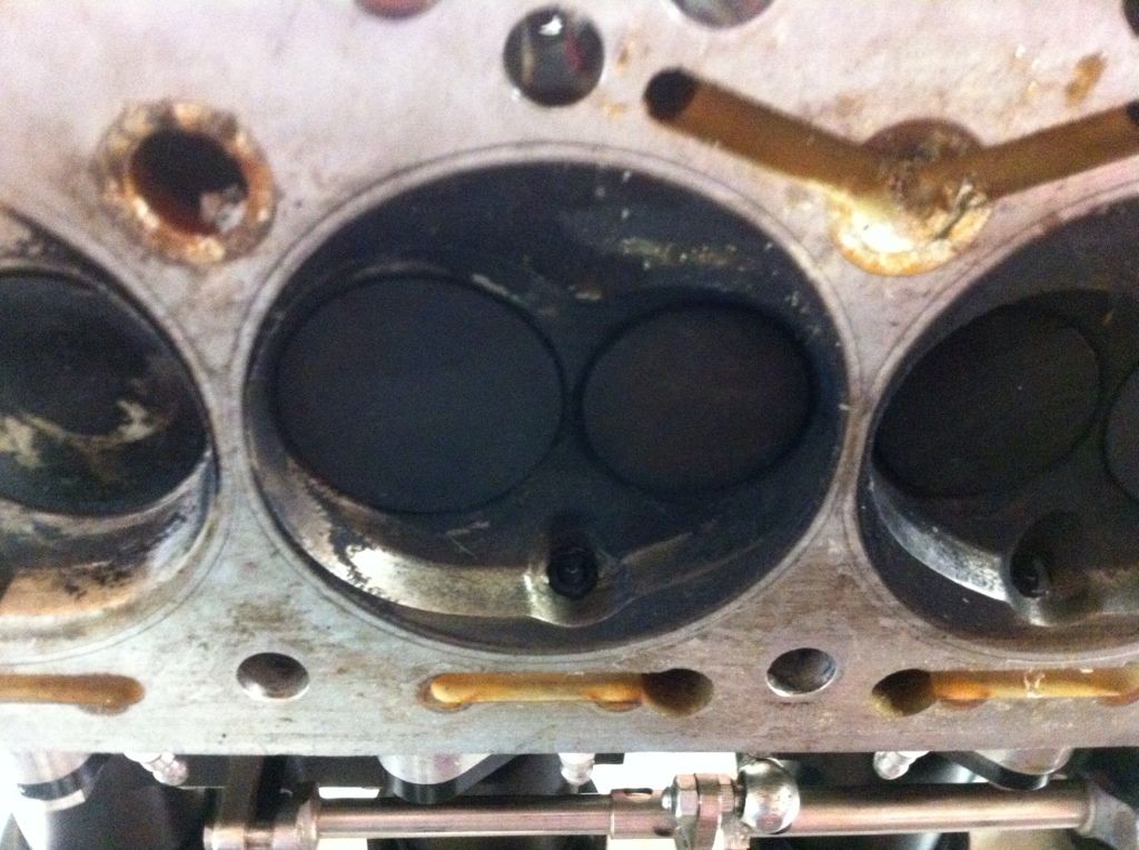

That makes alot a sense. I read another guy with a 7 Port had to rework the head to fit bigger 10mm plug, that were better placed in the combustion chamber.
What about spark plug gaps?
Edited by alaskanow0 on 5th Sep, 2012.
alaskanow0
1434 Posts
Member #: 8466
Mansfield
I have already modified the chambers to expose the sparks, before they were more or less consealed.

matt , is there any possible way you could get the plugs to go a fair bit further into the chamber ? eg longer plugs or machine down the seat ?
Having seen the pic this was exactly what I thought. Perhaps also worth indexing them to best "expose" the spark to the chamber?
No longer plugs are available. Im considering moving towards m10 Plugs and moving them in abit further at the same time. Just need to find someone who will take on the work.
All MED 7 Port heads now come with 10mm plugs as standard, and are done for them by Pierce. Mainly due to Plug choice......?

that burn pattern you have in the chamber : do you have a pic of the pistons as well?
well I quote again.. just to show I did not make this up myself.
''I was one that used to think that the clean areas where" fuel wash" when in fact, wet flow testing proved that the clean areas are dead lean. That was the first thing I learned on the wet flow bench. Where you have carbon, you have fuel. The biggest areas of carbon build up are usually vortex generation (large areas of fuel fall out that burn to latent to be useable cylinder pressure).
__________________
Darin Morgan
(Chief R&D head guy for Reher-Morrison)
So the plug is in an area that is quite lean by the looks of it . So I can sort of imagine that this plug has a hard time igniting the mixture. But it does not show WHEN the mix is lean or rich or the point you want to set fire to it. or if some point later ( when the piston is closer the plug) does not get washed with fuel so is hard to light at all. .
