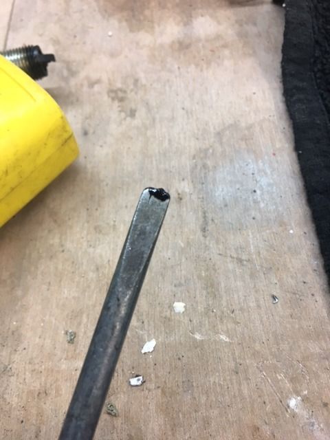

With a light scrape of a screwdriver in each bore, there is a deposit on each piston like this..
So it would seem I have 'wet or dry fouling'...
Possible Causes: "Depending on whether the spark plug is coated in oil or fuel, wet fouling can be symptomatic of a compromised head gasket, poor control from your pistons’ oil control ring, valvetrain problems, or an extremely rich condition. Dry fouling, or carbon fouling, is often caused by an overly rich condition, and the problem may lie with your air cleaner (clogged) or carburetor. Other possible causes could be low compression, vacuum leak, overly retarded timing, or improper spark plug heat range"
The plugs are NGK BPR7ES's and reading back it would seem 6's are preferred.
I've not interfered with the mixture since the rolling road but I have had the carb and manifold off.
What do you think about these?

Those plugs can wet very easily if things are not running right which would make the motor run awful. Until the problem is solved I would use some 6's, they are more forgiving.
I hope the valve guides are not nipping up when it gets warm, which may be an explanation.

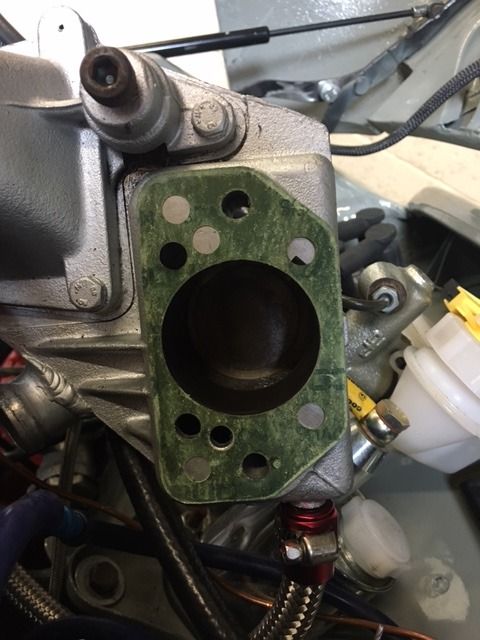

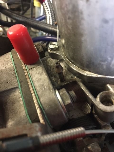

Hey.. just stepping through the steps of TurboDaves 'tee piece trick' post. It would seem that I have all the steps covered and all seems to be as written by Dave.
Took the plenum off just to check I had the right gasket (I knew it was but had to check visually to be sure, for the purposes of elimination)...
Everything is blanked off except this outlet..
Can anyone tell me what that is for?
Also, is my previous post utter poo poo regarding a sticking dump valve (if it is sticking)??
I have an AFR installed now and a temporary rigged up fuel pressure gauge that can be pulled into the cabin when going for a drive. Cant drive it just yet as I have one of the brake callipers off at the moment and need to get a new seal for the dump valve. I'll take a video of all the gauges when I'm able to drive it next and post it here... but for the moment, any help with these questions would be great.
Thanks..
4309 Posts
Thats the dizzy vacuum advance. I'd block that off too.
Also, can you blank the dump valve temporarily to eradicate that lead completely, just don't slam the throttle shut!
