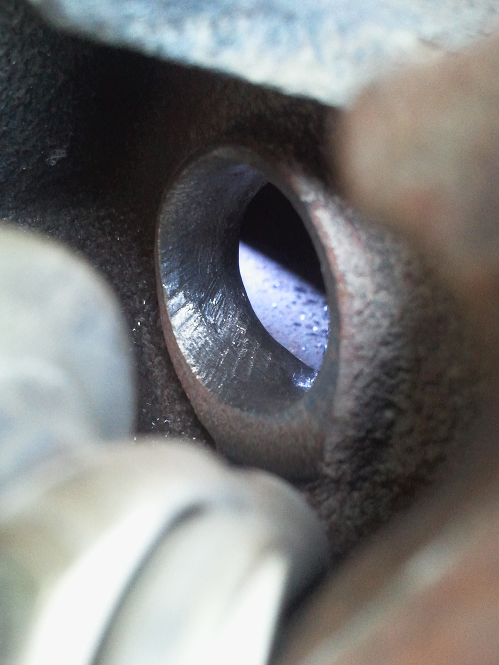

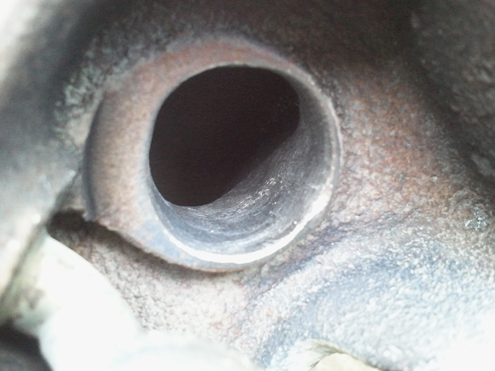

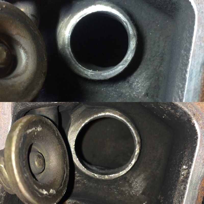

my efforts this morning , but looking at the pic there could possibly be a tiny bit more .
top pic is what I already modded so its smaller than that std

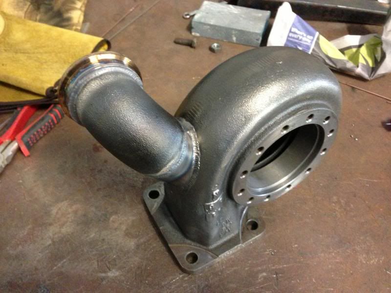

yep, not a hard job to tig a disc over the hole, also Ive seen external wastgegate take offs welded straight to the turbo so you wouldnt nececarylu have to mess witht he manifold.

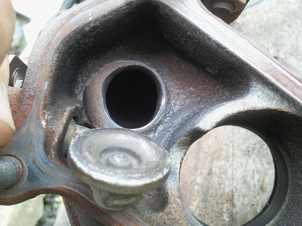

Rick and I talked about welding the housing up to give a larger flat surface then milling it flat and boring the hole larger. Then make and fit a larger flapper out of stainless. To make the internal larger.

Looks like you're OK on the bottom one, if it still creeps at that, it's going to creep no matter what...
What about at the other side of the waste-gate penny? There aren't any obvious obstructions in there that need to be relieved are they?
Had the die grinder in john and done as much as poss , the rest looks ok . Just need to try it again now

rip all the internal gate stuff out hog the hole out something big and go with an external gate

the wastegate penny only just seated *happy*
if i had to do it again, i would maybe weld a 24/26mm penny onto the wastegate arm and bore to size

when i had to slim down the turbo on the skyline to make it fit i welded up the wastegate and used a tial external
and still didnt go big enough *hehe!* *hehe!*

Looking at it I'm wondering whether it would make sense to try to mount a larger flap further up. plenty of unused flat area there.
Are these turbine housings just cast steel?
Edited by minimole23 on 29th Jun, 2017.
No, they are not "just cast steel". I forget what it is, but they are a twat to weld in a high stress area, eg where already cracked.. They just keep recracking.
If you have it opened out, blended on the inlet to the hole, and non restrictive downstream of the hole (easy to overlook) you should be good to go,,,
