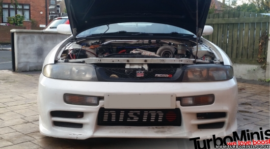

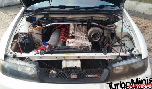

1000th post on my thread wooo *happy*
project i want alot more boost is not going well lol, everything is just too damn big
4310 Posts
The way your going you might as well just strap a jet engine to it!
only the power steering reservoir and windscreen washer bottle to relocate
ohh and it is totally fucking bonkers *happy*

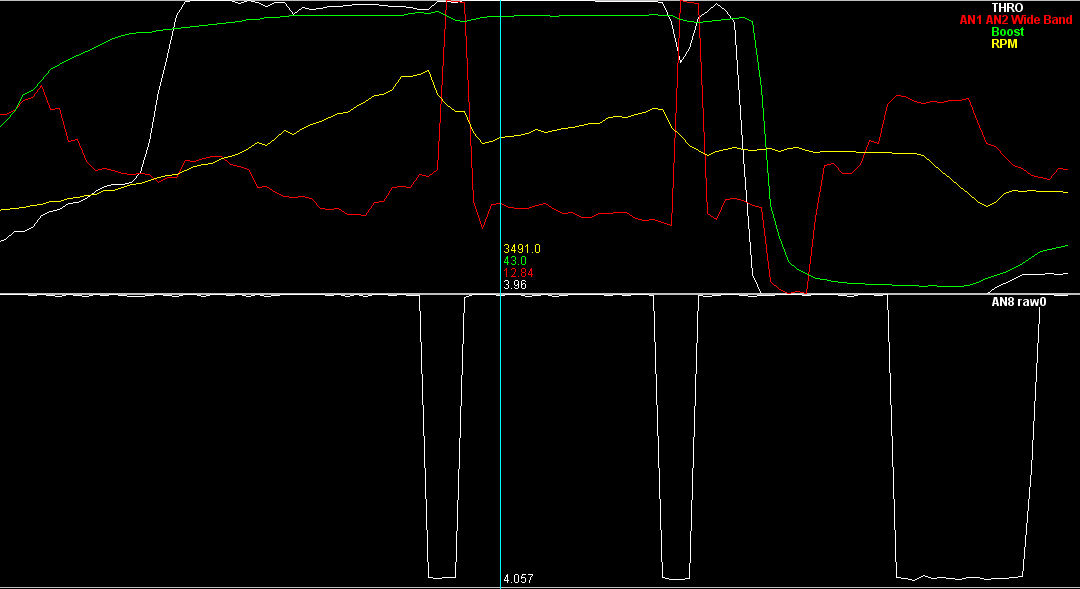

Is that 4 bar!? 😂
No i wish lol, its a log from the early days of my spreadsheet
Basically the apexi data logger outputs into a txt file, i created a spreadsheet that i can copy/past the txt files info into and the calculations convert it into something my mega log viewer can use ( megasquirt)
Things like water temp, tps, boost, were just a number from min to max
I have since sat down and done some more detailed calculations that give numbers that are useful
That log will be low boost @8psi

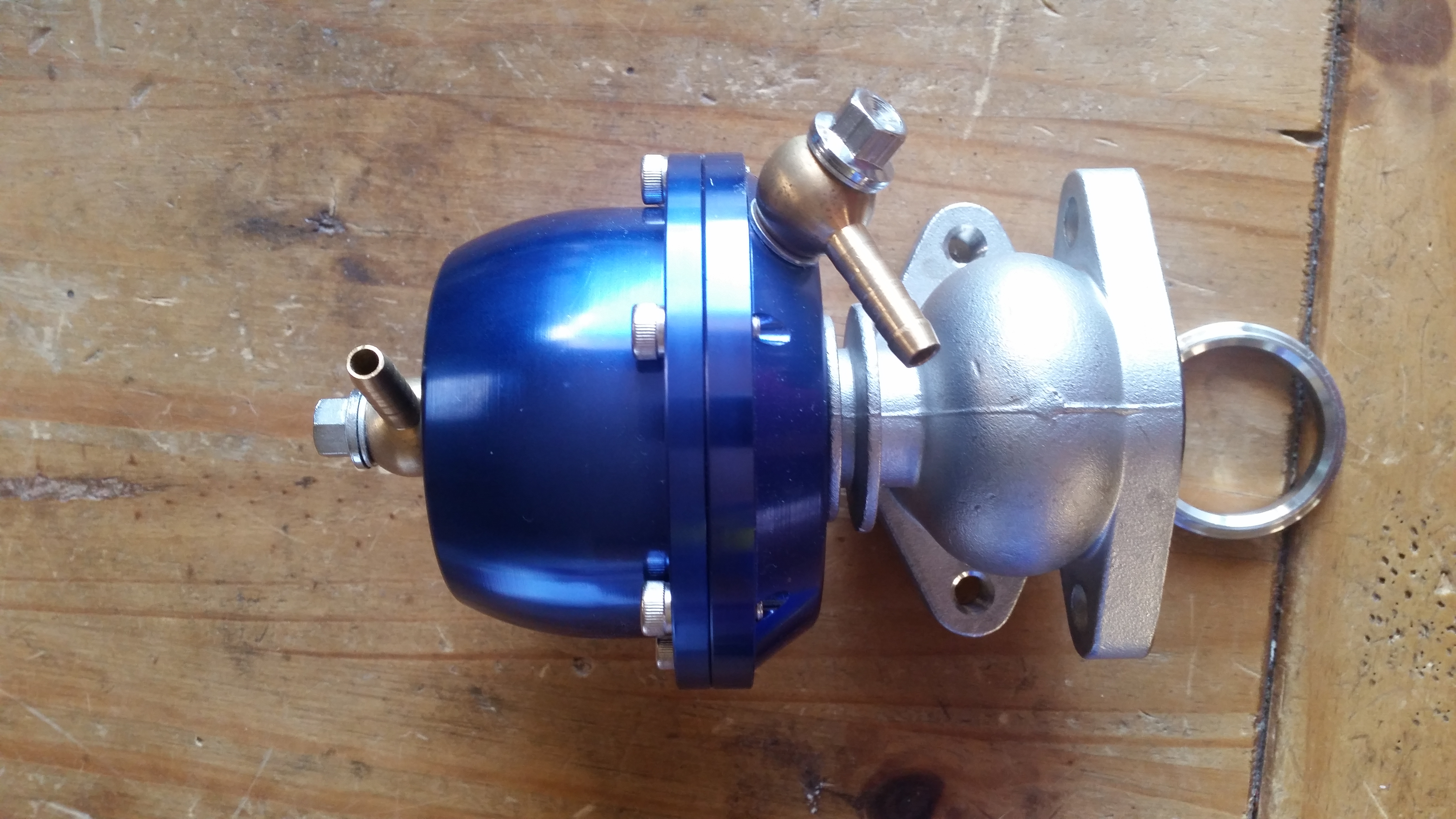

been doing some wiring today, got it to a point where it runs kill switch, ignition and start buttons mounted, and fired it up, short 10s blast.... realised the wastegate has been robbed for the skyline lol
few more bits to sort then im gonna run it up and down the garden *happy*
D4VE
2975 Posts
Member #: 10749
lowestoft suffolk
Oooo exciting, cant wait to see this thing make a run
Nothing gets past Dave lol
Good job i have more parts than sence lol
Heres another wastegate i bought years ago ... tial copy this one so that explains why the genuineee one went on to the daily lol

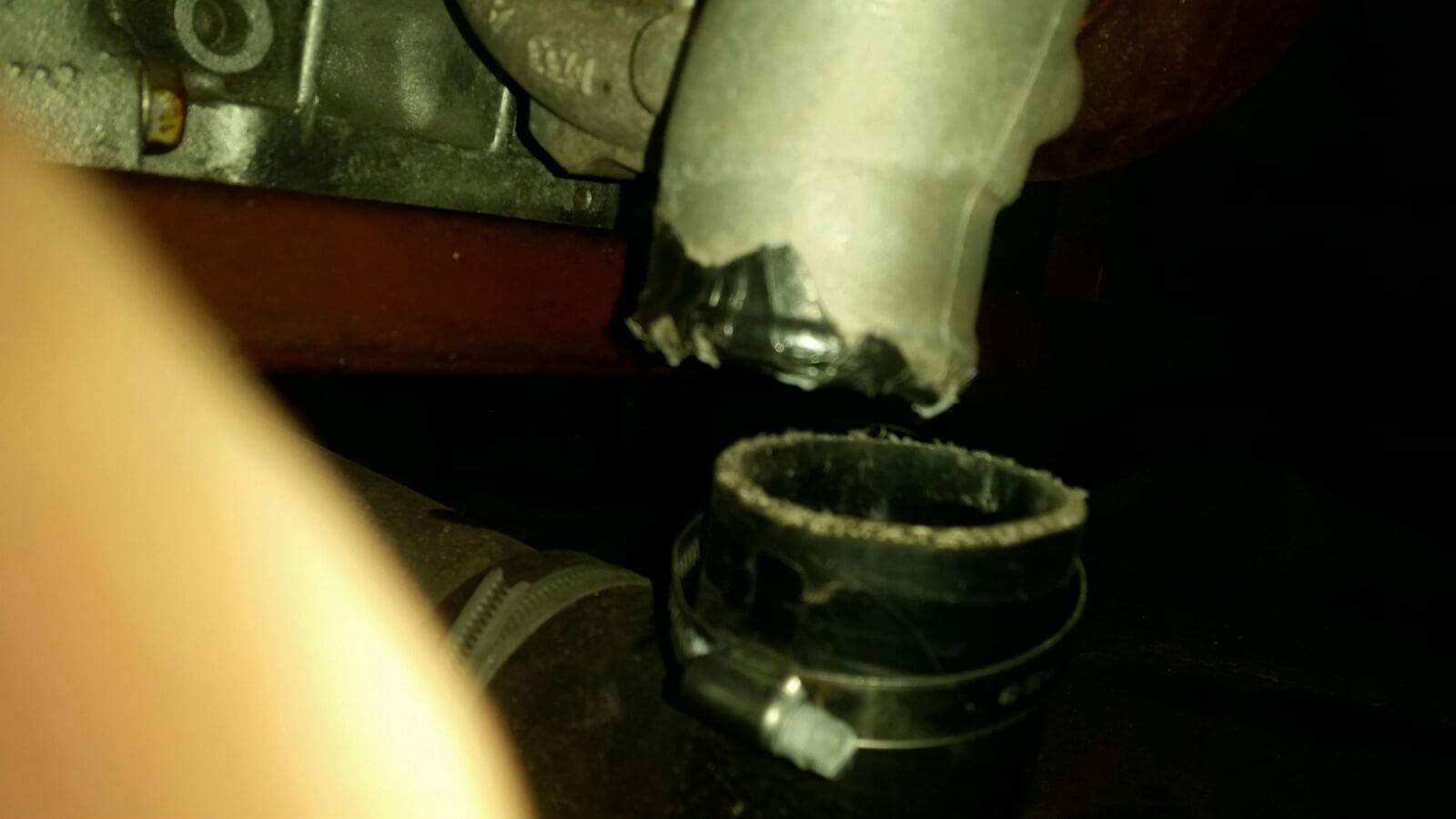

short idle vid, it seems alright but as you can just see the top blue boost pipe is collapsing as i blip the throttle and it whistles like fook when revved *happy* *happy*
https://www.youtube.com/watch?v=4n3D0IMM16U
i feel as bad as Mike and Rob lol, mine was not blue roll though
farking ducktape haha i had taped the turbo out let when i had it sat with no pipes on
pic to follow
Edited by Brett on 23rd Feb, 2016.
oh brett .
Oh balls
