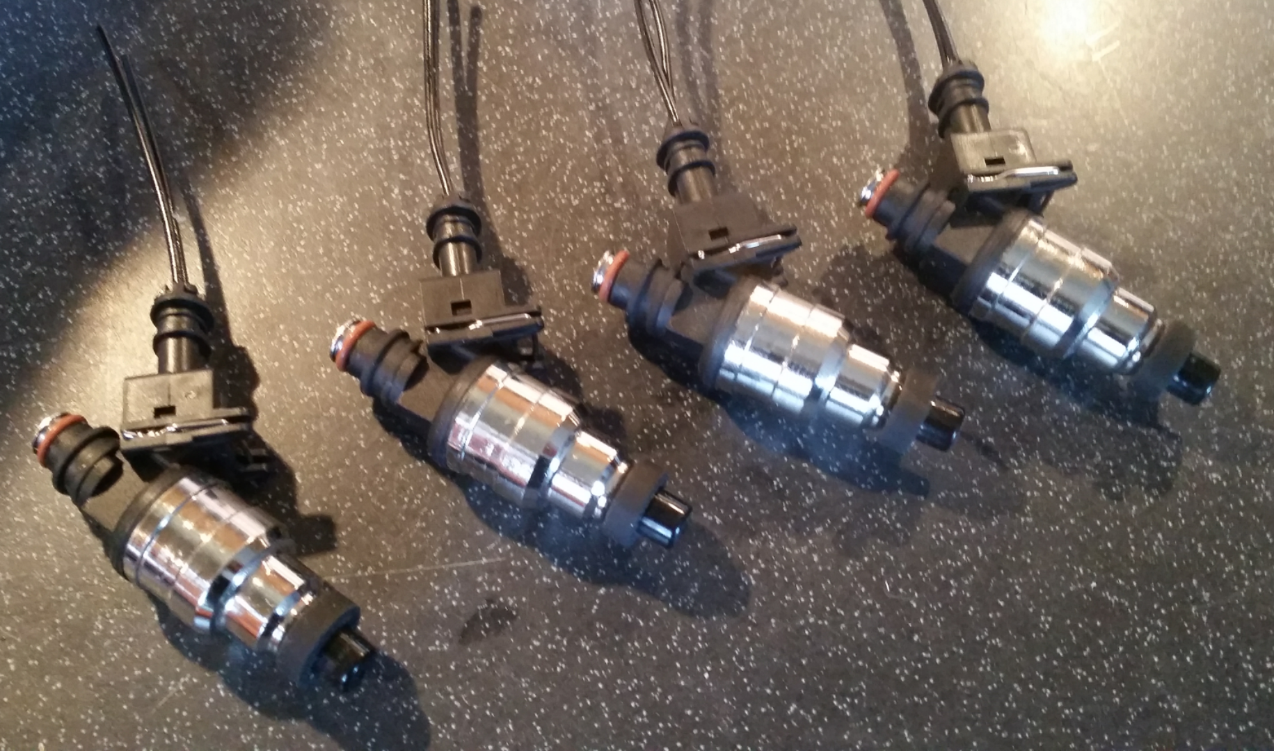

These turned up in the week
1600cc each *happy*
Can also be used on alcohol blends or straight alcohol
those are some fat podgers!
What about toluene/xylene....

High or low impedance? Where you get them from?!
1600cc each *happy*
Joe i cant find the exact injector i bought lol im sure they just said alternative fuels e85 and methanol
Steve these are low impedance and from tre performance usa im sure they are re branded maybe re manufactured bosch
More importantly 'should' fit my weird sized rails

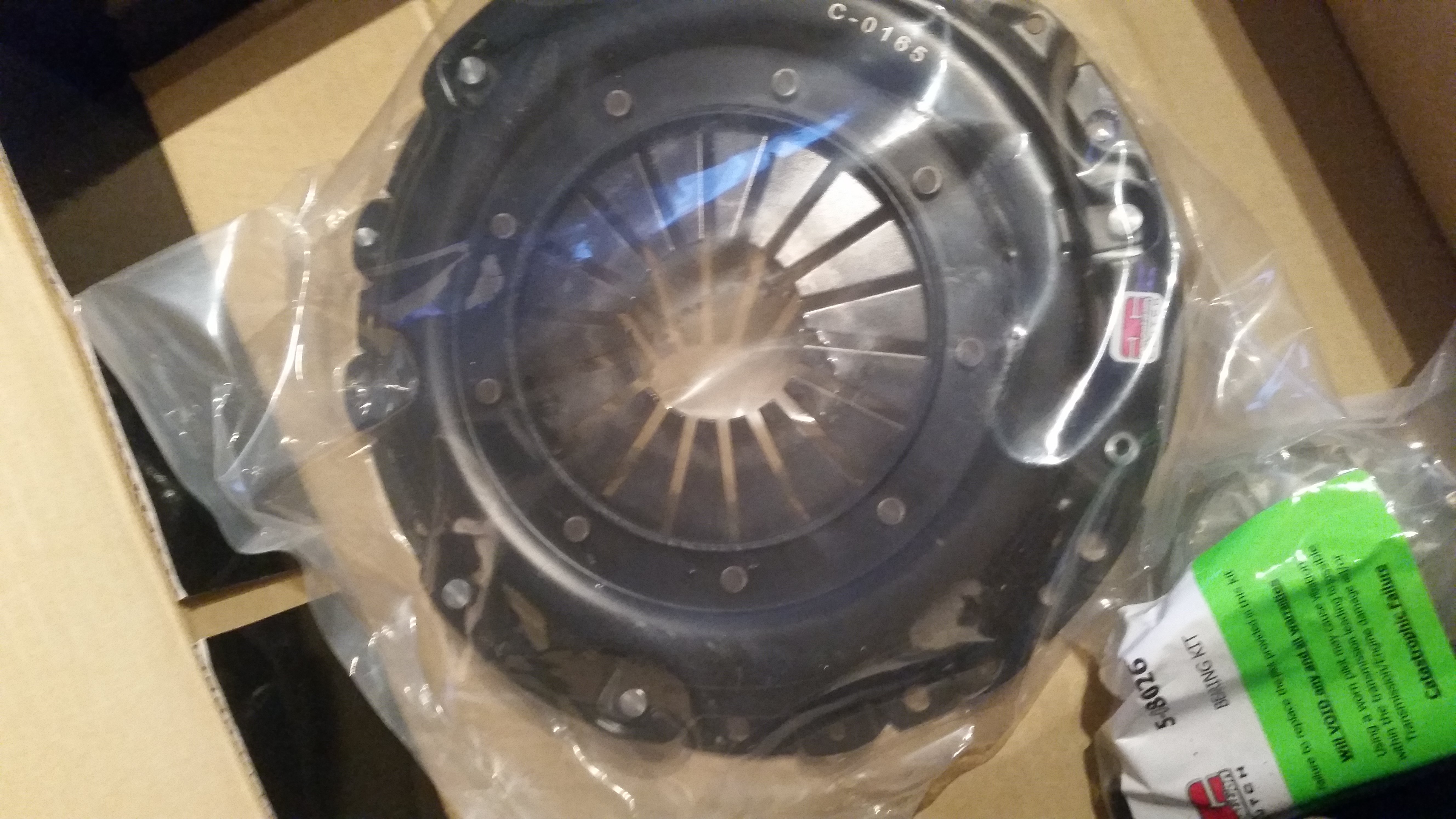

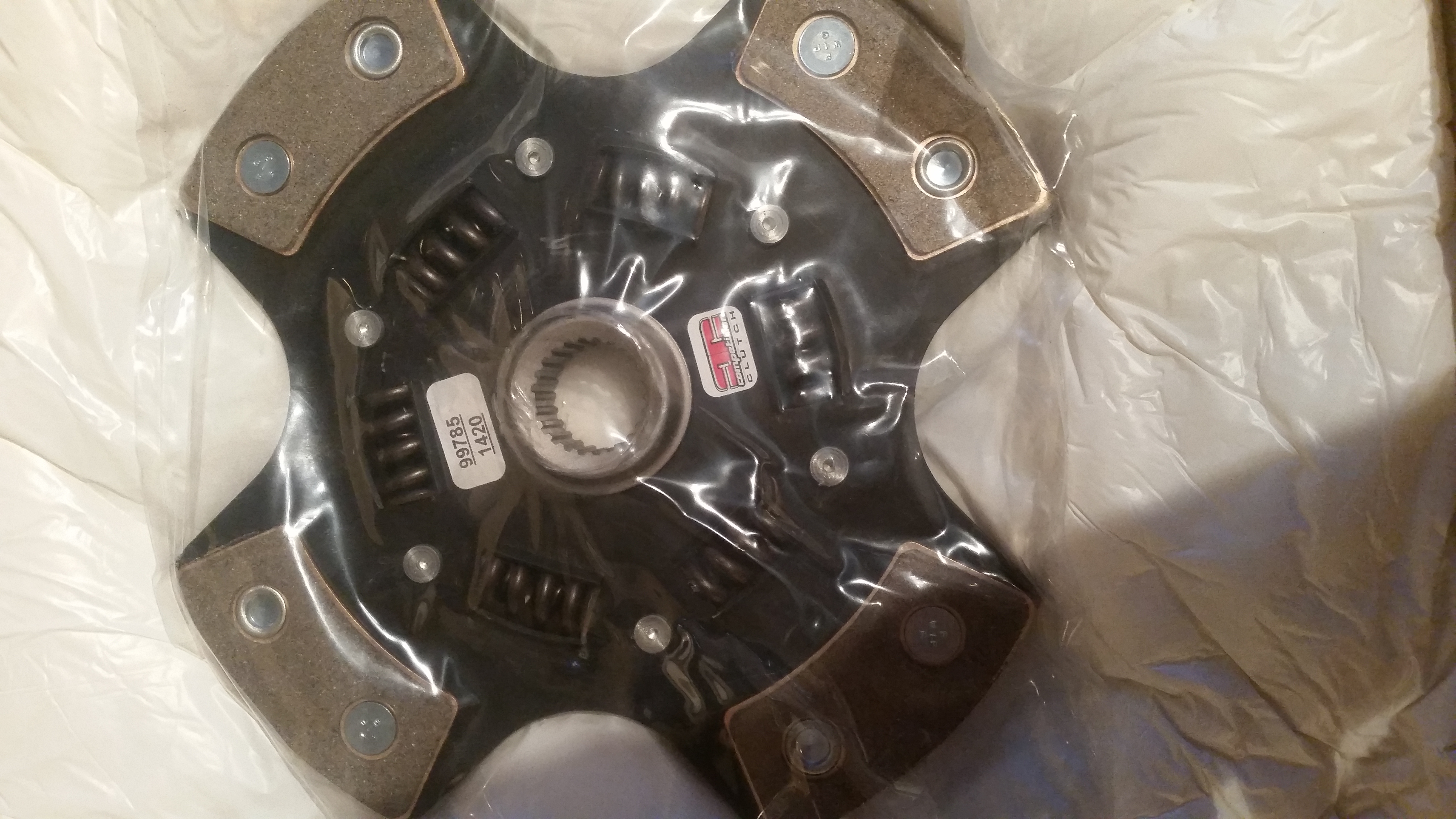

so the injectors are here ( might have said earlier a ive had them months )
1600cc i think lol *happy*
also i went for a competition clutch, stage 5 and a 4 paddle clutch
body panels also welded back in,
i had secret intentions of taking this to mitp but as ive just bought my house i have no time for mini play :/
so thought i would update this
