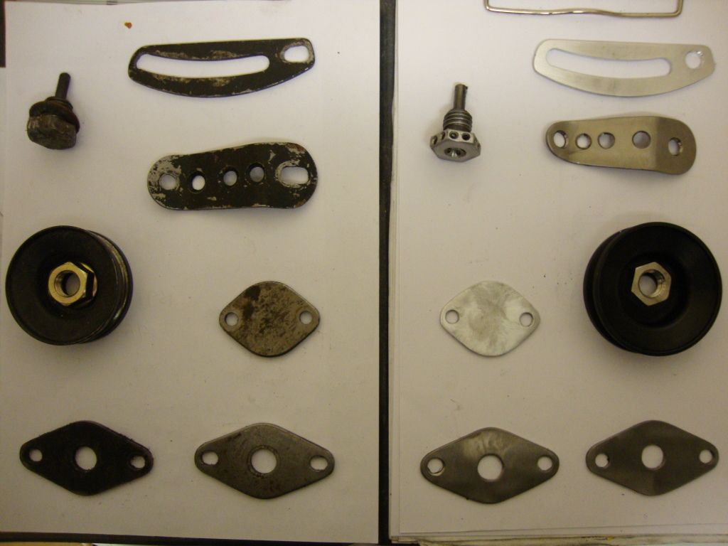

Ok I have had the weekend off from the car as i dont what to burn out on it too soon!
I ended up playing with my new toy and me and Jo went out yesterday, it was good to get back on a bike.
Anyway i got in the shed today for 3 or 4 hrs and made some small bits up out of Gr5 Ti and Alloy.
The old parts are 450g and the new parts are 192g so not bad *happy*
The count so far.
Wgt Before - Wgt After - Wgt saved
Sub frame------------ 36.00......... 17.60........ 18.40
Fuel Tanks ------------10.00......... 4.10.......... 5.90
Fuel Lines------------- 1.40........... 671........... 729
Oil P.R.V-------------- 47........... 13............ 34
Slave cylinder bracket--243........... 156........... 87
Flywheel housing------- 3.17.......... 2.92.......... 250
Wok--------------------- 1.380........ 1,289........ 91
Dipstick---------------- 90........... 52............ 38
Sump plug-------------- 46 ........... 36............ 10
Alternator Pulley & Nut ---------169.......... 84............ 85
Radiator Brackets----------- 218........... 149........... 69
Master cylinder arm---- 40............ 25............ 15
Top arm bracket-------- 43............ 17............ 26
Speedo drive blank----- 41............ 8.............. 33
Alternator adjuster -------------48............. 15............ 33
Clutch arm-------------- 159........... 148........... 11
Engine steady bracket----- 63............ 18............ 45
============================25.856kgs

Out of curiosity, what is the angle for the alternator pulley weight gain ?
Replaced a metal pulley with a plastic one ?
Rusty by nature
No its a Ti nut and a Billet alloy pulley.
Edited by madmk1 on 15th Oct, 2012.

Ok a bit of a small update,
I am a project manager at the min with this as i am waiting for some parts to come and some to get made, also i am making sure i have all the nuts, bolts, studs, parts so when i start the rebuild it should go smooth and slick.
I mocked up the front shock mounts, so when i get the Ti it should be good to go. I have made them with 2 holes for now, so when i offer them up to the car when the subframe is in then i can see if i can get them on more of an angle inwards.
and i know no one likes a show off but..
The count so far.
Bulk head Eng sty brackets/bolts..353..........134..........219
Kad bias box swapped.................2944.......916.........2028
Roll cage bolts x44 M10x30............1760.........792............968
roll cage bolts x6 M10x50.............312............156...........156
=============================TOTAL 29.227kgs
Edited by madmk1 on 21st Oct, 2012.
