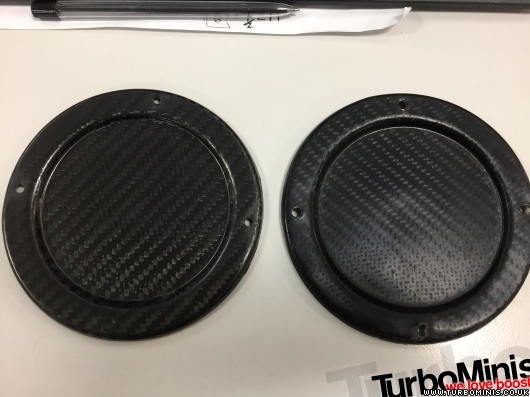

More ‘marginal gains’ in the post
106 grams, down to 14 grams
Aubrey_Boy
690 Posts
Member #: 9962
Thanks again Steve, if only I could make the same percentage gains on everything else!
stt
21 Posts
Member #: 9627
What are the carbon discs for?
steve w
656 Posts
Member #: 1917
AKA chargedzetec
Air vent blanking plate I believe
stt
21 Posts
Member #: 9627
Surely not blanking them is even lighter!
Certainly wetter.
