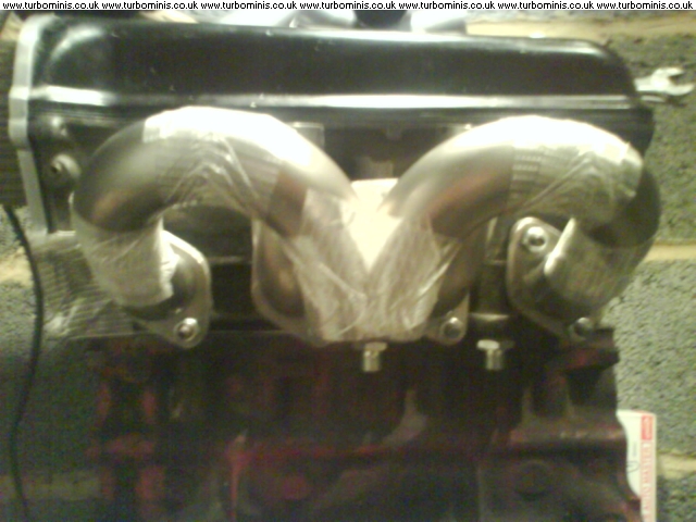

Right got a bit more done! This stainless is a right PITA to work with...lol Everything that go's near it seems to magically go blunt. *laughing*
I got the 4 flanges done...its not everyday you see 4 unused flanges all in a row like that...*laughing*
The turbo flange just need the hole cutting.
Ive now milled an oil drain for the cam (cheers for the tip-off Matt) *wink*

When are you getting all your pipes welded?
Fairly soon, now ive made the flanges the pipes sit really tightly in position so I can cut the cut-outs to make the collector.
Should hopefully be ready for welding in the next couple of weeks.

Isn't the secret with stainless to work very, very, very slowly as it work hardens very, very, very easily. Sorry if this is granny sucking eggs time.
Yeah it seems to mille nicely, turn nicely but trying to drill it was realy difficult as the drill wouldn't go slow enough! No matter how slow you go things still seem to go blunt though...lol

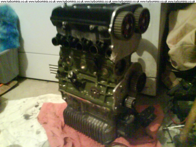

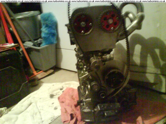

Today I had a nice long chin wag with JonhK whilst collecting my block, top bloke couldn't be anymore helpful.
Ive started the final build now. *tongue*

Looking real good, it looks huge there-almost as tall as me
Looking good matty , get rid of water pump tho and put a fancy electric one on ?
Rick
True it does look like tall old stack..lol

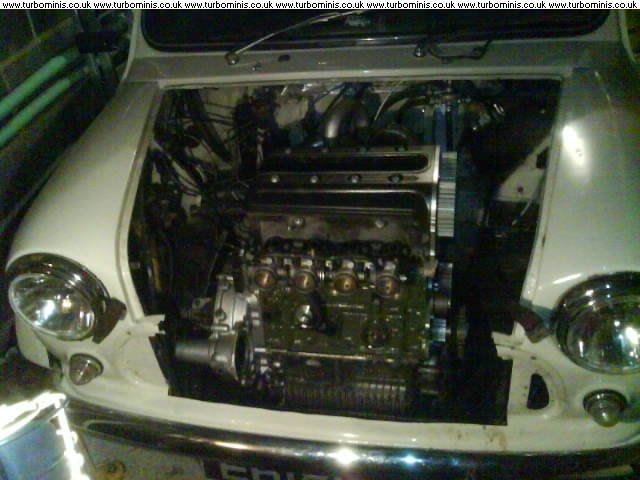

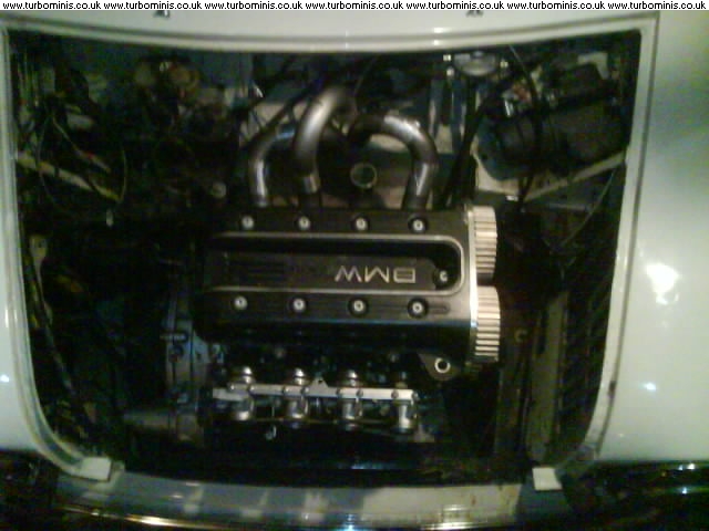

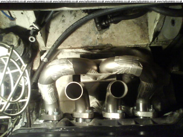

I thought i'd better check the exhaust manifold for bulkhead clearance, it needs a little trimming back...*laughing*
Starting the look the part now! :)

looking really good, how close is the exhaust manifold going to get to the bonnet?
David.
I'll probably end up taking the plug cover off (weight saving) *laughing*
The manifold will be level with the cam cover when i finish trimming it down, Ive spent the last couple of hours re-positioning the turbo AGAIN and trimming the outer 2 pipes to fit. I seems to be spending hours cutting pipes and not getting very far! lol

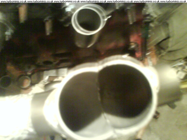

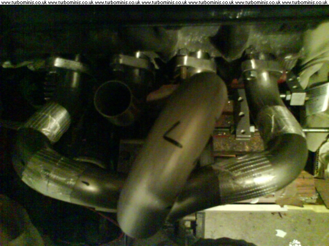

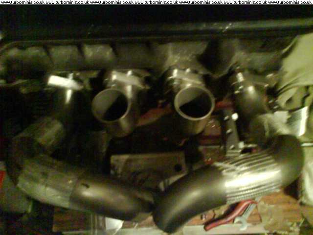

Well 10 hours, 2 hacksaw blades, 1 file, a few metal splinters 6 cans of beer later this is my progress....
Made half of the collector for the outer pipes.
finally it clears the bulkhead! 8)

Top pic is a little blury, is this the beer? Looking good tho!

Blury? Looks fine to me the others are blury. lol
Beer helps with the inspiration..lol
