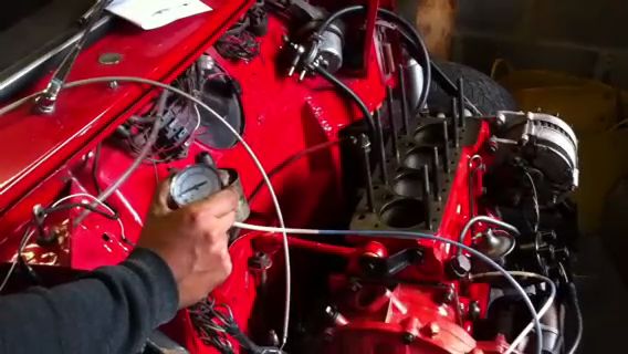

5th Jun, 2012 at 03:04:50pm
Got engine turning over and my oil pressure up today thought id film it because I'm a bit of an anorak.
