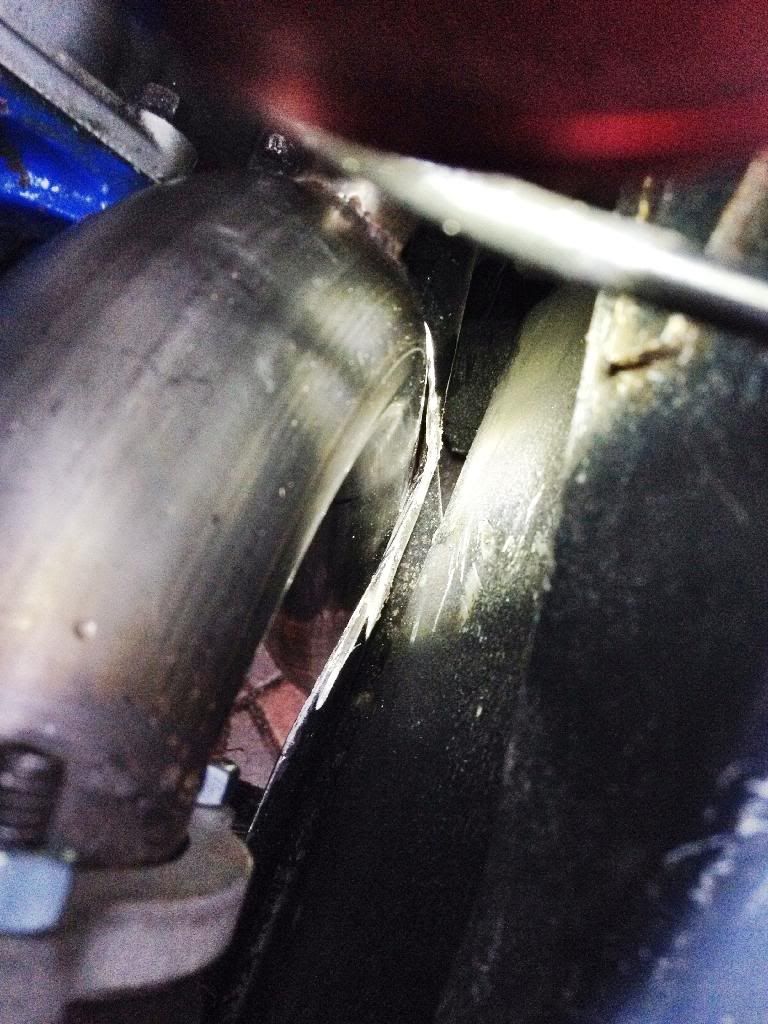

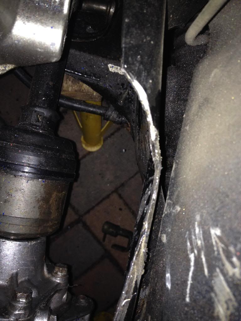

Got it to fit but only by cutting the top of the lip on the subframe off, it now fouls the bit that goes around the steering rack and pot joint.
Nick warwick
537 Posts
Member #: 8926
Sheffield
Before
After now hits the bump below the lip for the steering rack

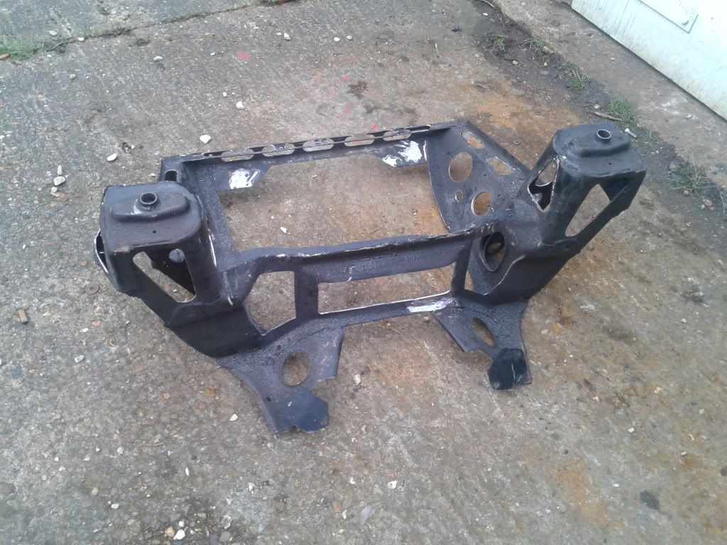

Yeah I have relieved my subframe, exactly where you have. Where abouts is it fowling the subframe? This is my subby, and has more clearance where the downpipe goes past the subby. What kind of tie bar have you got? Adjustable or standard?
Edit: just seen you have n adjustable tie bar. What is the length between centres?
Edited by matty on 2nd Apr, 2014.
I've just measured where my engine is sat, and the distance between the centre of master cylinder stud to the centre of the engine steady bolt is 220mm. I've also modified my steady bar mount so comparing engine steady lengths won't be of any use. Lol
It looks like your engine is tilted more than mine, which will reduce the gap between the pot joint and subby. I may have to go with a reduced slip joint to 2" in between the first and second bend, at least that'll give more clearance, and allow people to lengthen/shorten the downpipe to suit the tilt of the engine and adjust ground clearance.

I haven't got the steady attached at the min mate so I can rock the engine.
I think I will whip the engine out this weekend and hammer the bit I need to cut flat maybe or cut it out and weld a plate back across to give its strength back.
I have to lean the engine forward to clear the actuator tab an turbo so hopefully it will clear the pot joint when all in position.

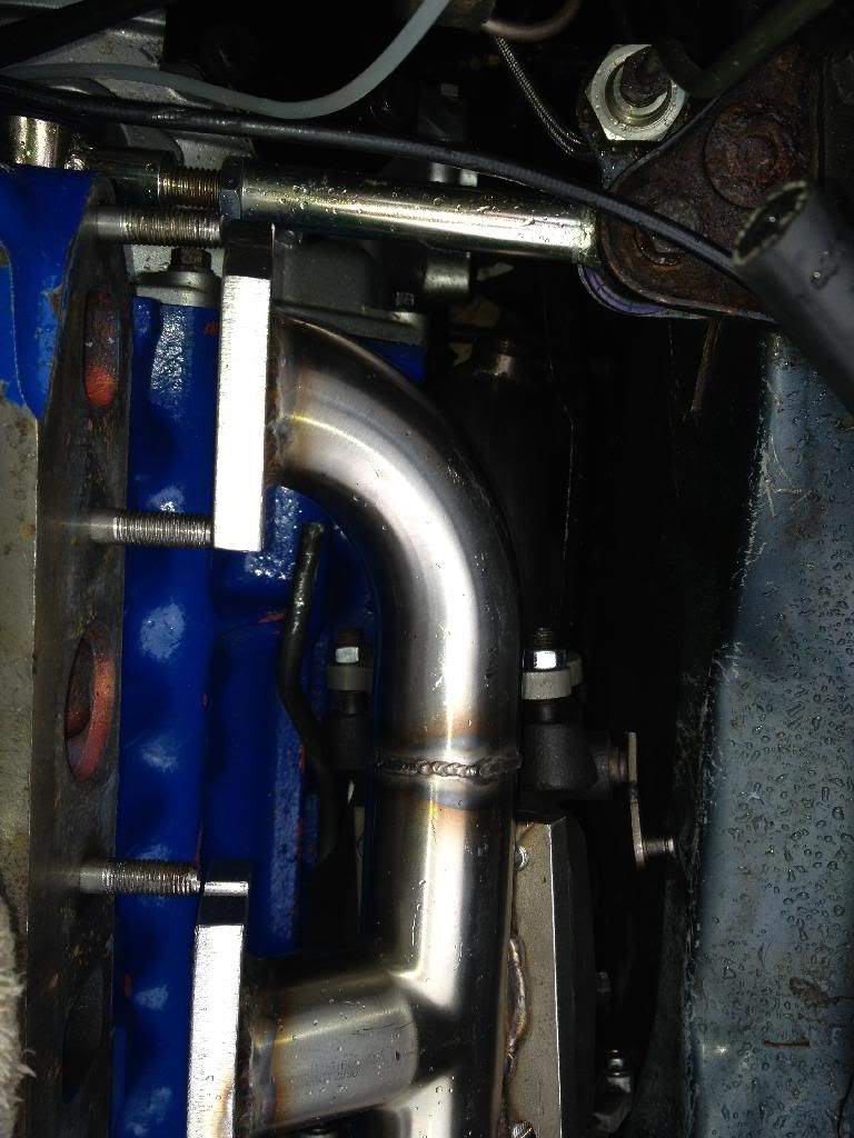

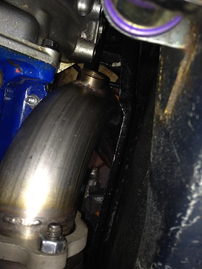

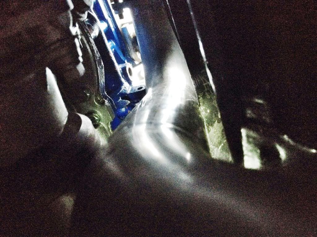

Fitted it again but couldn't do much for long as it was pissing it down.
Can't lean the engine to 220mm because the actuator tab hits the bulkhead but these photos were at roughly 225mm

Looking at the pictures, it looks like with the wastegate lever rotated to allow the actuator to be repostioned towards to clutch housing.
When trying to push the engine forward to 220mm as per Matty's, the wastegate arm is fouling on the bulk head at about 225mm.

Yeah thats it Lee so once the downpipe is on it makes moving the engine impossible as actuator jab is jammed against the bulk head and the downpipe against the subframe and pot joint.
If the pipe diameter was smaller during this section or even a oval shape this would help greatly.
