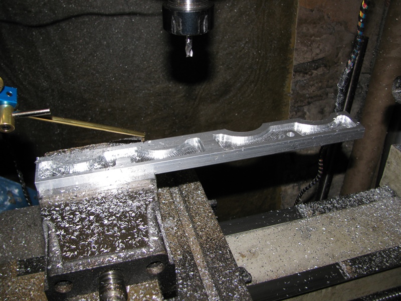

Got the eldest lad to make me a bracket to hold the coils:
Fancy Eh?
very nice.

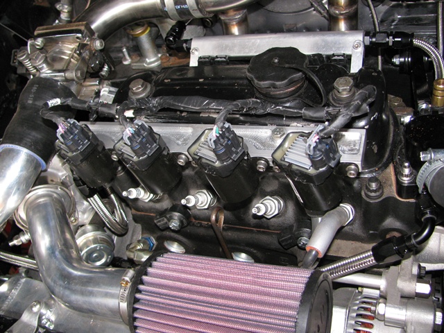

Coils and bracket fitted:
Next job is the engine bay wiring.... fun fun fun :)
