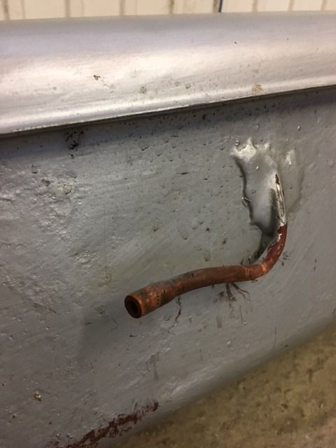

Well this is what the return looks like..
Seems clear.. It's around 5-6mm. Looks like the pipe goes in upwards towards the top of the tank but don't know how far towards the top it goes? Cant really tell what they've used before to bond it in.. looks like JB weld or something.. its not been welded.
Do you think I should look at getting a larger diameter pipe in there to match the rest of the system?
If the return is big enough you should be able to adjust the fuel pressure down to virtually nothing.

Absolutely... just wondering should I maybe change that return pipe for something larger to match the rest of the pipework?
Then I would know for sure that the pipe would be venting to the top of the tank.
I’d want it larger than that. Especially as we can’t get the fuel pressure down.
8mm would be better.

Yeah... whilst it's off I may as well do it. Then I also have the issue of the original pick up pipe, the union that screws in to the side. It's about 5-6mm also.. that would be a real pain to change I'd imagine.. I'm pretty sure that's not my problem however...
It's a vented cap yes...
