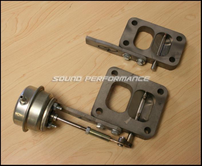

shame the squirrel pf turbo calculator is gone, that had some Holset maps on. although no goood for this turbin spool stuff
this purported to be the 60mm 6 blader,...
yeah 2.5l, Hx35w, 7 blade, 12cm twin scroll, but on a non twin scroll manifold, as i was going to buy / make a valve similar to what your doing
but the turbo was a hell of a lot more responsive than i predicted
the recent acquirement was listed as a hx40 'super 40' 16cm turbine, not took it to bits yet may end up on the 1.8 vtec
( ohh and the sound they make <3 <3 )

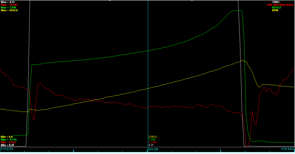

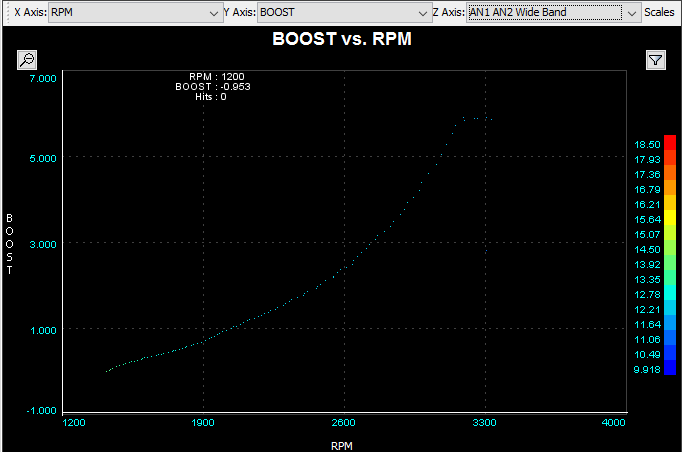

have you wheel sizes and spool log on hx35 brett?
be interesting to see how the 40 works and what's inside it .
what boost and bhp are you at ?
turbo wheel sizes
Compressor: Exd:78.0mm Ind:54.0mm
Ex Turbine : Ind:70.00mm Exd 60.00mm
boost low 0.5 bar, high 1.1-1.2bar ish
power ??? road mapped and not been on a dyno yet (peaks around 85% duty on 555cc injectors @ 11.1 afr )
needs a forged rebuild before getting frisky lol
both pics show the same few seconds of log, couldnt find any decent pulls from off boost when running high boost
