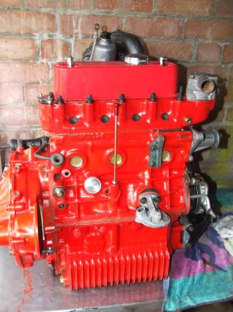

well engine is built, i cant upload pics as photobucket is bust. i have now ran out of funds psml !!!
still need a nic plenum, a DV and BV in order to meet the deadline for meeting Steve.

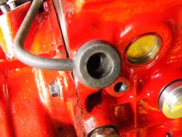

where does the oil feed for the turbo connect too ? it appears to line up with where the oil cooler hose goes back into the block, but the hole in the pipe is smaller than that on the block ? anyone able to advise ?
pics to follow eventually.

Scrap that oil feed pipe and fit a braided type.
Richie
3184 Posts
Member #: 628
I appreciate that, but i have been told braided = very bad, the pipe collapses with heat and bang goes the turbo, i prefer the solid type as i know it wont kink / collapse
I'd go so far as to say that 95% of the turbo minis I've ever seen have had the braided pipe on, with no issues. Certainly both the turbo minis currently in my garage have a braided oil feed pipe.
I've certainly never heard this "collapse with heat" fable.

Mark killed three turbos off with braided hose which had collapsed he was the one who told me to go with solid pipe., Neil has changed his back to solid pipe, and unless iam wrong i think even Steve is running / changing to solid type pipe ? perhaps its an issue of how it is directed to the front of the block I dunno just going off what i was told bearing in mind a turbo costs circa 300 quid so i cant afford one to go bang.
mind Tom because you 8nt heard of it, does not mean it is a "FABLE" just means you have not witnessed it happen, i appreciate what you say though perhaps Mark was unlucky ?
can anyone confirm that the pipe is in the right place ? can it be used and still have an oil cooler ?

fuck it, i have seen where it has to stretch to, i will snap that pipe before it reaches, Tom you are right why piss about.....1 x oil pipe en route from mini spares....... bugger still think solid is safer though :) just humour me please

Good man. You know it makes sense.
And if it collapses, you can blame Tom. lol
or me

didnt realise the pipe had to reach the oil capiliary doodad (the smaller hole which feeds the oil preasure gauge)

yes you need filterd oil richi from the main gallery to the turbo the other large hole goes to the top of the filter like the normal pipe
use new copper washers on both sides, these are prone to leak in my book
Tom i have heard a few instances of braided pipes coming adrift, but... maybe they were fitted .. angled wrong getting a massive heat soak
Am I right in thinking that the old solid BL pipes supplied the turbo with unfiltered oil? In which case the braided hose may be a better option.

dunno i have ordered the right one havnt i ? the braided pipe also appears to come from the smaller hole which feeds the gauges.

cant picture it at the moment but gauge and low oil light (tee) off the main oil gallery running the length of the block..

well it came today and it is now fitted, however due to the fittings on the oil presure braided line are different, i will have to get a new one, but for the purposes of rolling road i mihgt just pop a gauge onto the T peice until i get sortid.
