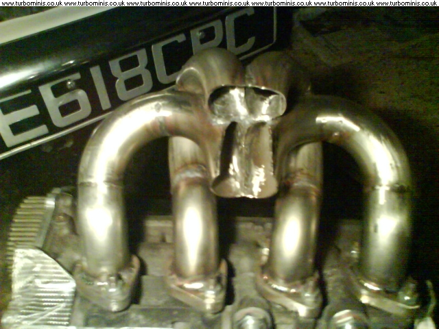

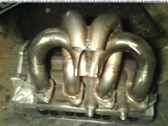

The exhaust has now been welded, and ive finished off the last 2 pieces to be welded in tonight! :)

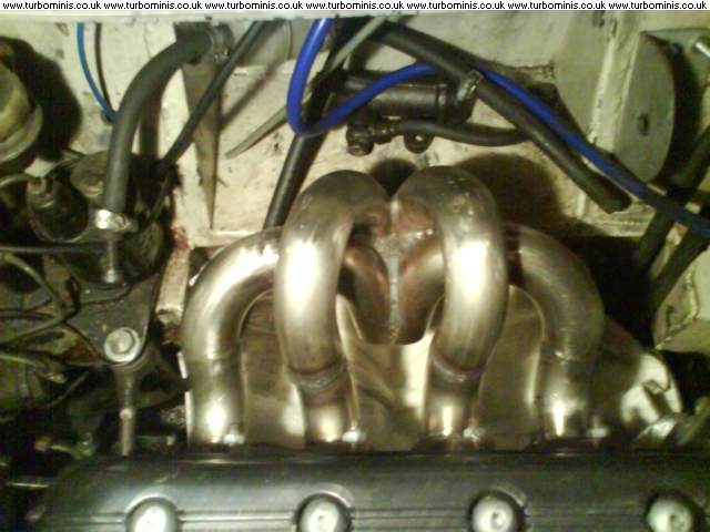

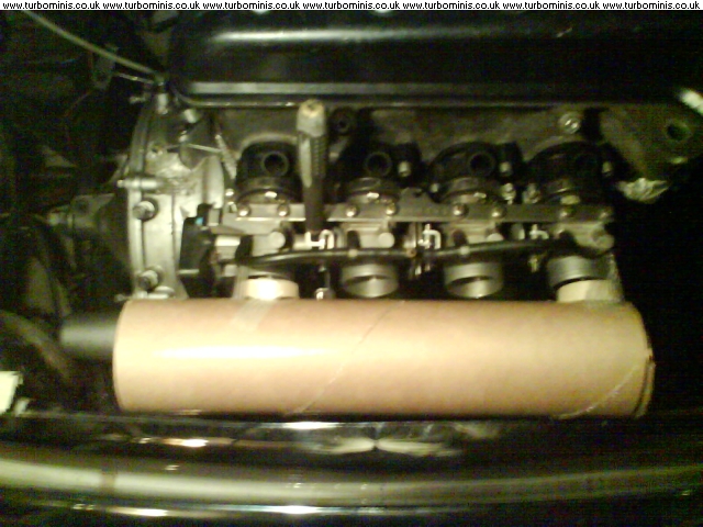

Believe it or not..but it actually fit under the bonnet, could be interesting trying to keep the hoses on with the short stubs mind. *oh well*

personally i'd loos the ITB's and stick one one the end, then you can have some extra fixing length for the hoses.

I have thought about it but didn't know what size to go for so decided to stick with what works. *oh well*

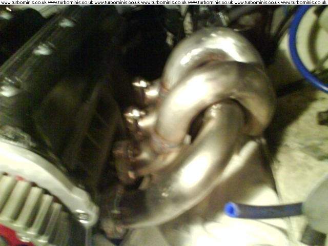

also forot to say the ex maniflod looks the dogs danglies :)

Looks ace matt,
Did you get it welded or was that a home attempt?
Either way, looks class.
Is the oil return block in ally or st/st? Nice piece of kit. You cant beat a good engineering machinist. *cough**cough* *blush*
Cheers for the comments guys, I got to the stage last week that I nearly started again because I didn't think I could get it to work, the near 40 hours of pissing around has finally paid off! lol
I found handy place that does TIG welding and only charge £25 an hour, so will be using them again me thinks. :)

25 quid an hour? Cheap as chips that.
Proberbly wouldve taken me bout 40 to 60 mins manually but idve got bored making it rounded on the lathe. *tongue*
se x on a stick matt ,nice job ,with the hoses ,run a few straps from the plenum to the bodies to fix it in place so the hoses dont have to do the job

wow, thats looking pretty special matt.
good work!

top work matt, that is looking so good.
12s next year? *wink*

Lol...I would be happy to get into the 13's..*laughing*
The last two pieces are being welded today..so ive only got some flange blending to do then its FINALLY done! *tongue*

Looking great buddy, I especially like the exhaust manifold.
Cheers tom!
Always time for some flange blending. *wink*

absolutly awesome looking manifold and so neat

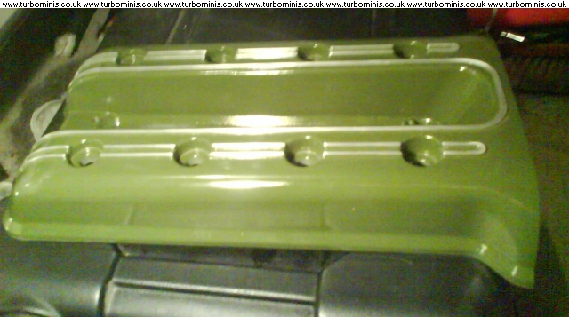

Progress is slow at the moment what with work etc...
But I have managed to squeeze a few more nanas and curley wurley's out of the engine by painting the cam cover. *laughing* *laughing*
Excellent colour!!
Ah,,,,, the choice of champions. :)
