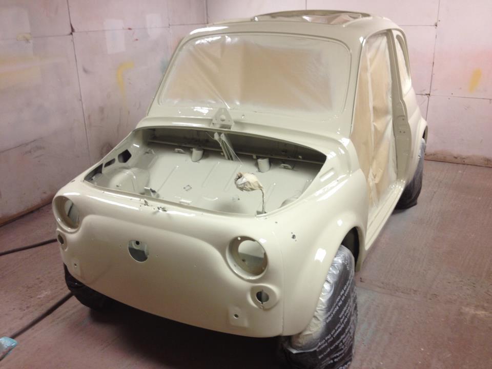

Ive ended up keeping the Finishing one of my Fiat 500's that was started a long time ago,
So the plan is get it done,sell it....use the money on the pickup,

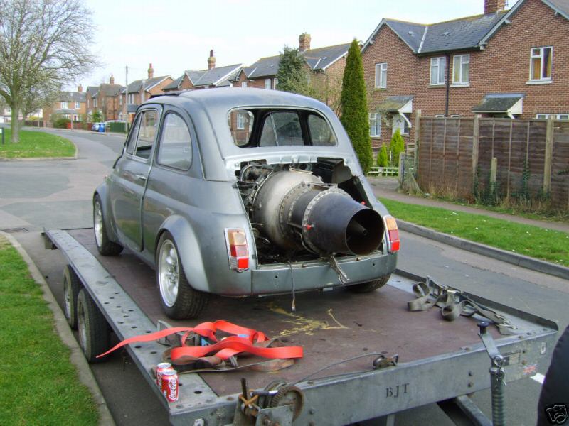

love the molegrips holding the jet engine in....lol
