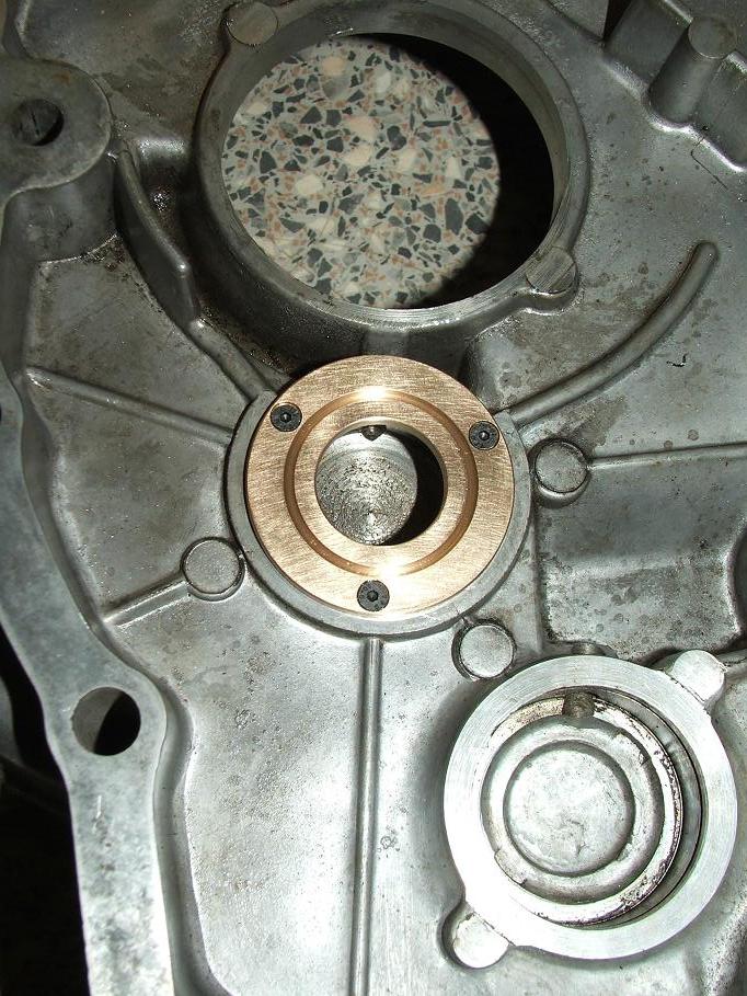

What are the screwed in place thrust washers (I assume the one in the transfer housing is the same) .... is it bronze or something else ???

Yes, only one side is pressure fed - oil comes through the idler to the other side where the another bronze washer is screwed to the transfer housing....
In my last try I let the bronze washer rotate - there I only cared about the gearbox side...now the transfer side was also worn a little bit, so I decided to this setup now:

so is there a matching bronze bush in the transfer side? or is that still just running on the alluminium?

yes, matching bush on the other side...looks exactly the same as on the gbox side....

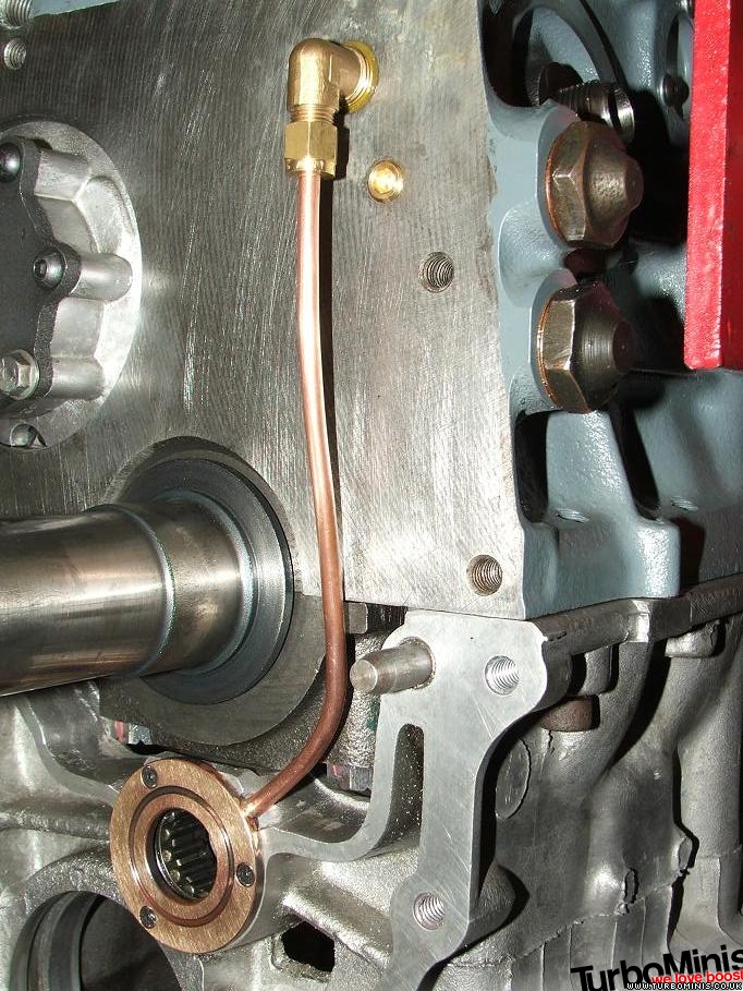

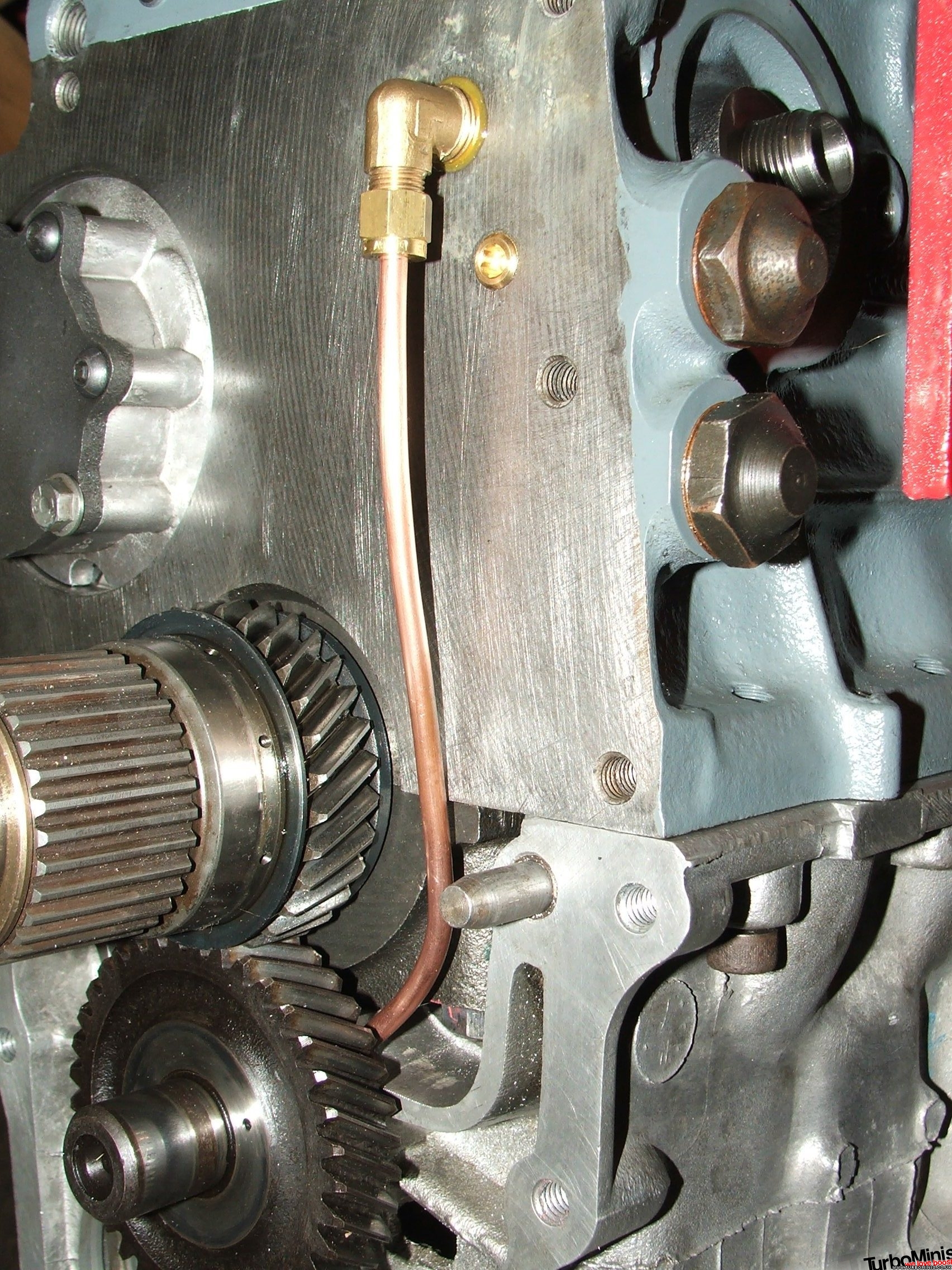

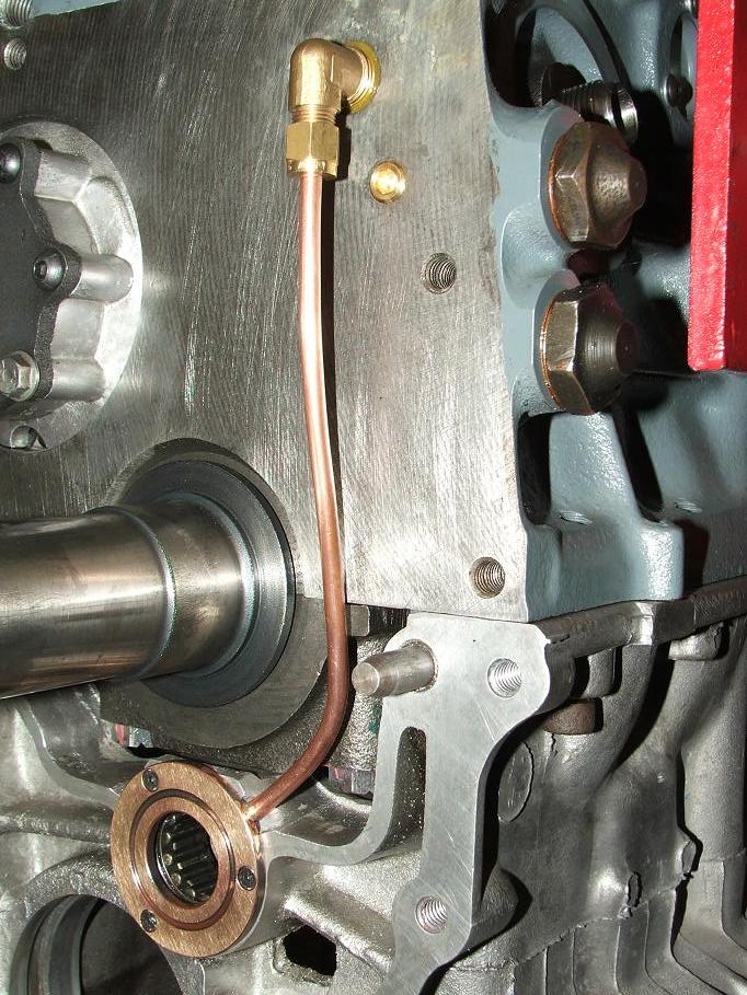

Inspird by Turbo Harry, here is my take on the pressure fed idler thrusts
