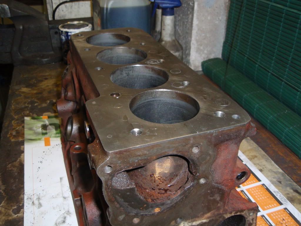

Got a bit of work done, block plugged, drilled and tapped. Also enlarged the gearbox holes to 5/16th while i was at it, waiting on bmw oil jets to turn up then they can be fitted then will send the block off to be decked and bored.

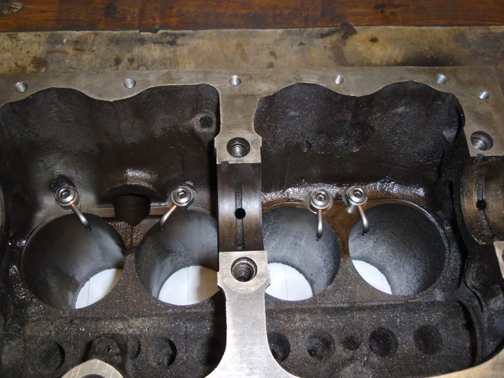

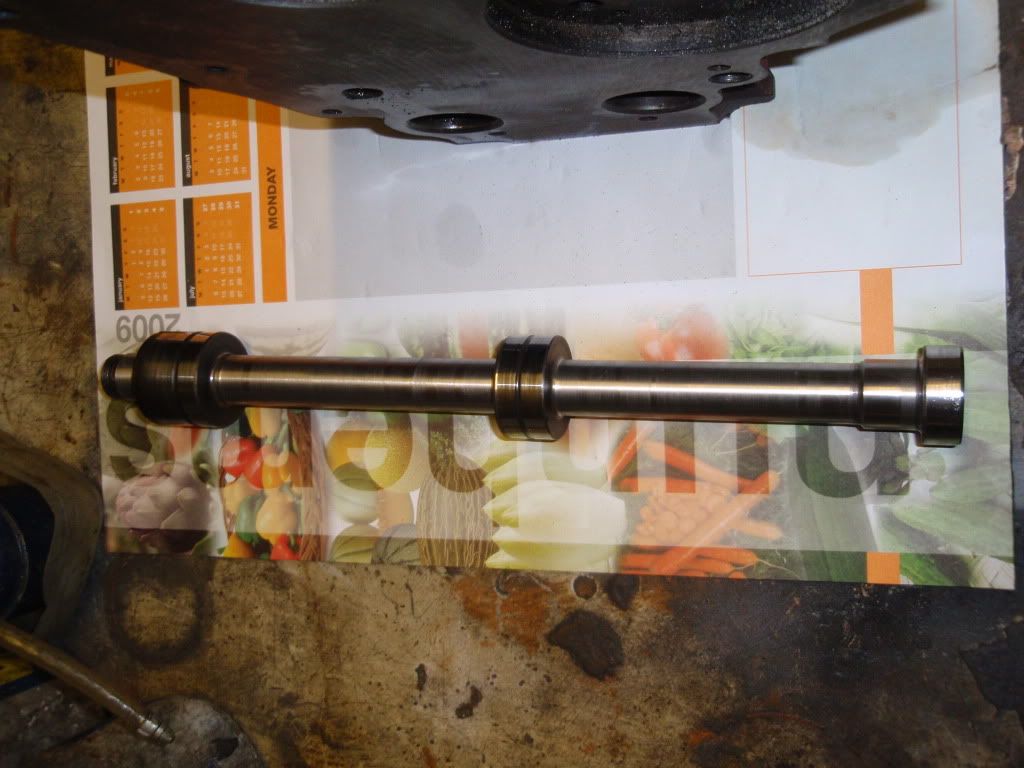

Did a bit more machining.
BMW oil jets:
Camshaft de-lobed:

The oil jets look great, i dont suppose you have a part number for them?

Yup i do indeed Part no. 11 11 1 739 907 at £38.41 incl VAT

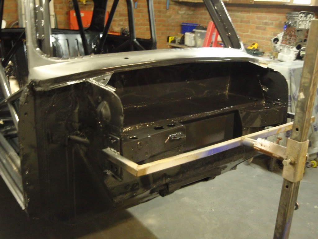

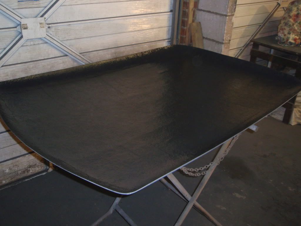

Got bored with waiting on bits being machined so i've splashed a bit of paint around:
Next job is to bond the roof on and smooth it into the gutters. Then the underneath can have a few coats of grey and the outside a few coats of white.

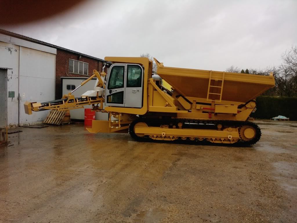

Seems strange painting something so small. Last thing i painted was considerably larger:

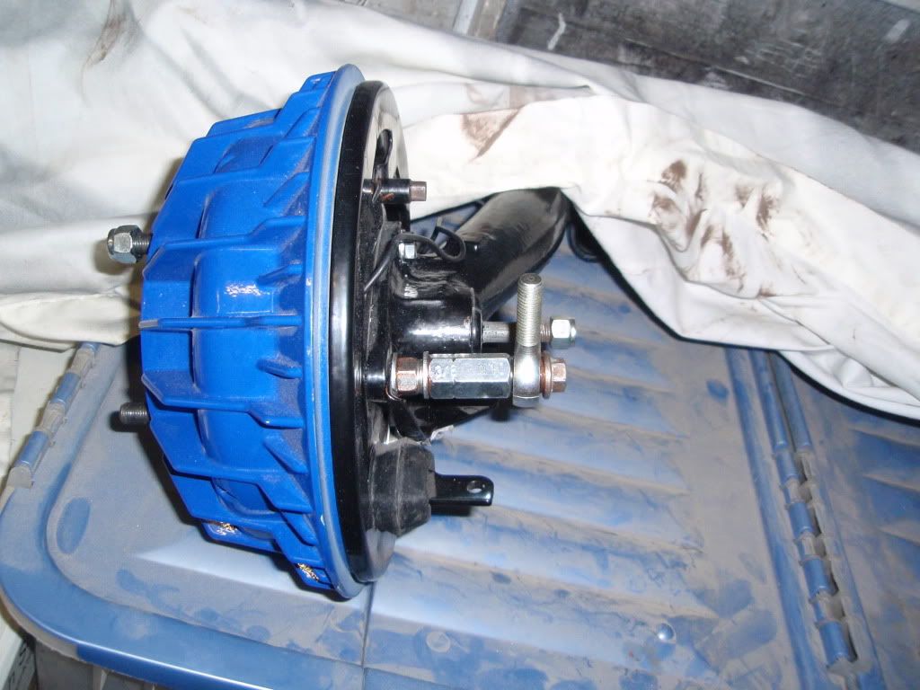

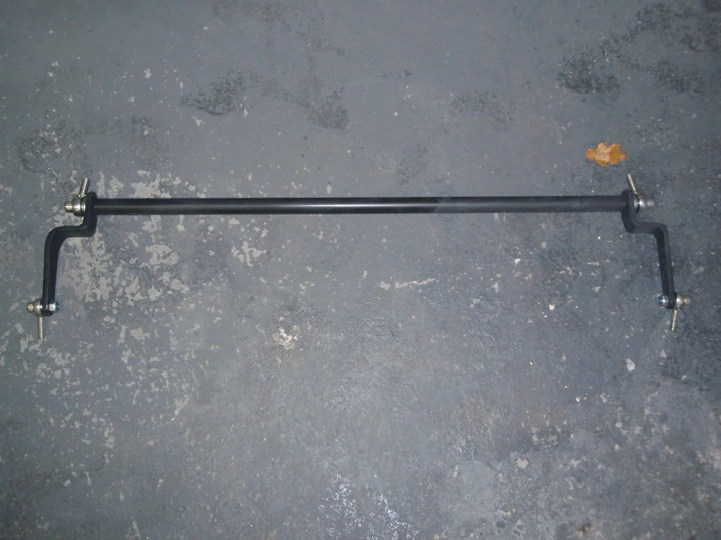

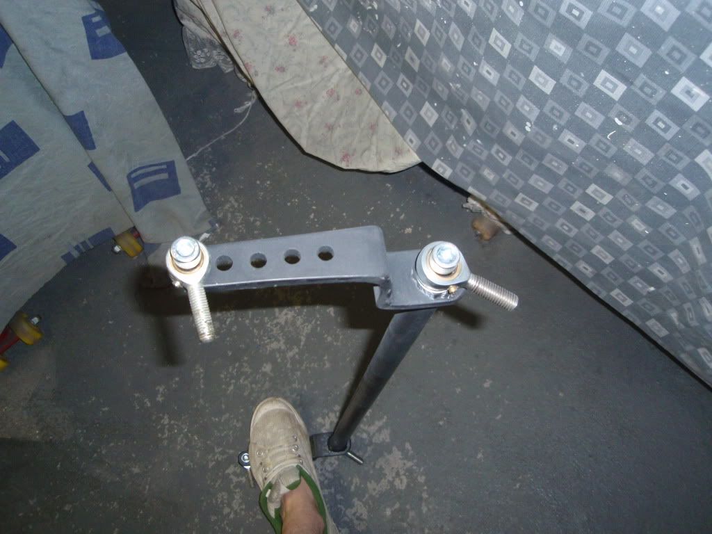

Also nocked up a rear anti roll bar, just gotta make up the drop links when i'm 100% on the ride height:

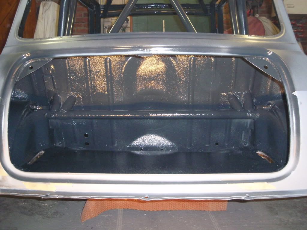

Looks brilliant as allways mate, i do have one small critisisam.
I realy dont like the stone chip in the boot.
sorry.
i LOVE the rest though
Rick

Me neither, as soon as the paint went on i thought bollocks, not much i can do about it now though, cant be arsed to strip it all off.
Gotta touch up a couple of bits where the paints a bit thin on a couple of the tubes, but all in all not bad coverage considering the lack of room to swing a spray gun.

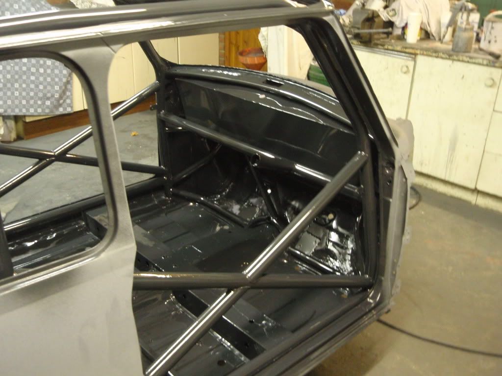

not an easy job painting the cage, looks like you have done a great job though, well done!
great colour btw.

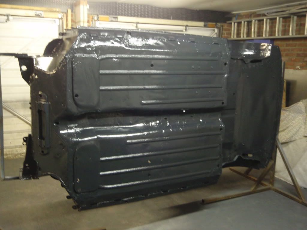

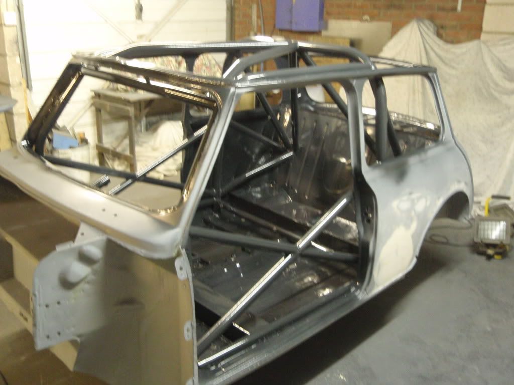

Bit more progress, underneath and bulkhead painted.
Can start building things up properly now, then will spray the outside once its all togther.

Excellent matey, i dont know why, but im in love with that shade of grey on the interior..... Has sparked new ideas for mine *happy*

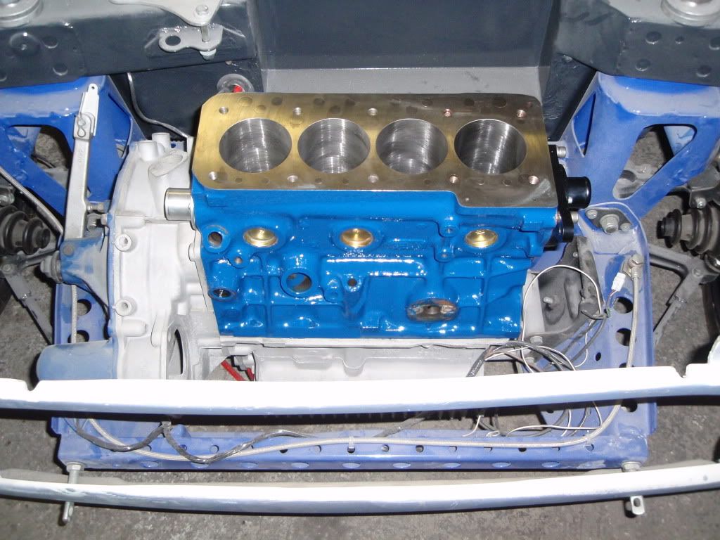

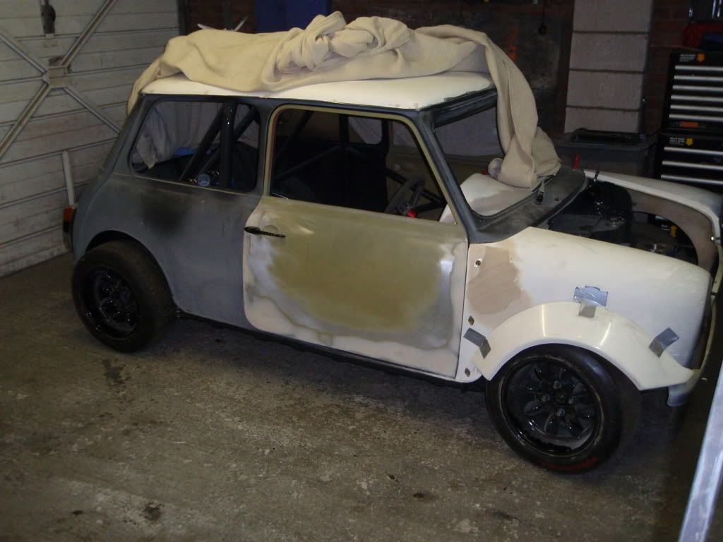

Just to show i havent been slacking too much.
Now sitting on some 13 x 7's with some yoko slicks:

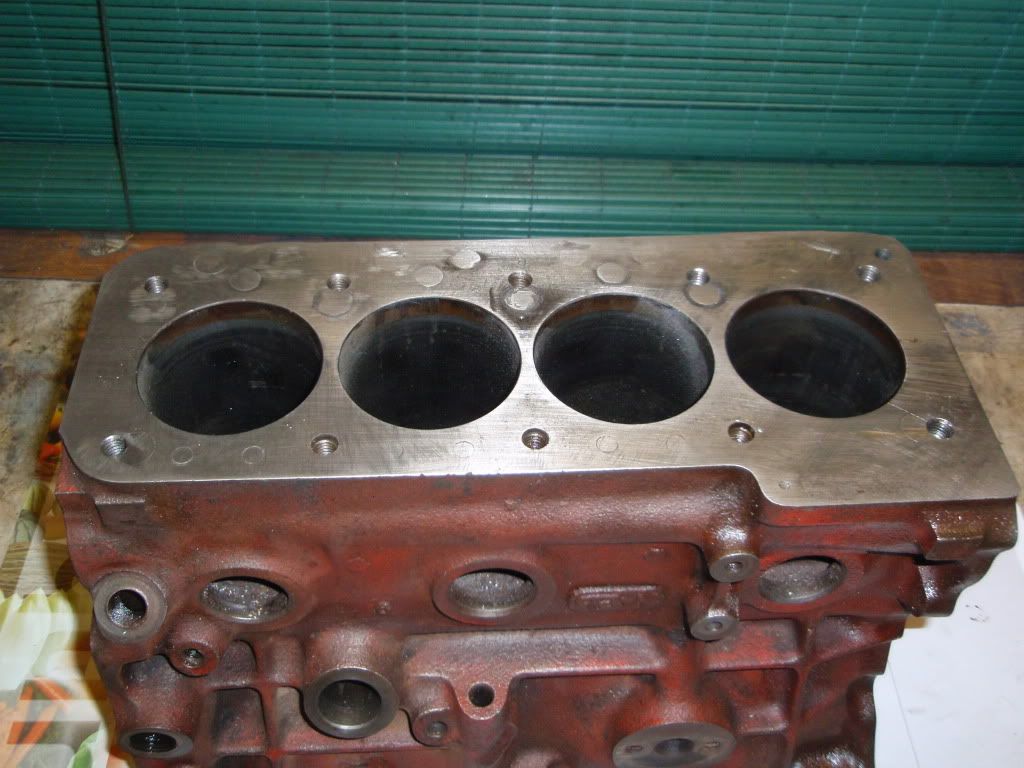

Engine block has been bored and skimmed:

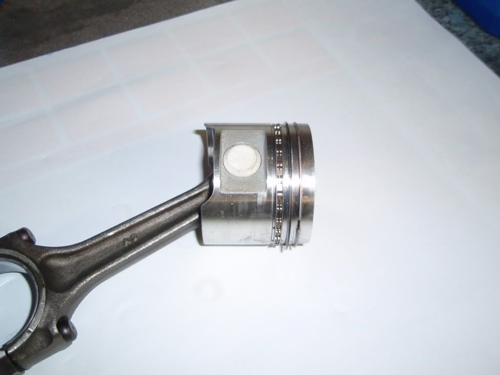

Machined up some piston buttons:

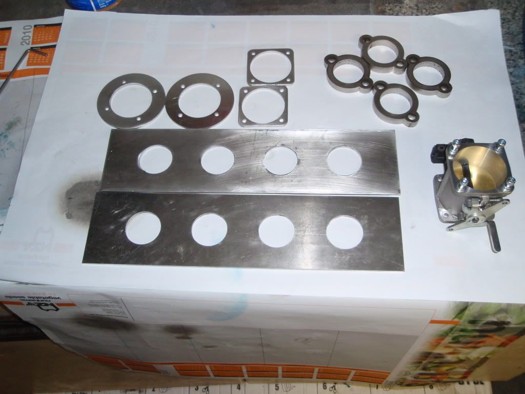

And drew up and had cut some profiles for a plenum and exhaust flanges:

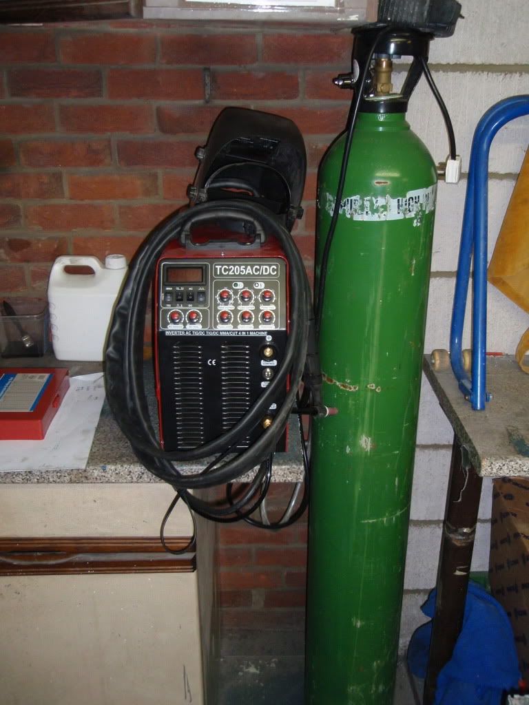

And brought a TIG to stick them together with:

well done mate, nice bit of machining there, did you have the flanges laser cut?

Yeah, we order £1000's worth through work each month so i can get them at very reasonable prices lol. The exhaust flanges were the only expensive ones at £4 ish each for 10mm stainless. Let me know if you want any and i'll sort them out for you.
I have johnk at specialist components to thank for the engine blockmachining, very good job indeed. And i managed to knock up the buttons.

yeah i may get you to get some exhaust flanges for me as i will have to make my own turbo manifold and a plenum chamber but im hoping to make the latter at work out of carbon if im allowed.
