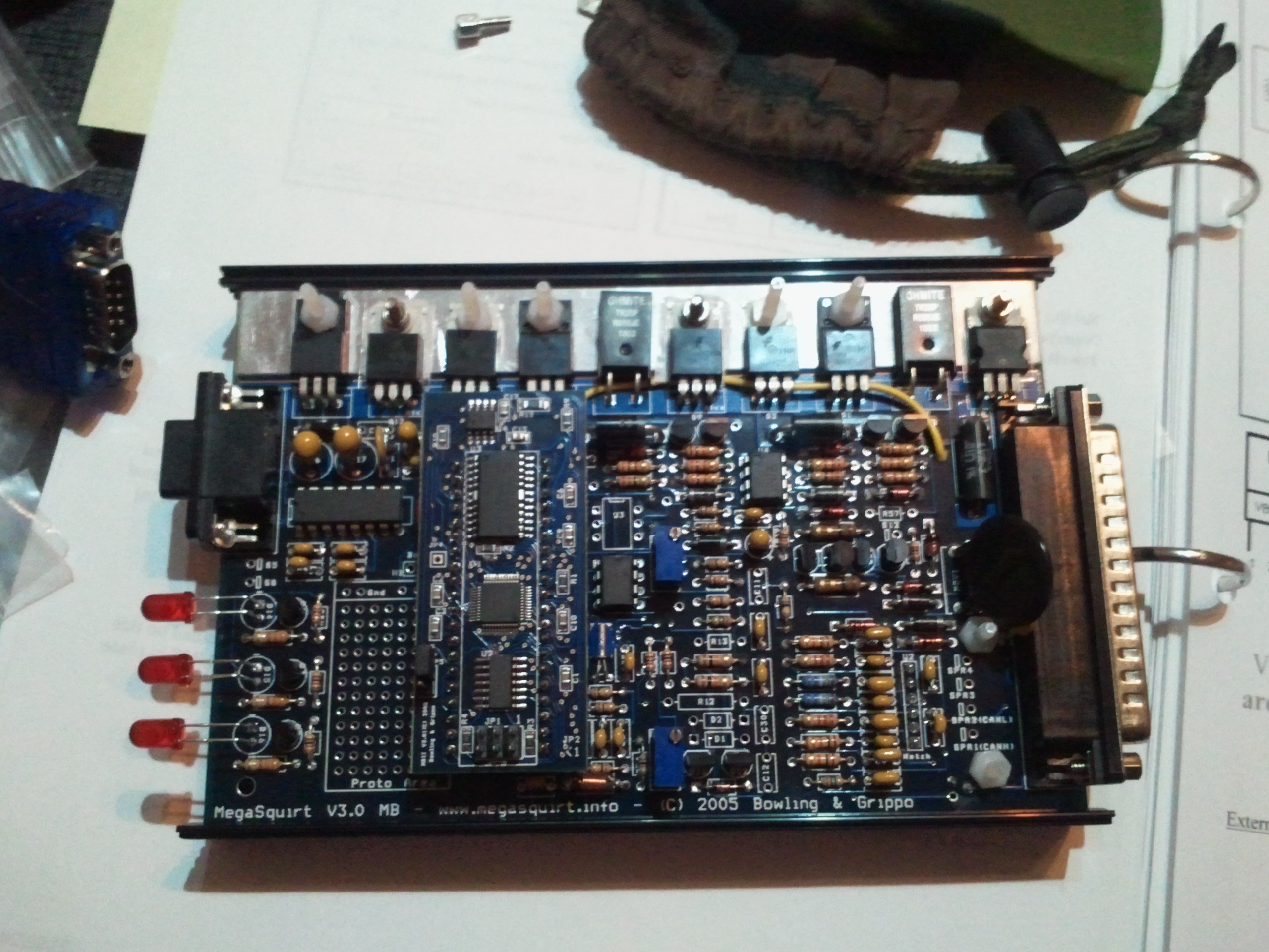

day 3 of the 3 week holiday, megasquirt is built and i enjoyed every second of it, extremely well layed out kit, but im sure we all know that by now, an order gone in with jean for the injector/ignition board and a couple spares
i built it up entirely, but some of that is coming back out now i have done alot more research and know exactly what i want left in, note the injection stuff is staying *wink*

Looks a tidy job, well done.
That is something that I've never done. Sturgeo has done our last couple.
Are you going to leave in the hall/opto input circuits for the cam sensor?
Brett,
Very neat soldering.
I won't repeat what I think you already know that 1/2 of it isn't required if you use Jean's driver boards.......
BUT - make sure you physically remove the minimum amount of components listed on Jean's website or you will create a 12V to 5V link and destroy the CPU if you set it up in 2 channel mode.
What's the yellow wire (top middle/right) for ?
Sorry, being far too negative......
the hall/opto circuit is actually the only bit i didnt put in, it wasnt until finishing the vr circuit i realised you can physically choose between them via jumper wires
On 15th Mar, 2011 Rod S said:
Brett,
yes Rod your right but it wasnt untill building up the main board that things started to fall into place ( in my head) jeans board was an after thought, and honestly i was only looking for another BIP373 for 4cyl wasted spark
the yellow wire i believe selects between logic level output and igniter output onto the DB37 for the directly driven single coil option

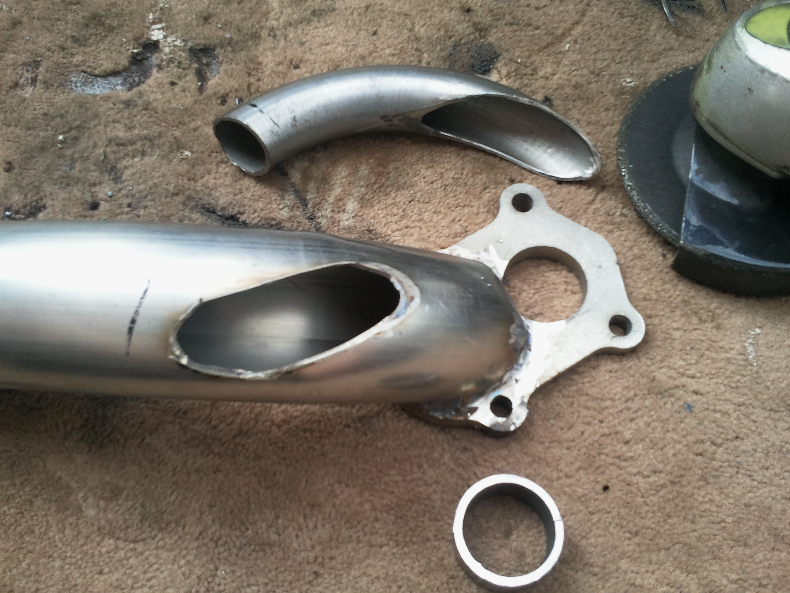

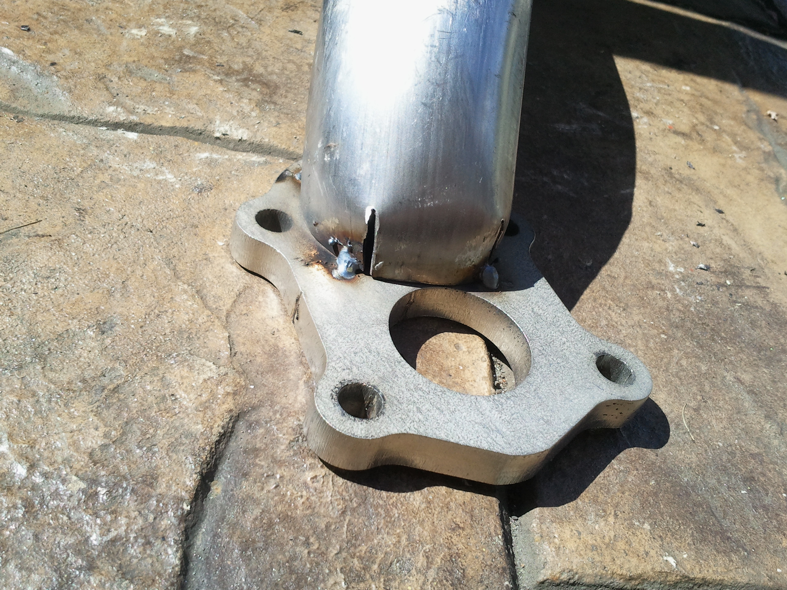

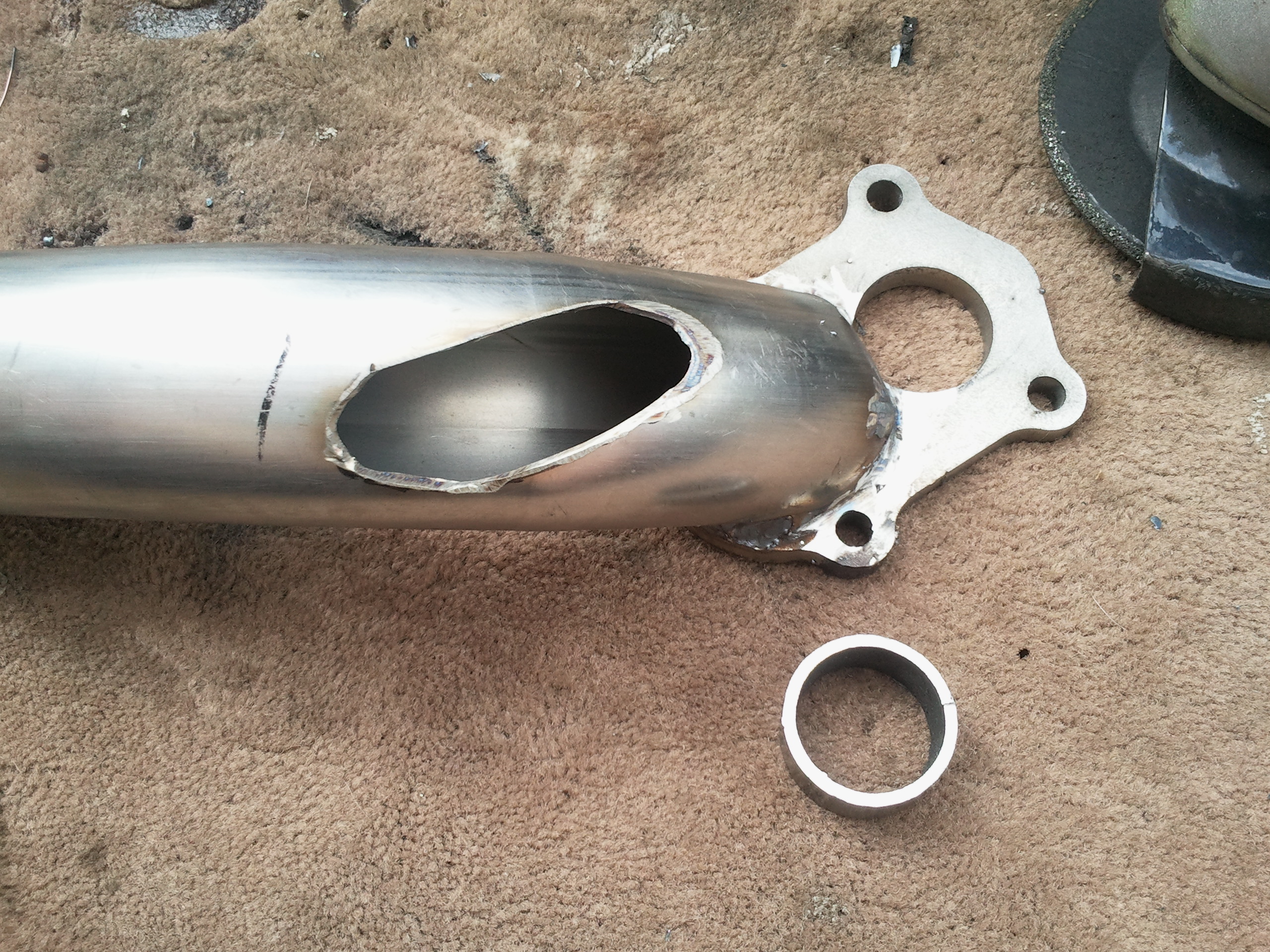

well today after i managed to get some energy together i started on the manifold, intentionally this was going to be a full manifold finnished off and running and then remade in stainless but after realising the old tubes i had ( an old lcb) was actually 3 different diameters i have decided to call it a day on this one.
My longest 'runner' if thats the right word id almost half in more in diameter :(
first of all i am not going down the equal length runner route for 2 or 3 reasons although i have absolutely bags of room it seems there may be a v3 mani
anyway here are a couple of the the pics
looks a good start. I have an old lcb if you want more tubing
hmm what diameter is it andy? dunno if its worth just pikie-ing up this till its finnished
i think on my next manifold will tuck the runner from cylinder 1 up higher, there is alot more room under the inlet manifold than i first thought.
Edited by Brett on 1st Apr, 2011.
It's 2.5" all over apart from the branches of the Y which are 2.4".I've chopped one side of the Y of for my mock up.
2.5 inch? u sure?
1.5" *blush* Need to do measuring before drinking beer...

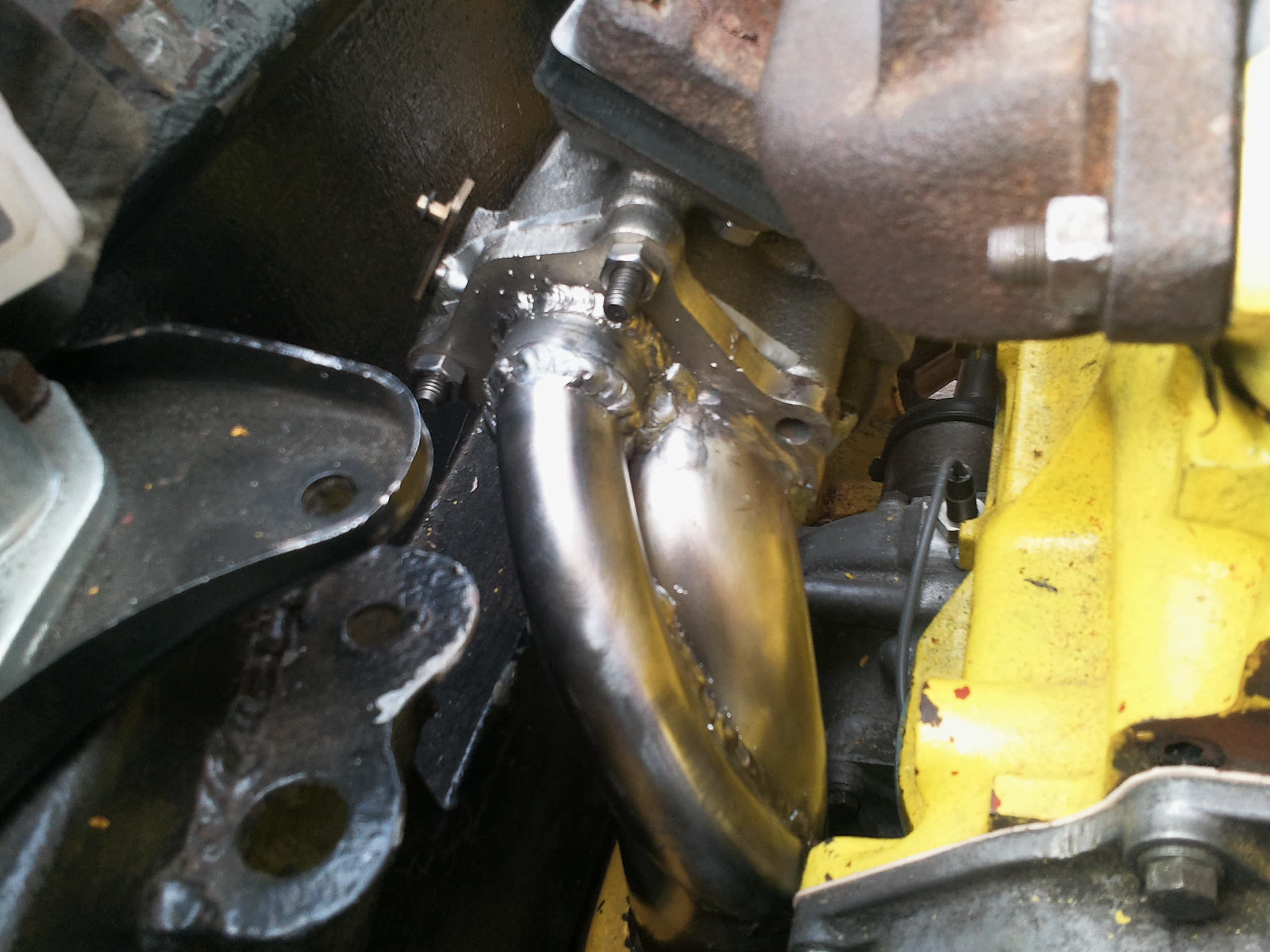

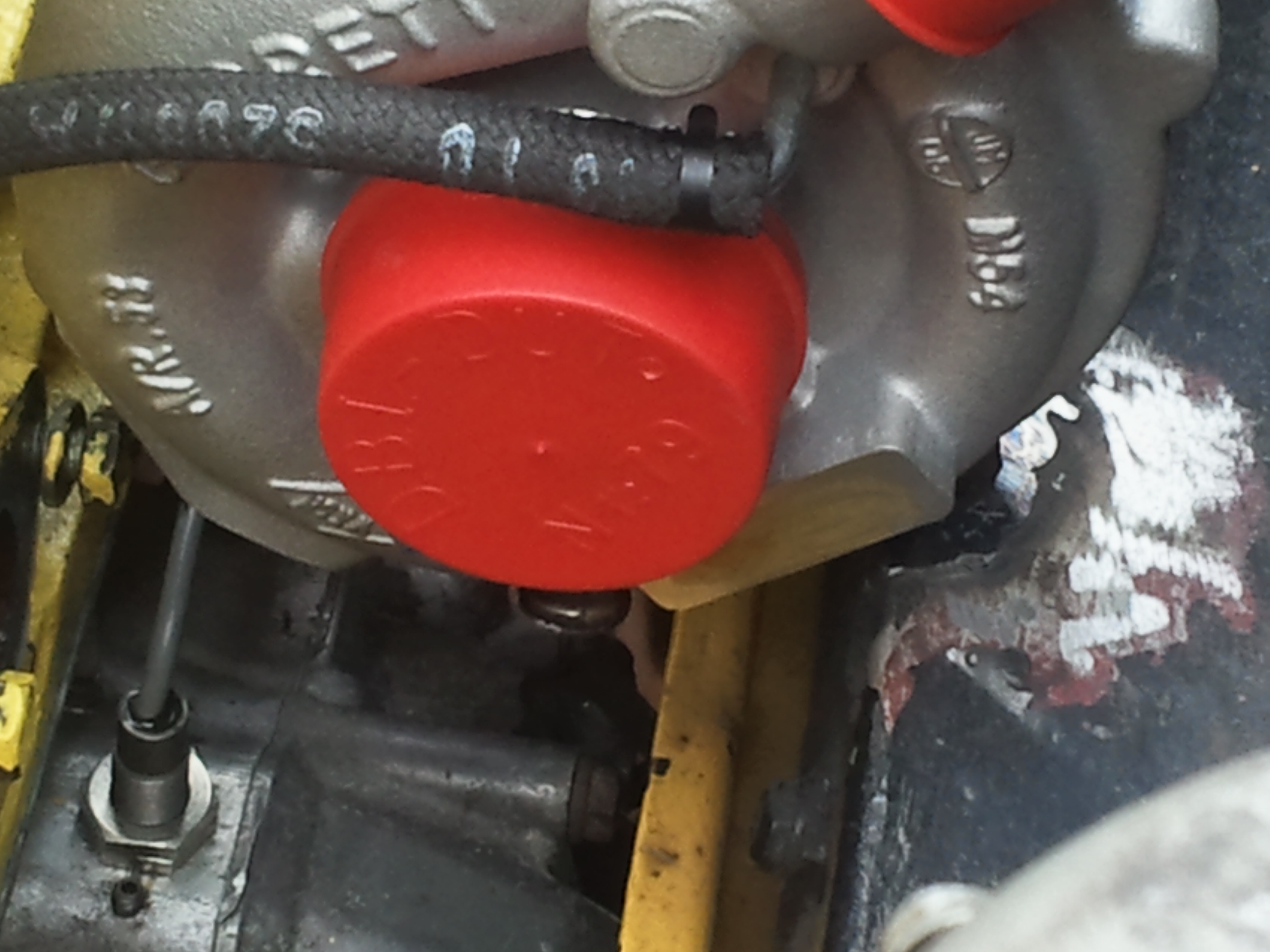

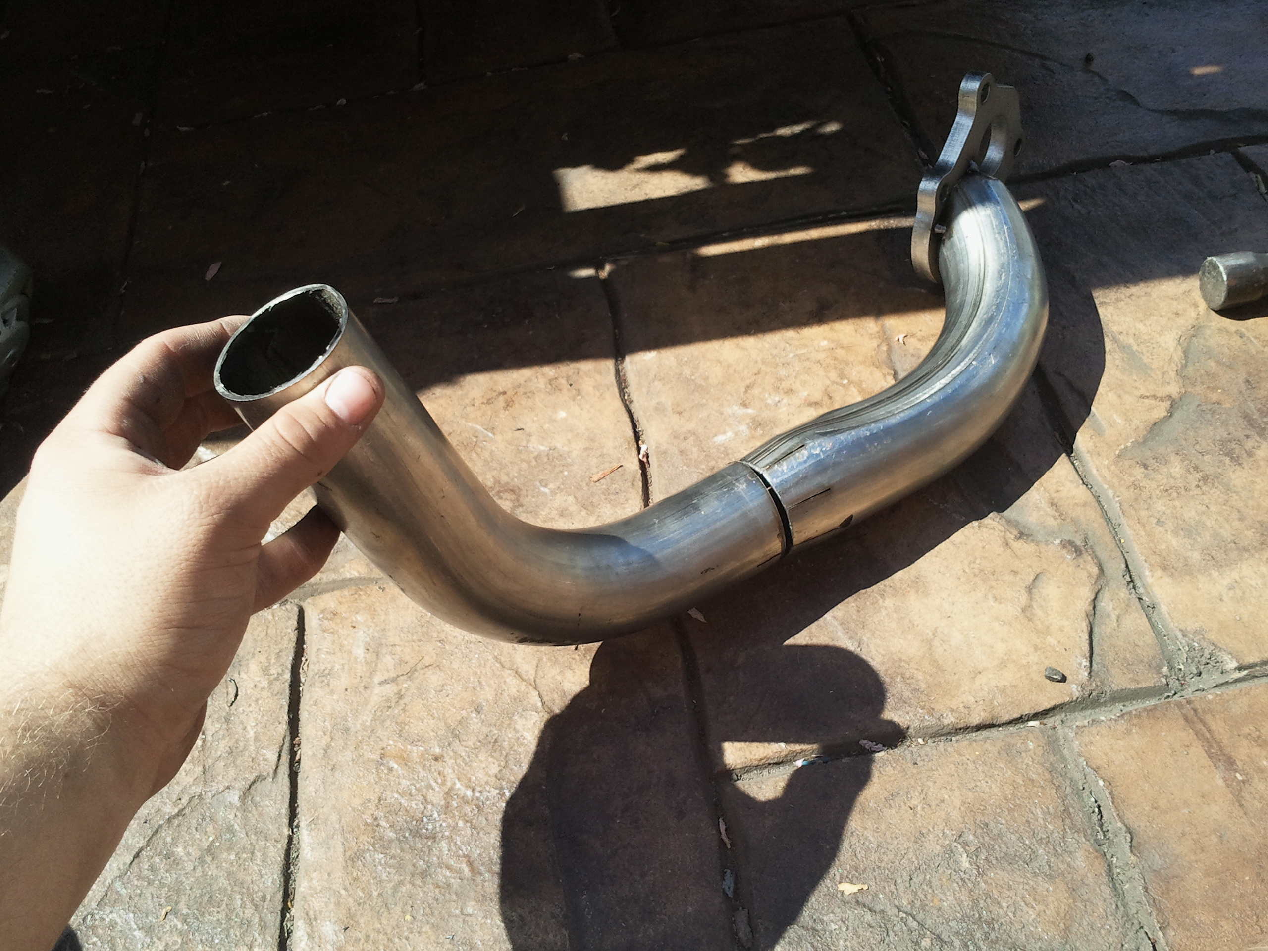

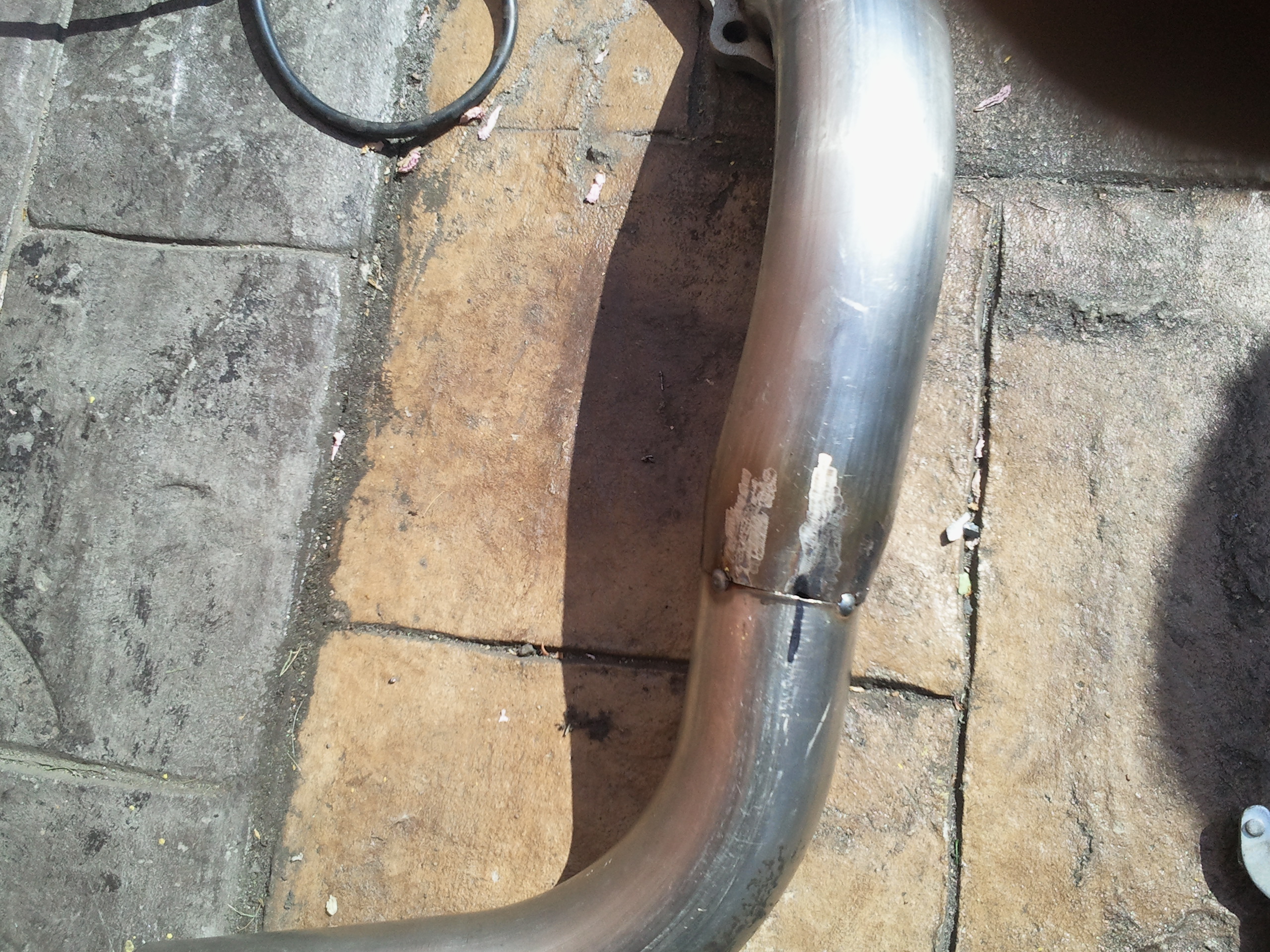

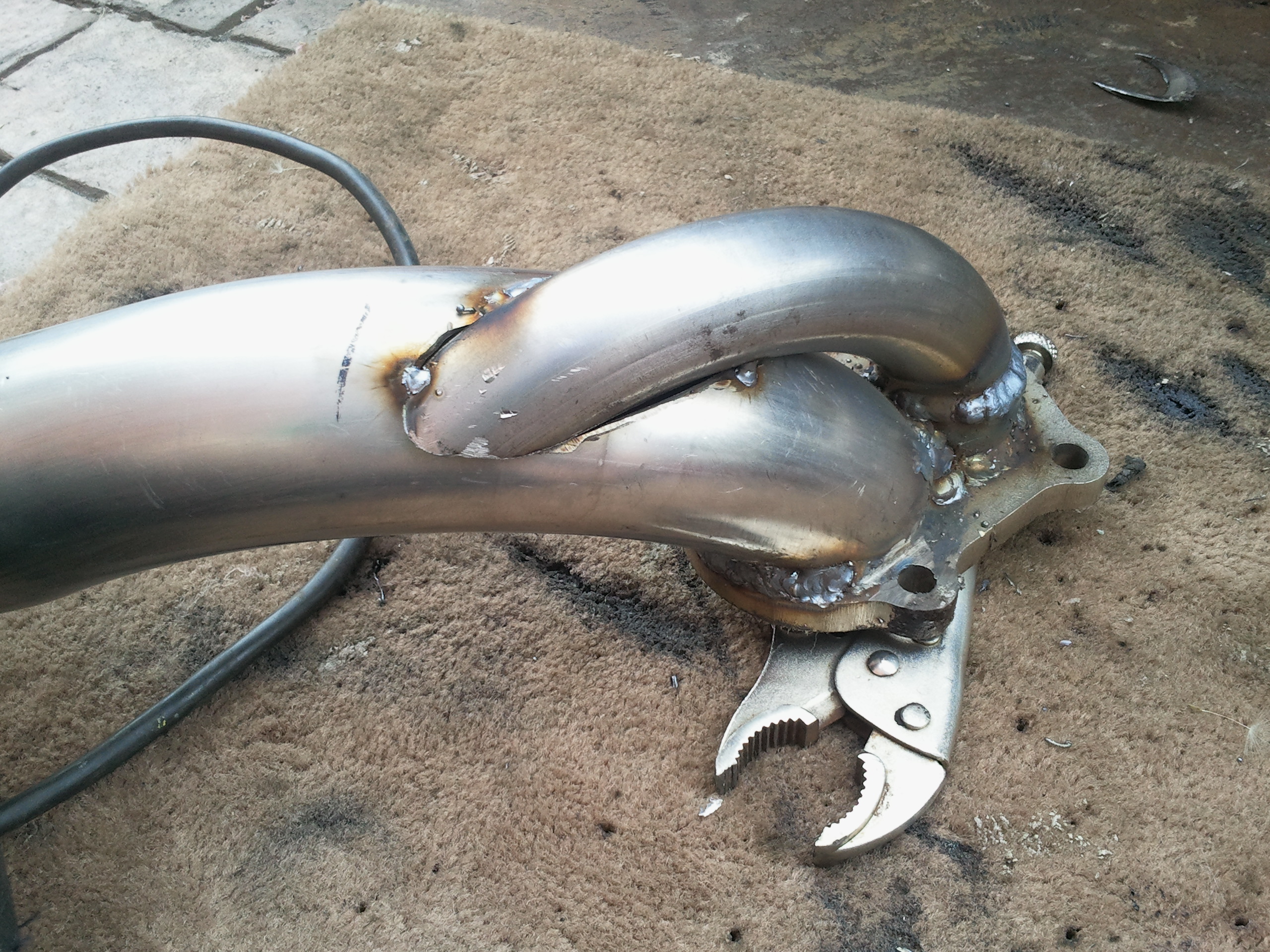

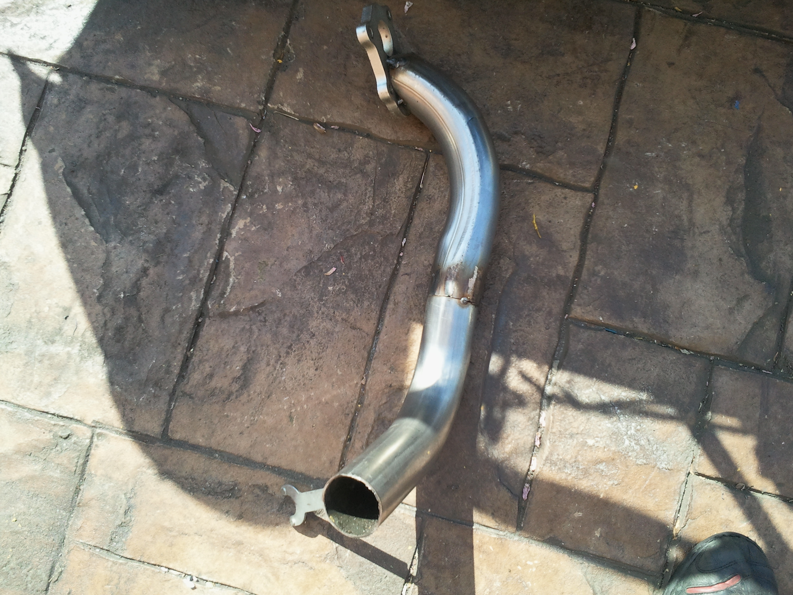

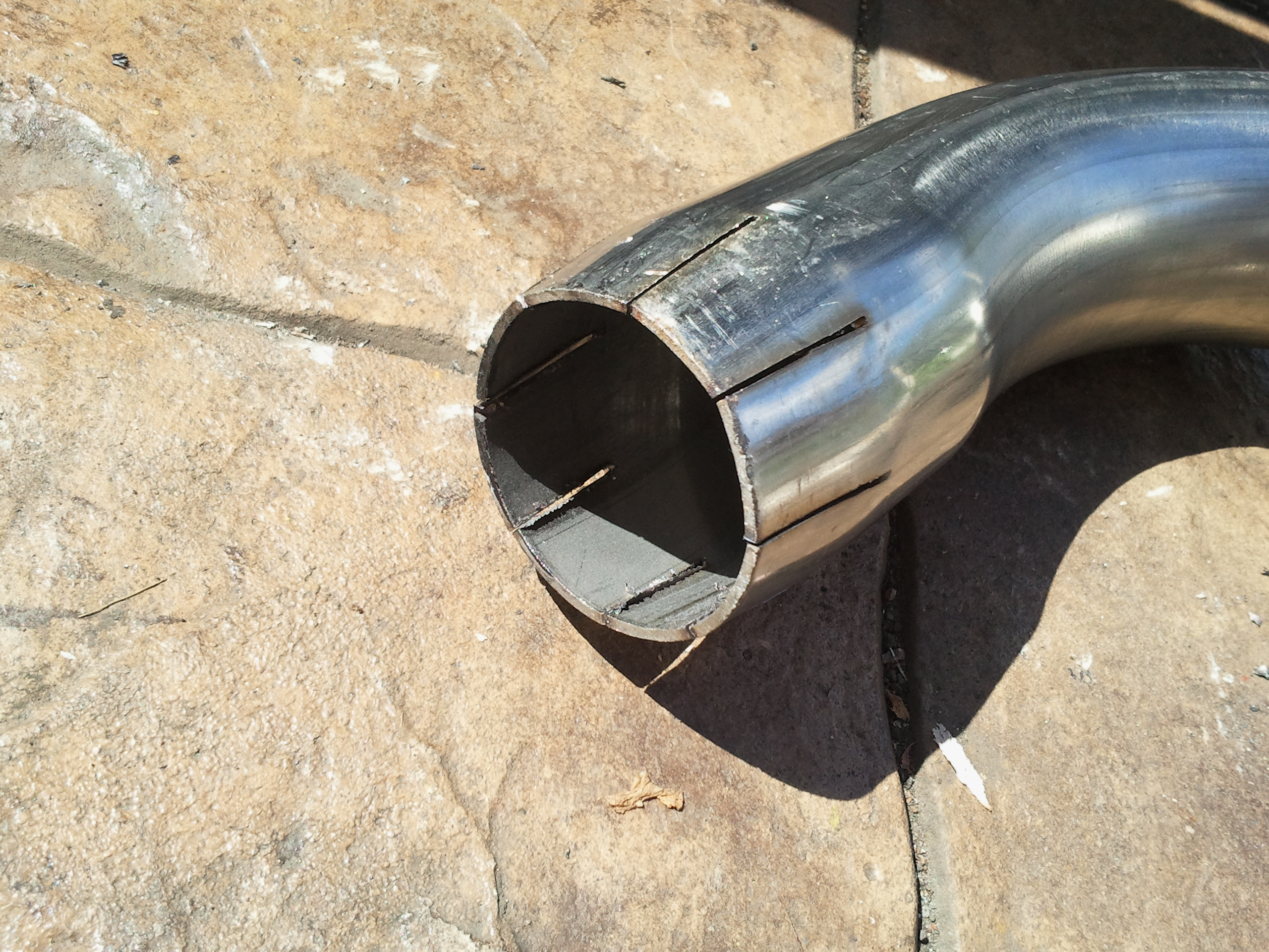

well after calling a few favours, and to save time and money the GT20 has gone down the back of the block, tbh im surprised how easy it was apart from a couple pissed up manifold studs *happy* the job is a beauty, downpipe went well, just a dump tube to make now
its 2.25 to just above the pot joint then 2 inch for the second bend
[edit] its actually a deformed 3 inch bend for the first bend down
Edited by Brett on 28th Feb, 2012.
I think that might blow a bit...

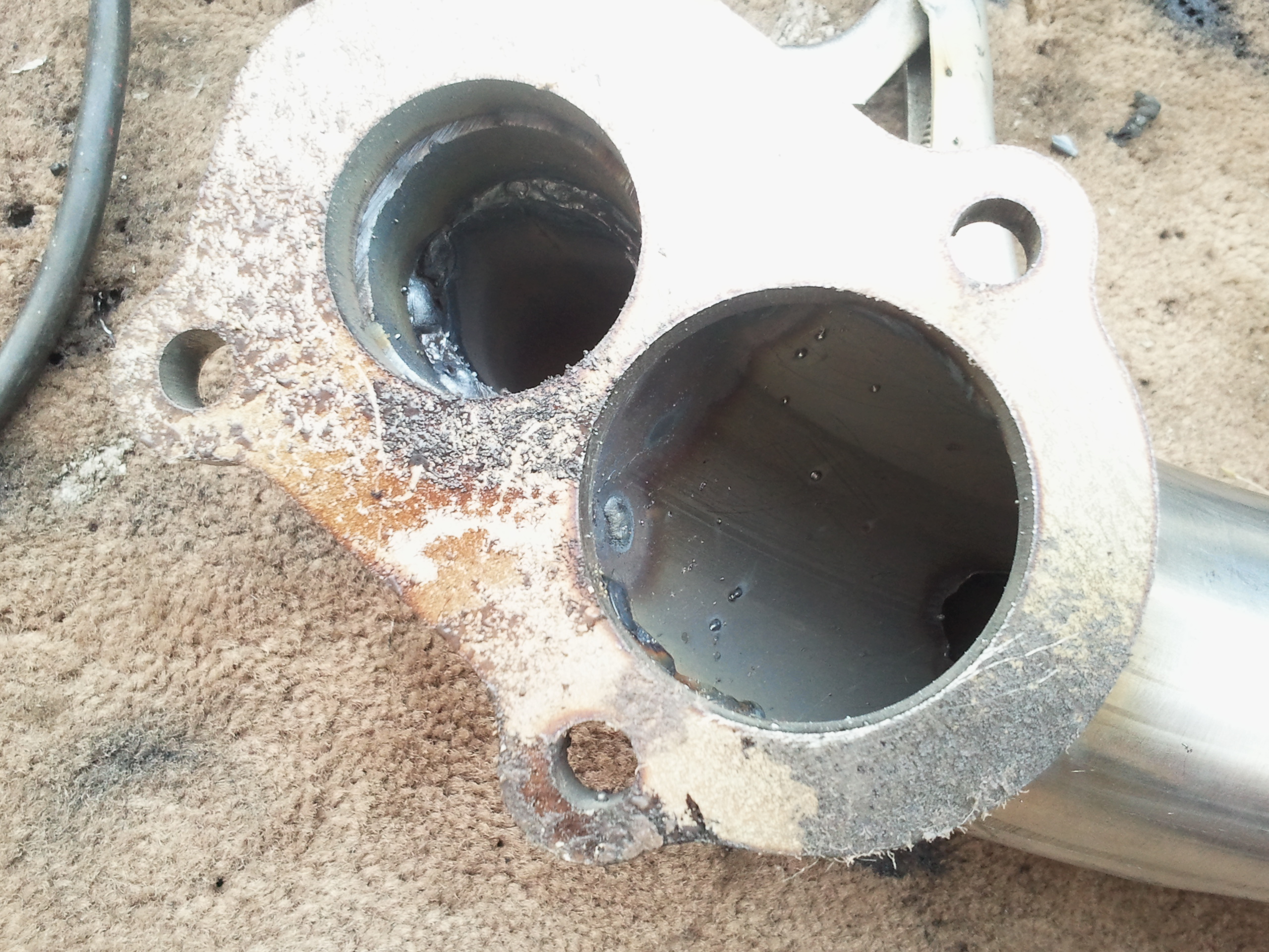

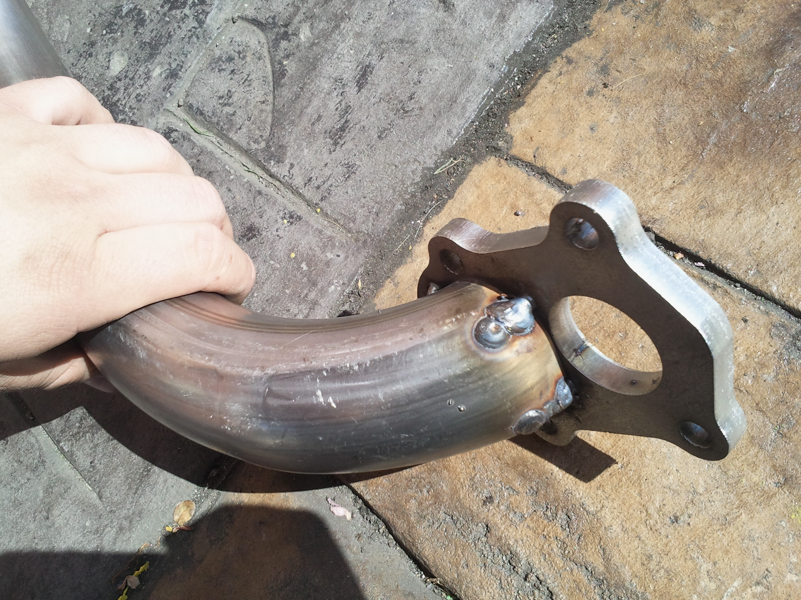

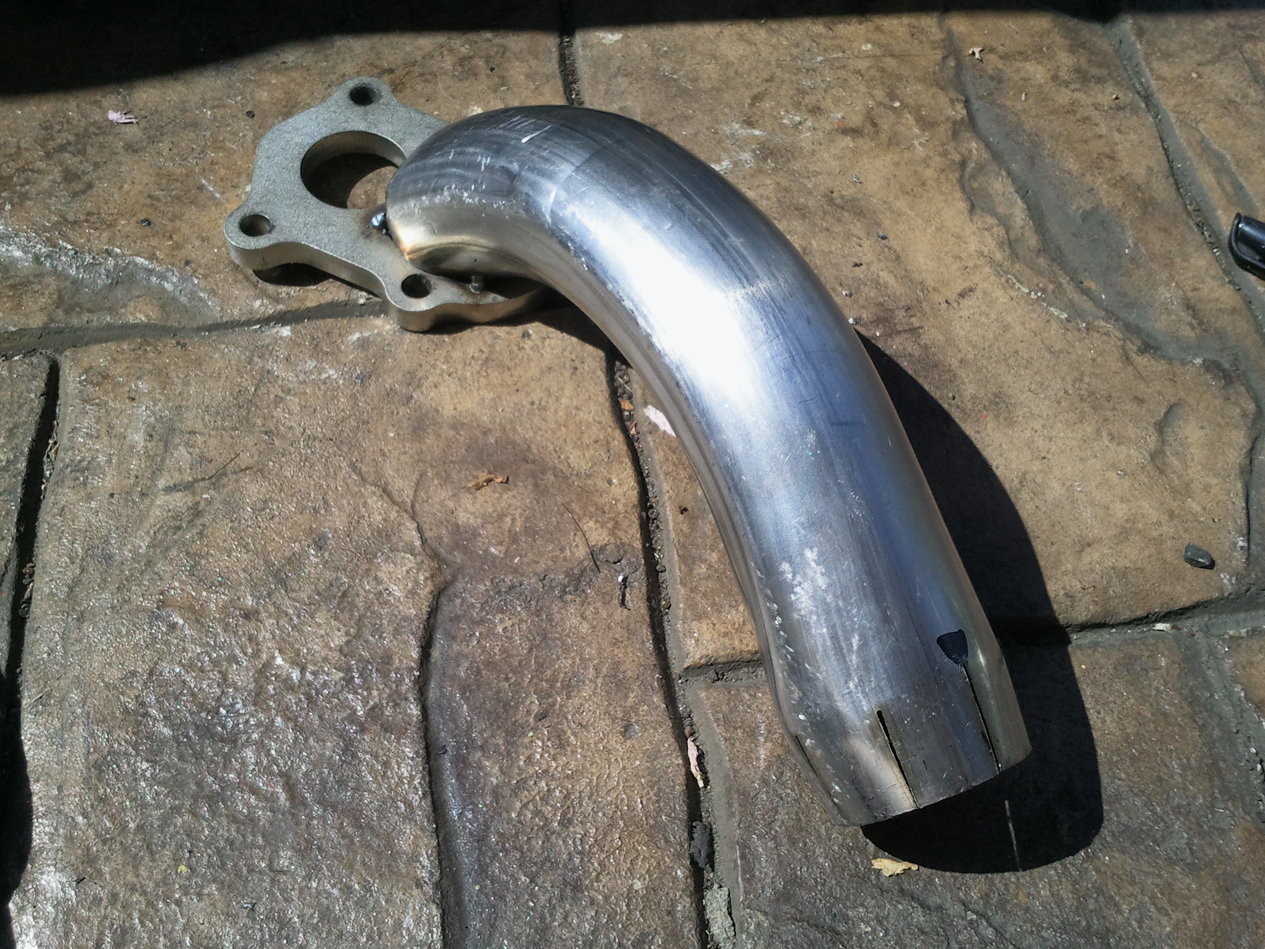

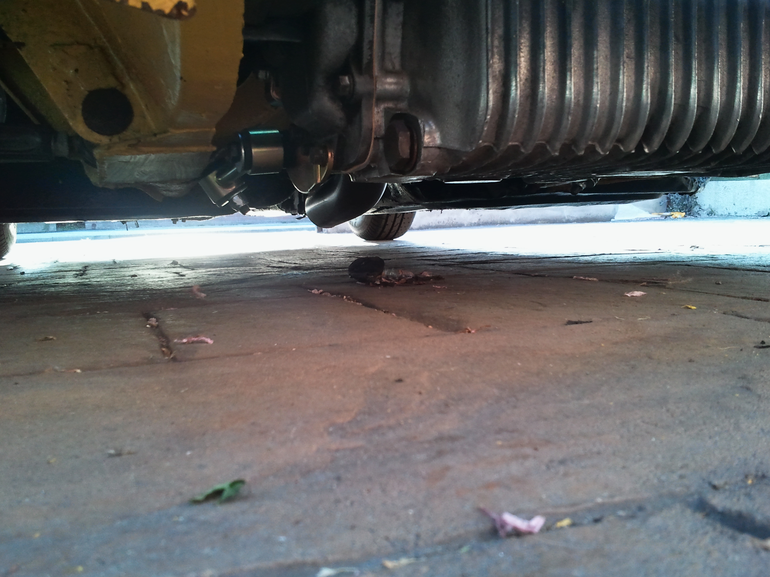

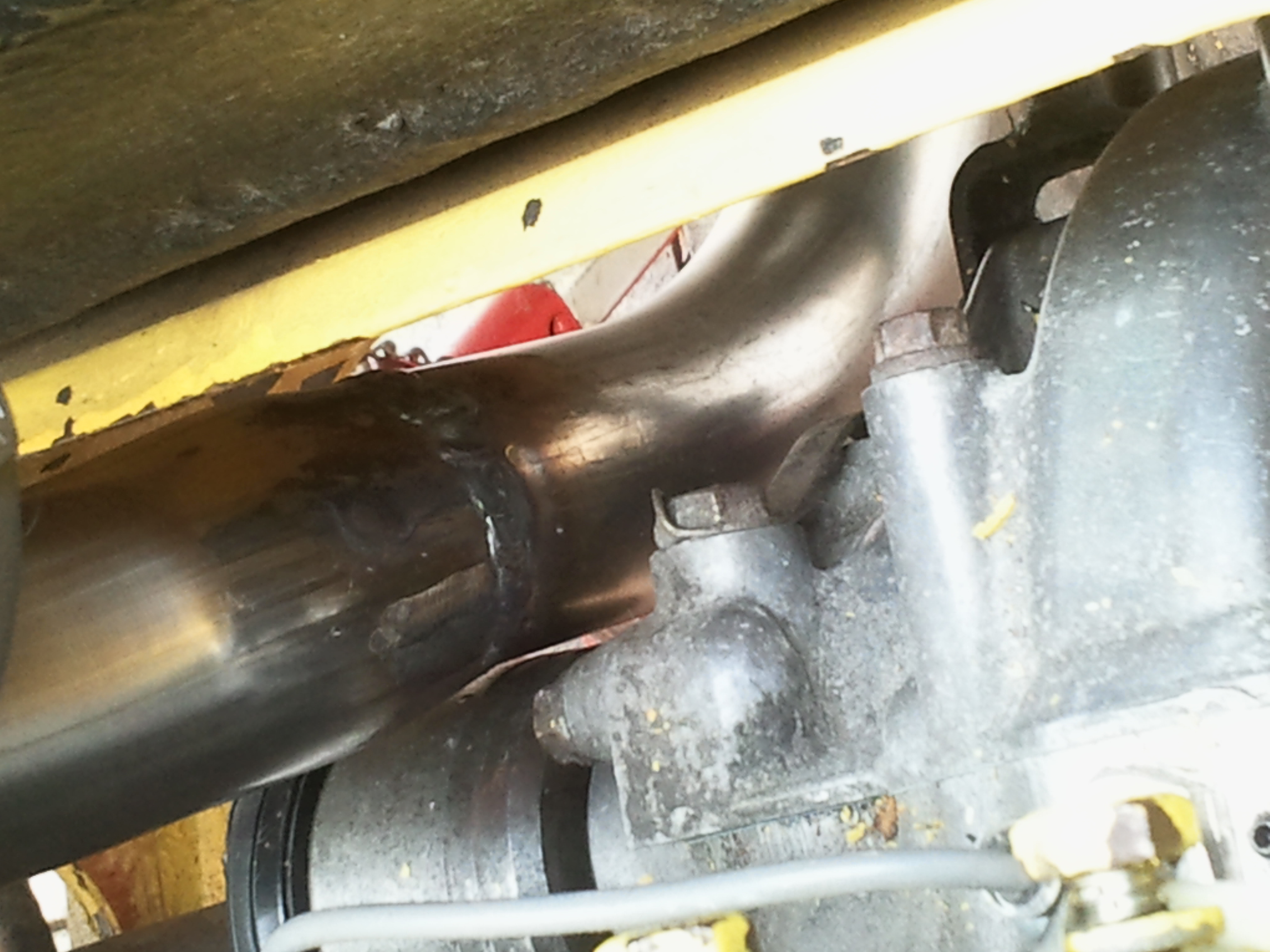

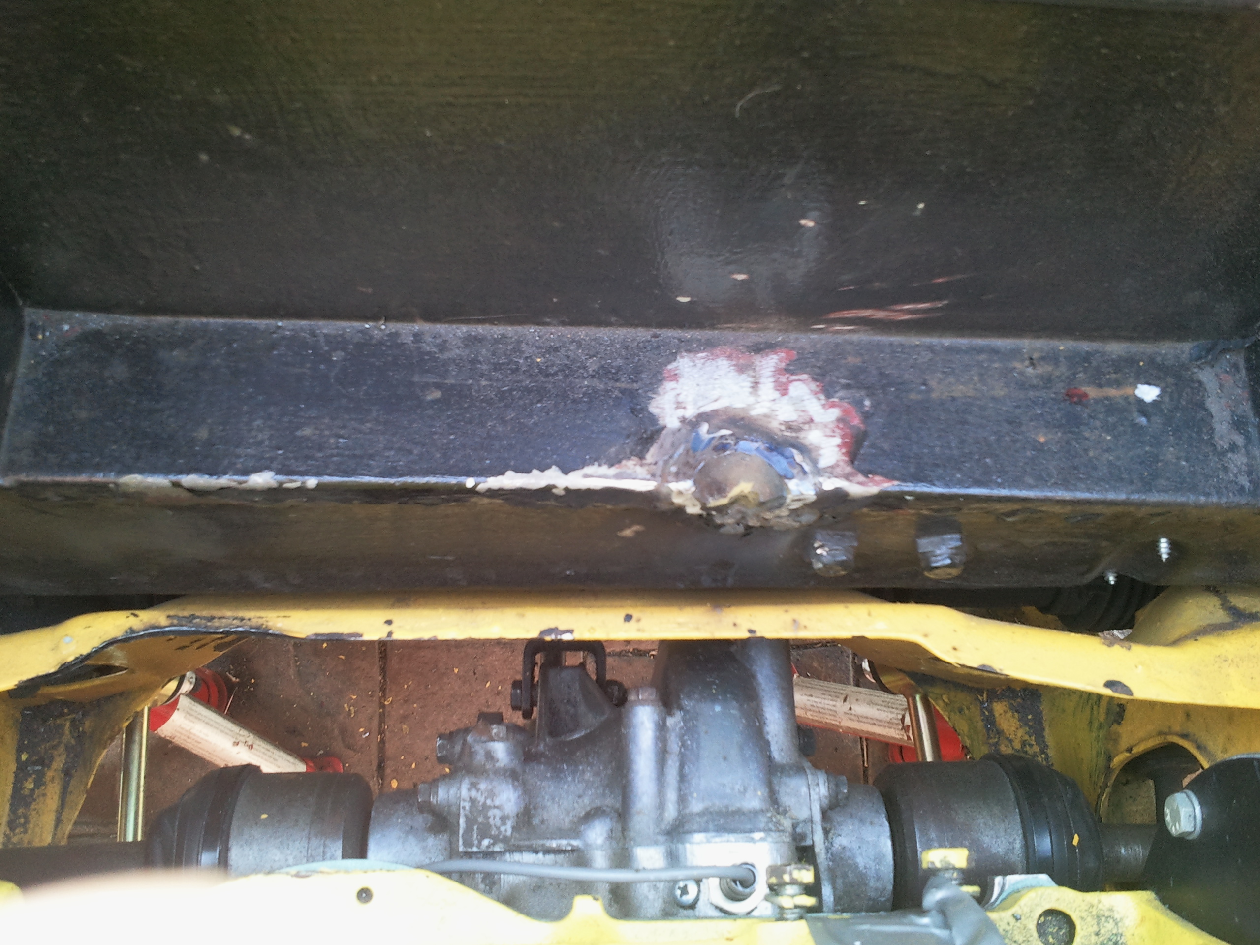

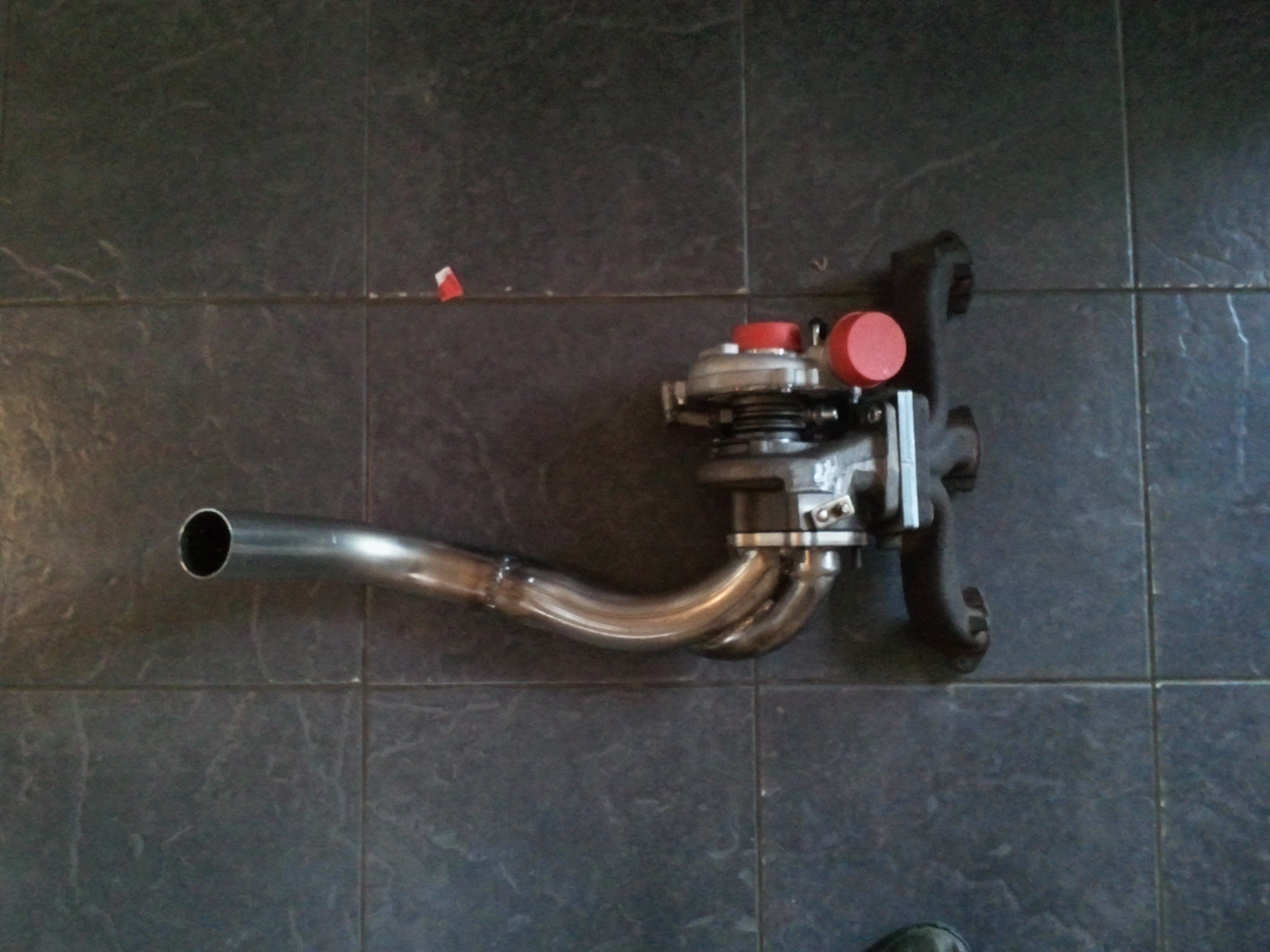

downpipe is done
the clearance on the pot joint, well its tight *tongue*

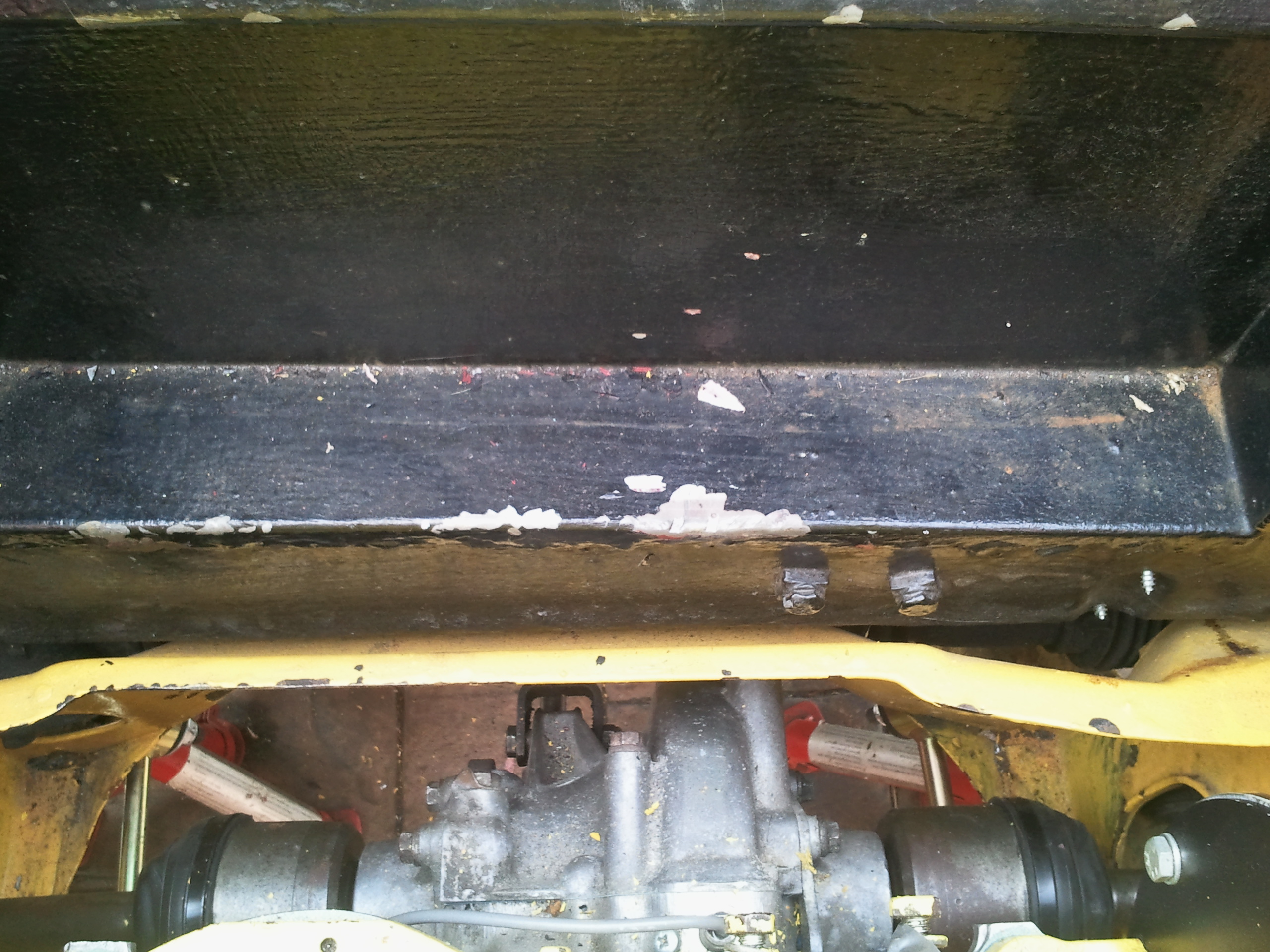

and the turbo hit the bulkheadbox and a big hammer did not sort it*happy*
Edited by Brett on 28th Apr, 2011.
half a section of pipe sorted the clearance on the turbo compressor

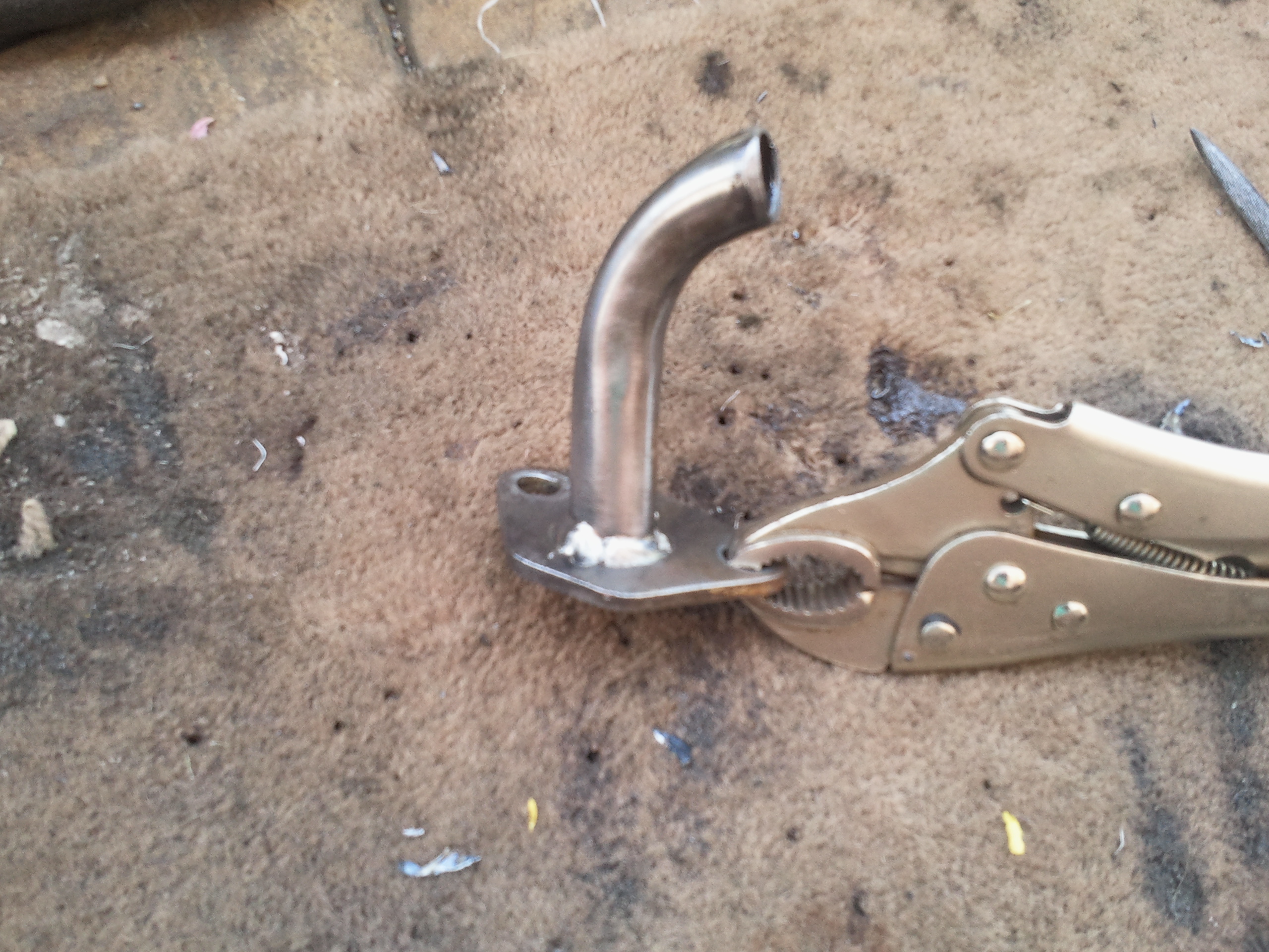

a cheeky oil return pipe made from an oil pick up pipe *happy*
all it needs now is 10 mins with a die grinder and one weld dressing back

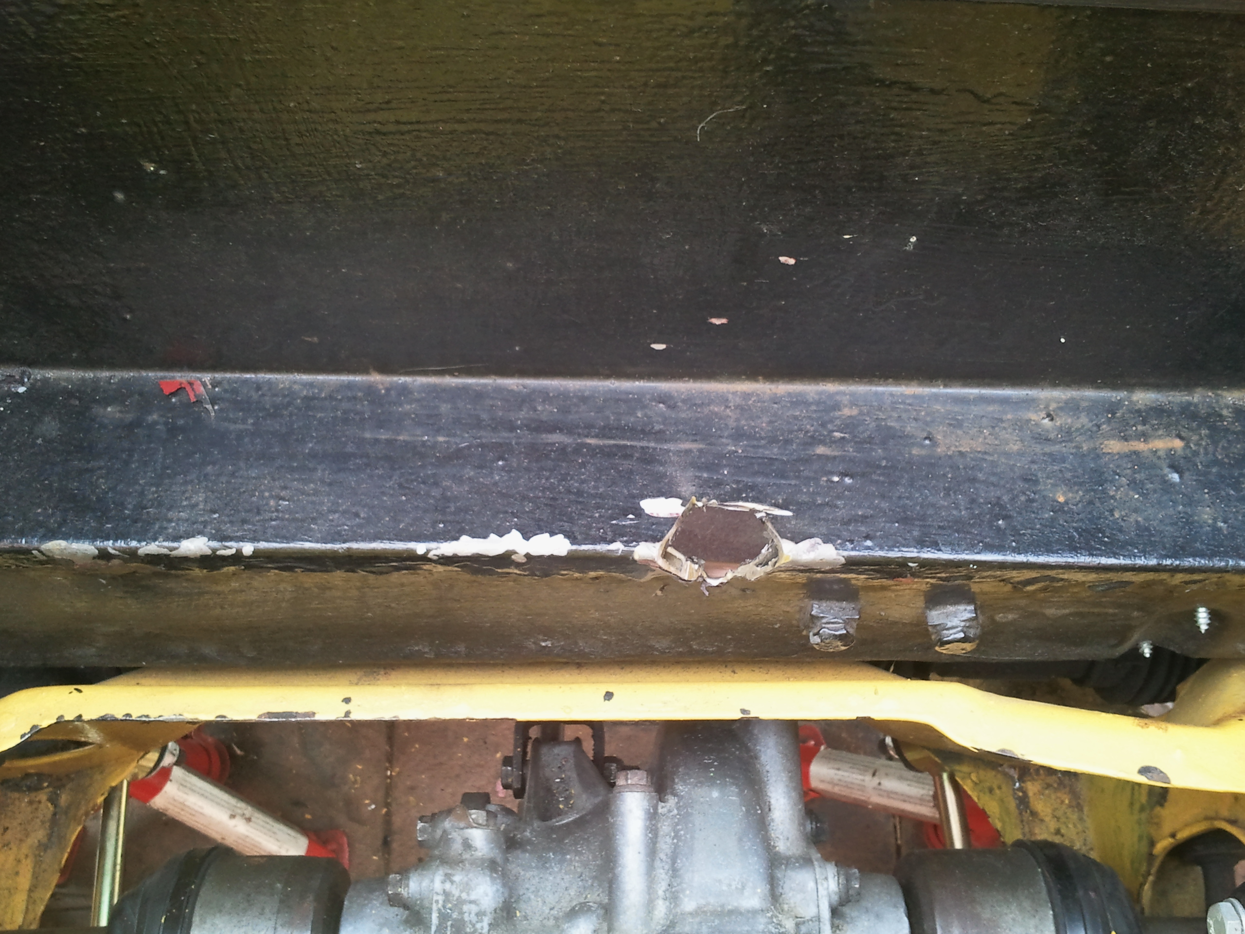

i did have 2 inch ground clearance i now have 1 and 3/4 inch *happy*
and i think the best bit the whole lot can be fitted and removed without moving the engine *happy*

That downpipe looks the nuts mate
