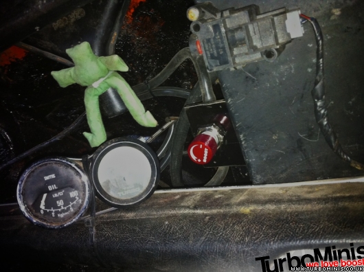

So, today I finally spent a bit more time on the car. I have tapped into the inlet manifold and put a line to the DV from there (instead of the other side of the butterfly where it was before). I installed an adjustable boost bleed valve, and made a little hack to make it limit the boost when fully open, as well as still giving some boost when fully closed. I can adjust both ends of the scale too :) (and without the faff of adjusting the actuator) so that's pretty cool. I am sure there are better ways to do it, but it works and I'm happy with it. I also made a little mount out of Ally, and mounted the bleed valve thing in car (with the 'excess' being taken back out of the cabin).
So, it's now running that 5.6psi when the valve is fully closed for day-to-day plebbing about, and when fully open it's currently 12psi. I am going to gradually raise that as I use the car, as I am already enjoying the hike to 12, going up to the 16ish is going to be fun! :)
I also adjusted the firmness on the shocks and have it firm, but not back breaking, but also firm enough to stop the wheels scrubbing on the arches - perfect.
Here's a snap of it mounted in car. Ignore the mess, I know I need to clean it, but if you saw the state of the interior you'd realise why I haven't *wink*
