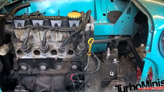

Right time to revive this thread. Ive decided ive had enough of leaky smelly a series and gone to leaky smelly vauxhall instead :) Managed to get a decent 16se 1.6 8v from a disastra. Came with loom and everything to go, so me being me binned it all and bought a pair of twin 40s haha. Looking to use the NoDiz system and get the old gal up and running for some enjoyment before the years out.

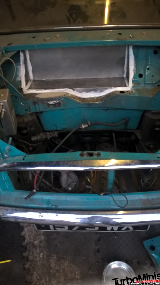

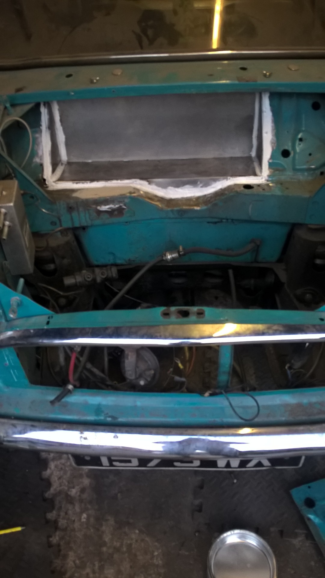

Done a bit on the bulkhead today
Webers should fit nicely.

Thought I recognised your avatar, you messaged me about my 16se. Did you get the other one that was up on 16v forum?
In your broke down photo, what wheel combo is that with those miglias?
Look forward to your progress.

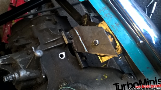

Are you welding a shifter box into the lower fire wall or are you binning the plasticy looking Vauxhall linkage?
7x10 force wheels, erm i literally cant remember the message haha. Yes im going to weld in a box.

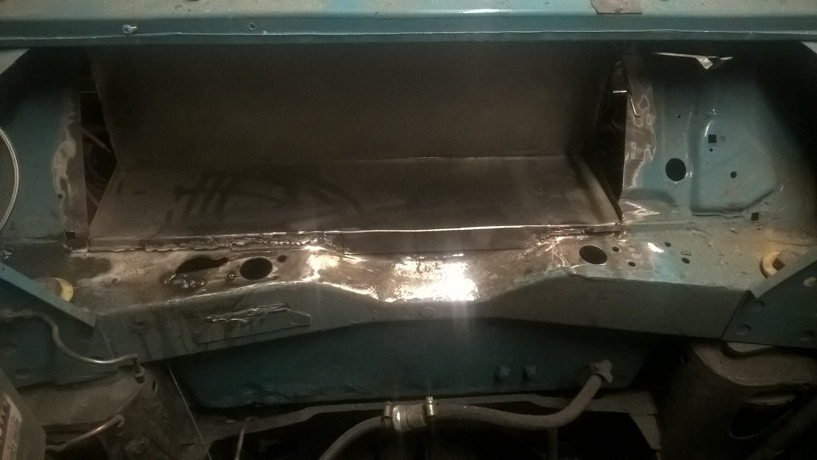

Finished off the bulk head box and seam sealed up to ensure no leaks
Looks good mate, you must have lots of time on your hands to have two projects on the go!

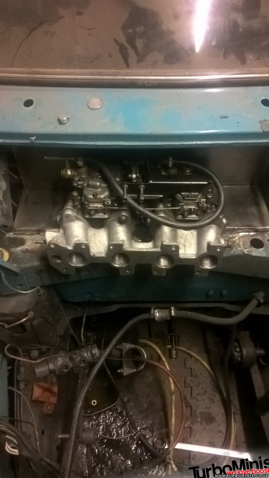

Its in!
tight but it fits
It might be tight but it looks good
Well done Mike you don't fuck about, but pissing webers WHY. It will make about the same power, use half the fuel, and be far more tractable and drive able on the injection. Perfect for a reliable daily that will start, idle, etc on its own come sun or snow.

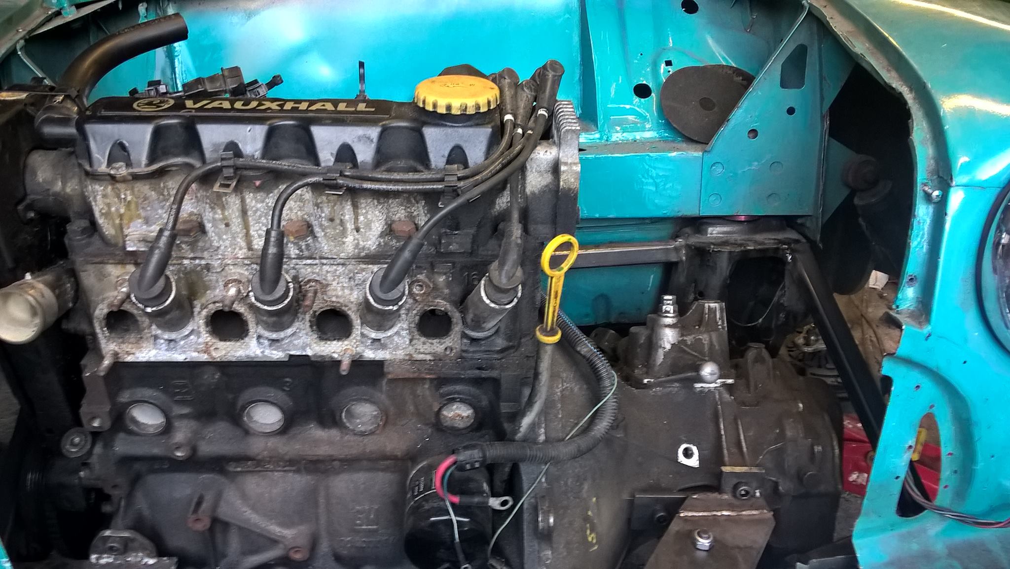

Yes mate, ended making one in the end. Wasn't too difficult. Hardest part was having no engine lift so had to man handle the fucker in.

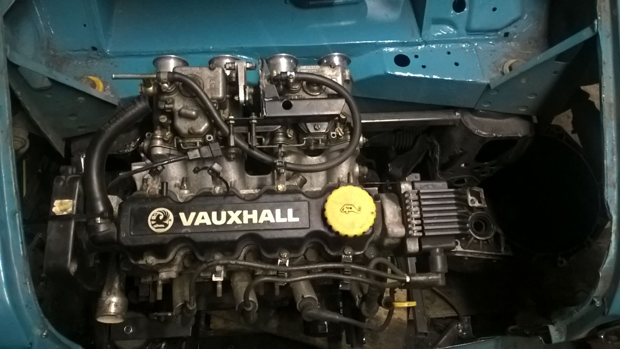

This engine is the lesser powerful 1.6, the c16se produced about 100bhp, however this is the z16zr or something there about which produces about 75bhp, the main differences being the inlet manifold and tb, which is restrictive for emissions purposes. Therefor id have to get the inlet and ecu from the c16 which are getting pretty hard to acquire these days. So when these carbs popped up on the correct manifold for £250 it seemed the obviously choice really.
Ill utilise the onboard Coil pack and run the Nodiz system. The Project title is a little misleading these days, as its more like "Project not a ridiculously wide Stupid fucking volvo engined mini"

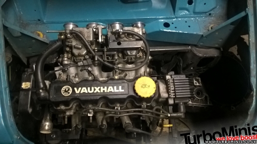

Finally got the engine and subframe fitted today. Bit of a pain in the arse without a engine lift but we managed to handball it all in.

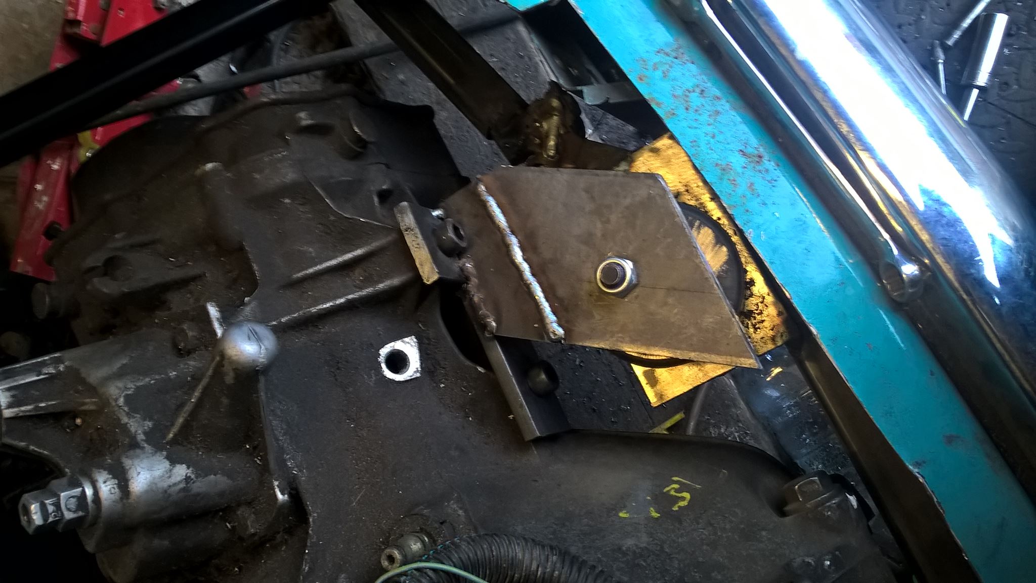

Fabricated a little box and got it welded into place.

Started on the airbox today, a bit fiddly as the engine sits a tad lower than I first anticipated.
