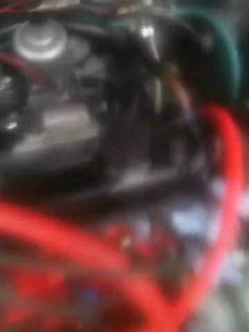

AA man is on the way, as none of the garages locally were willing to come out to do it. Here's a quick vid of it running badly, you can hear it struggle and pop.
In the mean time I fitted the shiny new stainless fuel lines.
