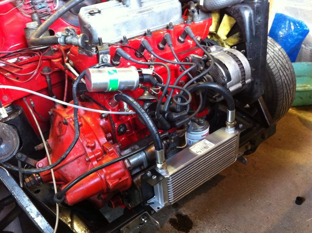

I fed my oil feed round the clutch Side and passes above the exhaust down pipe from the turbo hope it doesn't get to hot, anyone else done this?

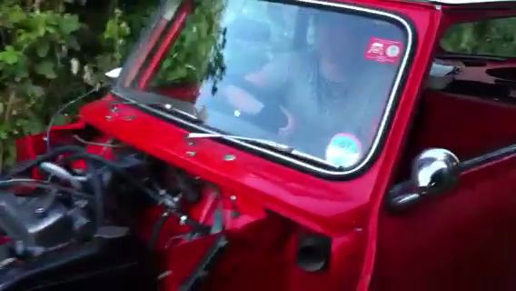

Engine is running I know no one will believe me but fired first turn of the key. Wahooooooo
VIDEO
http://i998.photobucket.com/albums/af107/j...ul/d91584e9.mp4
Edited by Jimmyful on 15th Jun, 2012.
Jimmyful
163 Posts
Member #: 9865
Just need to fit the exhaust *smiley*

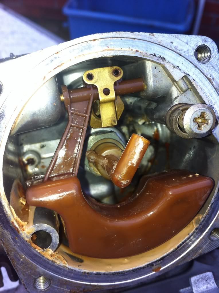

Ahhhhh bad news, had fuel pissing out of the part lean throttle off doofer.
Time to rebuild it I think, first time iv ever rebuilt a carb. Just had a read through Tom Fentons how to guide. Credit were credits due This forum is ace cheers Tom.
Notice something wrong with this pic?

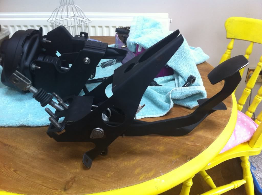

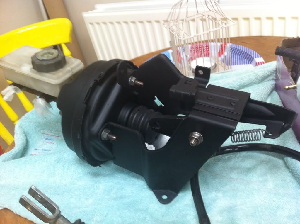

Got some goodies today.
Oil cooler mounted

It's missing the jet holder.
Might be worth doing this mod too whilst your rebuilding the carb:
http://www.turbominis.co.uk/forums/index.p...vt&tid=311&fr=0
Jimmyful
163 Posts
Member #: 9865
This is what I want to do, the only problem is I don't have the original part to copy.
Anyone have a spare one even if it's bust?

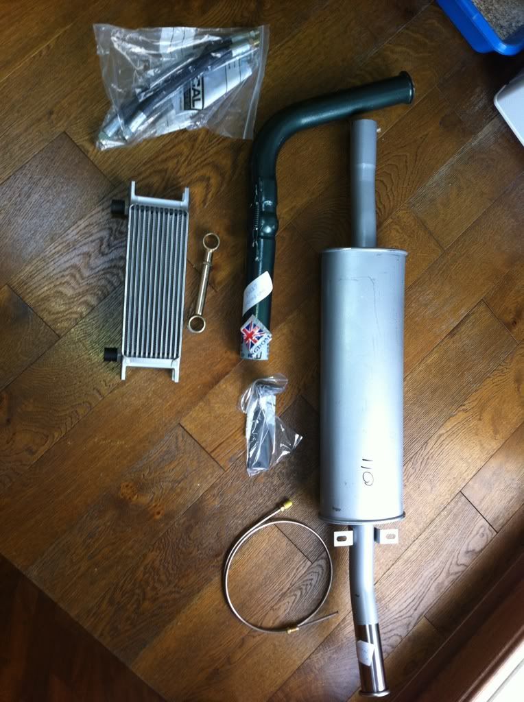

Some more goodies tonight.
