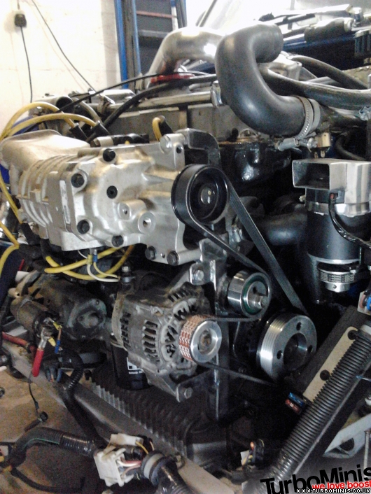

I finished off the new SC mount above the clutch cover today. The basic design is the same but moved about a bit to suit the 1275 block.
I also made a couple of ears to steady pulley end of the SC.
This is my 4th attempt at a tensioner for the belt system. This is the closest I've got to doing the job so far.

Hi I'me seeing that your having problems with the tensioner, with my blow though setup I used an timing belt excentric tensioner from a peugeot 106 petrol engine and its much more easy to install .

Wow how's that for convergent builds. *surprised* Thanks for the recommendation, do you know what year or 106 your pulley came from?

Hi I think its from 1.1 engine single cam, but I don't know the year

That tensioner looks identical to fiat uses on all fire engines in punto, cinq, sei, doblo, 500 and so on :)

Thanks guy, I think I've got Peugeot tensioner on the way. Gotta love the knowledge of this forum.
