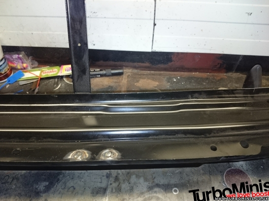

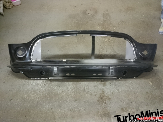

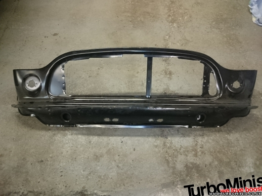

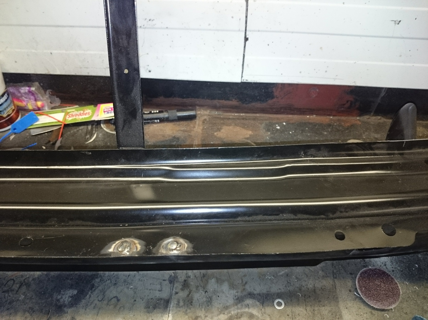

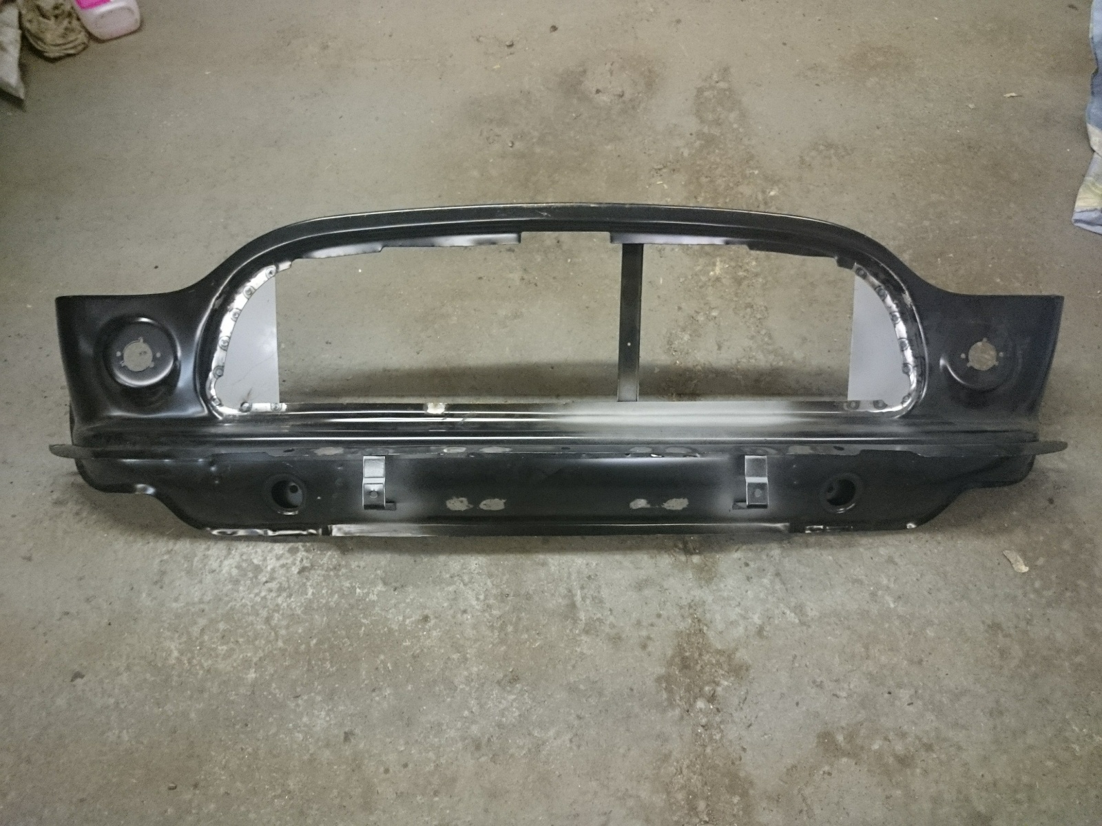

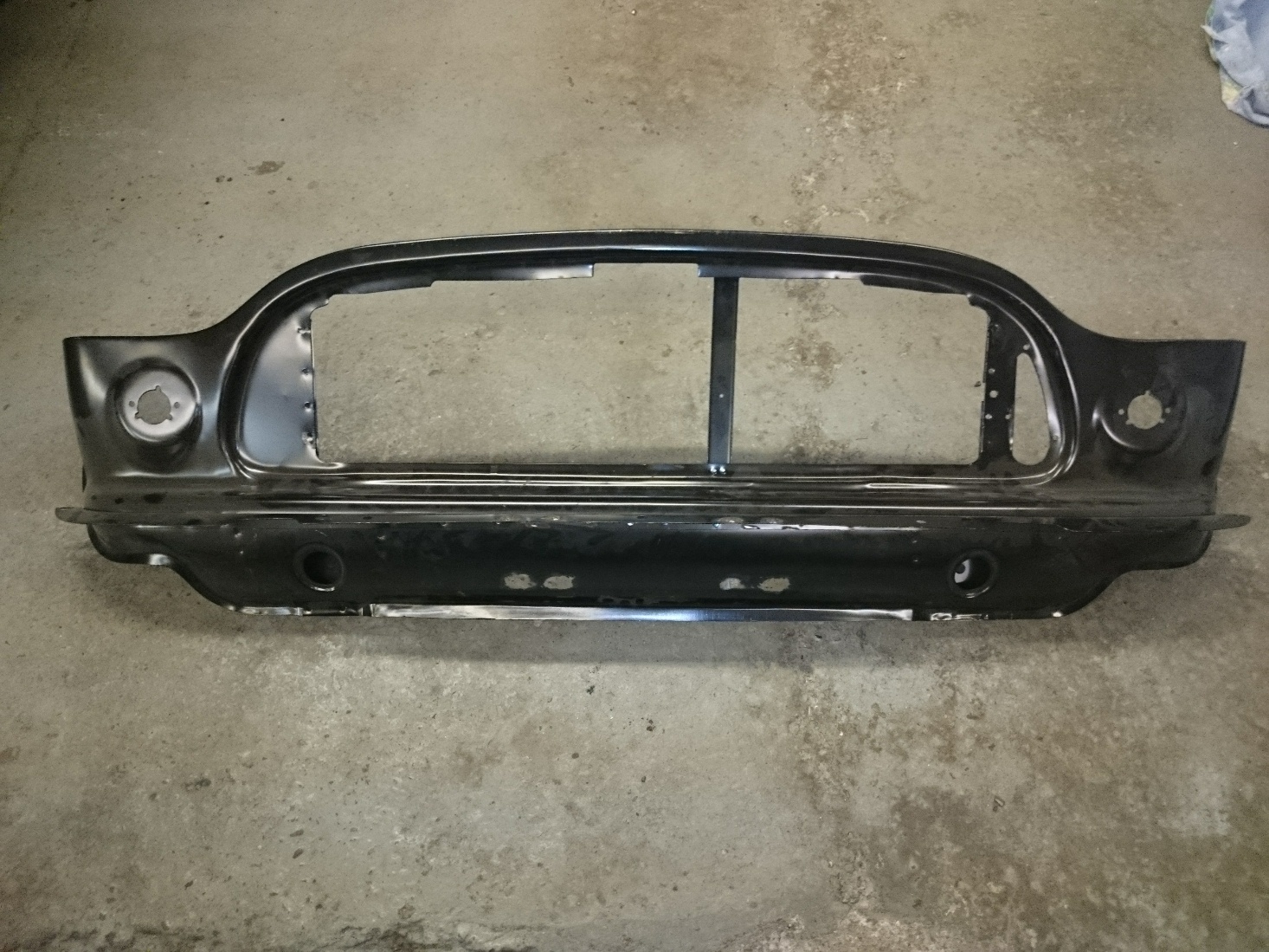

Been working on the front panel altering it back to original. Mine was already cut off so just been working off pictures so it won't be 100% accurate.
Here it is before I started, already cut the number plate brackets off.

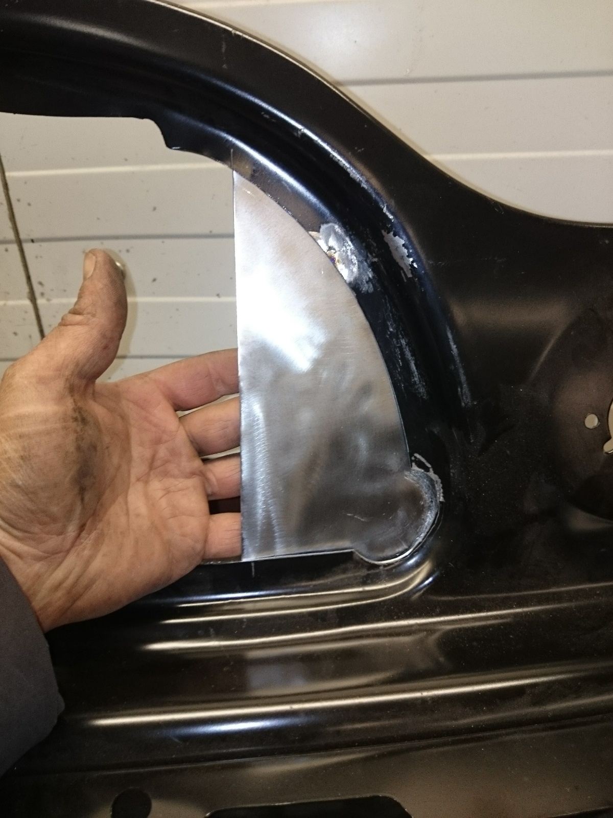

Cut the corner peices out and made the new ones

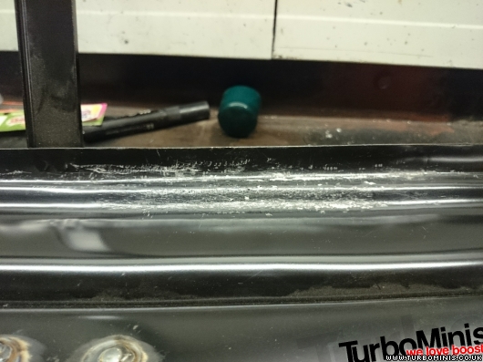

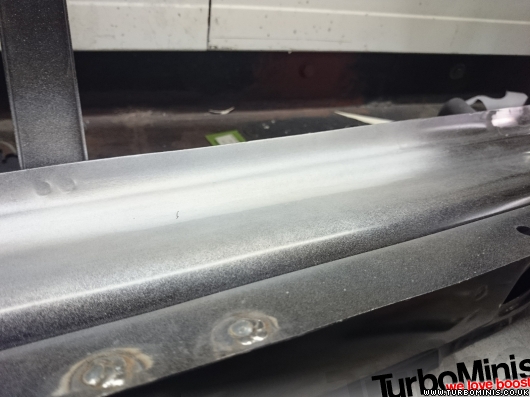

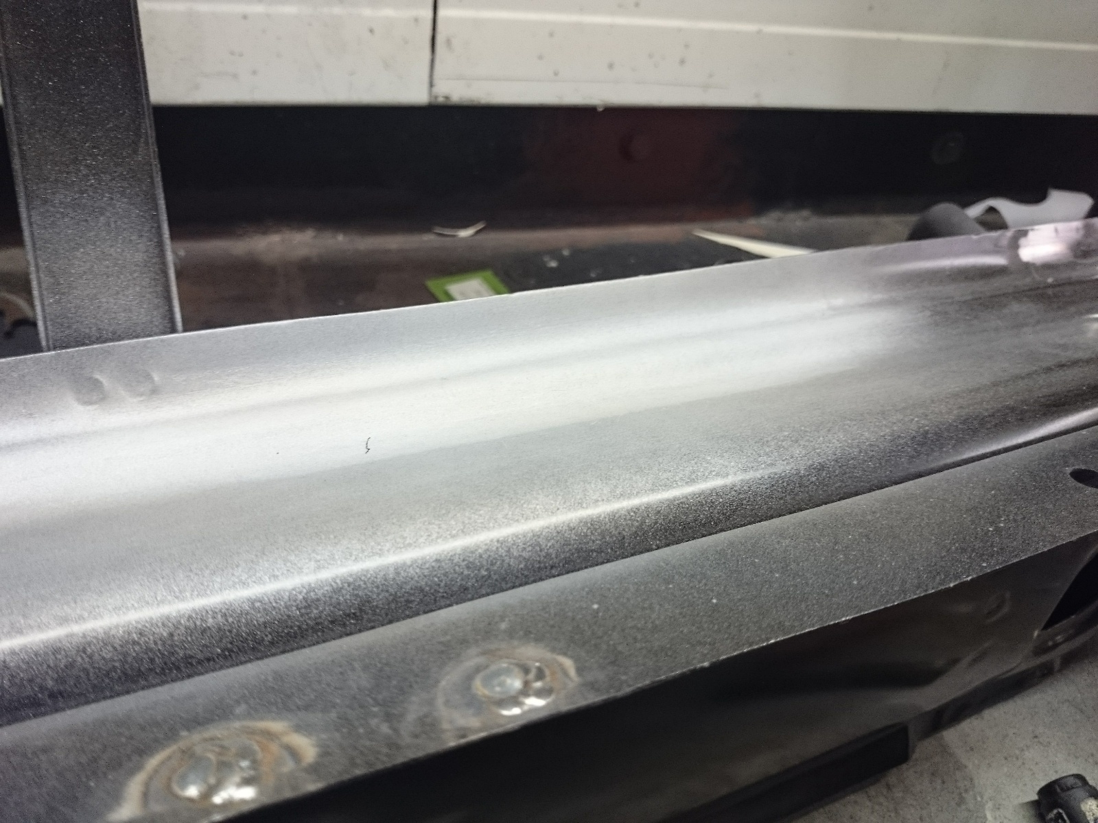

Then I had a go at removing this lump, had a go with a hammer and dolly and it came out ok for a first attempt but far from perfect
Finished it off tonight, spot welded the number plate brackets back on.
That's it for now, cheers

Very neat, i knew quite a few differences about the front panel and seen them done before but not as far as the ends of the grille as uve done, where are u getting the info/pics from to go from?
Been getting them from a few places really, build threads on the mk1 forum, there's a website called boot2bonnet which shows the same alterations being made and google images has come in useful as well

Derby
Didn't realise the brackets are so far apart on mk2's!! Same for mk1's too?

Yeah mk1s are the same as well, also foundd out that the indicator plinths are smaller on early minis so this needs sorting as well

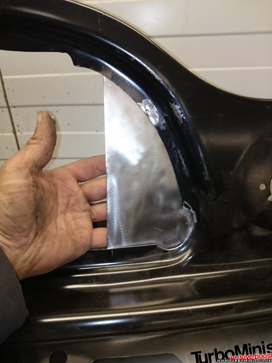

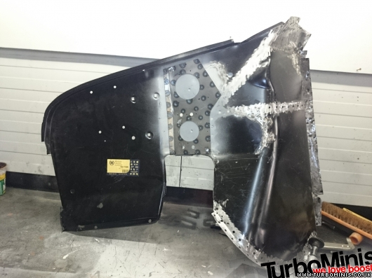

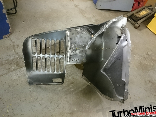

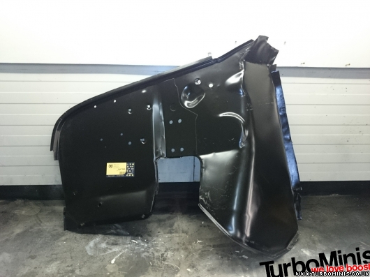

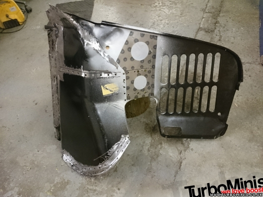

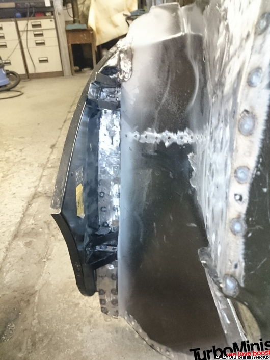

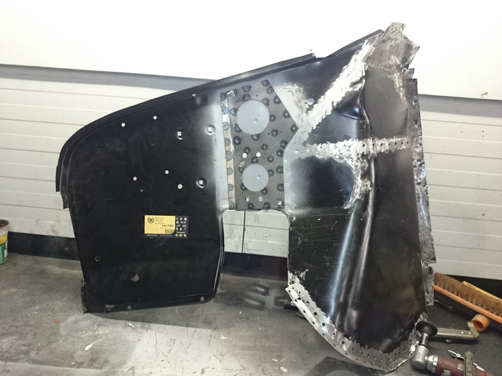

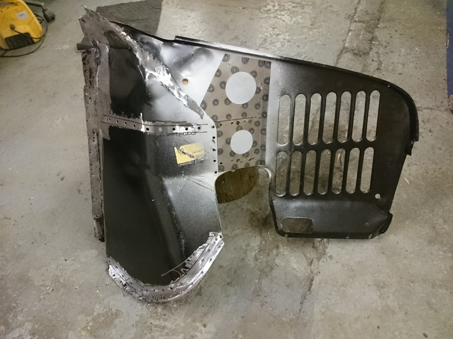

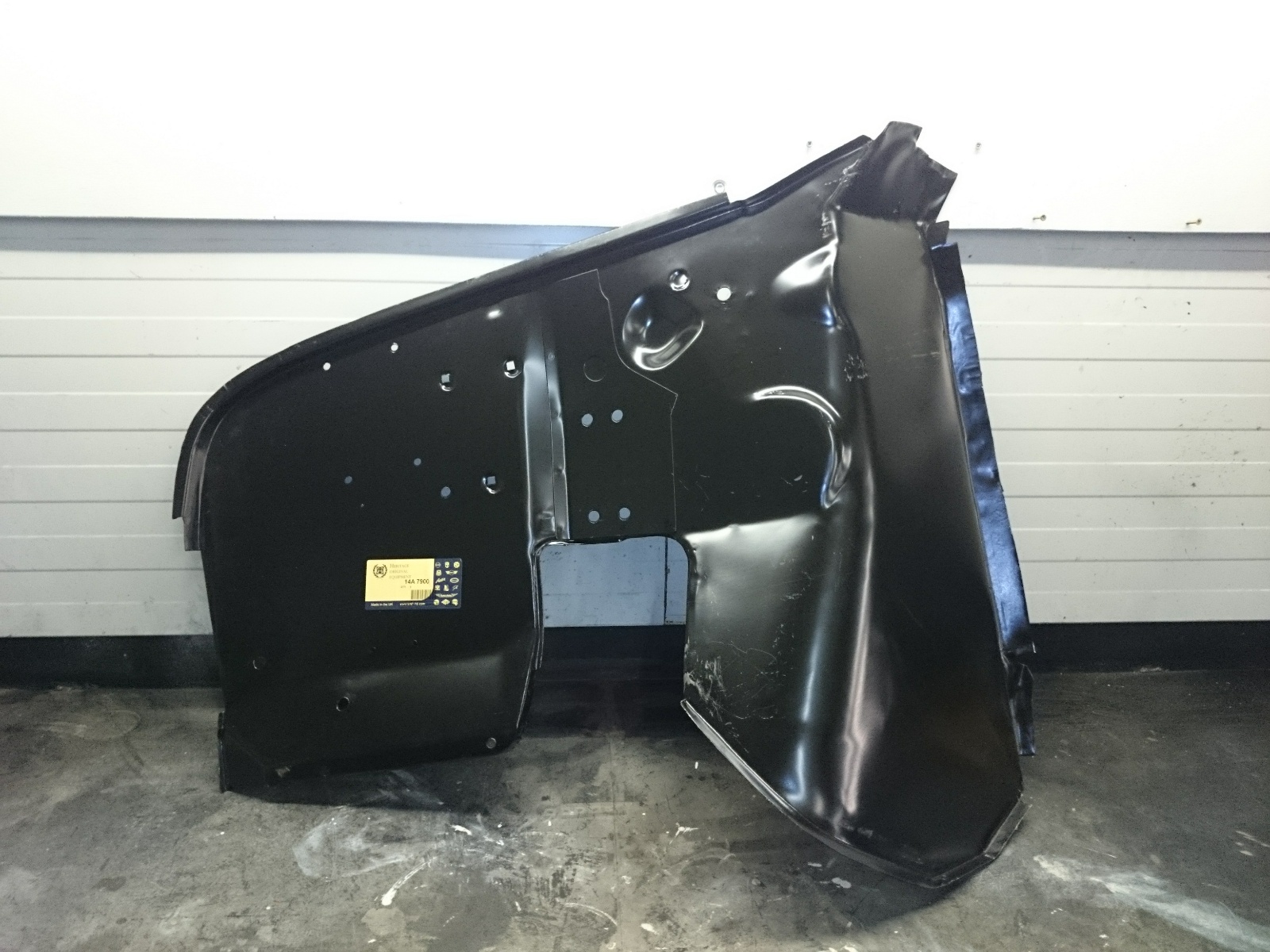

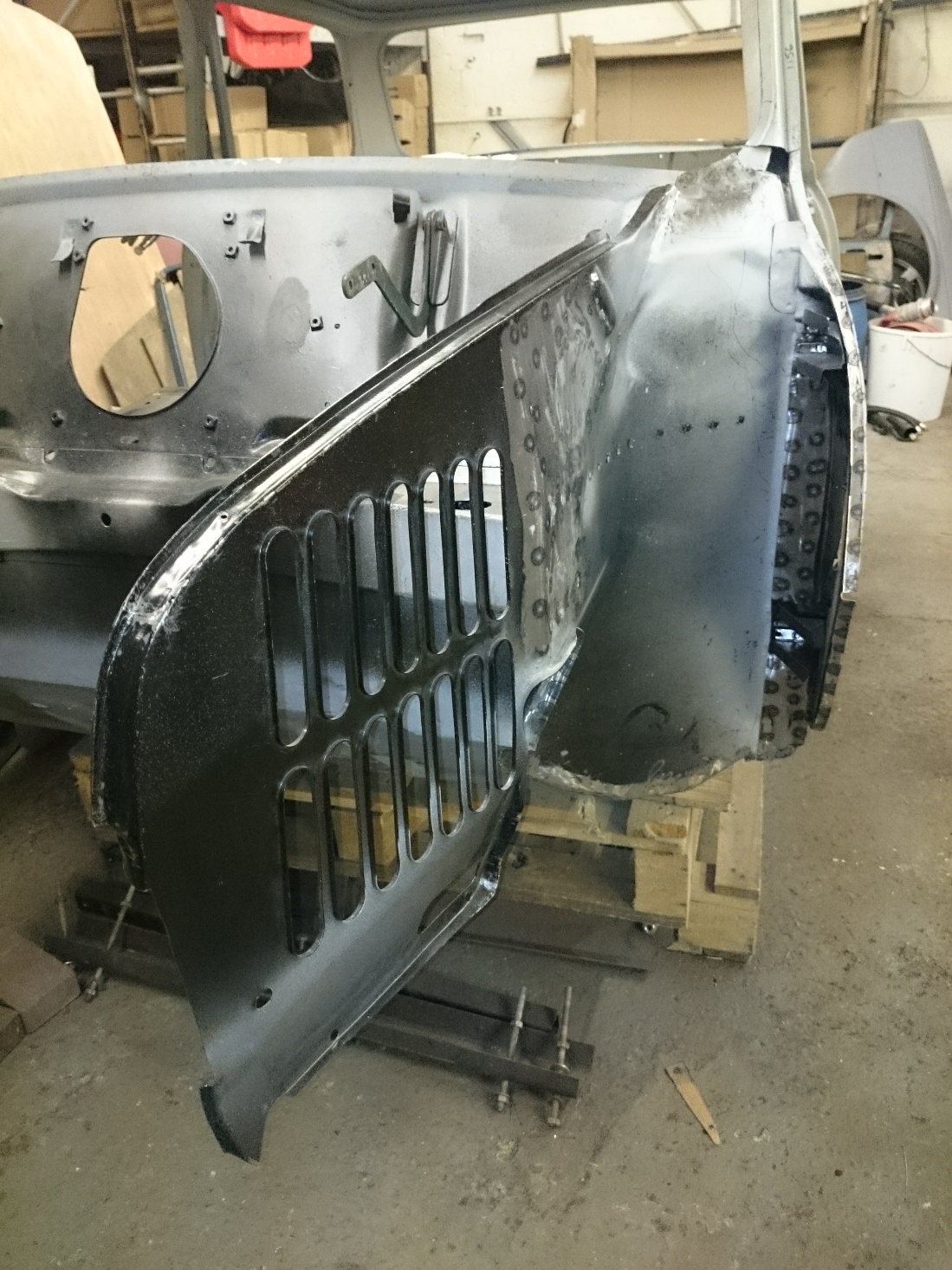

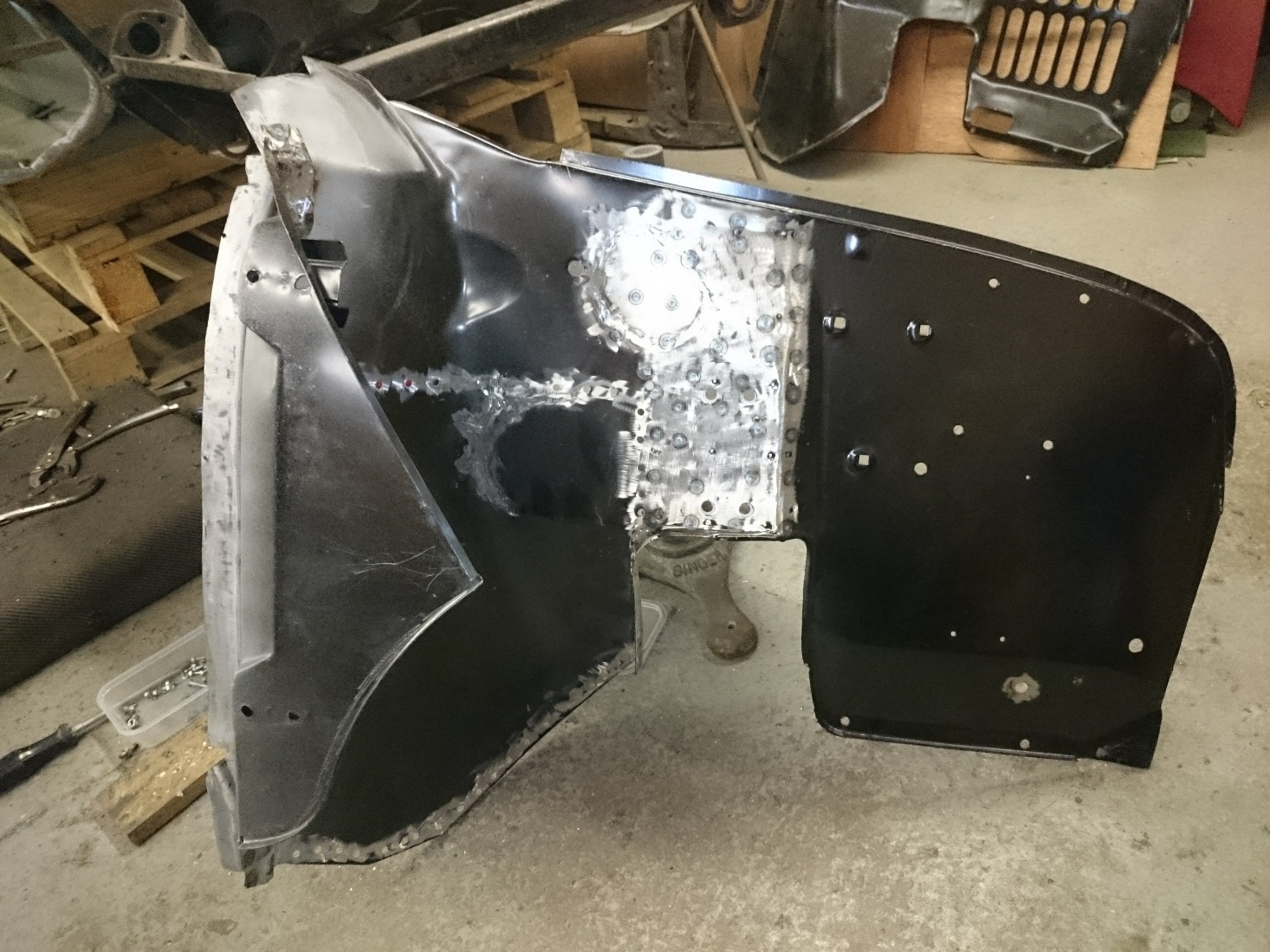

Not had much to update on this recently due to Christmas and have been snowboarding as well but getting back into it again now. Inner wing is nearly ready to weld in, had to modify the panel to original spec as with most of the other panels.

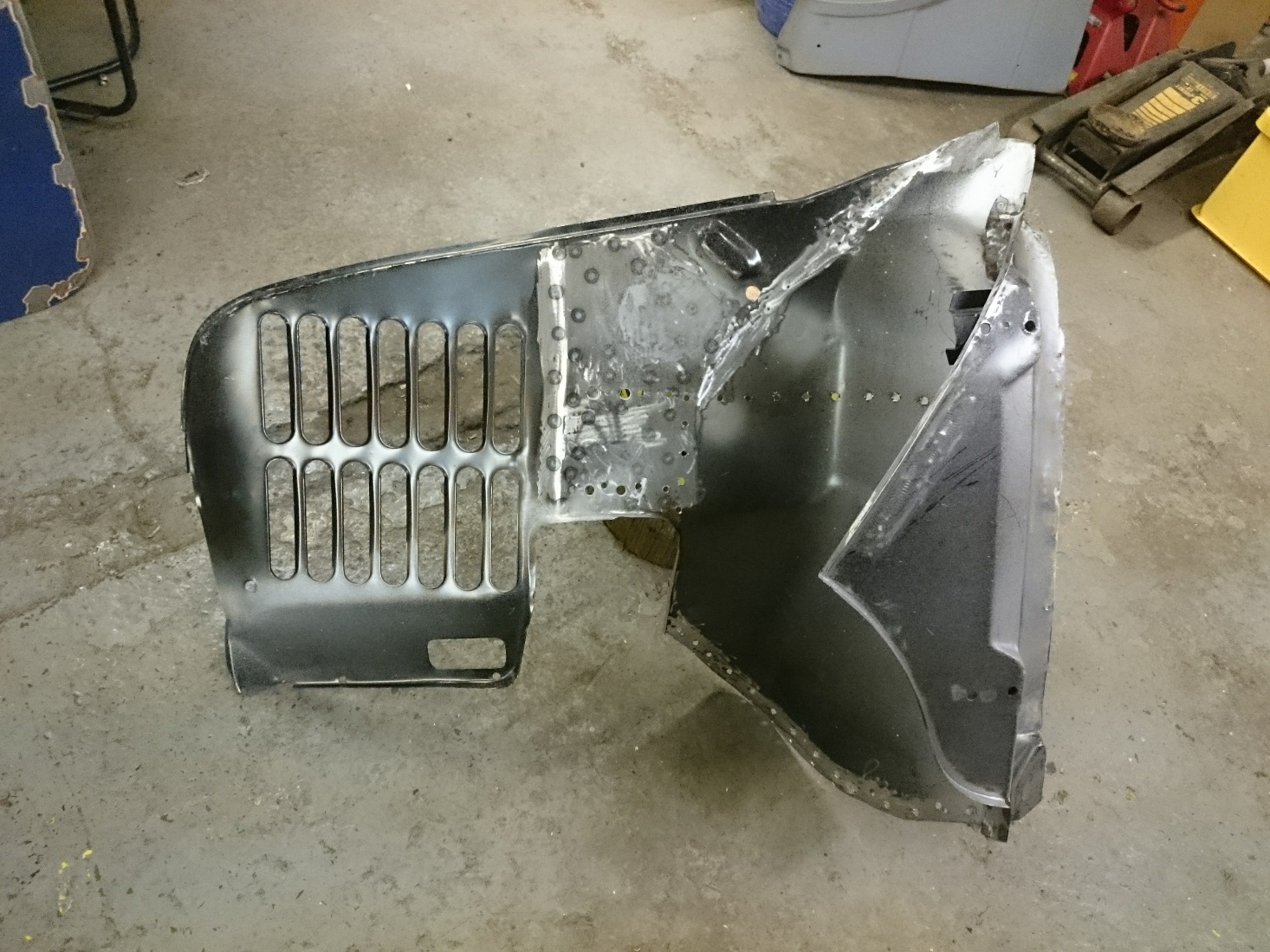

When i started
The lumps removed and the strengthener welded on

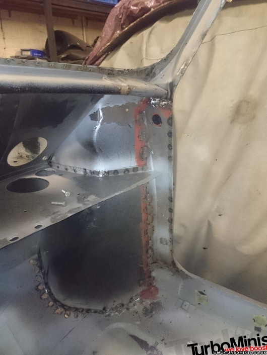

Decided to weld the inner A panel on now whilst I can still get the spot welder arms in
That's it for now, will try and get it welded in at the weekend. Cheers

4310 Posts
Nice front panel, will be trying to salvage the front panel on my MK1 seeing the differences now.

Yeah there are quite a few differences so save it if you can, mine had already been cut off unfortunately.

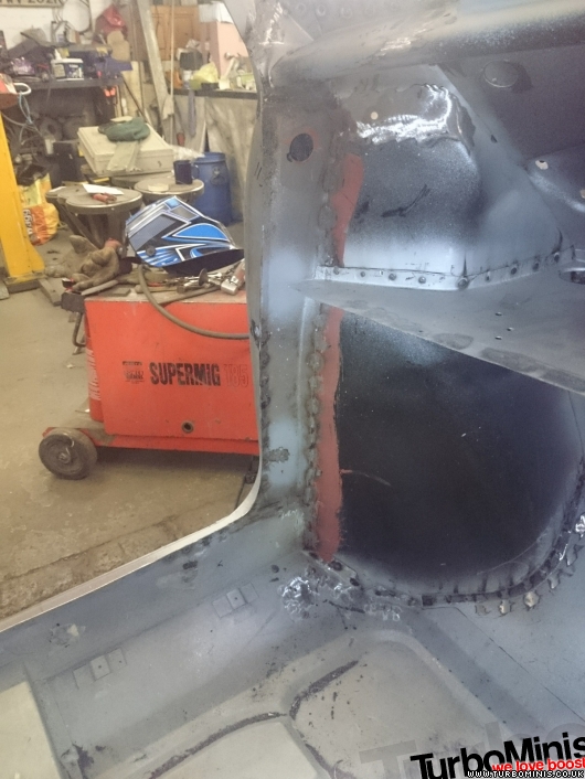

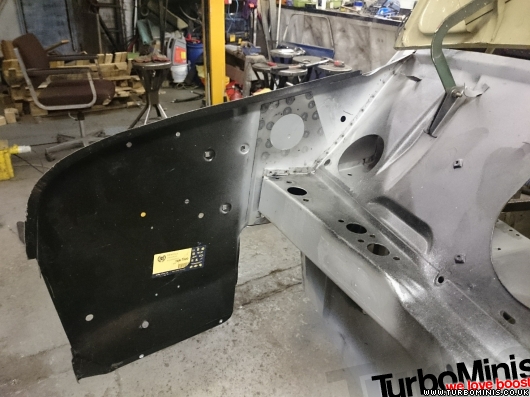

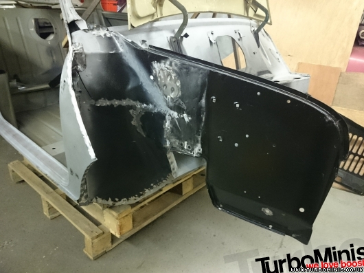

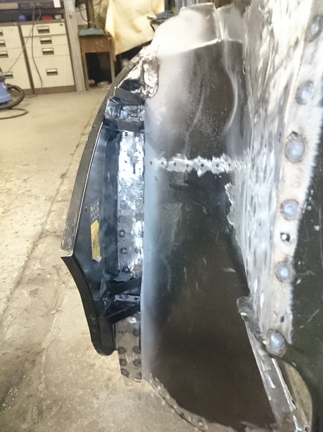

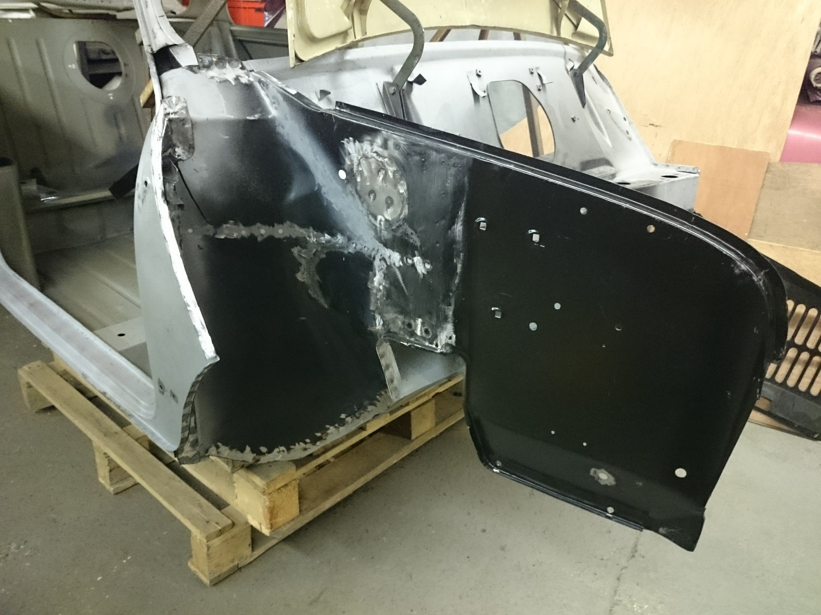

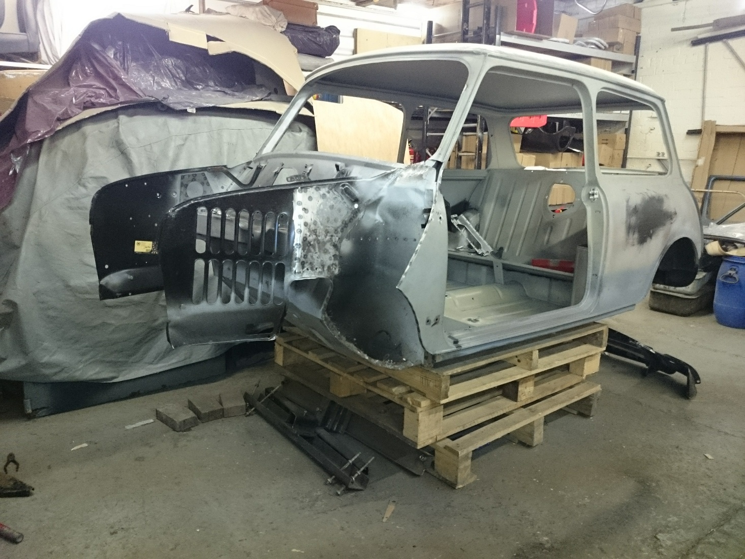

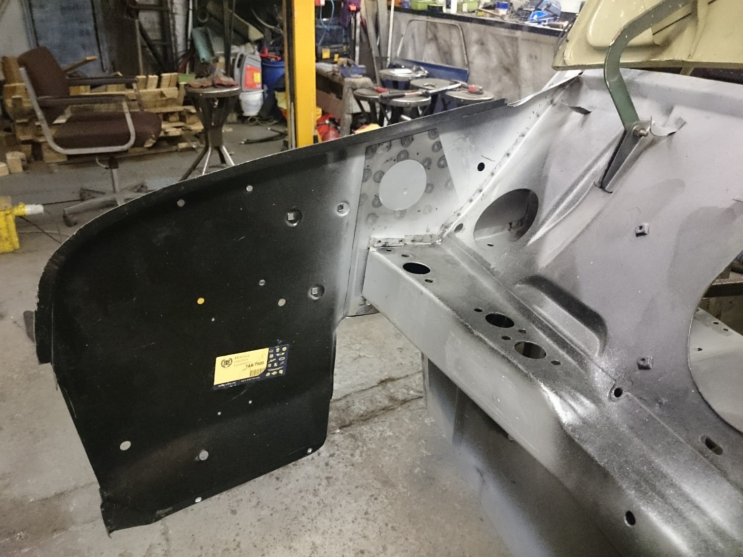

Got the inner wing welded in today
Turned the car around ready to start the other side, hoping it wont take as long. Cheers
Edited by Callum on 14th Aug, 2017.

clubman91
263 Posts
Member #: 8923
North Wales
Very nice work! Looking great.
Nicely done.
All looks a bit alien to me welding up the a panel and inner wing without trial fitting the door....
Callum
450 Posts
Member #: 10396
Stoke-on-Trent
Cheers for the comments.
The doors been on and off a few times during fitting the inner a panel and inner wing together , and I lined everything up again before it was welded in so I know it all still fits where it should

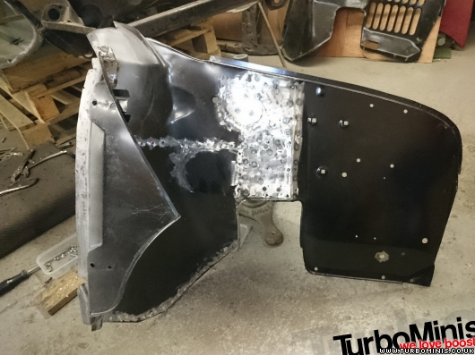

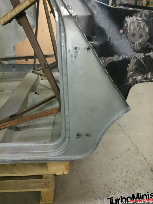

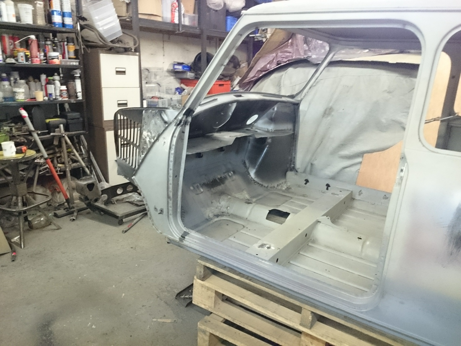

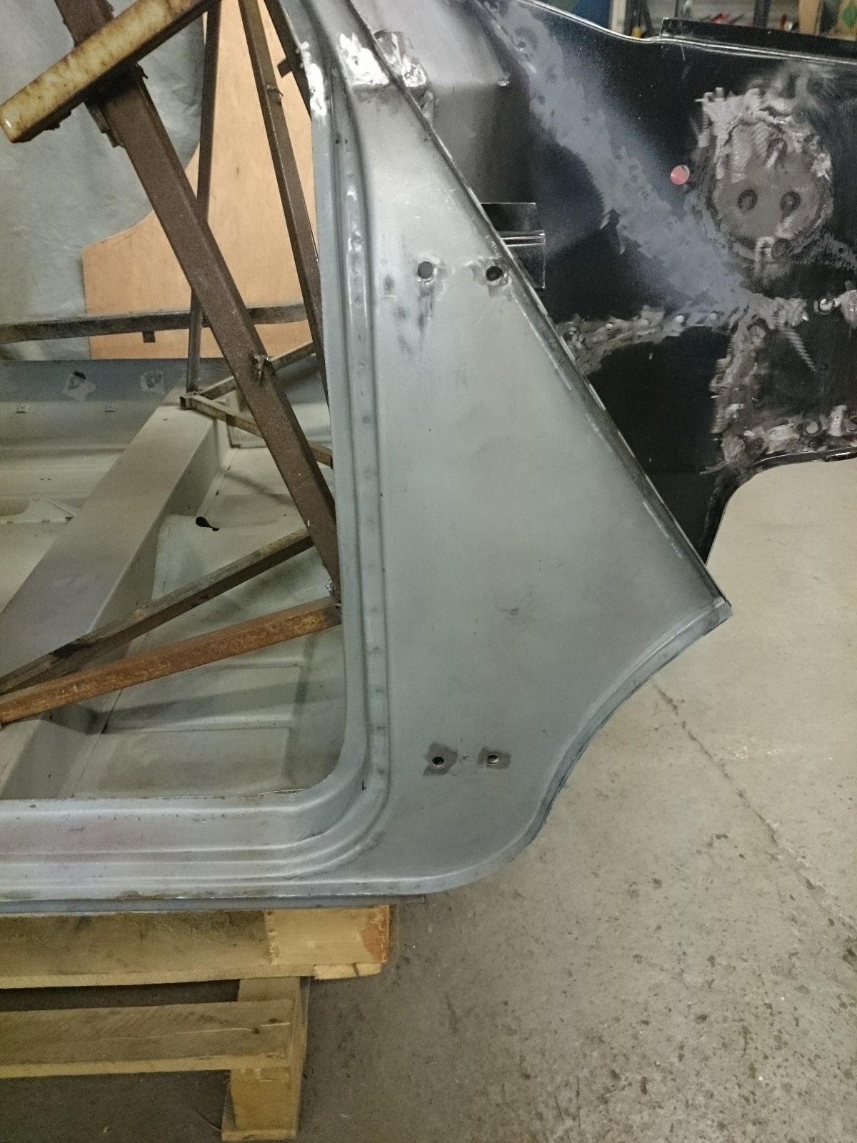

Other inner wing finished with the inner a panel welded on

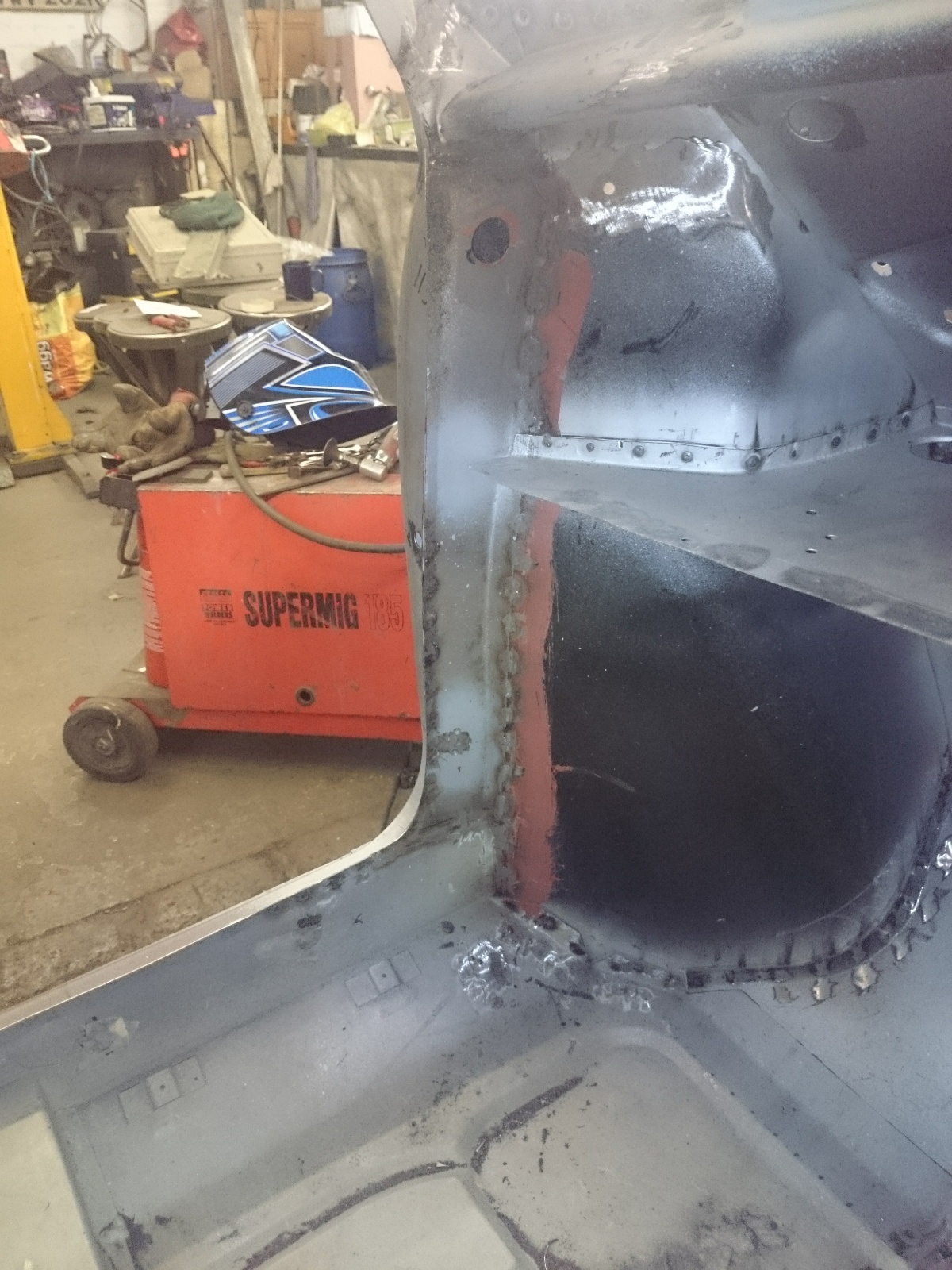

Welded in and cleaned up today, took the horrible bracing out of the front as well and nothing has moved
Nice. You can nearly see the end of the welding now. *smiley*

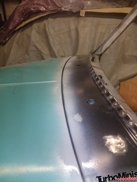

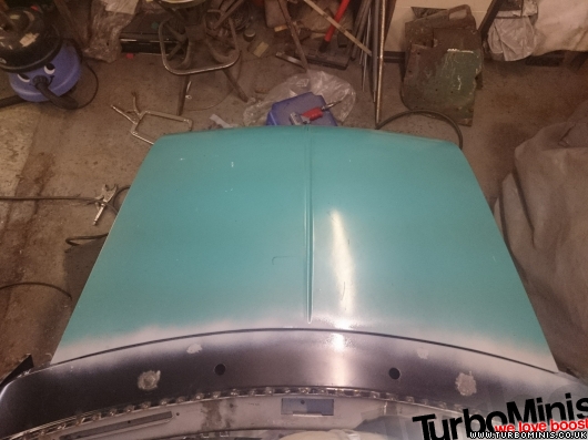

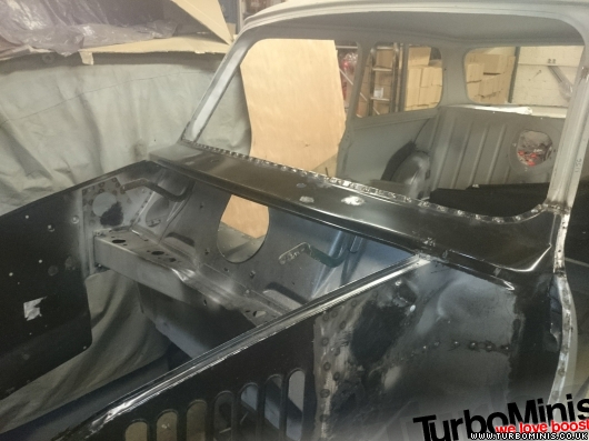

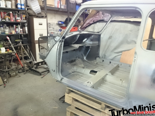

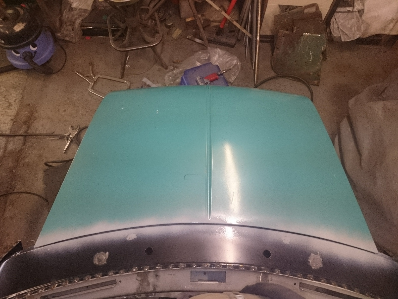

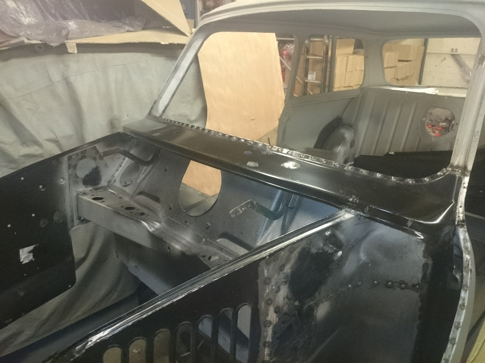

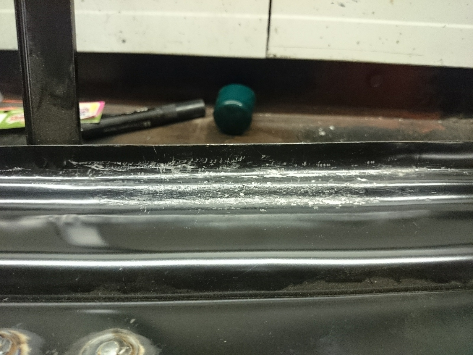

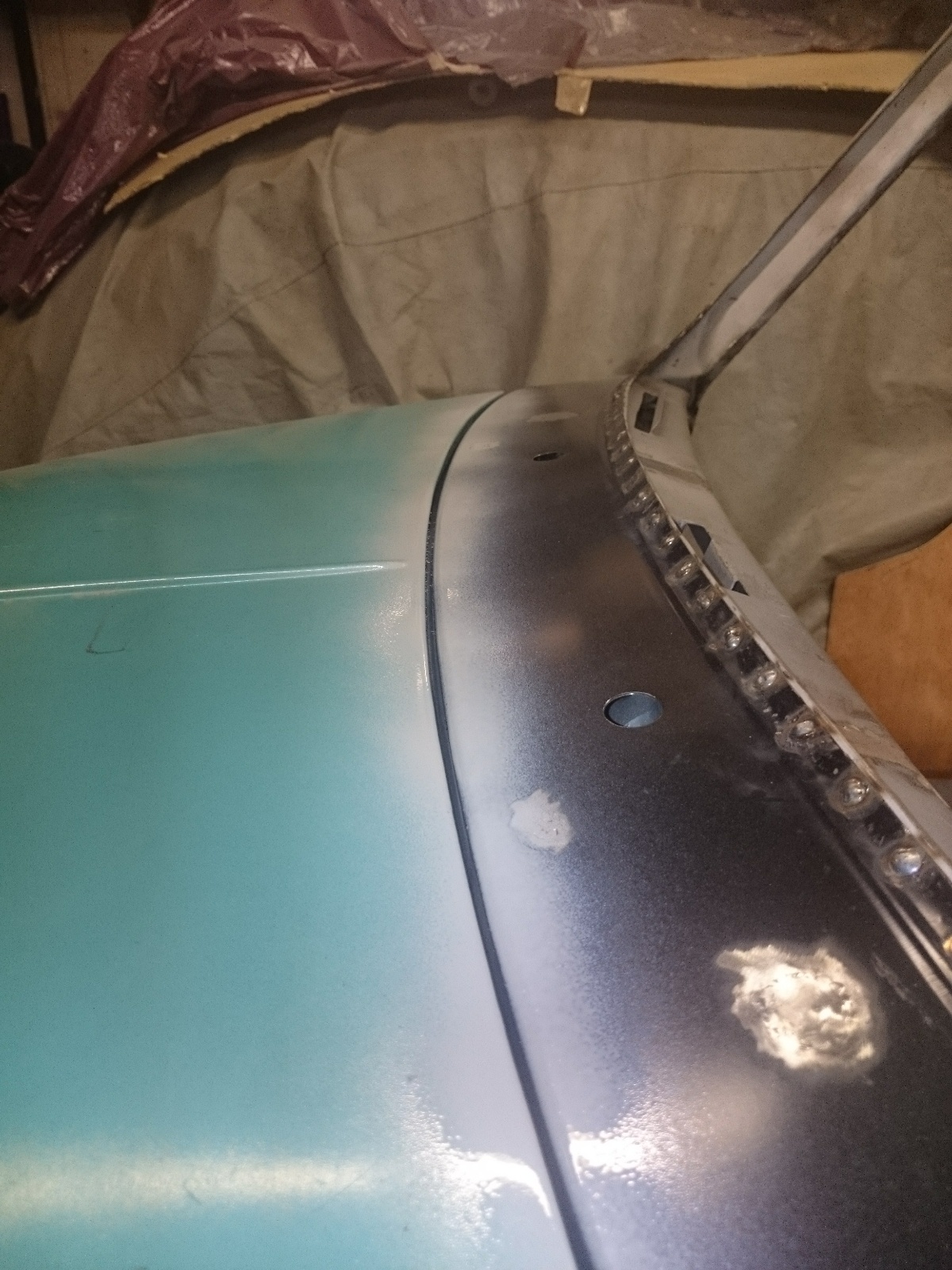

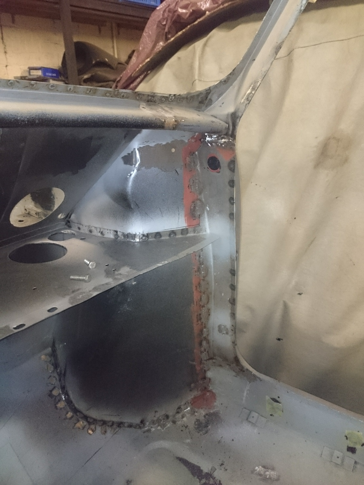

A pillar closing panels were welded in on Friday, the dash rail is ready to weld in but I ran out of time.
Then today I got the scuttle welded in
Not a bad fit with the bonnet but still will need a bit of work
That's it for now
jonny f
2096 Posts
Member #: 9894
Dorking
great job you are doing on this!
