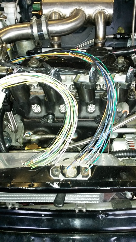

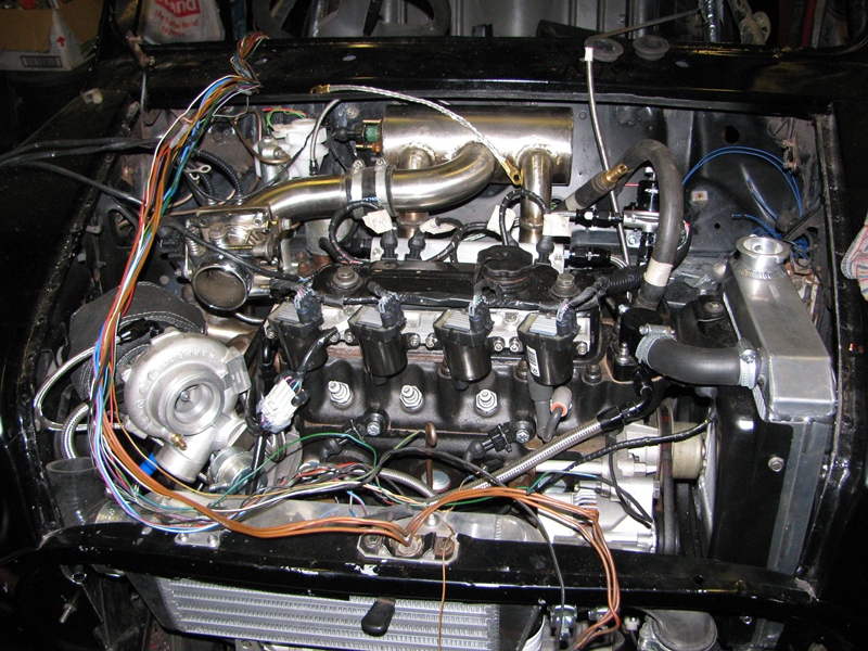

Just a few wires to connect *frown*
ECU wiring all done, just need to re-introduce whats left of the factory loom:
JT
2742 Posts
Member #: 637
Hertfordshire
That's alot of wires there lol!!
I'd not enjoy wiring that up. Well done!
My build thread..
Progress.
What are the dodars bolted to the head? knock sensors?
Yes, knock sensors.
It's running 9:1 CR but I want to wind up the boost at some stage. Water injection and knock sensors with individual cylinder ignition retard as protection.

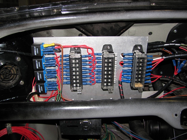

I seem to have spent a lot of time on the wiring, but can now see the end of the tunnel *smiley*
I suppose that it's the result of using a lot of bells and whistles rather than just the simple ECU setup. Also moving the engine bay loom inside the car.
3 fuse boxes with different functions: ECU, Gauges and the standard mini fuses. Relays for Main, Fuel Pump, WI Pump and Fan.
The car is going to be fitted with a full dash, so this should situated behind the glove box lid if I've got my measurements right.
Looks neat Paul but I am surprised you haven't used the proper relay bases.
I bought a 4-way relay base, but it is so deep, I could not fit it in the space *frown*
I used the miniature relays with the same rating as the ones you have used, but a lot lower in height when on the base.
Still, how often do you change a relay. Make fault finding easier if you can whip them out mind.
