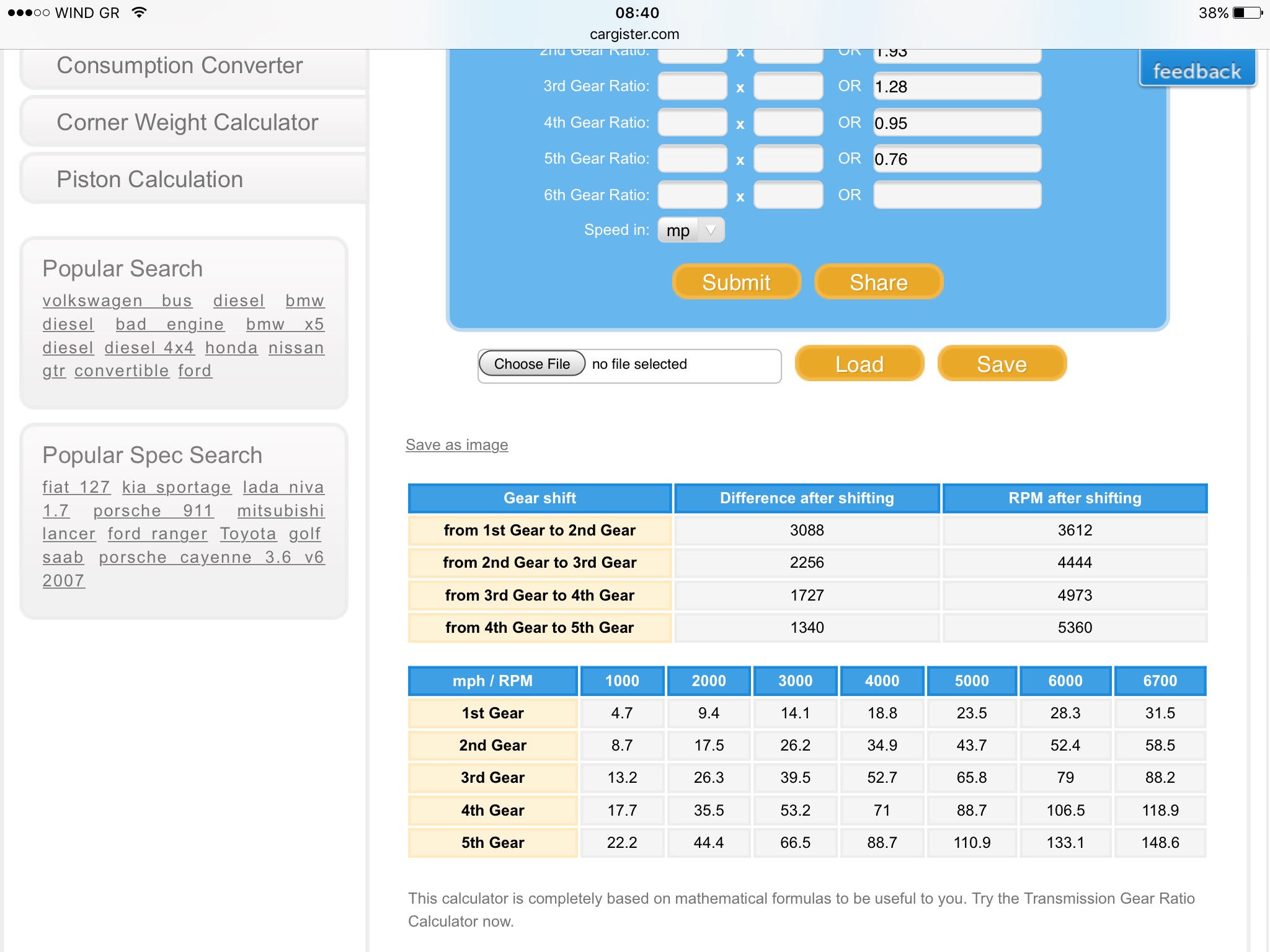

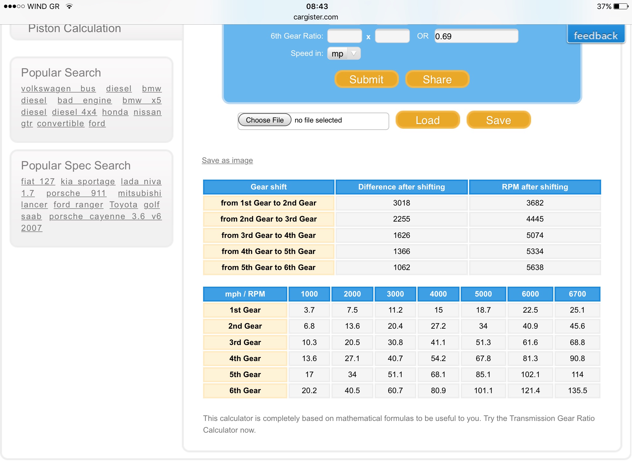

Thinking of a gearbox change to the ib5 box from a diesel fiesta for a couple reasons
1, the ratios
2, there are plenty of lsds available
3, it's quite a bit lighter
What do you think of these ratios (all calculated for 10" Wheels)
Should improve my quarter mile as I should be able to pull away in second still
First is my current 6spd focus
Second is the 1.4 diesel fiesta one
Edited by charlieb150 on 29th Aug, 2017.
1st to 2nd and 3rd to 4th looks like quite a jump... You really need to do at least a sawtooth and ideally a tractive effort plot. I've got a xls somewhere from when I was in the transmission engineering industry, and I simplified it a lot to make it more user friendly... I'll see if i can find it.

The 1.4tdci fiesta box.
1st. 3.58
2nd. 1.93
3rd. 1.28
4th. 0.95
5th. 0.76
FD. 3.37
My current 6 speed focus
1st 3.73
2nd 2.05
3rd 1.36
4th 1.03
5th 0.82
6th 0.69
FD 4.07
