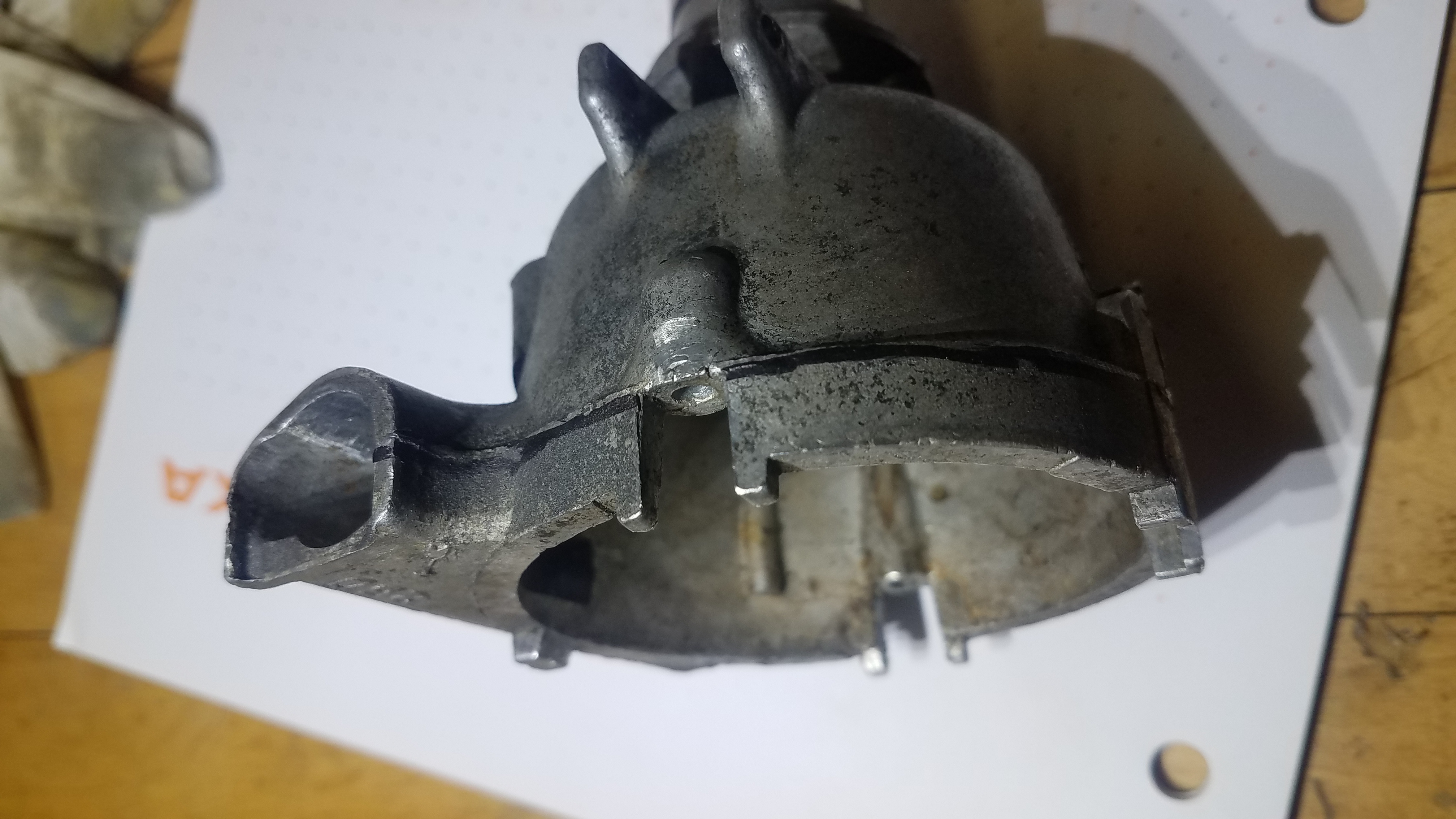

I have an old distributor i took apart today. Cut down the shaft and drilled and tapped it. Im thinking about cutting it at the black marker line. So i can still use the bolts for the distributor cap. But just a flat plate. Then get an aluminum wheel with a notch and go optical.
