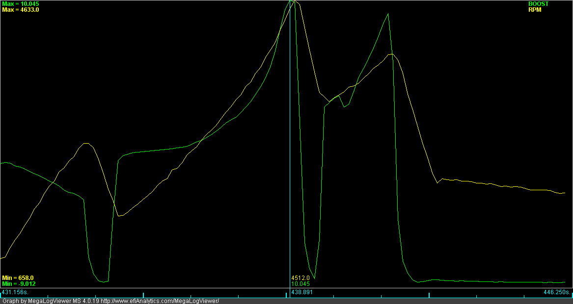

it separates the pulses and make pool up sooner.
so im guessing around 300 to 350 bhp ish brett?
that spool more slowly than i would have expected .
i know of another very similar spec with 300kw at the wheels @ 1 bar, i dont want to put a power on mine tbh, the tune is on the safe side, and the overall drive is good, im just biding my time as i have another engine waiting to go it (still need a rebuild)
maybe spool does look slow like that, but imo im 2 gears higher than i should be

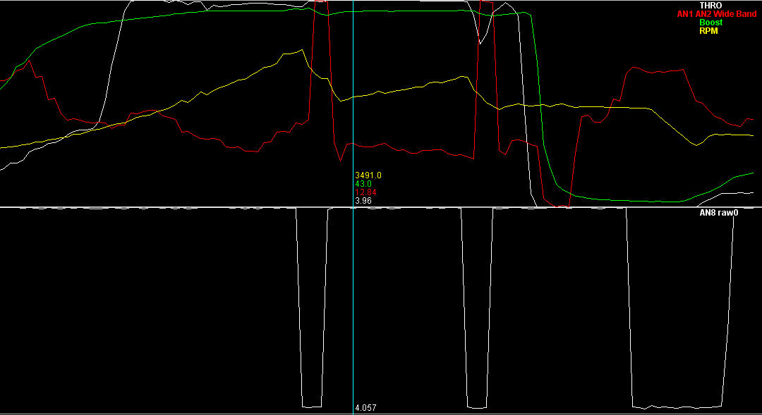

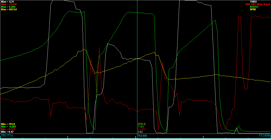

ill dig out some more screen shots
edit: who needs spool times when you can flatshift *happy* ( pic 3)
edit2: also please note the rpms are kept low in some logs because most of my time spent tweeking was for useable road speeds

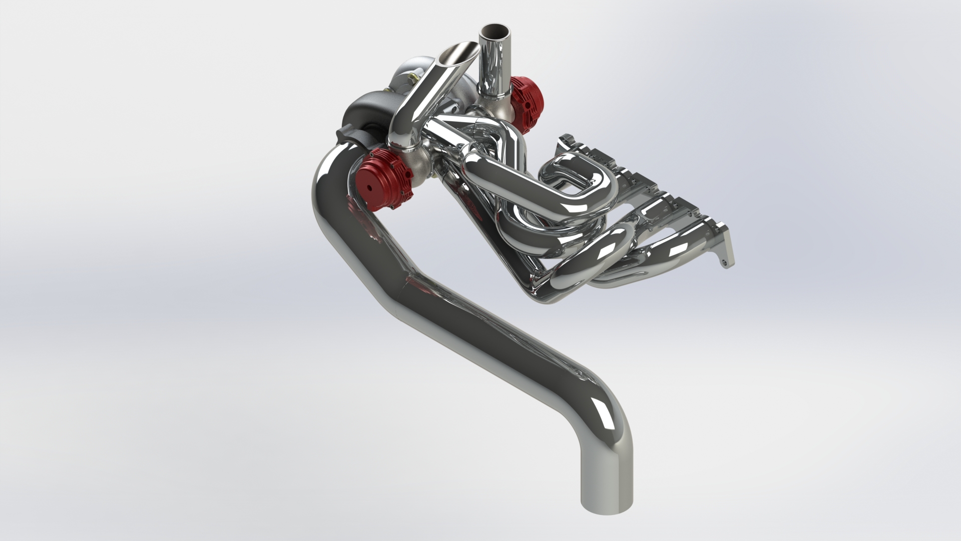

What are your throughs on manifold volume in regards to spool?
Oh and btw this is the manifold i hope to create next summer. Although It is a twin scroll design. I hope to use a hx40 7 Blade or perhaps a 6 blade. With the right camshaft the engine should be happy to 9500rpm. All this is in the objective of running a 10.XX on the 1/4 with a full weight car. Im currently sat at 12.3 with the hybrid ko4 setup.
