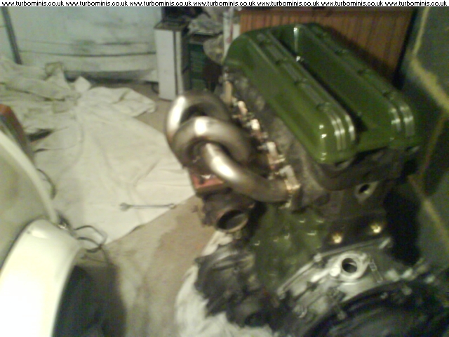

lol, that looks quality! Modern and retro. Really like it that you've kept the ridge silver.
6297 Posts
Still love this project - top work Matt.
If only BMW knew of the special powers BMC Green paint has.
Top stuff!
Its gonig to look even better on the rollers once those bananas start glowing!
Cheers for the comments guys. I got the idea of a green cam cover from someone else so I can't take credit for that! *wink*

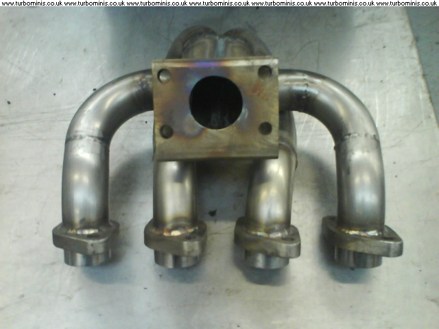

The manifold will be finished tomorrow....:) *tongue* Ive finished blending the flange so it can now be welded on and cleaned up.

It`s a sort of "Castrol" green hey? makes it look almost period racing style now *smiley*
well,,, almost *smiley*

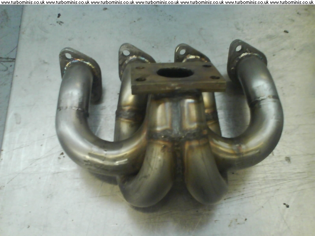

Just picked up my manifold from the welders....its finished!!!
Finally I can get the head bolted to the block and the turbo bolted on. Then engine in. *tongue*
That looks like a work of art!
This build is coming on well, I bet you're excited now!

very nice matty, you want to make a jig around that manifold then make a few manifolds to sell, I'd buy one.
Grand job.
Presumably thats a GT17 flange.

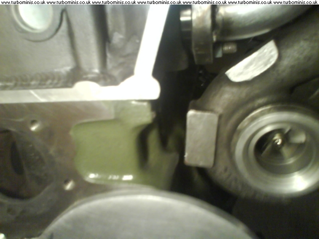

Does the turbo fit without a bulkhead box?
me too, even if i just hung it on the wall.
I do believe it needs the bulkhead box still
However it looks like it will flow well
It was painful enough just making the one...sorry guys!
Paul, yeah it is for a GT17 although on the weekend me and Nic found out that it will also work for a T2 flange which is good if a decide to change turbo in the future...
As far as I can tell it will fit without any bulkhead mods, I'll take some pics when its in.
Yes, the bolt pattern is the same for the GT17, T2 and T25.
The round hole is the GT17 specfic detail.

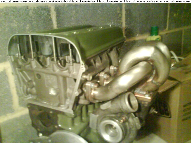

Right today is officially the "wanky bollox fuck sake annoying jobs night"...
Spent the last 5 hours filing head studs and nuts down to clear the cam, Re-fitting valves for the second time and generlly pissing around with things that should be straight forward...
Here's some pics of the turbo position though, makes it all worth while! *tongue*

You've done a class job of that fella, well done!

Matt - looking great fella - top stuff
