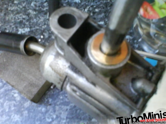

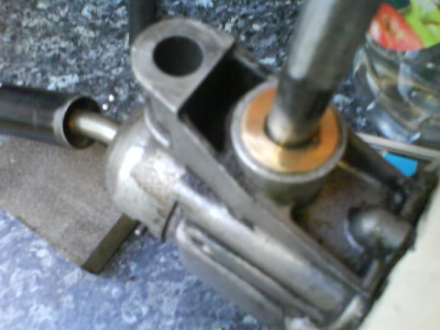

Some more mods to my gear selector to try and get a smooth change. The action was slacker than a clowns pocket, and now very smooth!
has that bush made much of a difference?
Is any more tweaking needed?
It has to the amount of play. It had 1.5mm gap between the shaft and the selector casing. You can imagine how much travel this equates to at the other end of the slector shaft!!! Fook loads!
Ive made some webbed brackets for the turret too so that should be alot more solid. Hopefully I'll get chance to try tomorrow perhaps. *oh well*
Oh yeah, when you do yours..I recon you should try and make it so it only has 1 UJ. I think that will also help alot.

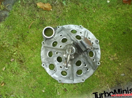

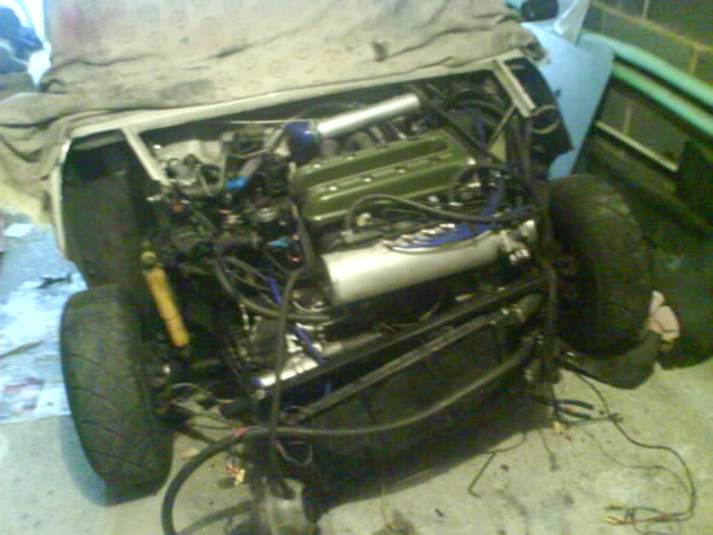

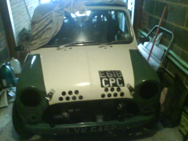

Its been a while...bit of an update! Shit pic but you get the idea. Can't believe I didn't do it sooner, I can get to everything in the engine bay now, so repair progress should be much quicker.
Told you I'd do it Nic! *happy*

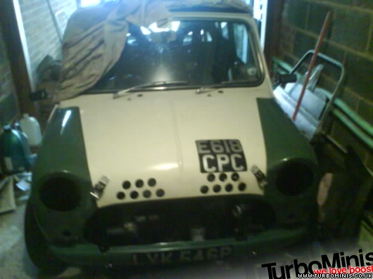

Nice!!
Clubman front yeah? *wink*
Haha, I have been tempted to go clubby...but that would be cheating! *tongue*
bout time *Clapping*
Clubbys aren't cheating they are the future

Is this bush replaceable as standard? or is that something you turned up yourself?
mine's got loads of play too, running a KAD internal linkage, and it really does ruin the feel, and the rod vibrates at certain RPMs on cruise!

I made this to suit, as mine had loads of play. It really has made the rod action smoother...such a smooth rod action, it will make the ladies go weak at the knees! *wink*

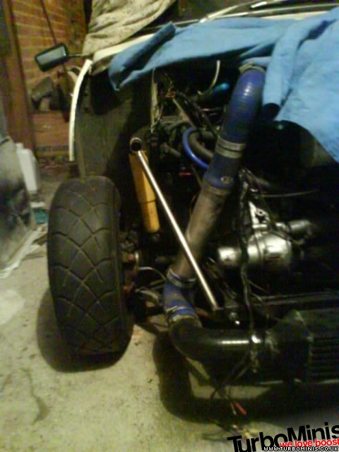

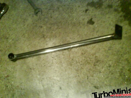

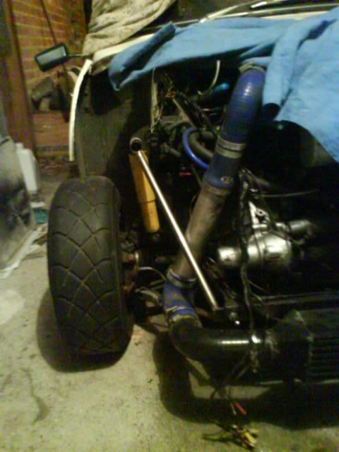

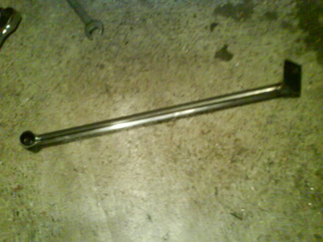

A bit more progress. The front is now on, and made one of the strut braces.
Will hopefully get the crank cleaned up tomorrow and rad back in! And find the decent camera! lol
The first piccy reminds me of the Frog.
looking good buddy, nice design *wink*
It reminds me of the frog every time I look at it!
Haha cheers Jim...can't think what gave me the idea to mount it to the shock. *wink*

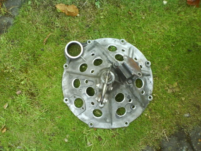

Matty, I can see where you can loose a little more weight.
Cut that cone off the chinamans hat *wink*
What the bit on the wok?
yeh, thats it, the China Mans hat
Urm like this. *happy*
some ones been busy with the Starret *happy*
