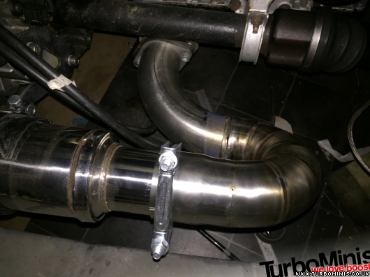

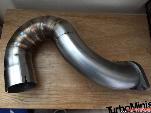

Exhaust is coming along. Got a load of mikalor clamps to order for this and the boost hoses. This now needs tigging up before I make the tail pipe.
Added a couple of slip joints either side of the silencer to make it all easier to remove if I need to.

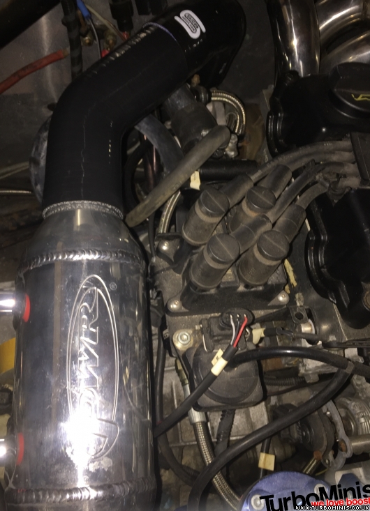

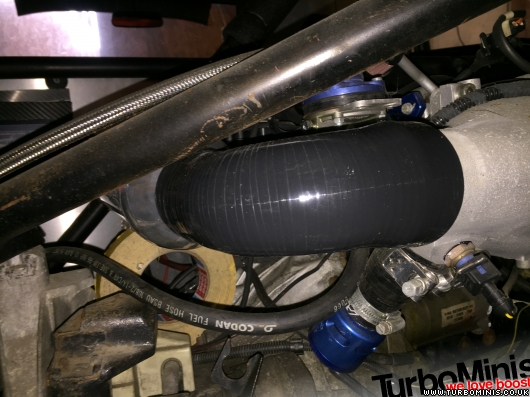

Boost hoses have arrived, all fits just where I wanted it.
Clamps are in order and exhaust is in for welding.

Had the downpipe to silencer exhaust section tacked to pre fit it. Really happy with how it's come out. Although now I'm wishing I fitted a v-band!
About to get started on the tailpipe.

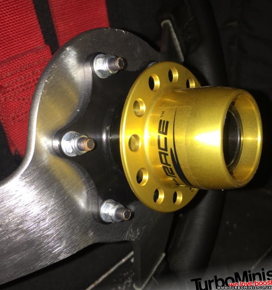

Latest update. Got fed up with having to squeeze in and out of the car, so went with a quick release.
Just waiting for my brake bleeding buddy to return, and the cars pretty much ready to be mapped. Looking at a couple of track days for early next year. But am looking at some quiet local roads for a gentle shakedown too!

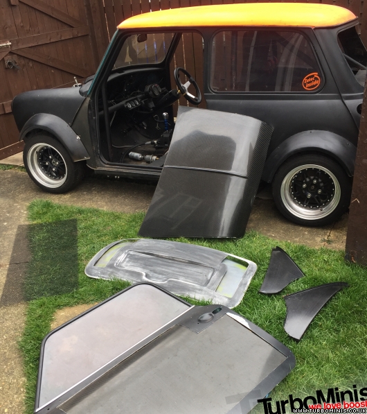

Had a load of new bodywork to fit.
Bonnet is on, but I need new pins.
Had to replace the a-panels as the front end was pushing them back, and they were catching on the doors when opened/shut.
Bootlid is also done
Just finishing making a set of hinges with removable Clevis pins.

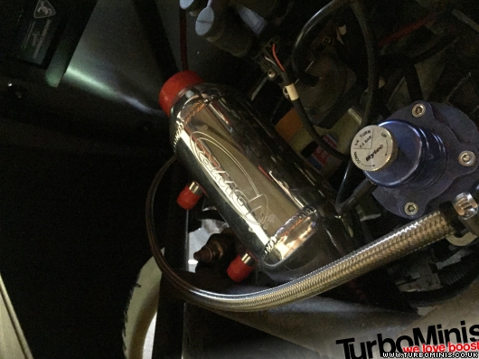

Wired in the alternator and chargecooler pump today too.

Door skin to bond in next. Then it should just be a matter of a few rattle cans to tidy it up, and a few MOT requirements (fog lamp/wipers/etc) before mapping and getting on the road

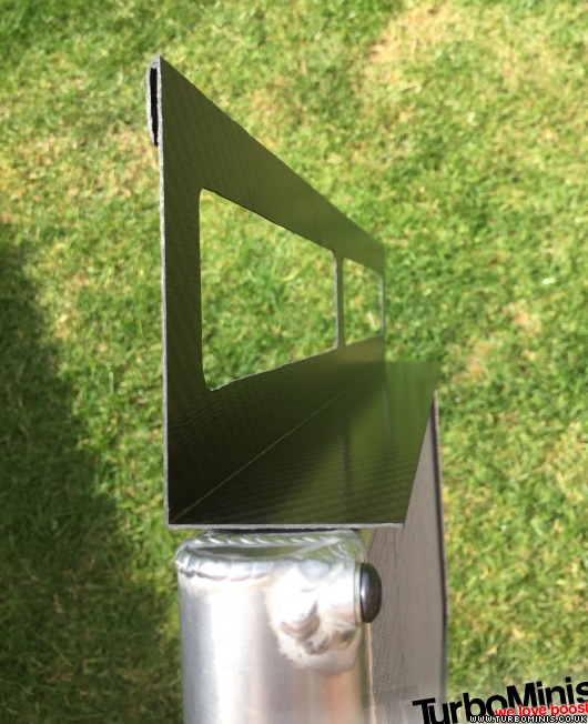

Boot hinges finished.
As soon as I find some m5 nuts will fit the bootlid.

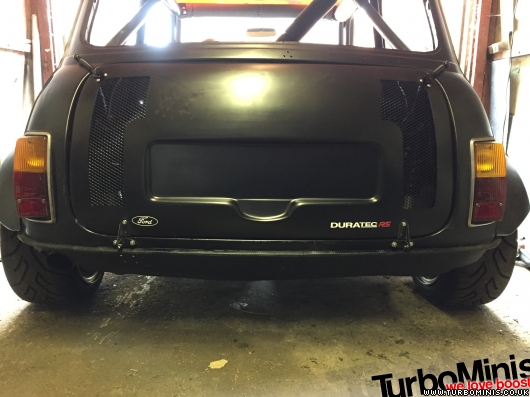

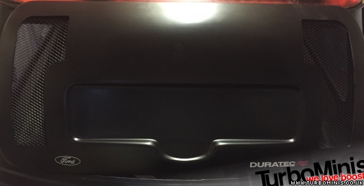

Bootlid fitted.
Shape of the fibreglass isn’t great, but it will do for now

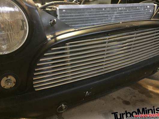

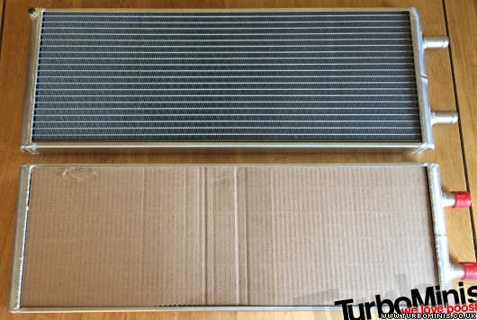

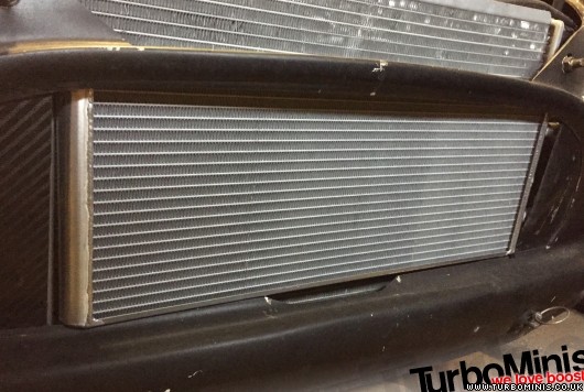

Been waiting ages for 1 chargecooler rad to be made, and 2 turn up at once!
Turns out there was an issue at the fabricators, and the 1st was made too small. So now I have to work out what to do with the 2nd one 🤔
The correct one fits perfectly. Both outlets on the LHS, with a bleed on the other. It’s the exact dimensions of the grill opening, and fits between the end tanks of the Focus rad
Final plumbing from the pump to the rad to run next, then that’s the last of the big stuff.

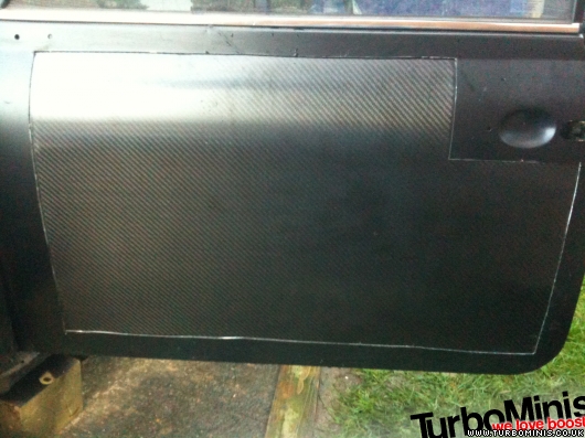

Bit of an update from today
A-panels are bonded on, so is the door skin.
Doors fitted

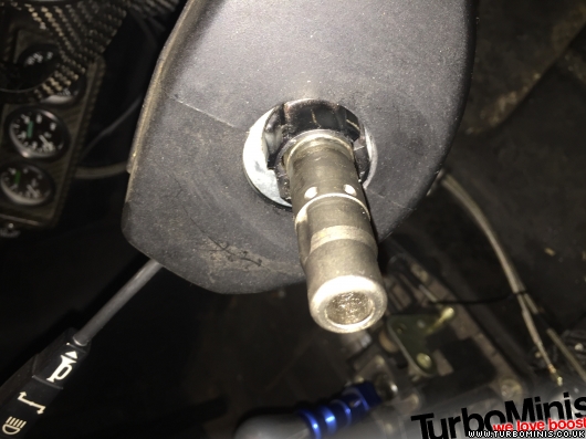

Steering column had to be refitted as the steering wheel was off centre.
Few other bits

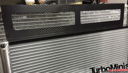

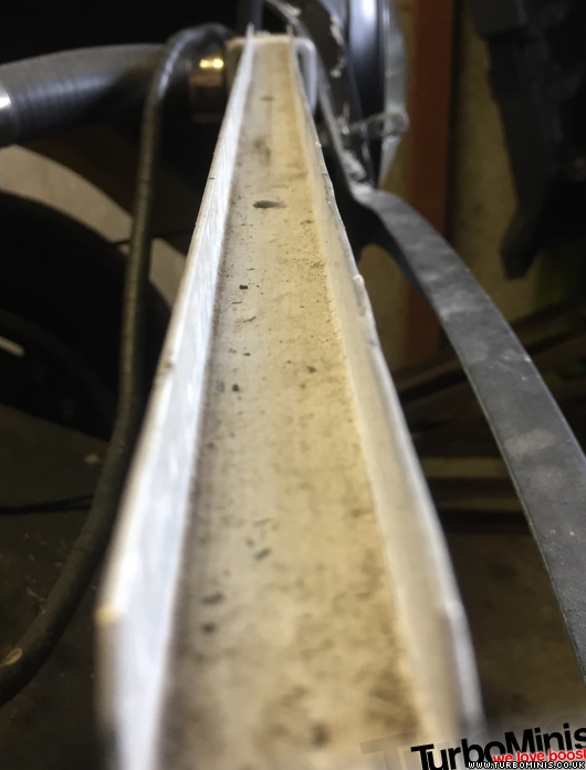

Been contemplating how to mount the additional radiator, and came up with this solution
The main rad has a u-section channel on top
So made a right angled bracket with a return on it. Used high temp silicone to attach it
Fairly happy with the fit.

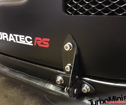

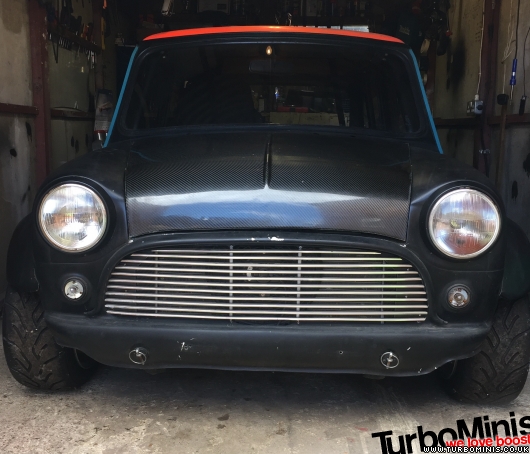

Fitted the bonnet catches and here’s the result
https://youtu.be/rnZxlTba-bU
650g all in, is about as light for the road as I’d go.
I’ve made lighter, but this seems usable
