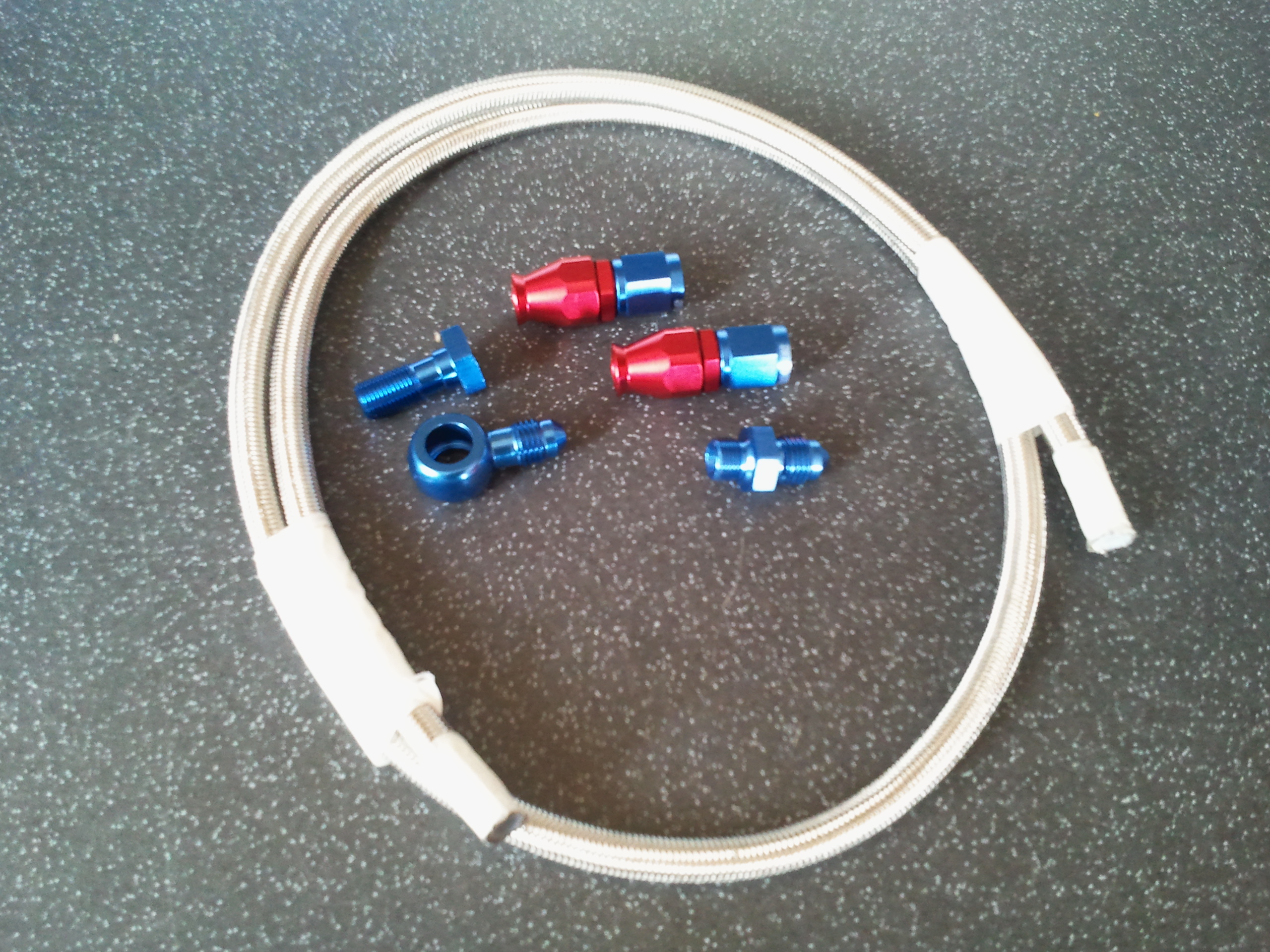

sexy in a bag turned up this morning :)
looks very well done brett good job
We went for the even sexier black "stealth" versions.

stick them in a wire wheel get rid of the cheesy anodising
Looked at the black ones but couldnt get a black an-4 to 1/8bsp from the same bloke so got the typical ricer stuff :)

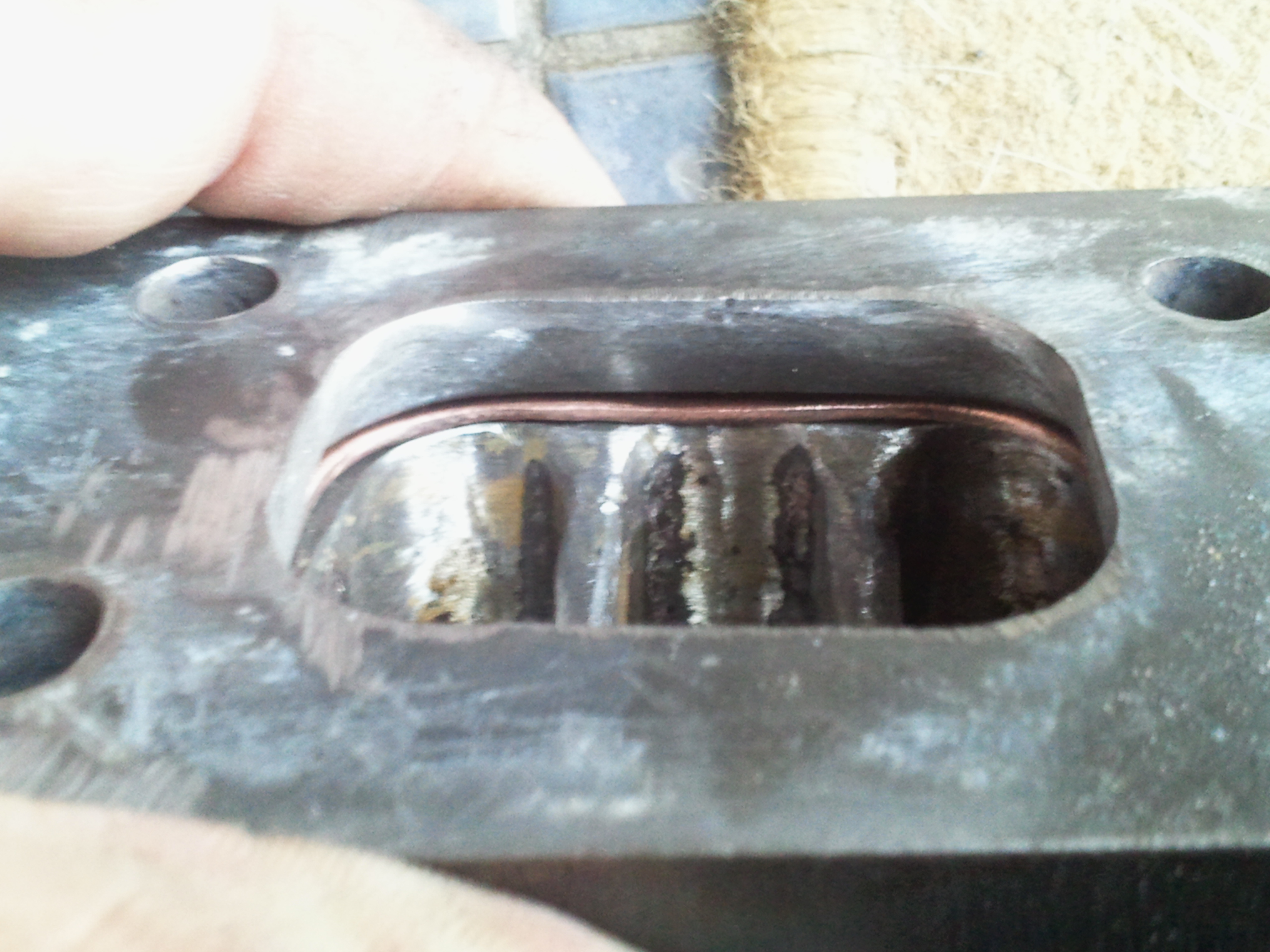

needed a turbo gasket
and blew my grinder up so exhaust didnt get a hanger
I've got two grinders if you want to borrow the bone shaker.
Which gasket do you need?

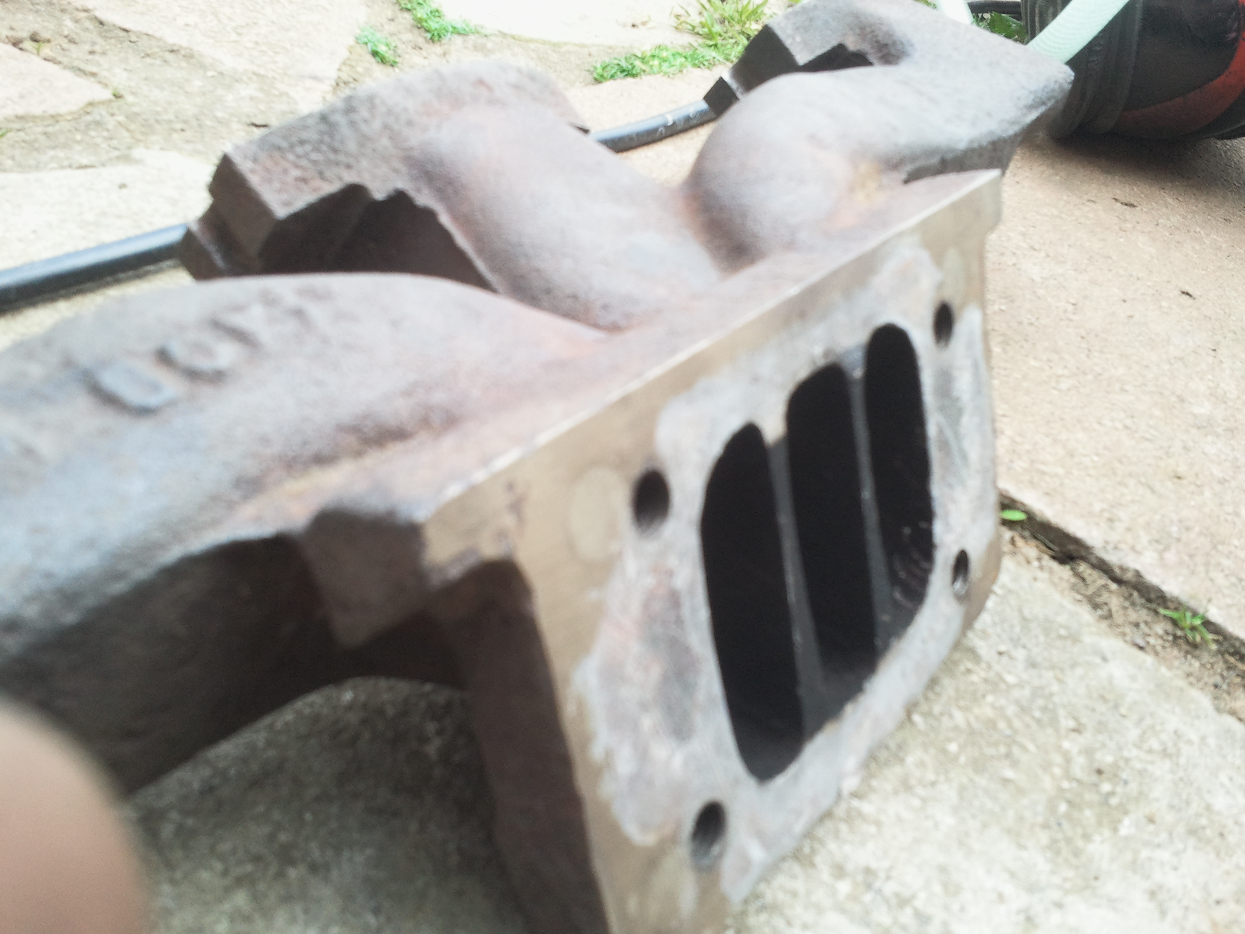

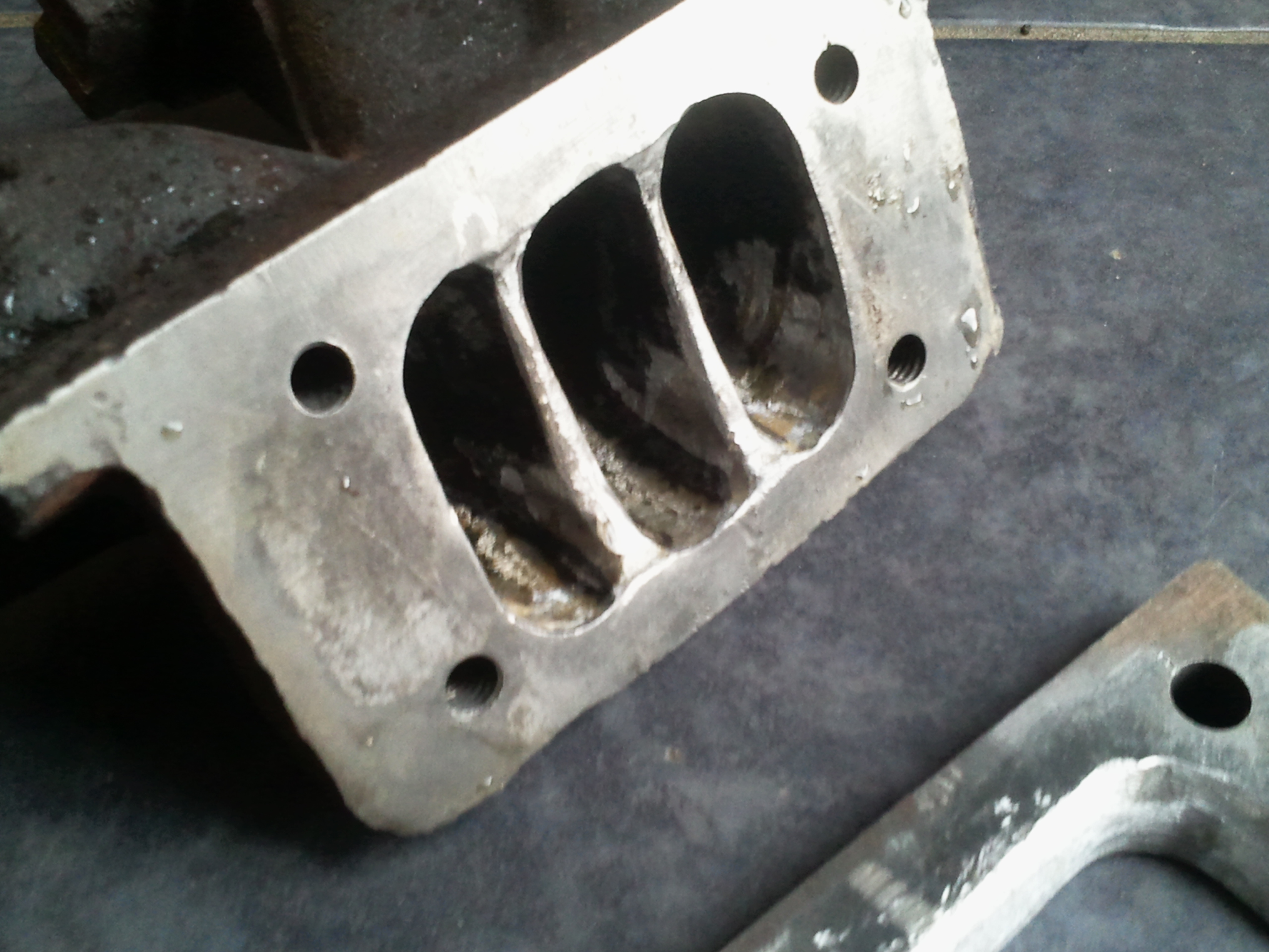

the gasket i need is a t3 size with t2 holes and on the dodgy angle ive got my turbo.. ive gote some 1.5mm copper plate here to make 1 now *wink*
I've never used a gasket between manifold and turbo. Both surfaces should be nice and flat anyway. I just use some exhaust assembly paste, never blown.
Got a few new t3 to maifold gaskets if you need one
copper one is made up now, pre pump filter fitted too, for reference its a stock uno turbo fuel filter pre pump and ford focus post pump

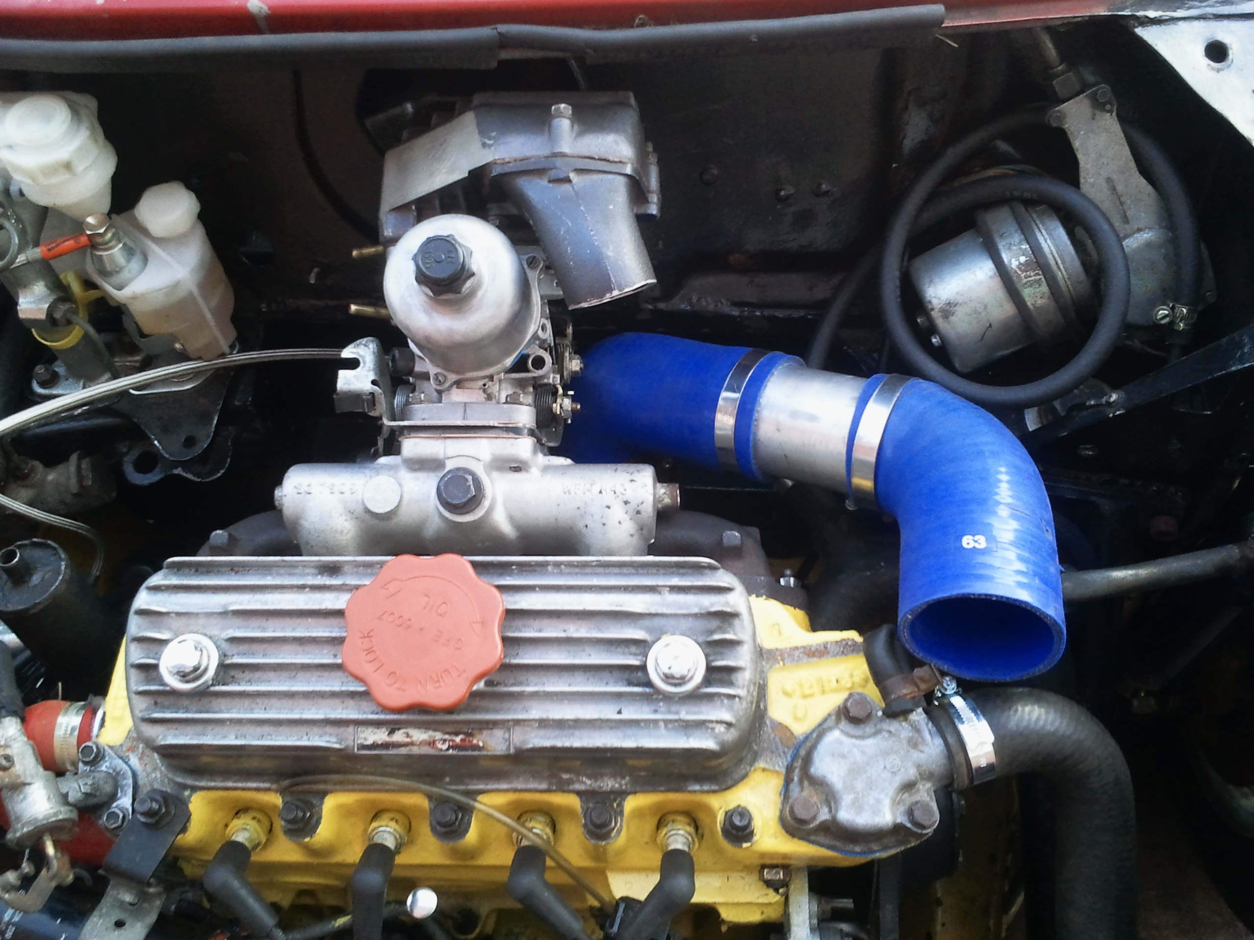

well it ran, and it ran well, fired up after about 10 extremely slow revolutions

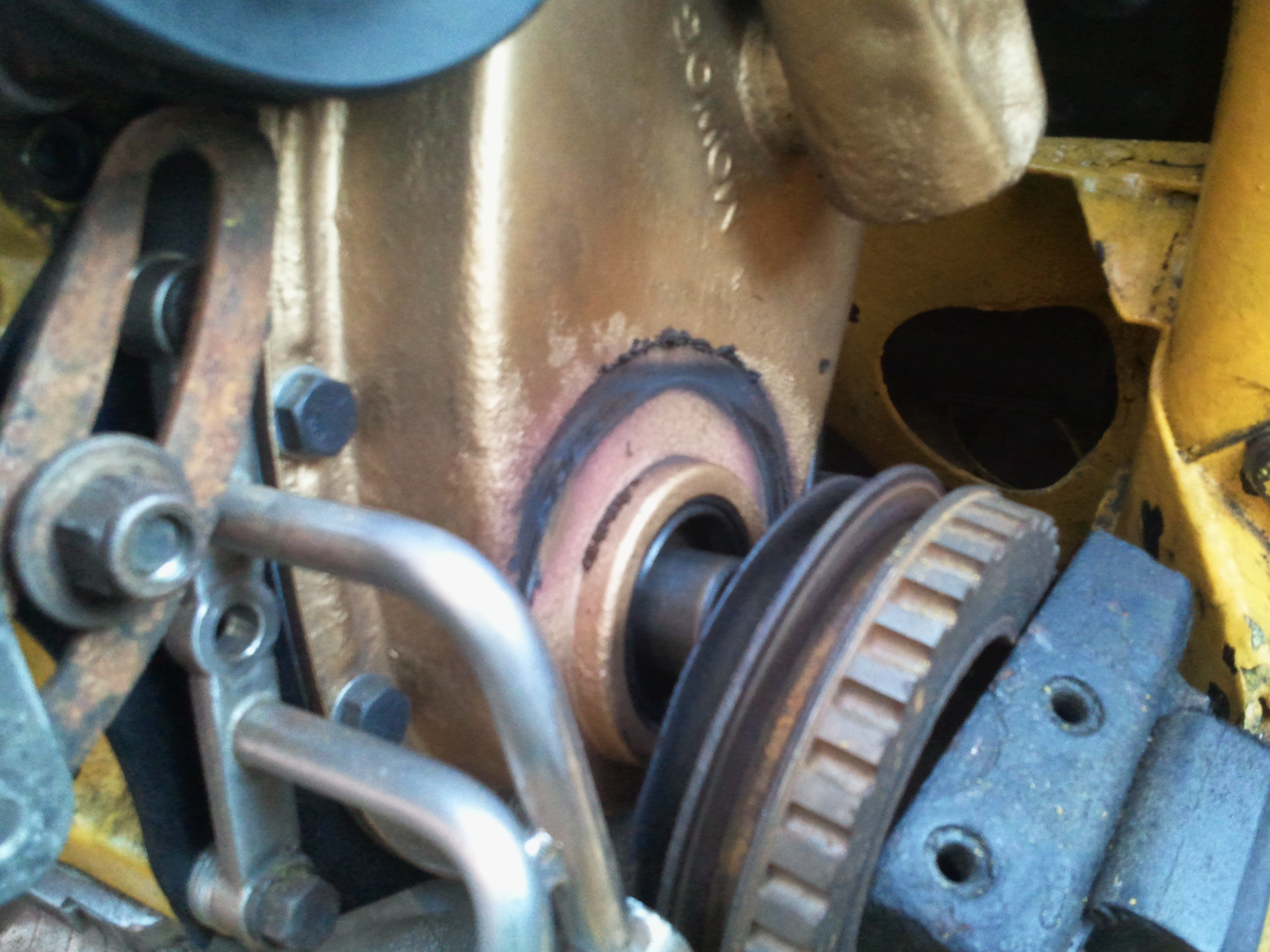

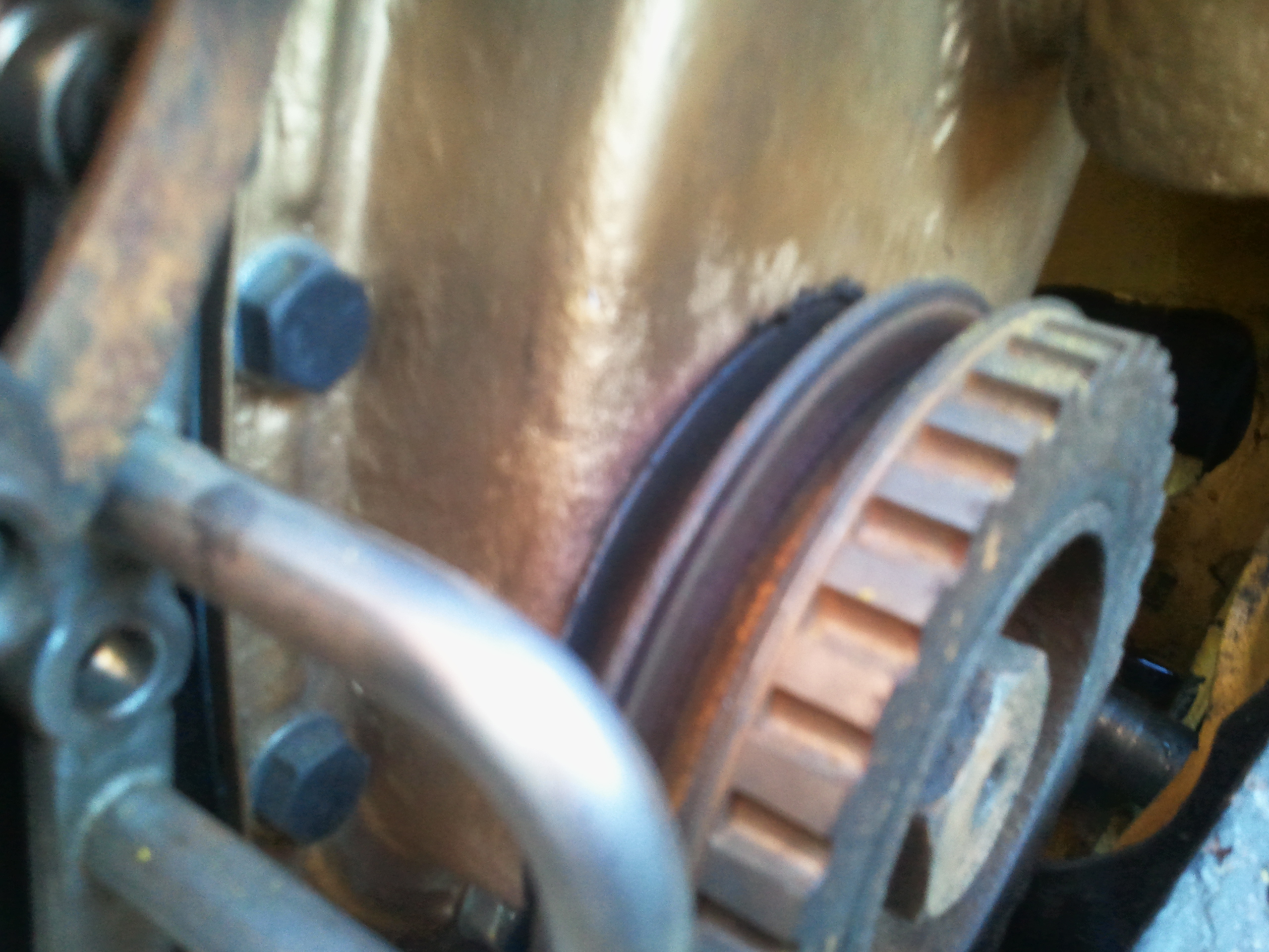

struggled to idle, infact it wouldnt it needed 75% throttle to do about 2krpm something was seriously up with it, then smoked alot.. from the crank damper
i should have spotted this when i built the engine but i did not, no harm done though and an easy fix
the only other problems really, small leak from the top dry deck port and a slight fuel leak on the return line so well chuffed doesnt describe it
*Clapping*
Well done buddy, bugger about the damper.
Easy to sort, just drill the three rivets in the back of the pulley and that tin guard thing comes off.
cheers guys and cracking idea Tom, already done, back together tomorrow :)

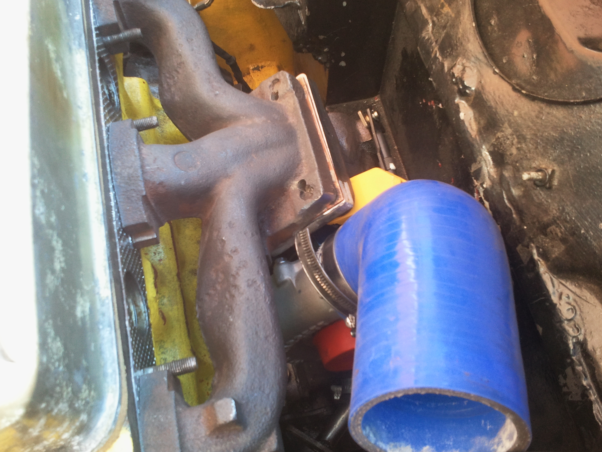

its done, took alot of effort to get it to fire up today though turns out there was a leak on the manifold bolt,
its now got a rock solid idle and it sounds like a really big bike revs up like one too well cuffed, moved it under its own power for the first time since 2007
there is no video yet as i only have 2 hands and im abit embarrassed about how scruffy it still looks *oh well*

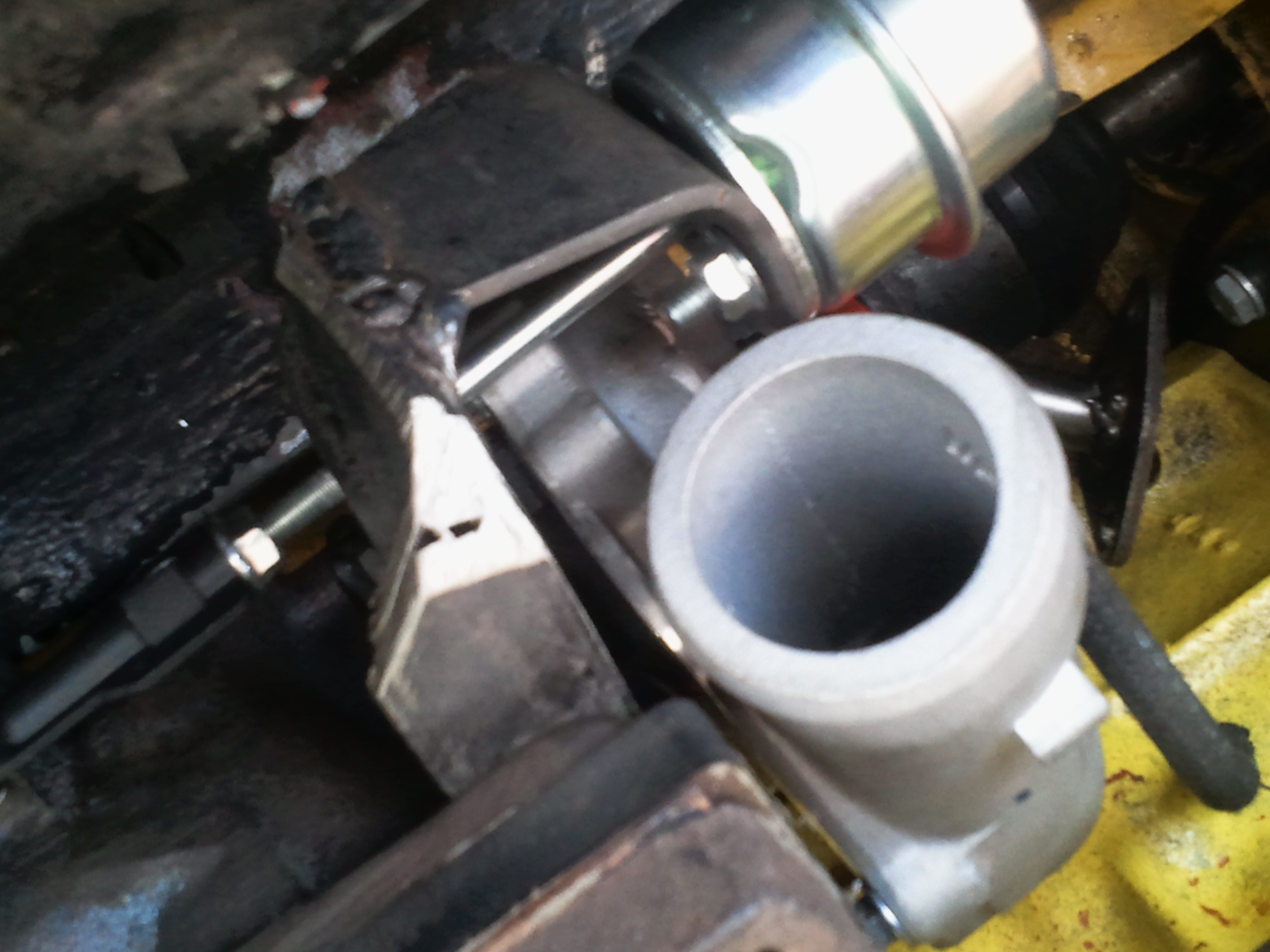

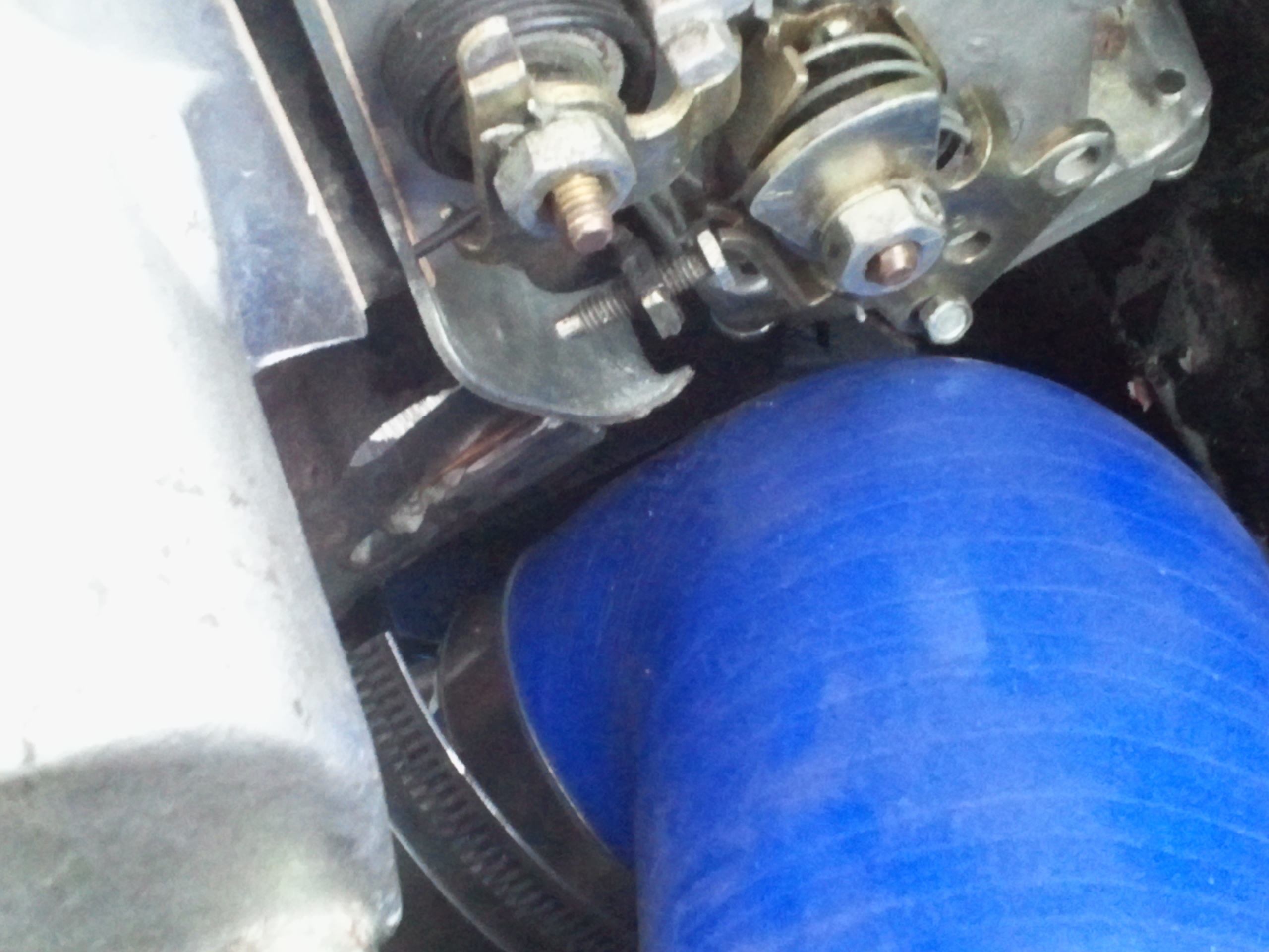

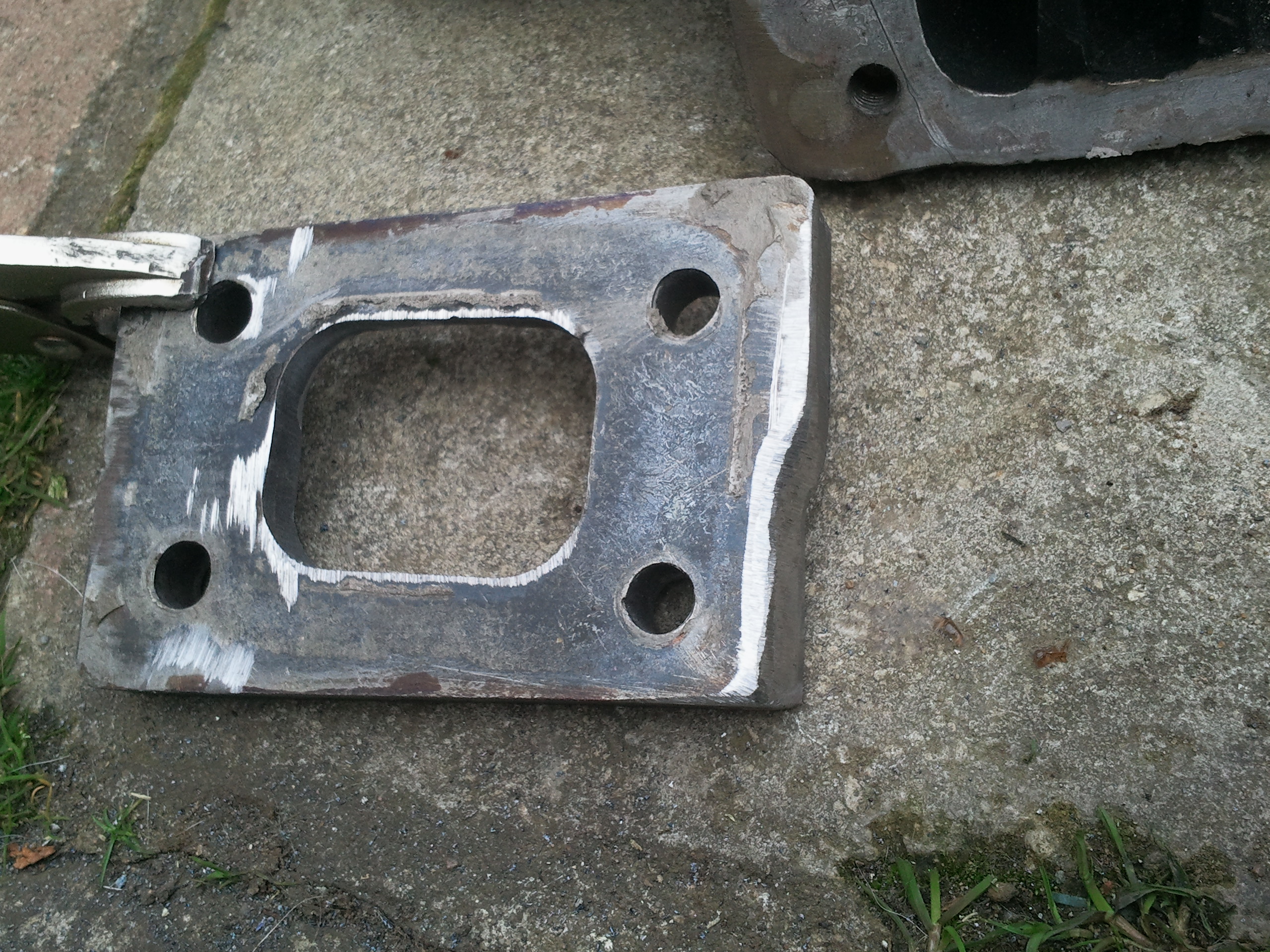

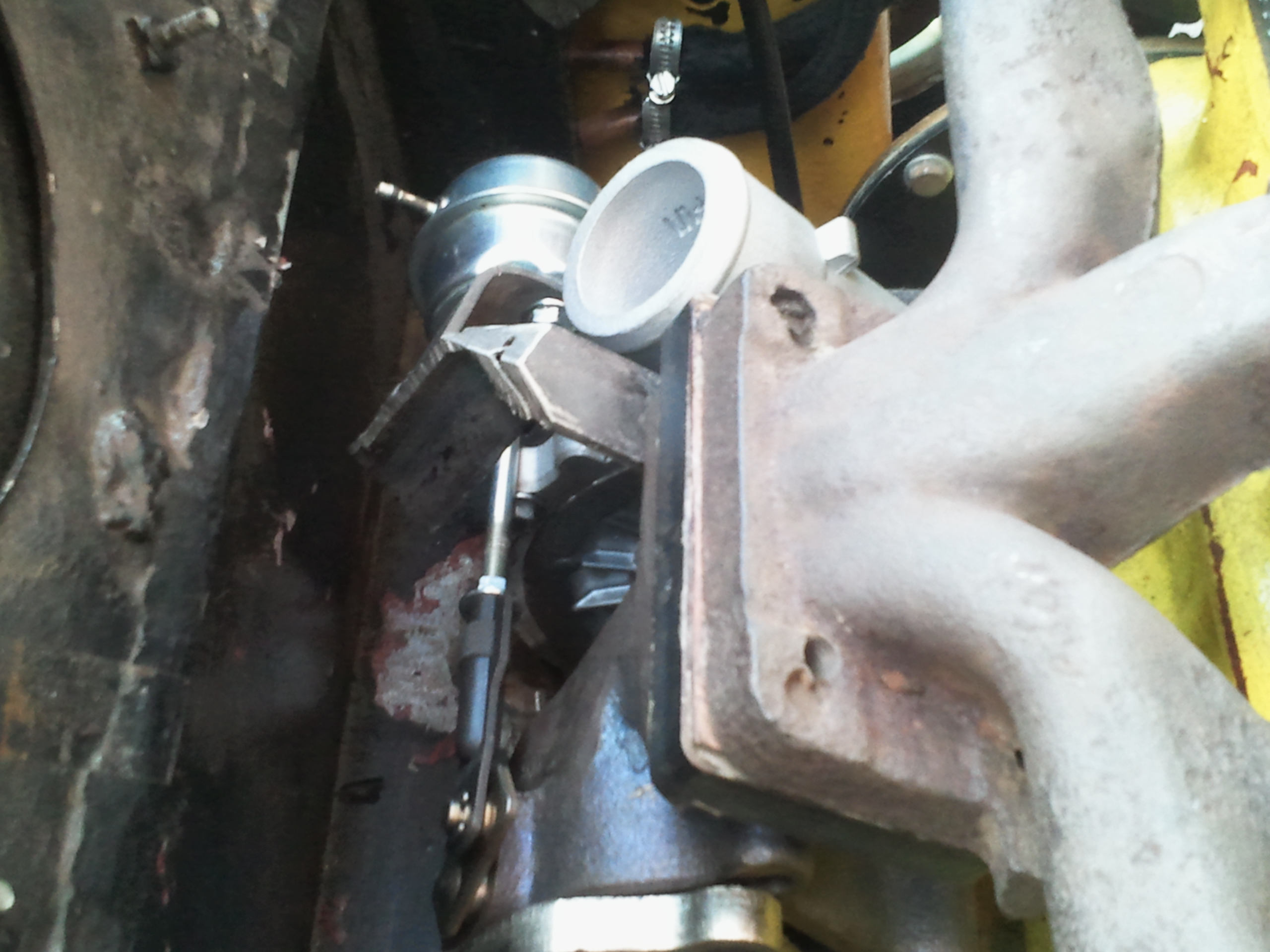

actuator mount (v3) built and test fitted
then it all came apart for serious fettling and blending in with the adapter plate

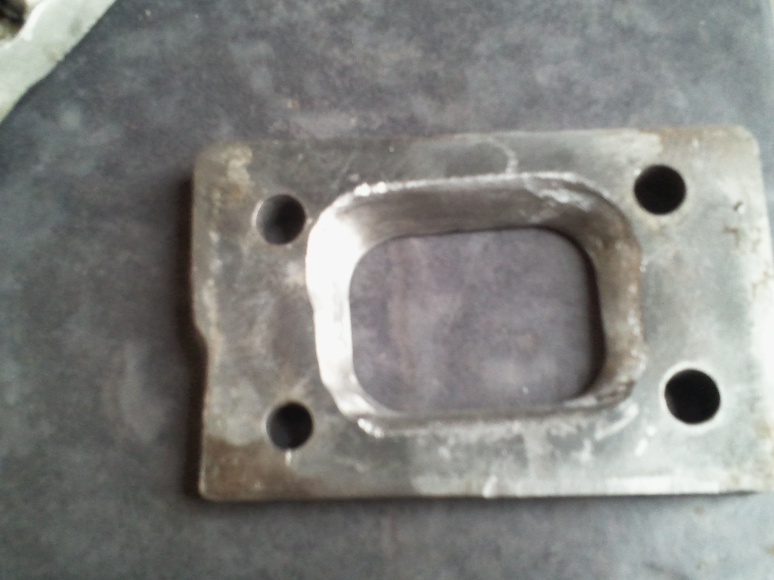

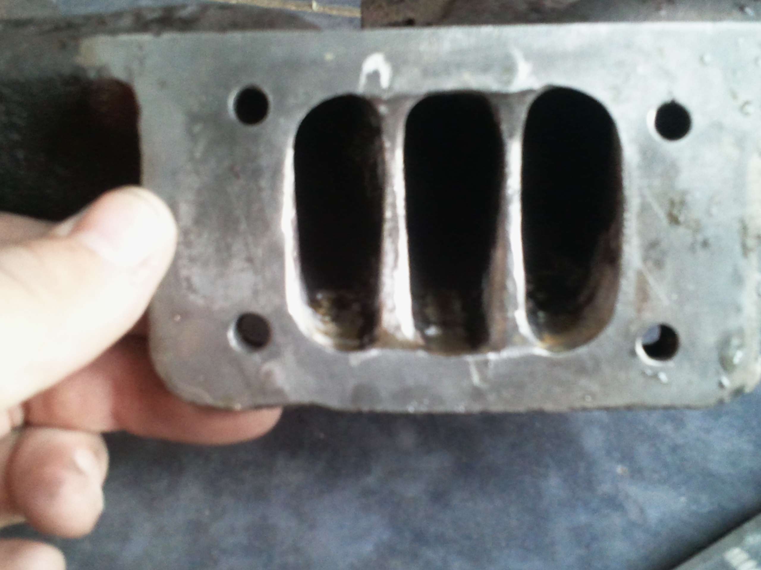

more
more more*happy*
and the tube im doing to call an exhaust *happy*
