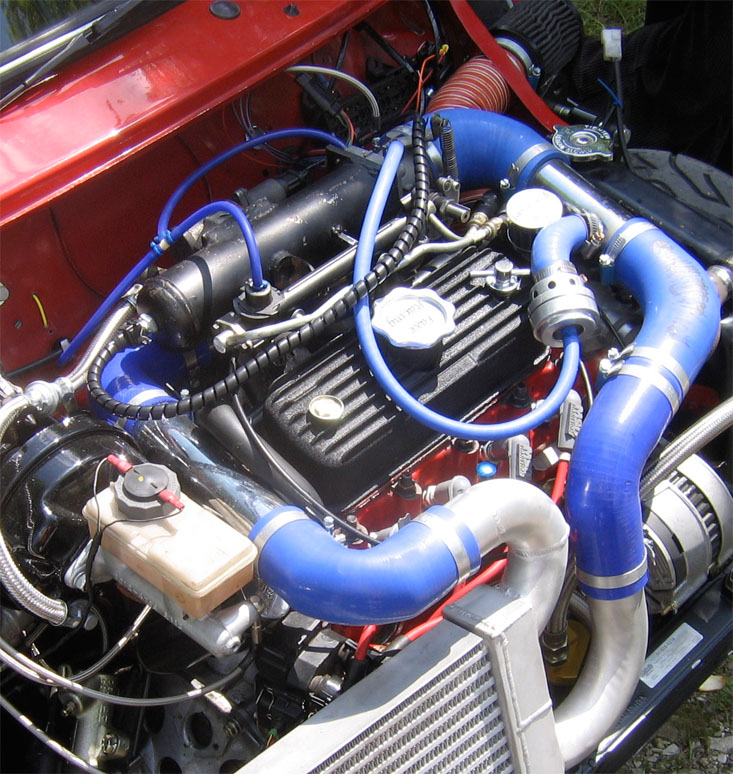

Reminds me a bit of this one I saw at IMM last year (is the owner on this forum btw?). Sorry for the bad angle, but the overal shape of the inlet seems comparable. Not a clue where he left the injectors tho.
