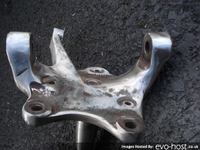

The cast steering arm...
I was extremely bored a couple of years ago when re-doing my Granada front suspension, so took to the "upright" with a flap wheel in the grinder. Only a few minutes work and over 200g removed from each.
I was mainly cleaning up to paint, but decided to weigh before/after too.
