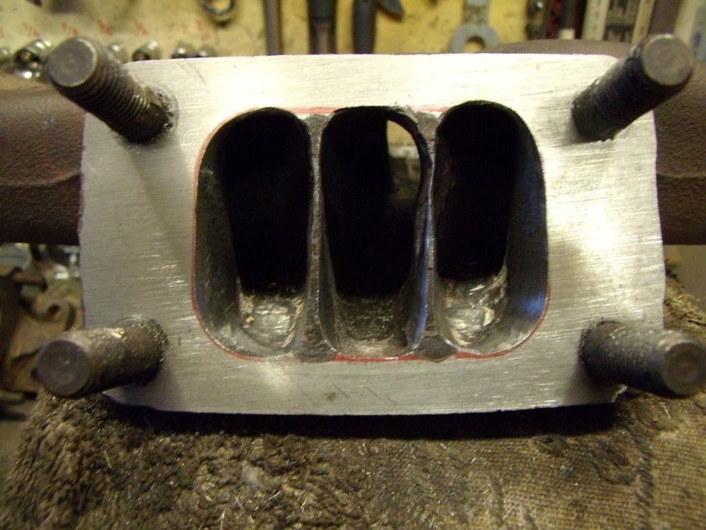

While It's all striped down decided to do a bit of porting..
Got my new gasket and drew round inside..
First one done..
and the other..
Same thing with manifold..

Hi guys have I done enough with the porting or is there more I can do without going over the top, Thanks for any comments

Usually it's not the size of the ports on the flange, but the bends that are the most restrictive.

Yea just seen It on YouTube that it is the common practice to smooth the ports back to the gasket which is all I've done, just wondered If there was any thing else I could do..

That's about it for the manifold, match the ports to gasket and port the dividers, do the turbo elbow too, your still on a t3 aren't you?

The turbo elbow can be ported with good results.
